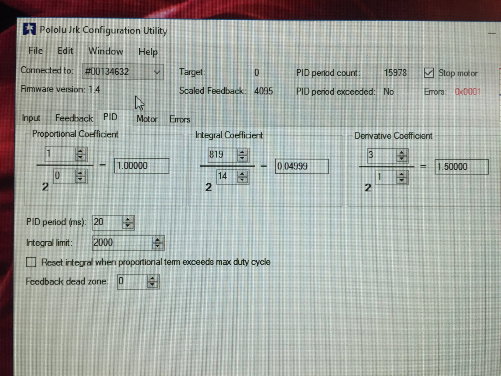

    Quick question, what fuses are you guys using? I manage to blow 15A slow-blow fuses but not sure if using 20A is a good idea.
    Thank you.

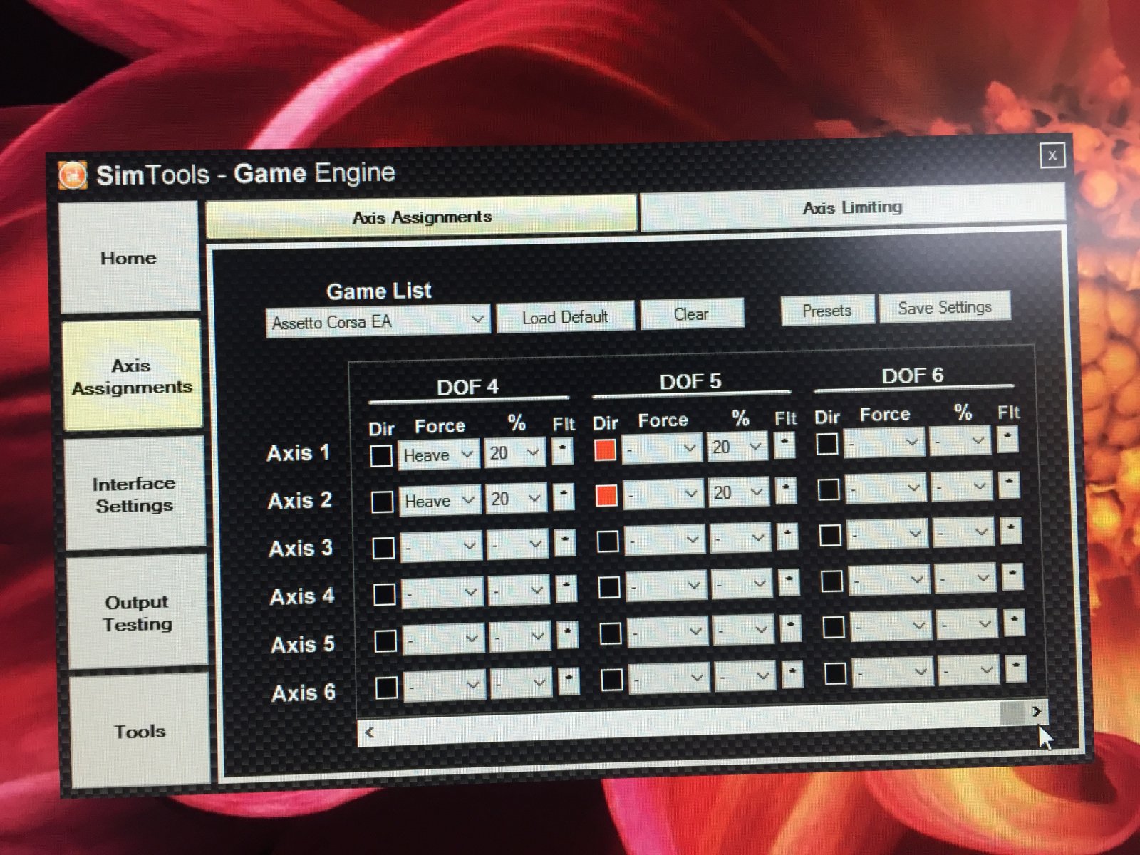

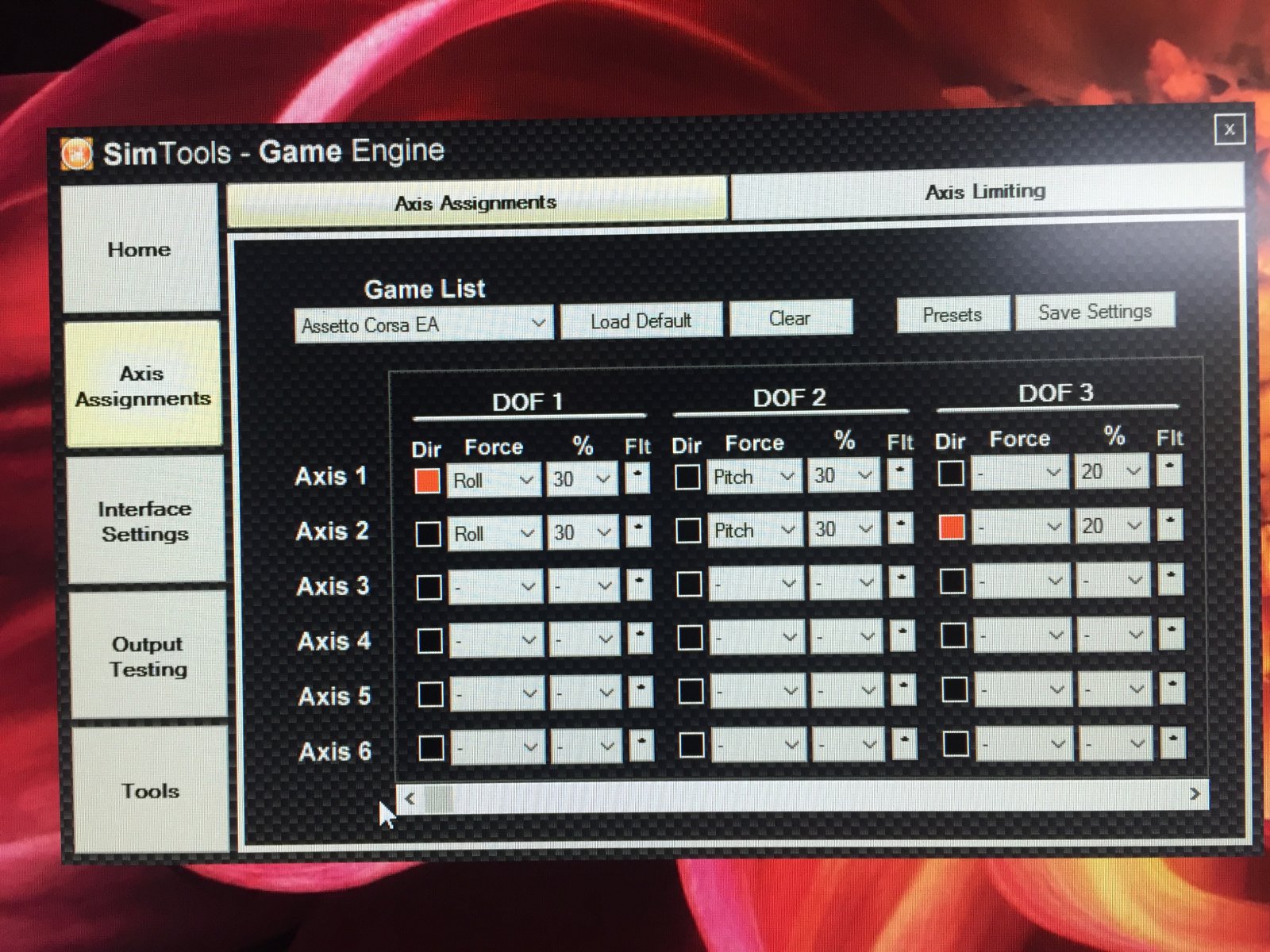

    my settings are attached I will be posting a couple of videos shortly
    here is some motion, I placed a second monitor next to the motors so it easier to see what is going on, only two motors are active
    JRK performance:

    Black Cat does NOT have a very good mesh, and the roads are soo wide its hard to replicate a run, over and over to feel the same thing's over and over....I suggest a track like Monza or Spa or Imola or Magione for testing. WAAAAAY better mesh compared to the fake Black Cat.
    also why are you missing stuff on your DOF 3 and DOF 5 ?

    @reko19 you might be better starting your tuning with serge & sway first ,,,,,and then pop the heave , pitch & roll in there .

  17. Nick Moxley
    17,057Coins
    +2,506 / 30 / -2
    Try replacing the regular nuts with Nylock nuts. Then if they still wiggle loose (they technically shouldn't) Then use a healthy amount of red loctite. Sure it makes it more of a challenge to dis assemble when the time is needed but, But Moot point you want to keep it in 1 piece while playing so either CRANK those nuts on tight, or look to other solutions.
    Game manager kicking out is a somewhat glitch on the simtools side but also hardware side having thing's turned up a little too much. (been there done that) v2.0 is Significantly better in this regards to a point where i used to have my JRK's limited in the Duty cycle and Accel, With V2.0 i was able to immediately go back up to 600/600. Bump your motor's down to say 500-500 and test, if no improvement try another bump down and if not, then we have to start working on a Better PID for your motors. I cant say i feel like the P and D are very accurately set. 1 and 1.5 are rather high for your motor's (same as mine) PSU dropping is part in parcel with the Duty cycle/PID settings more so than the PSU itself.

    Nick, what PID settings are you running at? Thx
  19. Nick Moxley
    17,057Coins
    +2,506 / 30 / -2
    P would be .5
    Integral would be something i cant really remember lol (no worries your Integral looks good but might need a slight tweak once we adjust the P and D)
    And its either .5 or .7 on my D i've flipped flopped between the 2 in the past and I honestly cant remember right now. Ill check next time i fire up the rig.
