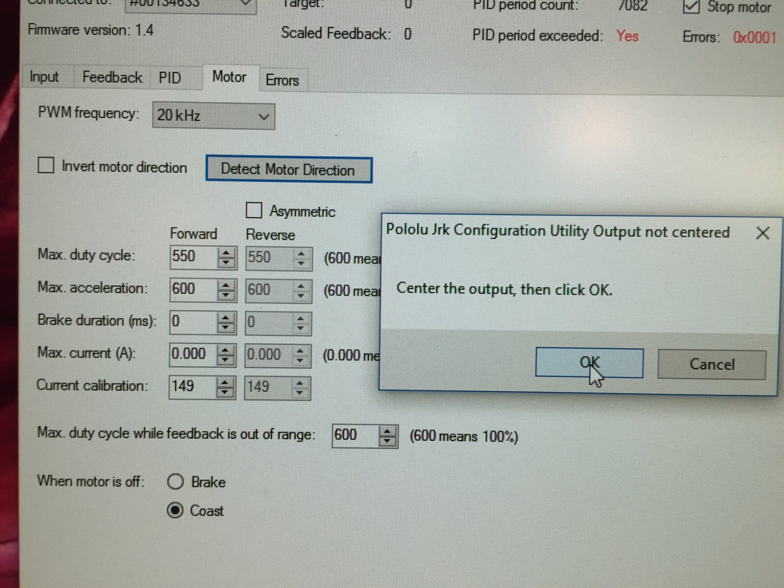

    First off, emergency stop is a very good feature to have :)
    Now that I got this out of the way, getting stuck at the very last step of setting JRK guide. After I press Detect Motor Direction I get to the prompt "center the output, then click OK". I click OK and nothing happens at all, my only option is to cancel. Any ideas?
  14. Nick Moxley
    17,056Coins
    +2,506 / 30 / -2
    that's fine, its just detecting the direction's...with a small bump of the motor which sometimes doesn't even happen. No worries continue on.

    Was able to sort it out with Nick's help, just needed to manually adjust pots so that they are within the range and line up with the motors (target lines up with feedback)
