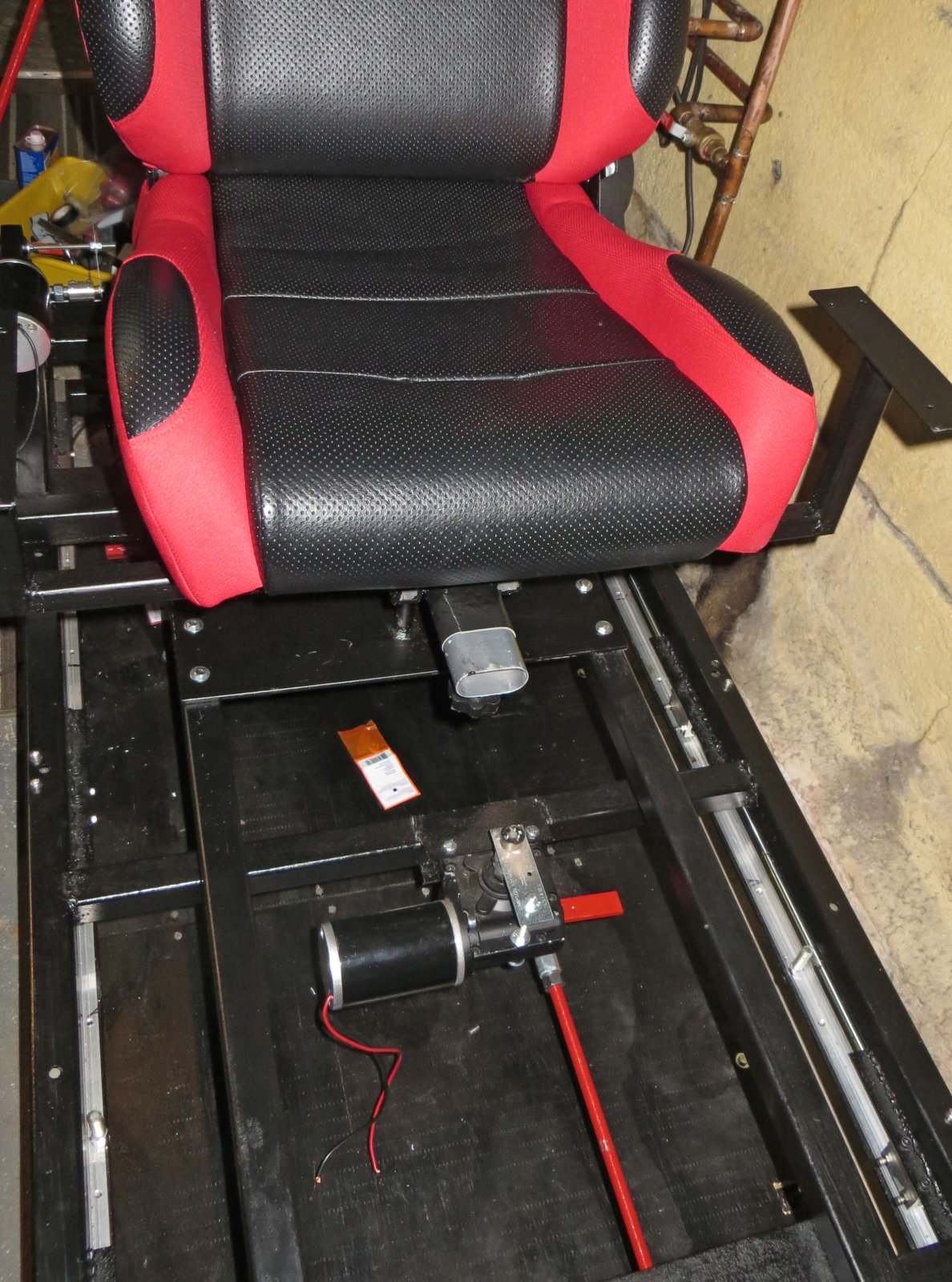

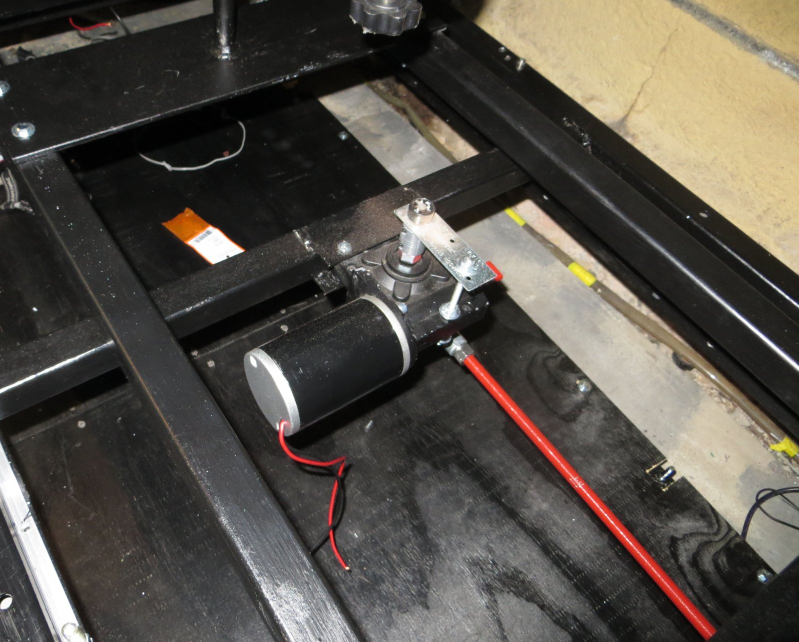

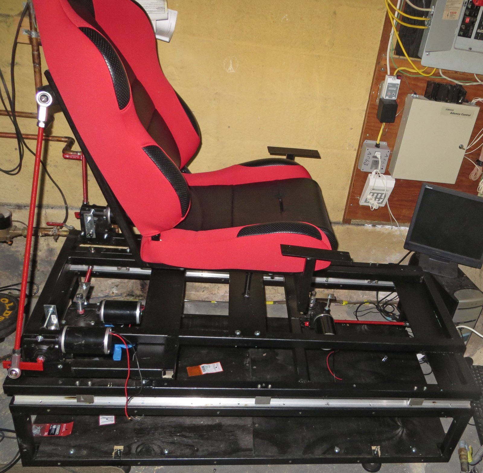

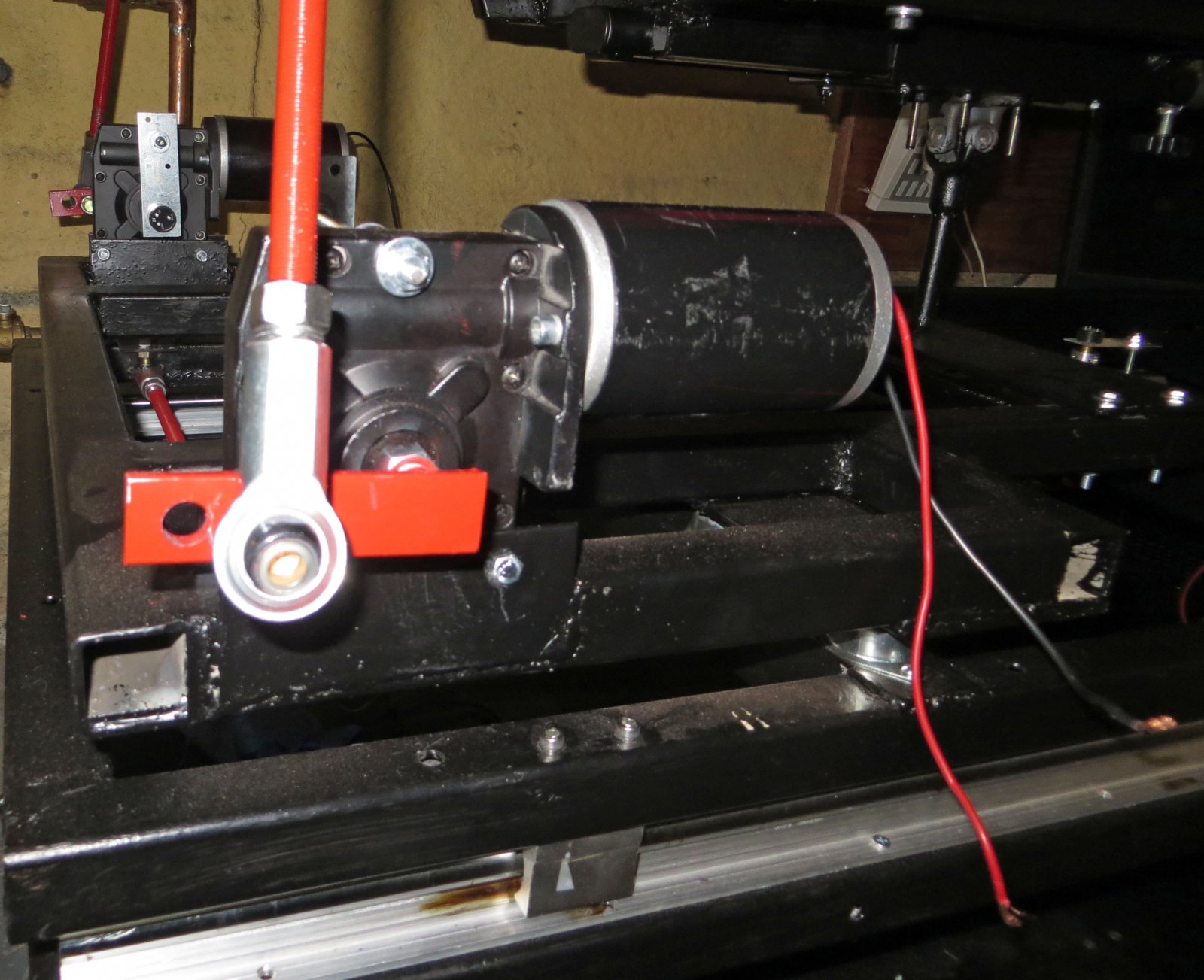

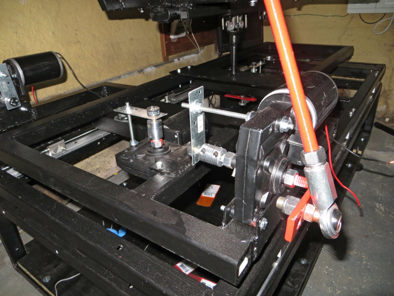

    @reko19 if you thread rod is a bit thinner than the motors hole you can wrap the threaded rod with a thin sheet like from a soda can so it will fit tighter . can do the job but don't know if it will last for a long time

    thanks, nothing is tighten yet, that could be the reason. worst case I could redo those, not a huge deal. hoping to finish the frame this weekend so i could move it inside

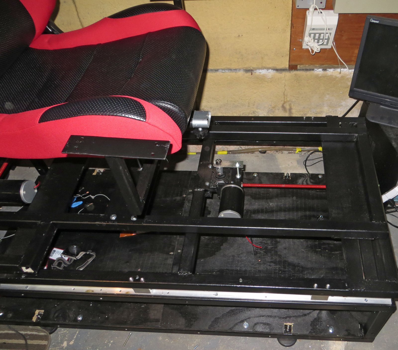

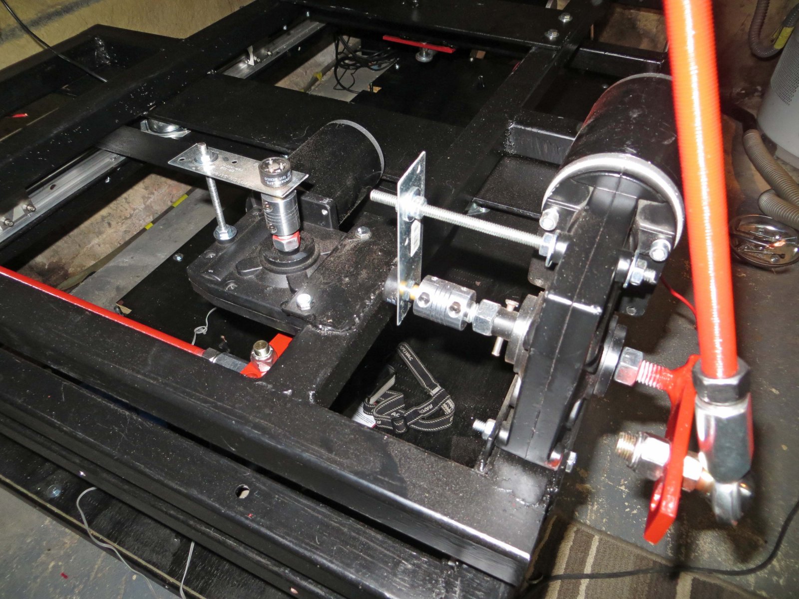

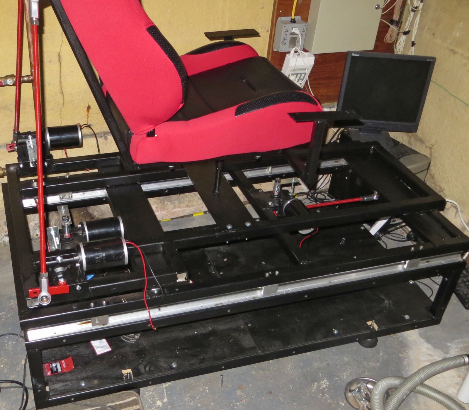

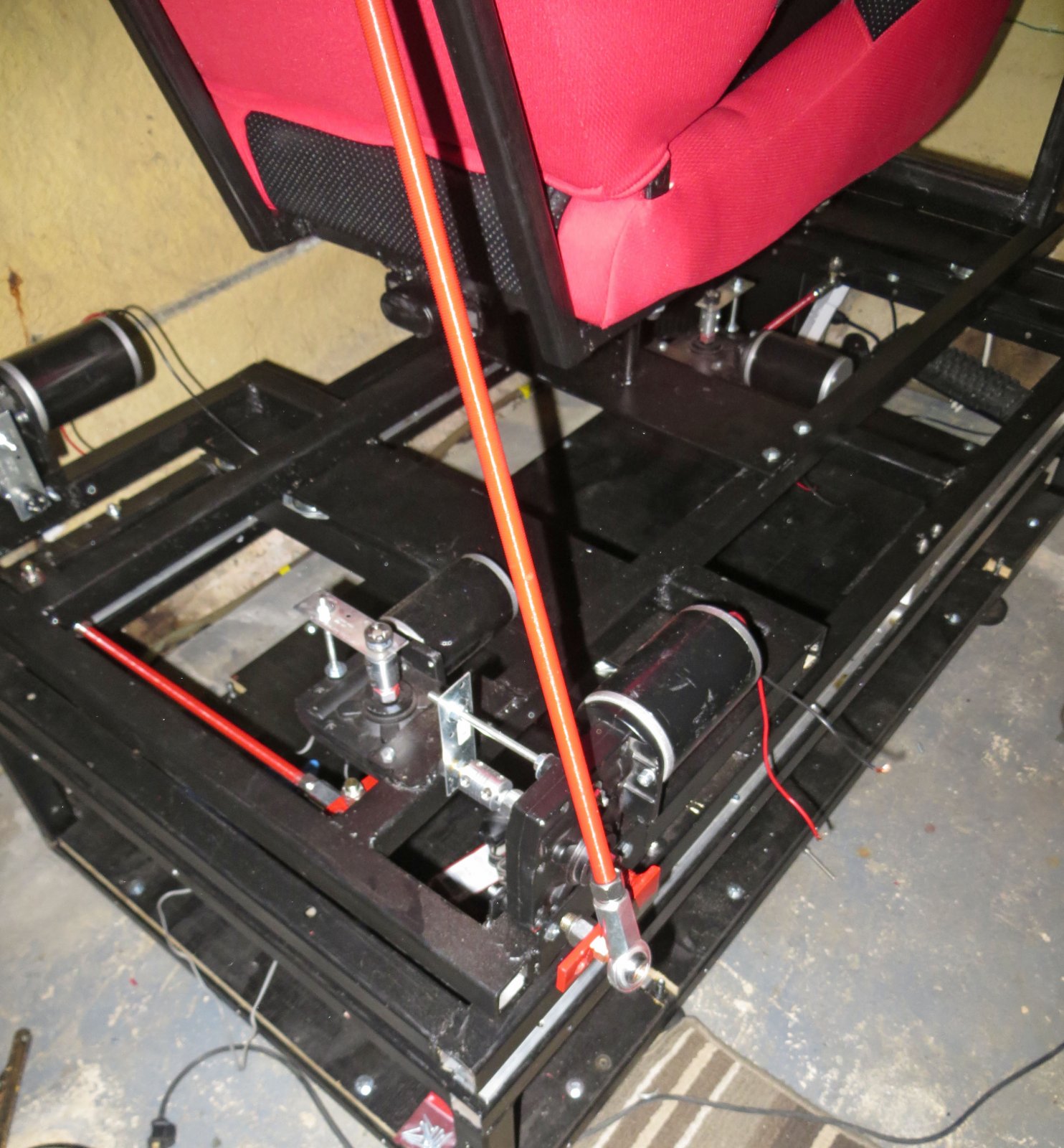

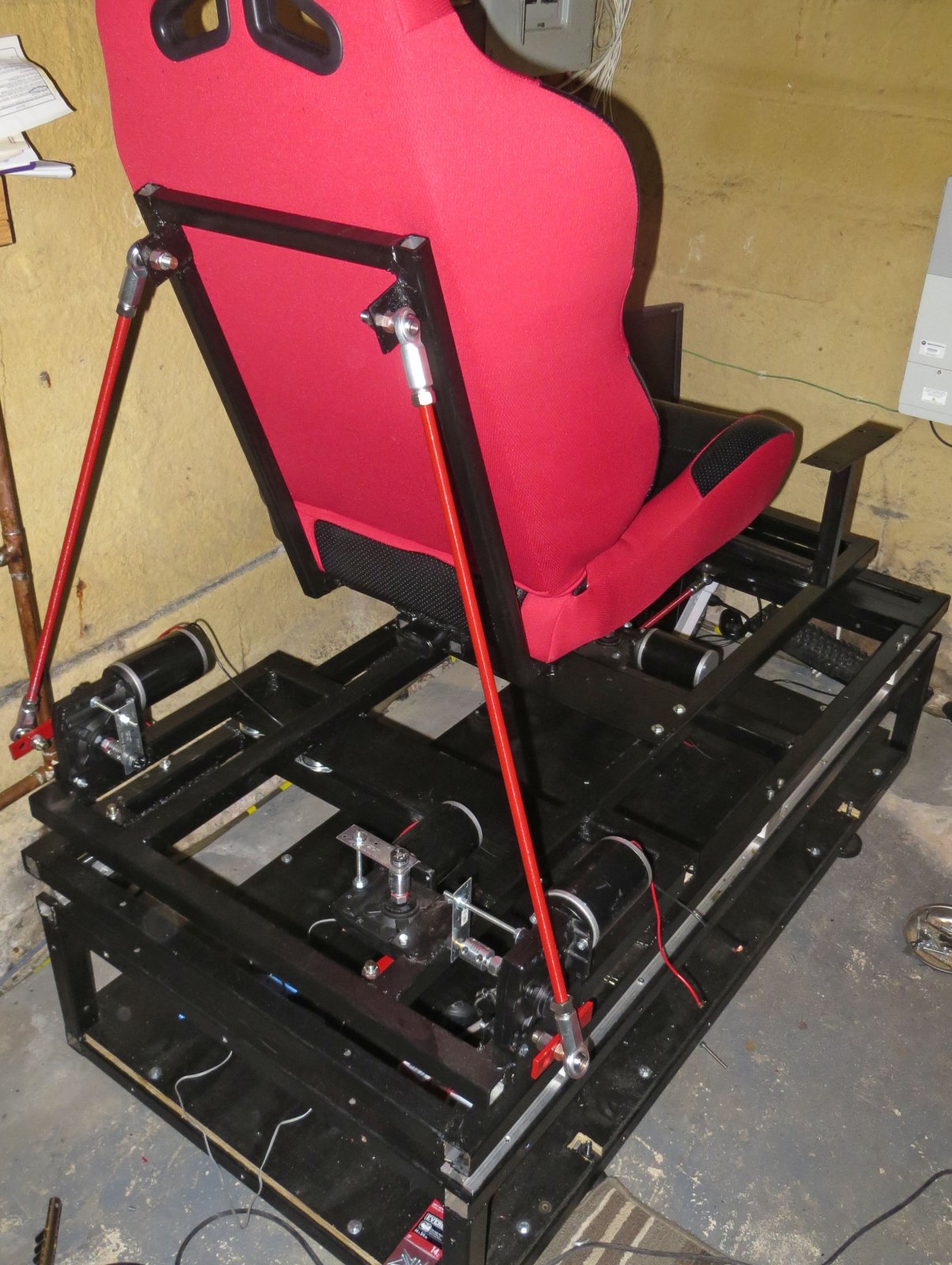

    long time coming, but the rig is panted, fully assembled and is in the house. four jrks came in last week so commencing wiring. this should go a lot quicker. will circle back with you guys once I make the computer parts selection to make sure I didn't mess anything up

    Reko, Can i suggest something. The Threaded rods have been known to "bow" under pressure, If anything i would box the rod up with some square tube to ensure its as strong as it can be.

    Nick, thank you for the suggestion. I know exactly what you mean and will keep an eye on it.

    quick question, where do I wire emergency power off EPO?
    power supply-EPO-JRK-motor
    OR
    power supply-JRK-EPO-motor
    thank you
