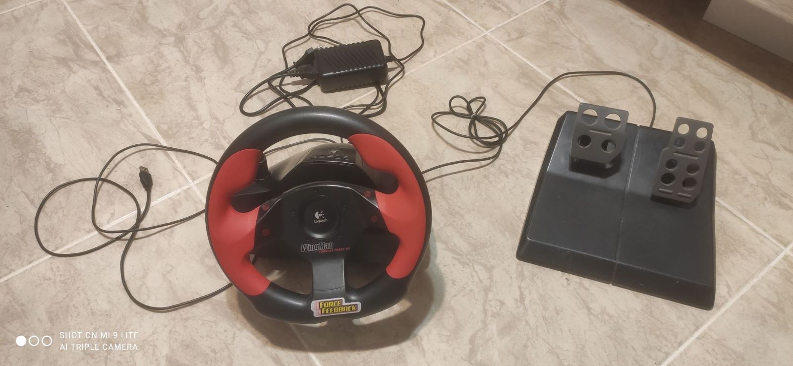

    - Logitech Wingman Formula Force GP steering wheel (2 pedals)

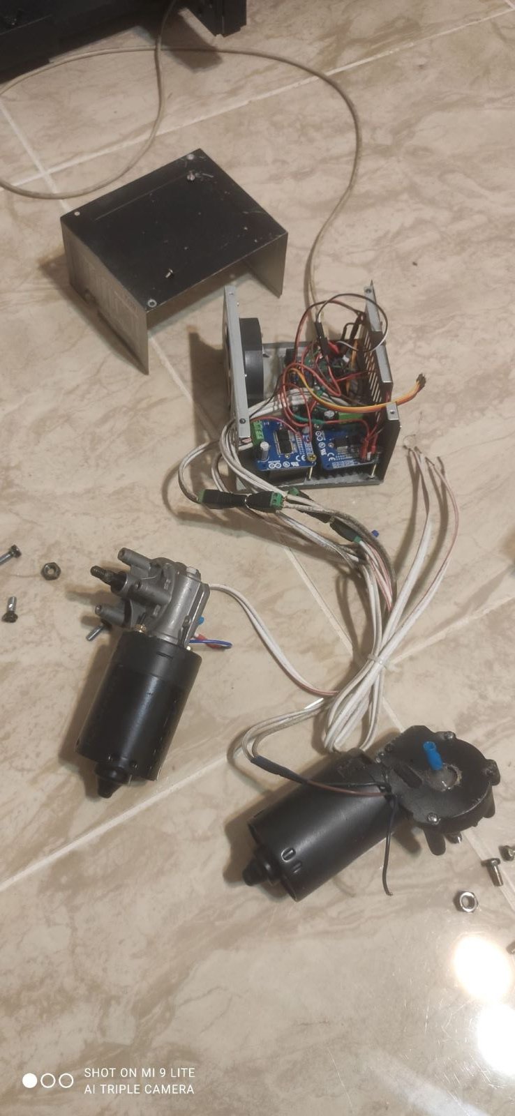

    - 2 x 12V wiper motors (Chinese brand) with 2 speeds

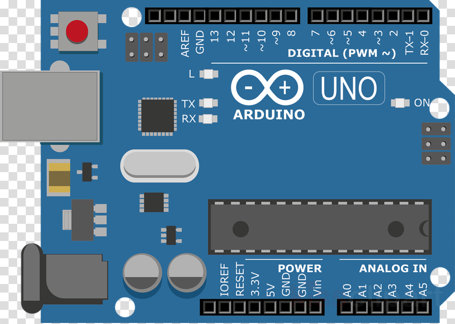

    - Arduino Uno R3

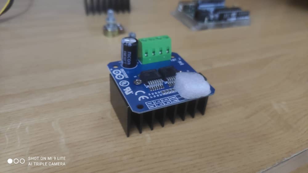

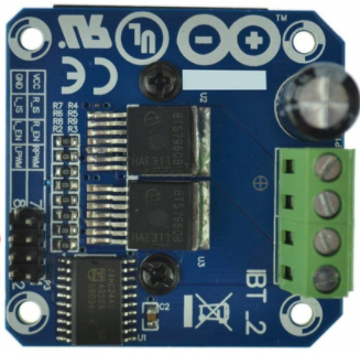

    - 2 motor shield IBT_2 ref BTS7960, (max 43A current)

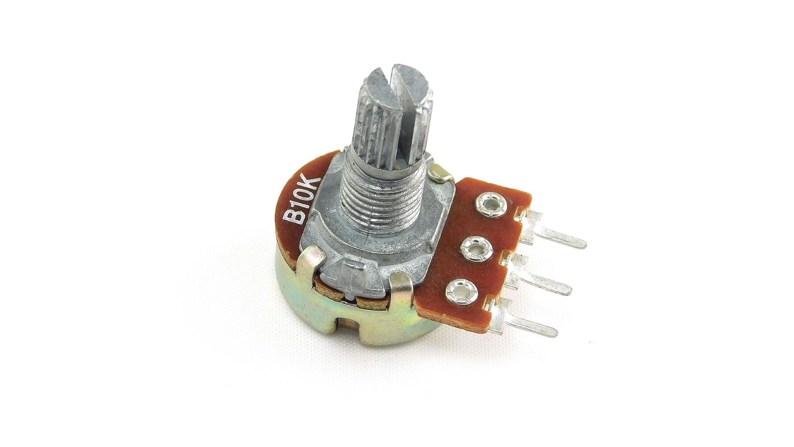

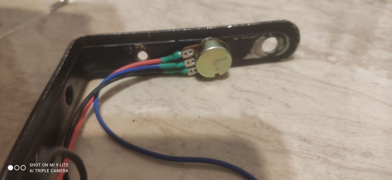

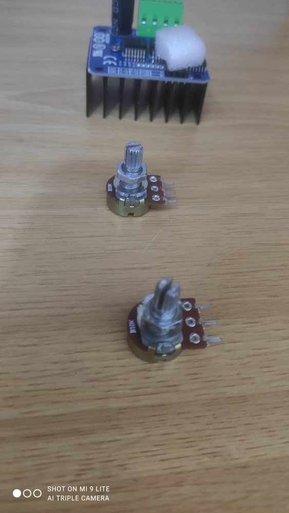

    - 2 standard potentiometers 10K 12V/20A

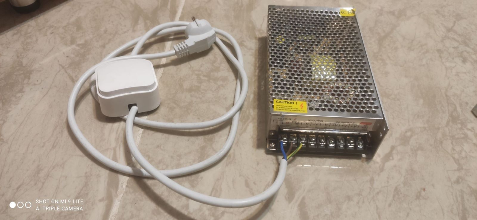

    - Power supply

    - Mounts for potentiometers

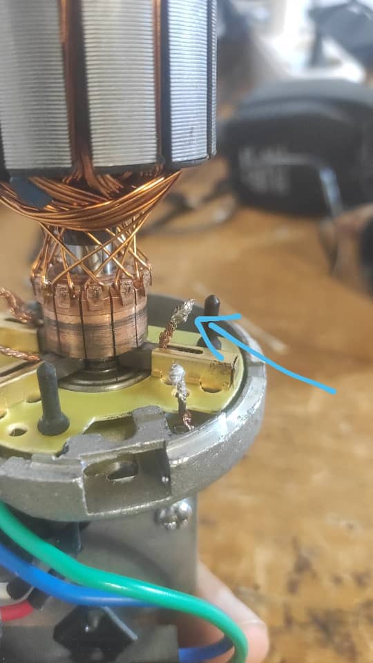

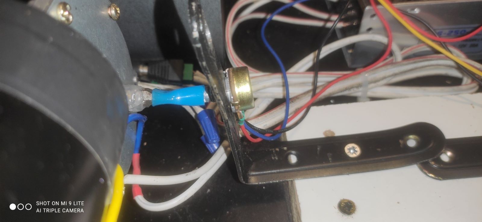

    It is important to insulate the GND inside the motors, it was not necessary for my project because my structure is not metallic.

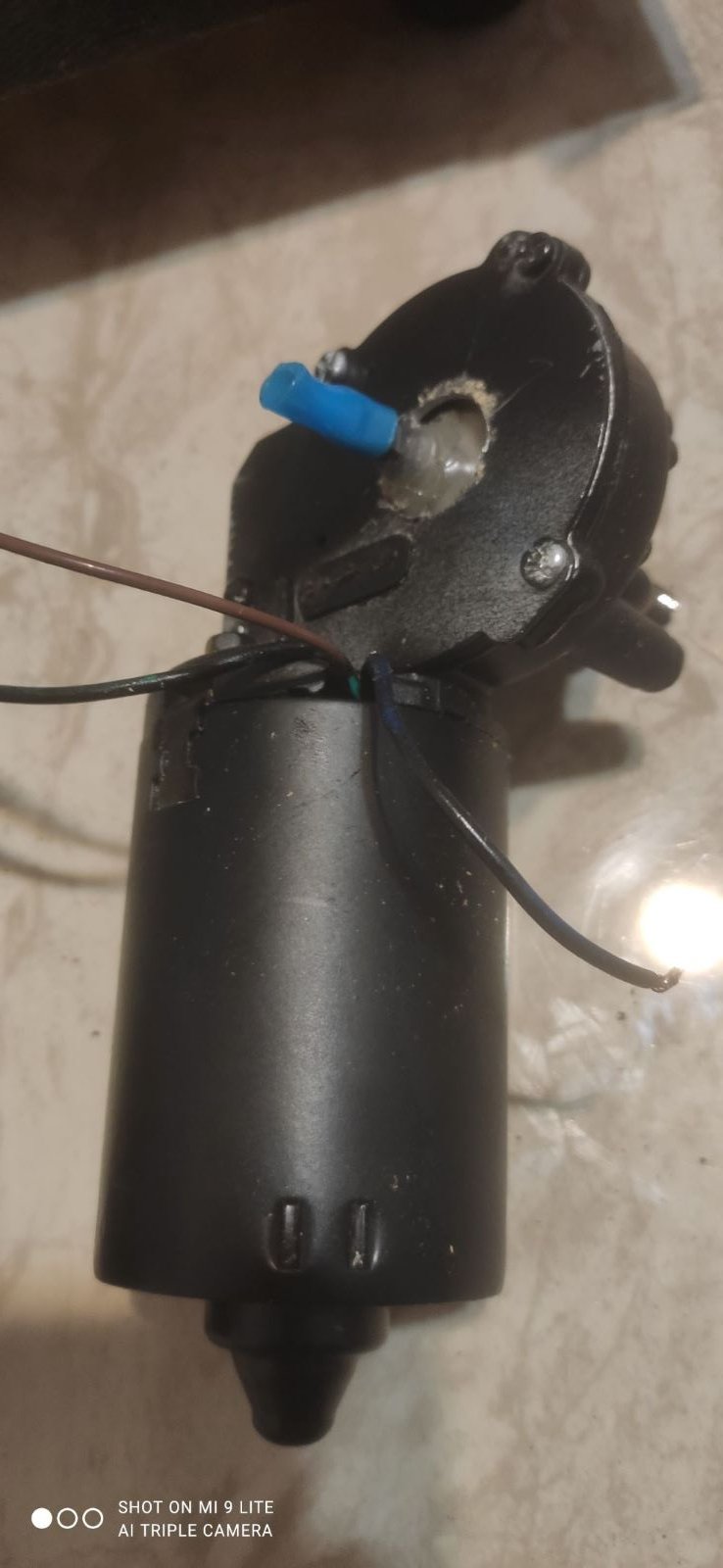

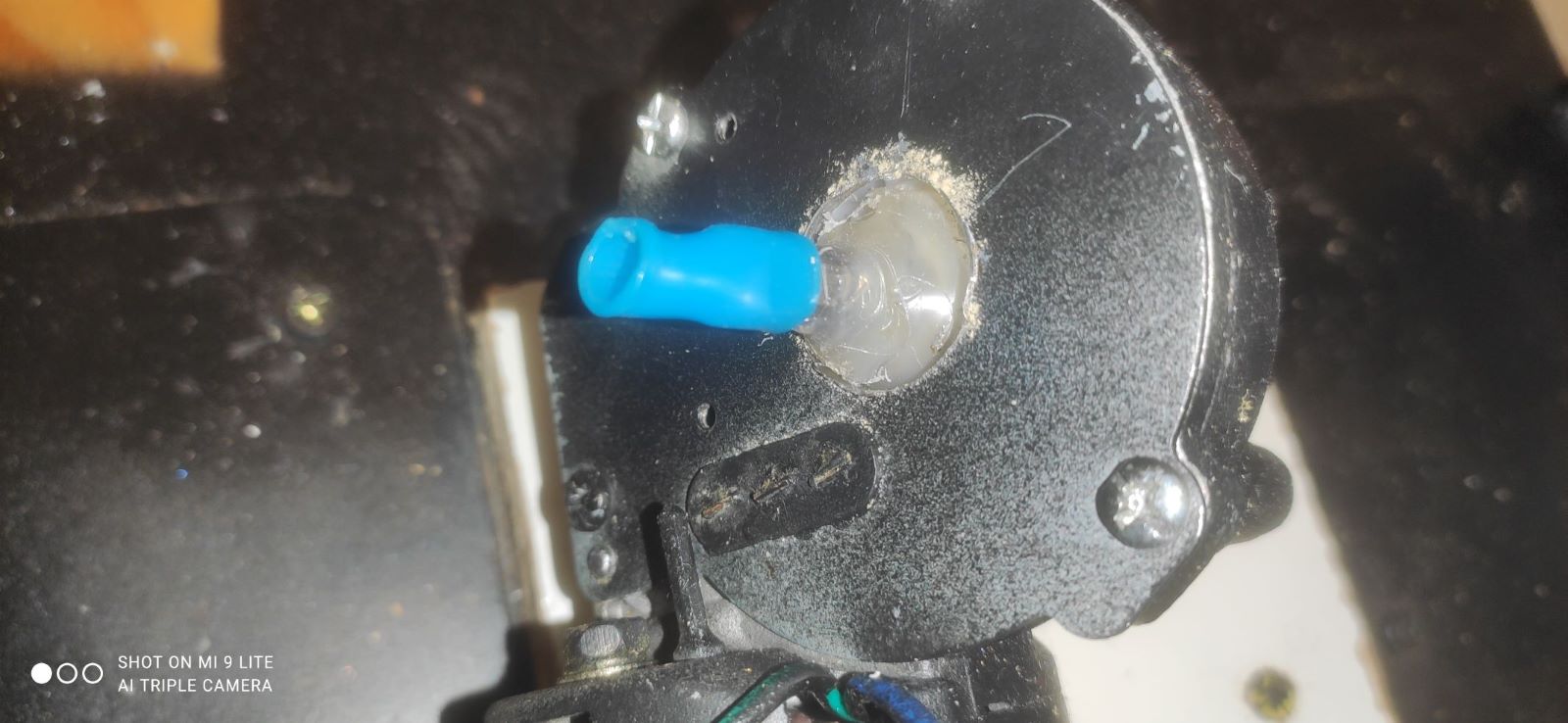

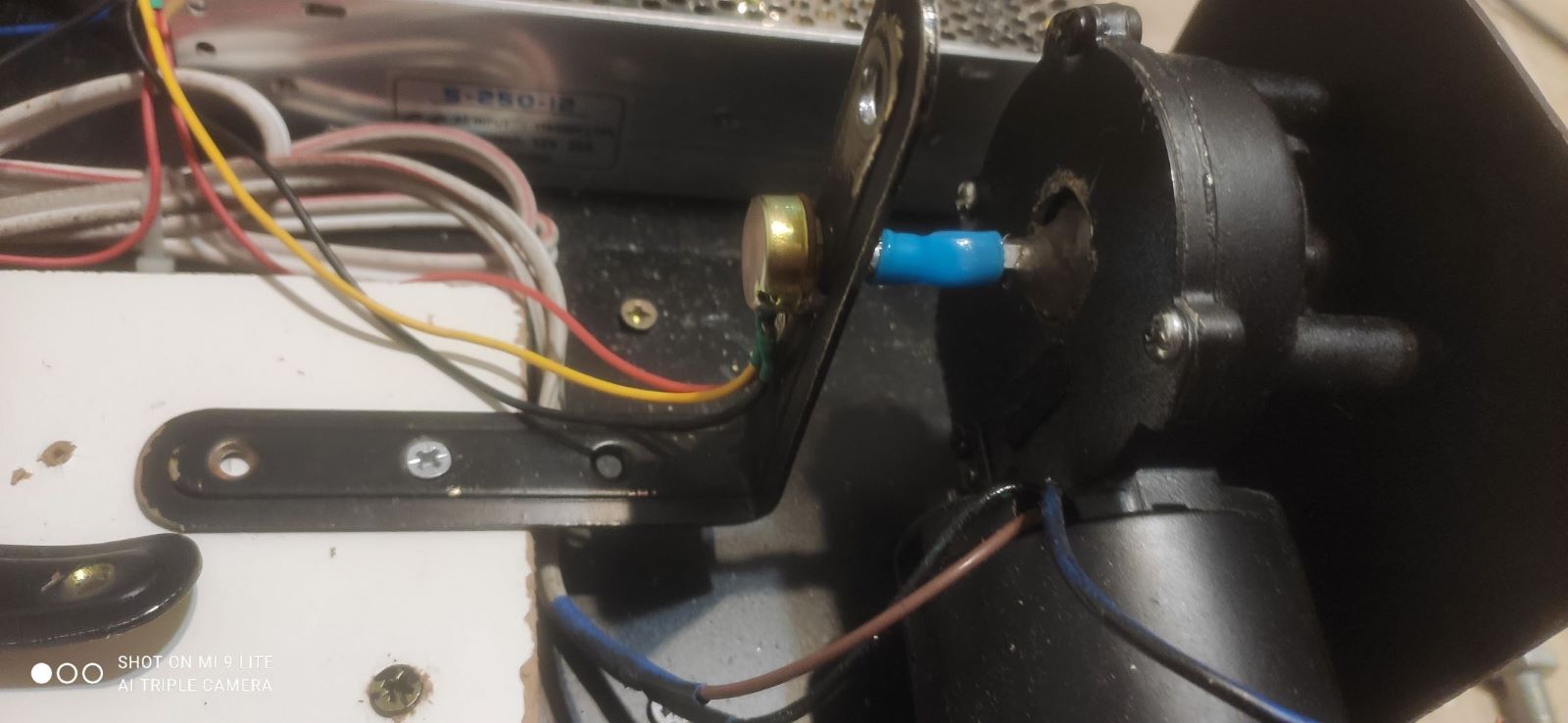

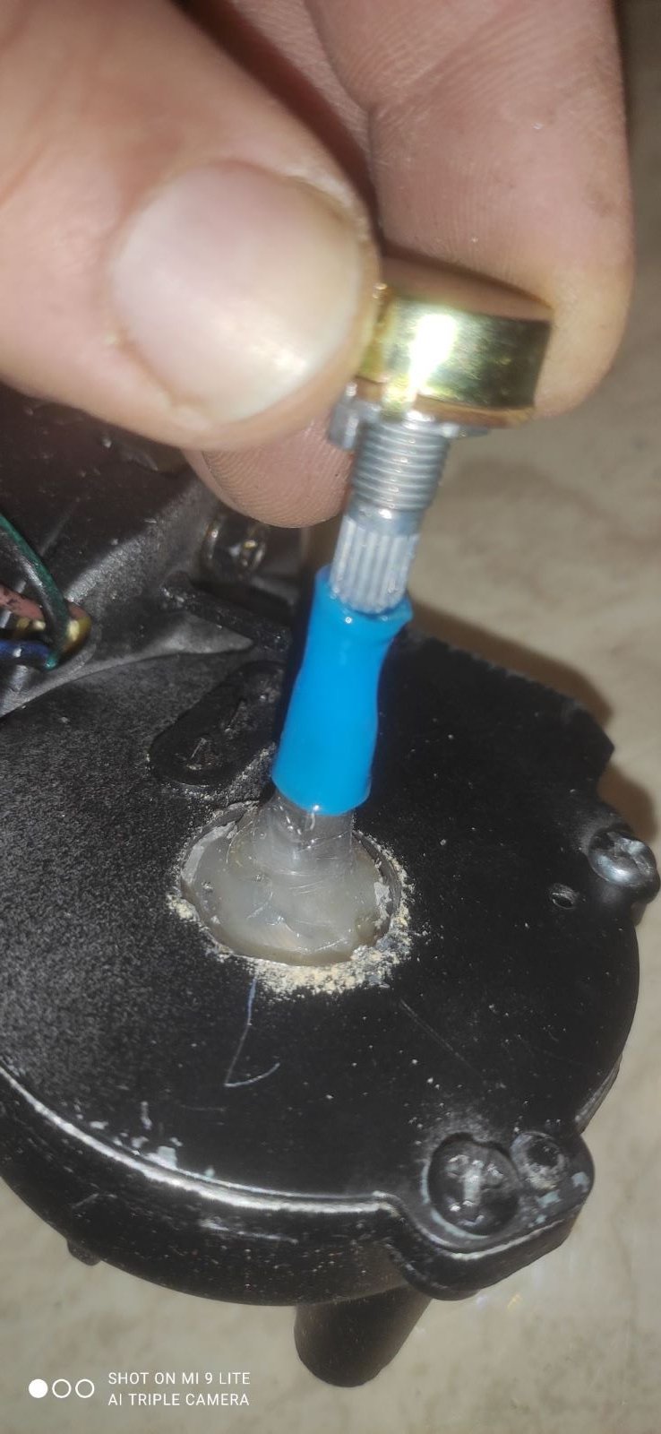

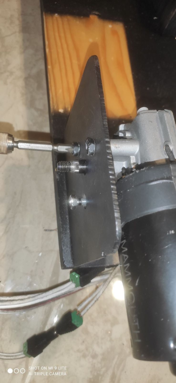

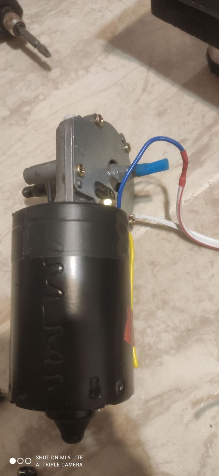

    Here are the modifications made to the motors to add a rear axle for attaching potentiometers.
    Small rigid pipes serve as links between motor and pot. The axle is a simple tip of screwdrivers glued with silicone. The pipes should be inserted slightly forced into the potentiometers and the rear axle of the motors.

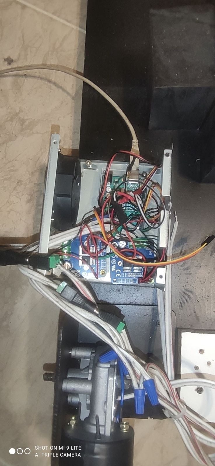

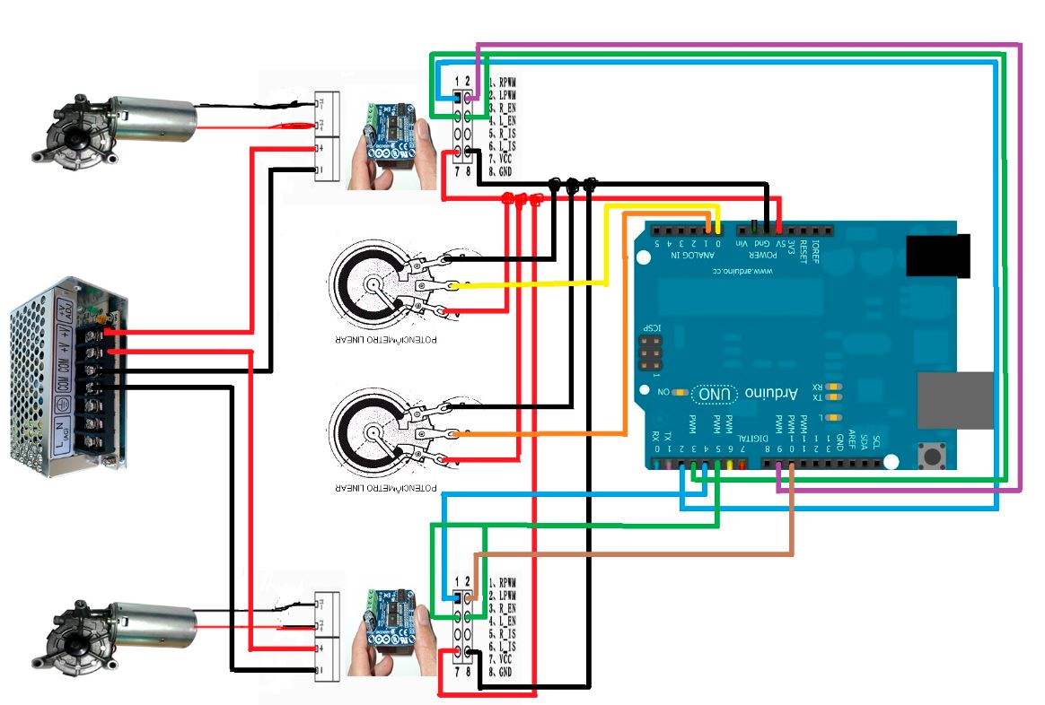

    A. Electronic
    The Arduino code used is the one provided by sirnoname: Arduino open source PID control firmware and hardware. The outputs are therefore the 2 actuators position 1 and 2 (Right & Left)
    For connections, here is the diagram:
    It is advisable to test the connections before fixing everything (see Software section for setup), the direction of rotation of potentiometers and motors must be reversed. If both rotate in the same direction, simply reverse the poles of the concerned motor.
    Motors must be stationary in the dead zone (50%)

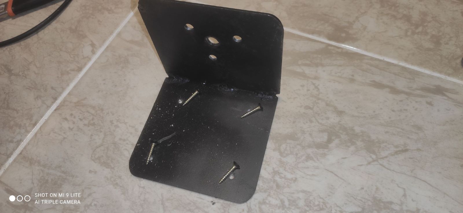

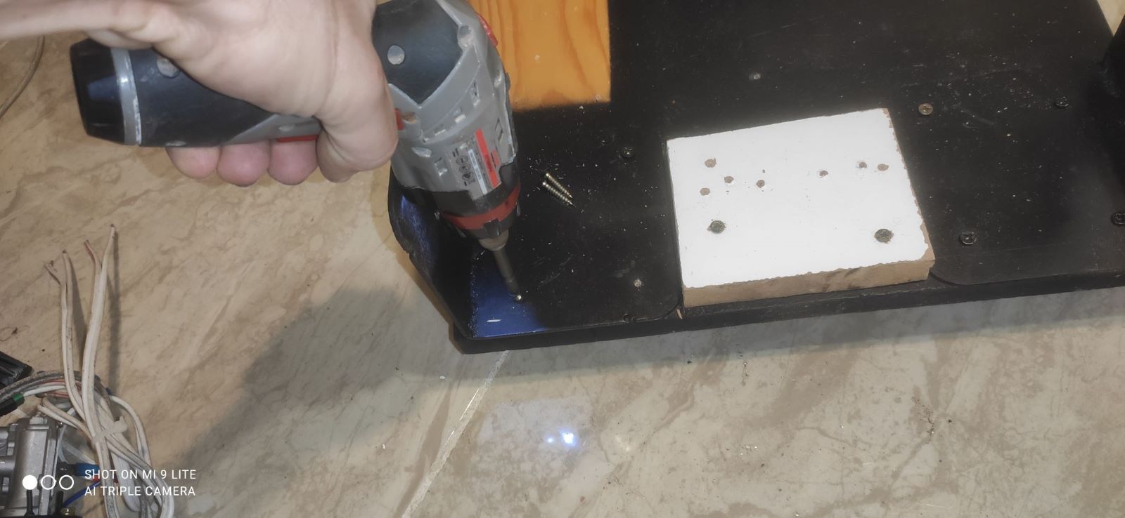

    B. Construction:

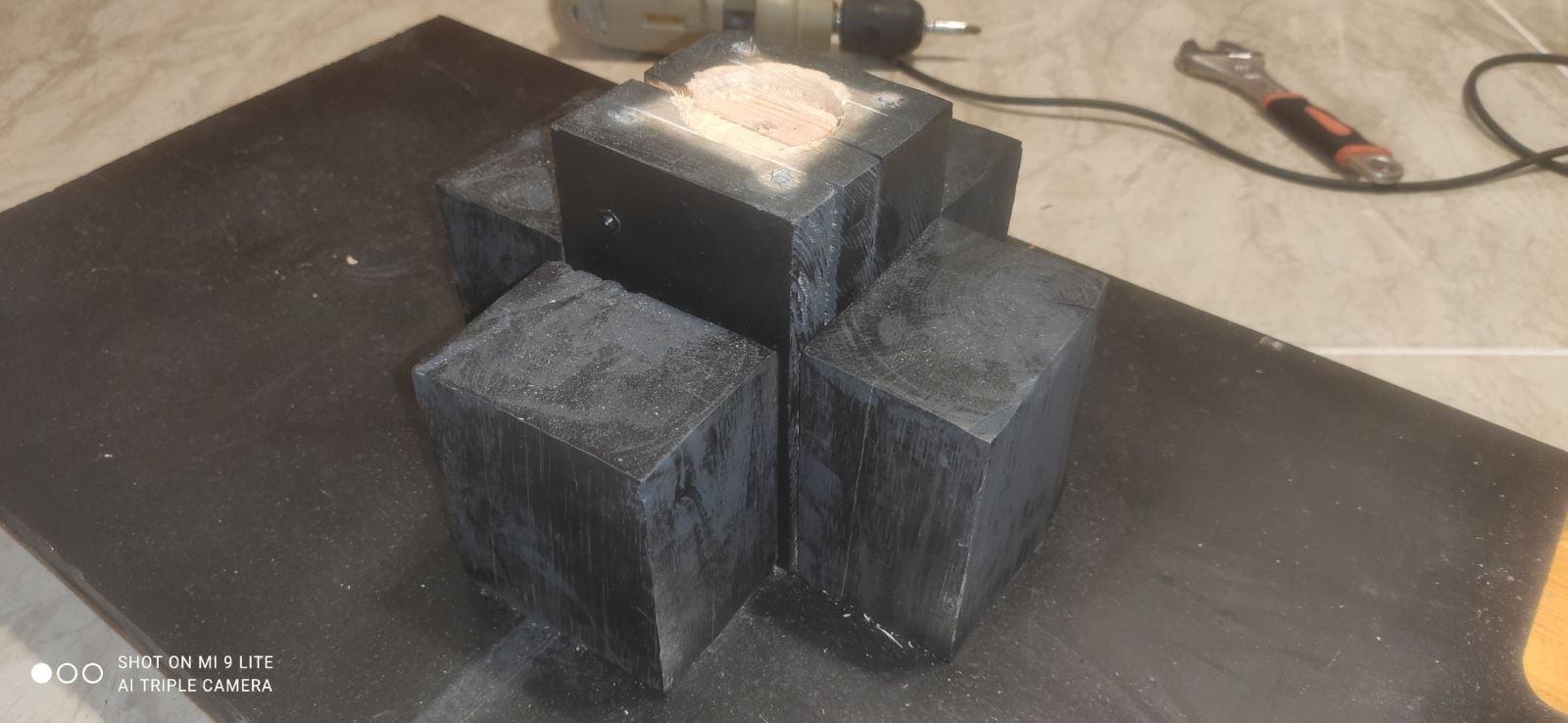

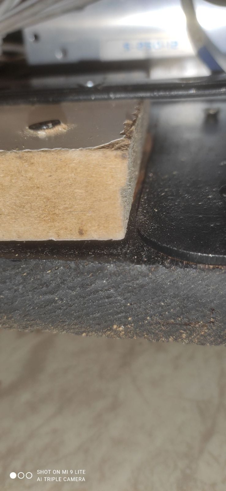

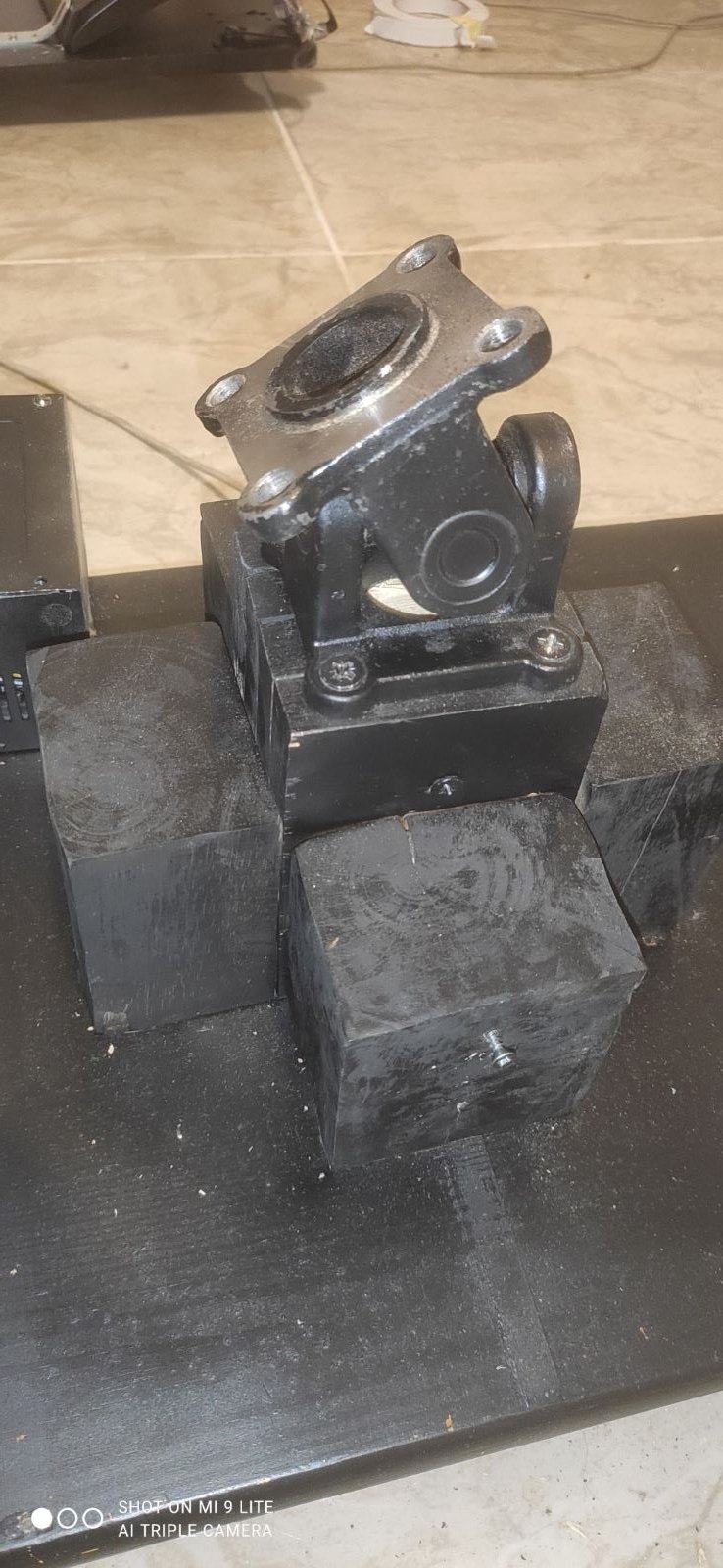

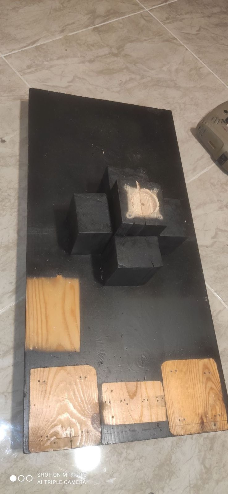

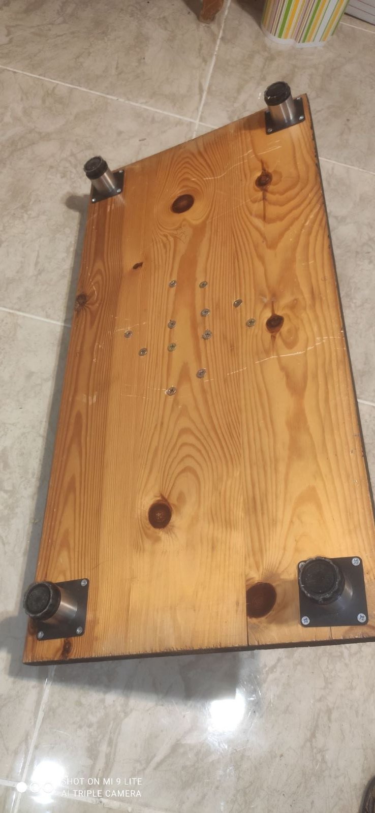

    1. The basis:

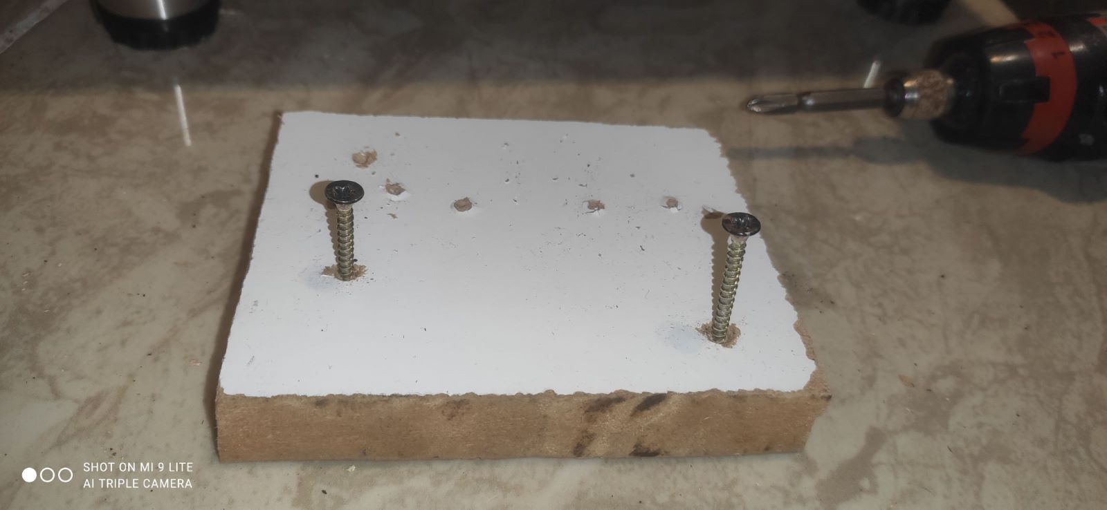

    A wooden plate on which are fixed blocks (wooden), to reinforce the attachment of the gimbal. Use of large screws to solidify the gimbal that will be well solicited

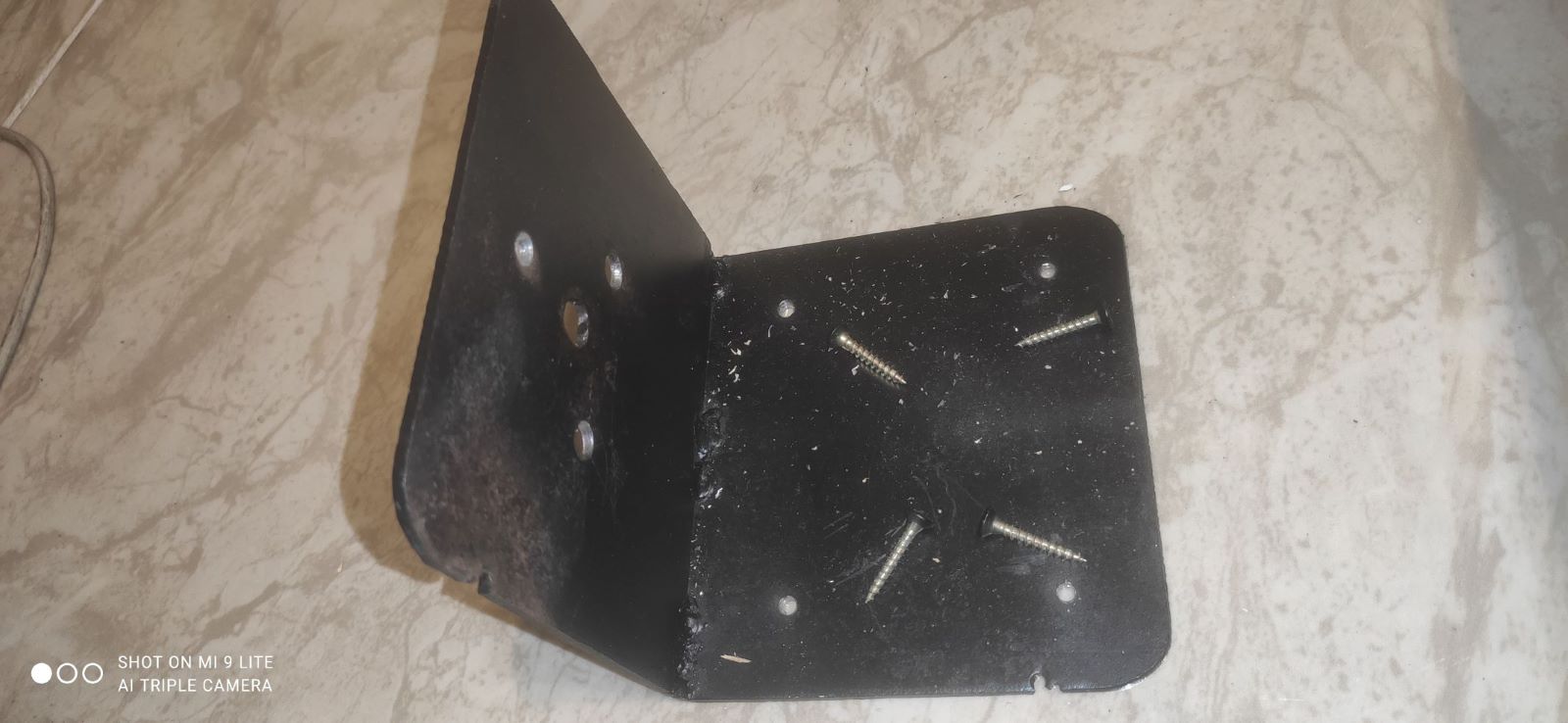

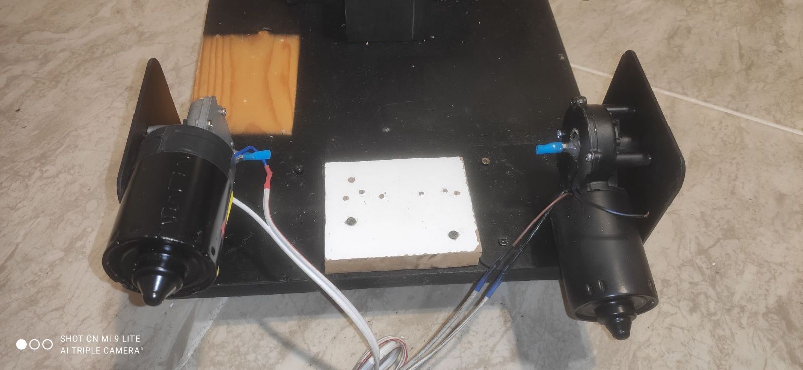

    The motor mounts are fixed like this:

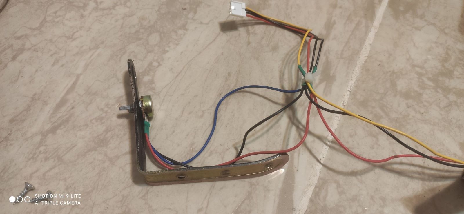

    A support for potentiometers, make sure that there is no contact between the potentiometer holders and the motor mounts to avoid disturbances from movements

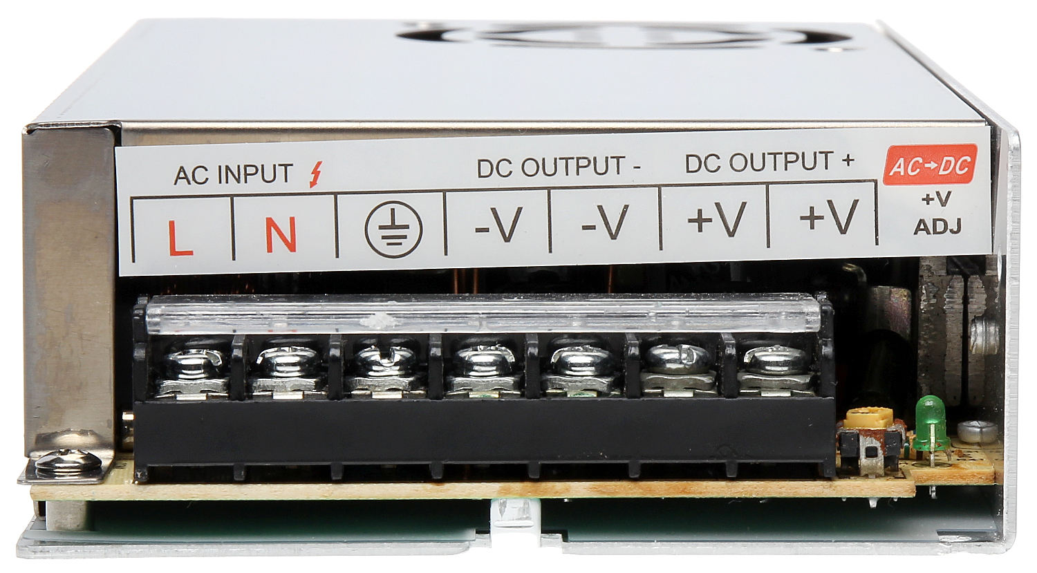

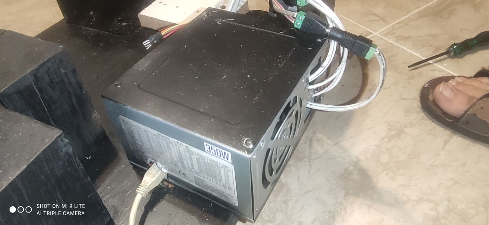

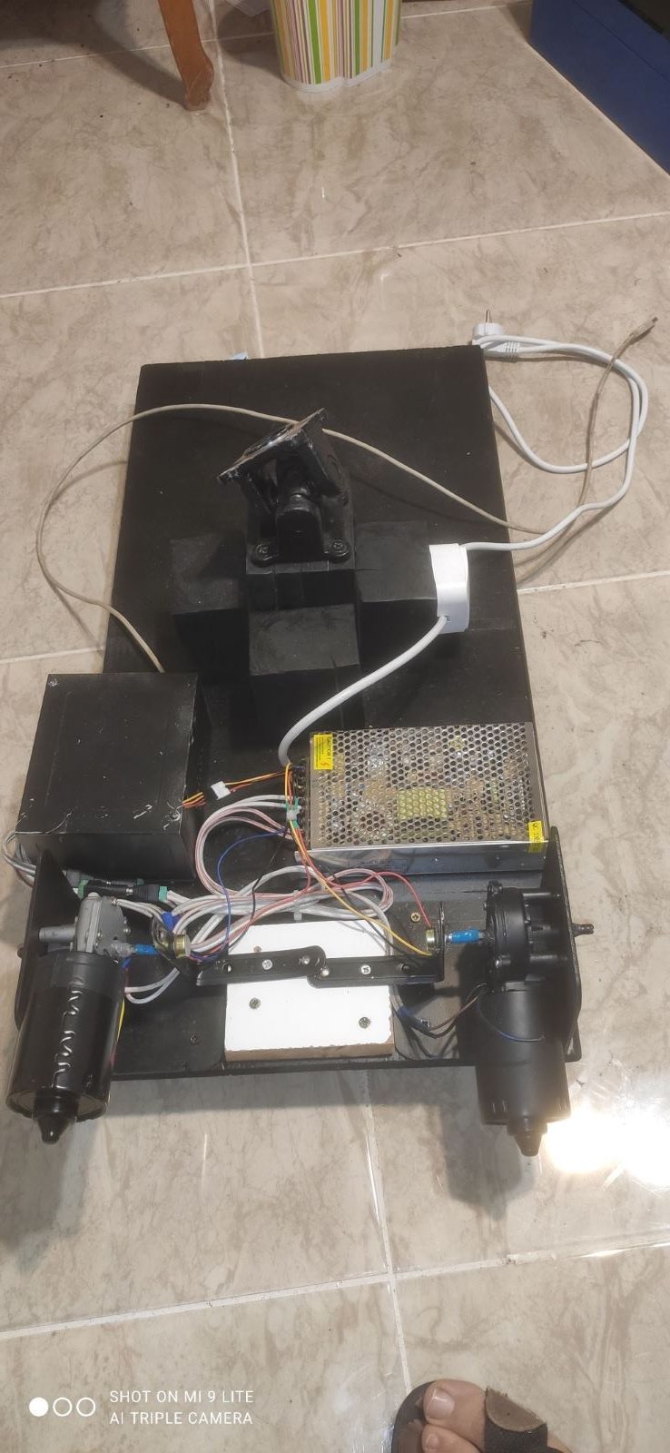

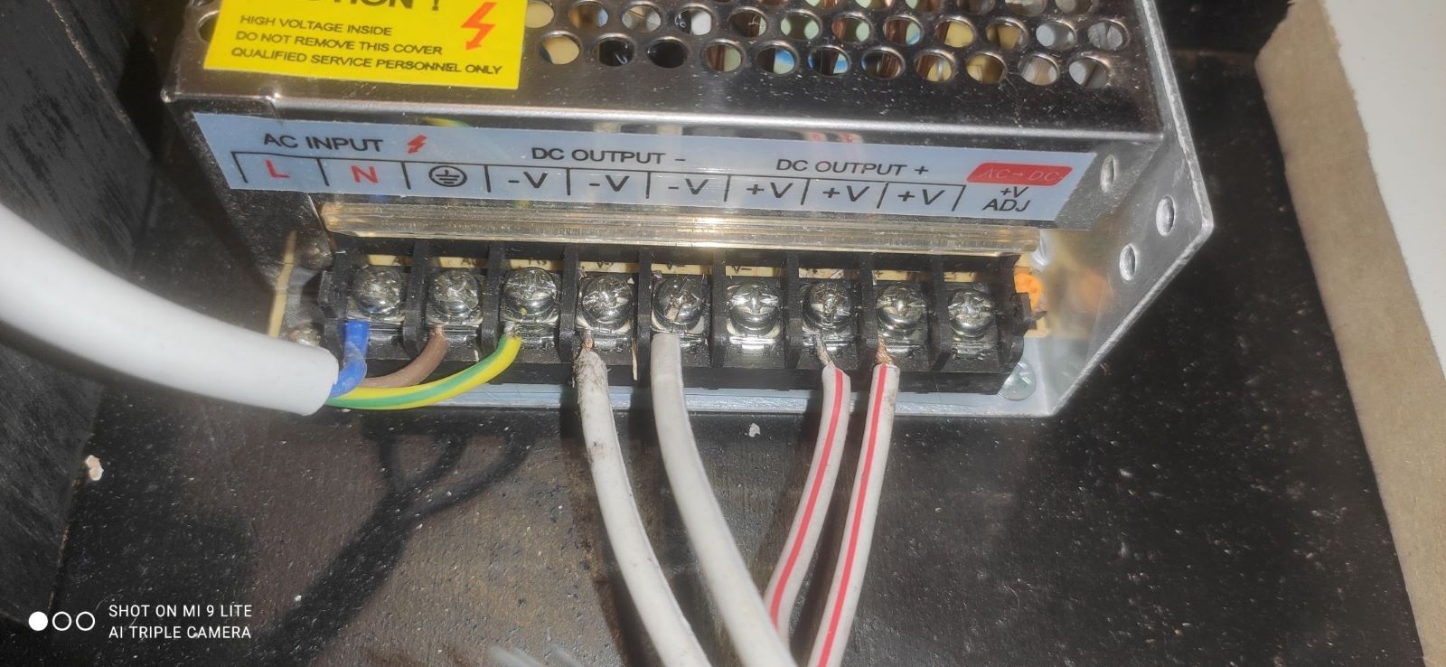

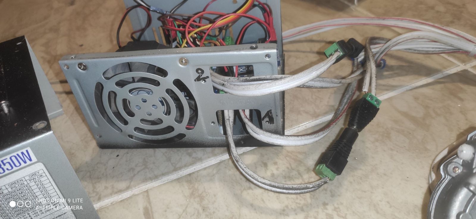

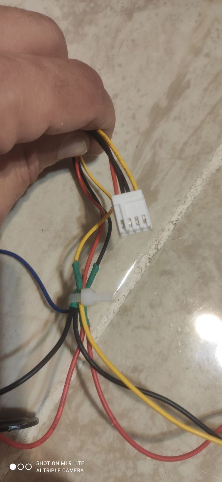

    All the electronics are stored in a standard PC power supply box, in output we find only
    - The connector for the 2 potentiometers
    - Power connections in the 2 motor schield
    - Motor connections in the 2 motor schield
    IMG_20220114_194742.jpg IMG_20220114_194757.jpg IMG_20220114_200028.jpg IMG_20220114_194400.jpg

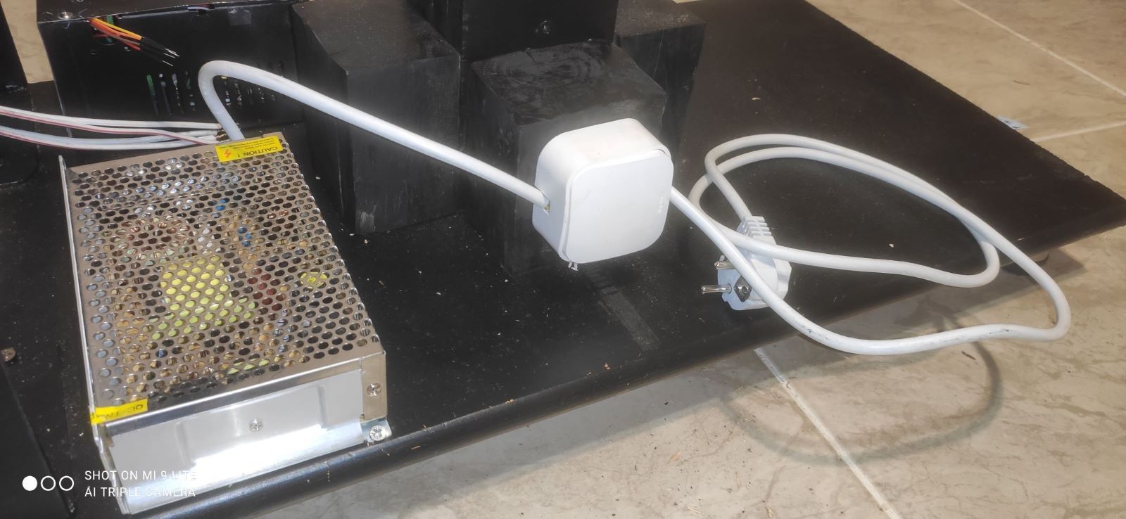

    Fixing the power supply in the base, adding a switch for emergency stops

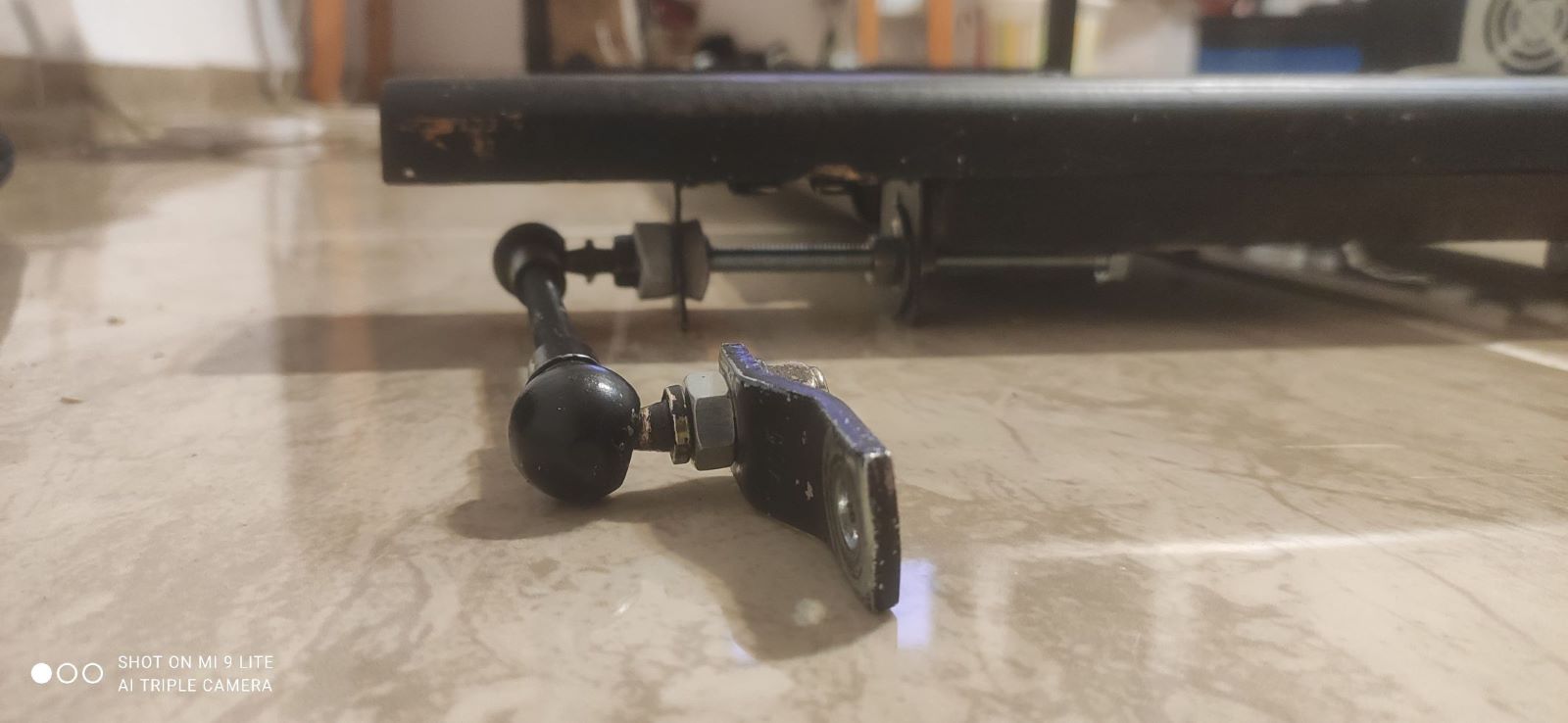

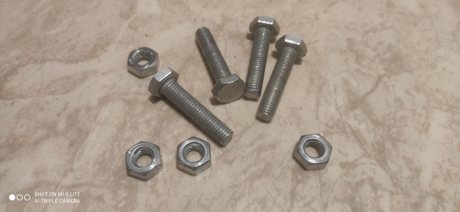

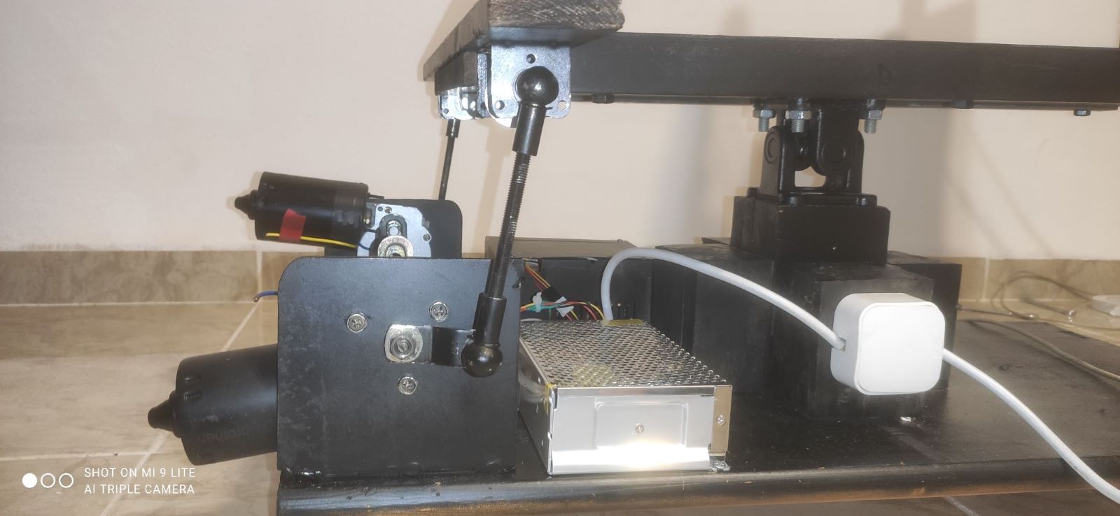

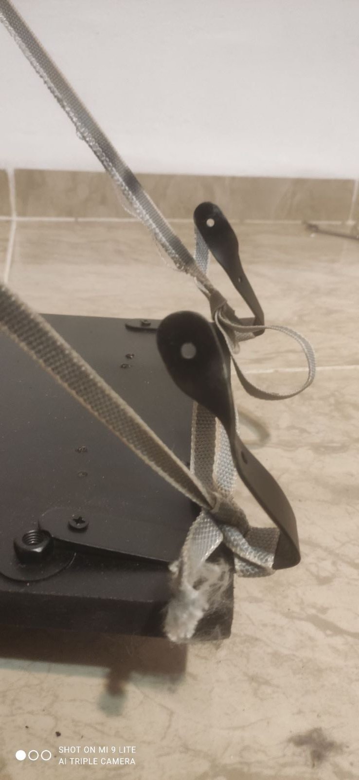

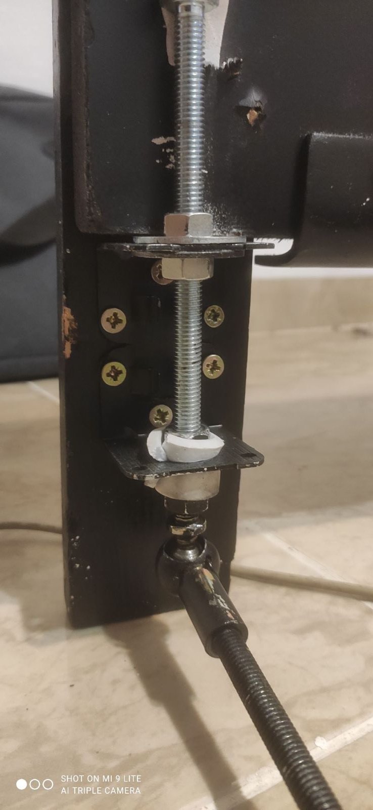

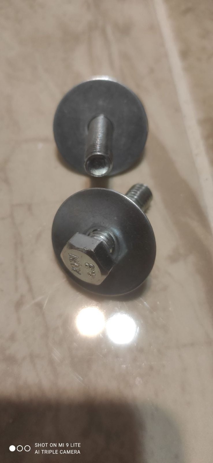

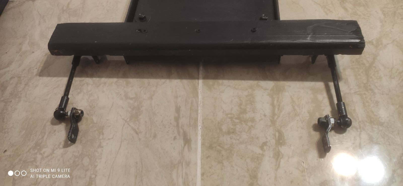

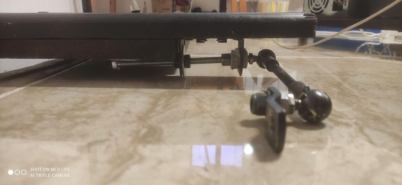

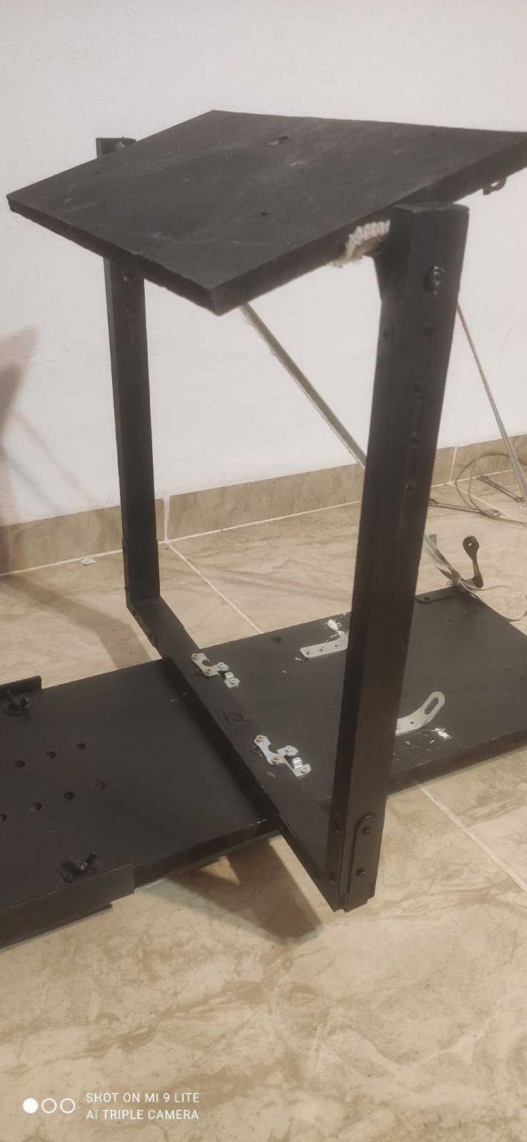

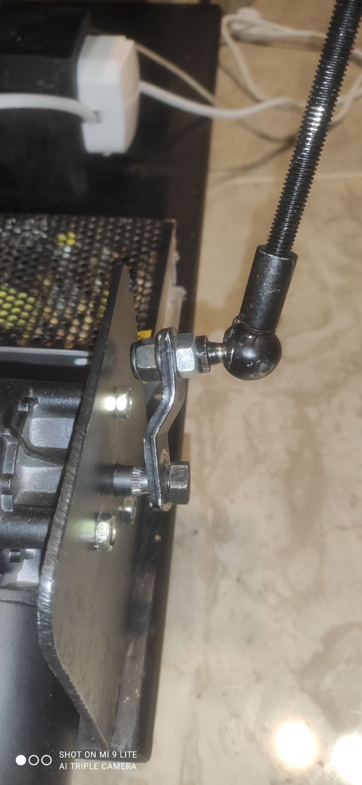

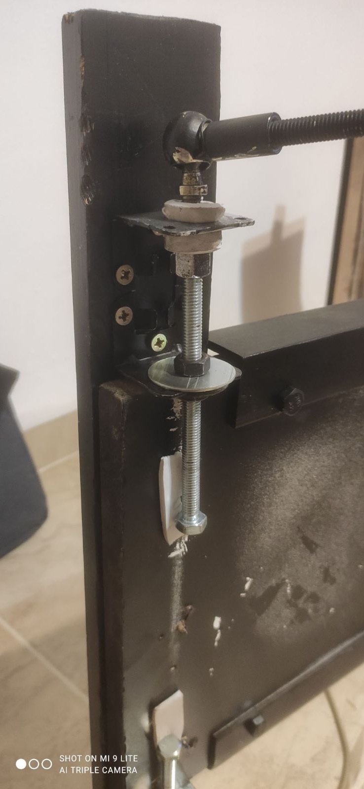

    The connecting rod system, made from
    - 2 long bolts & 2 threaded rods
    - Angle brackets
    - 6 nuts, 2 brake nuts
    - 2 nut connection
    - 4 Metal ball joints
    - 2 motor metal arm (delivered with the motors)
    IMG_20220114_193108.jpg IMG_20220114_193116.jpg IMG_20220114_193206.jpg IMG_20220114_193215.jpg IMG_20220114_193218.jpg
    Completely adjustable according to the width of the main board on which the seat is fixed.

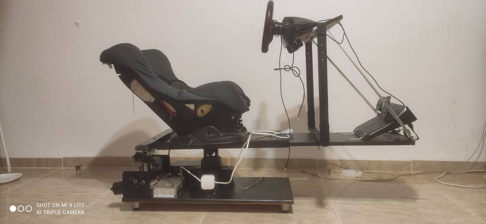

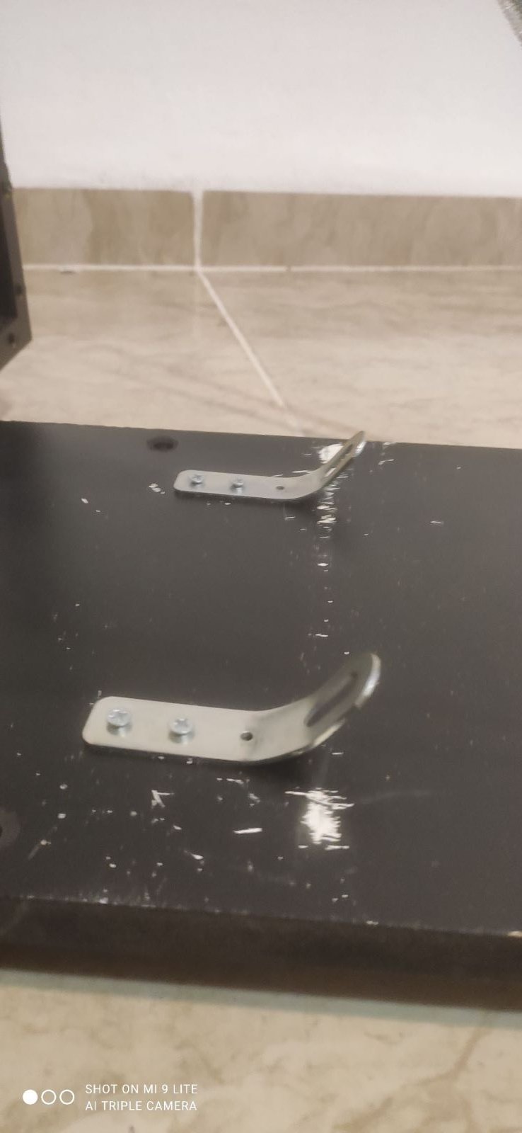

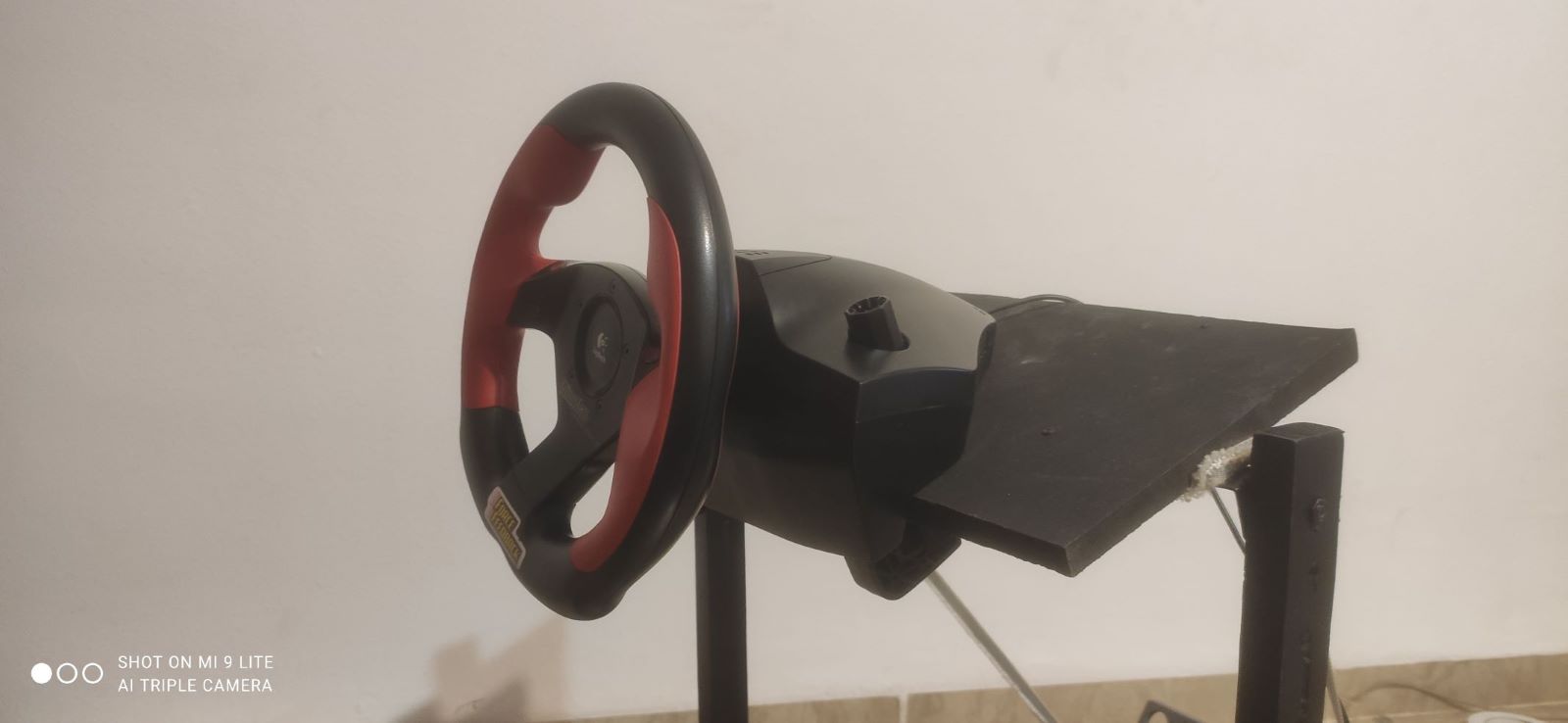

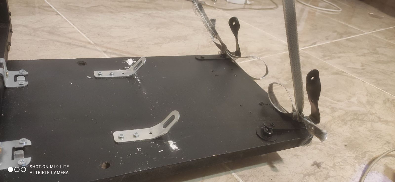

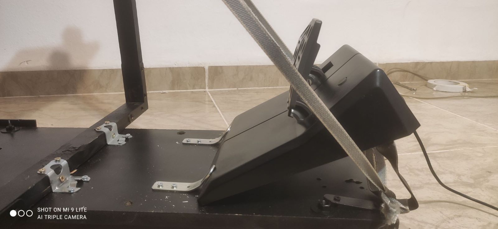

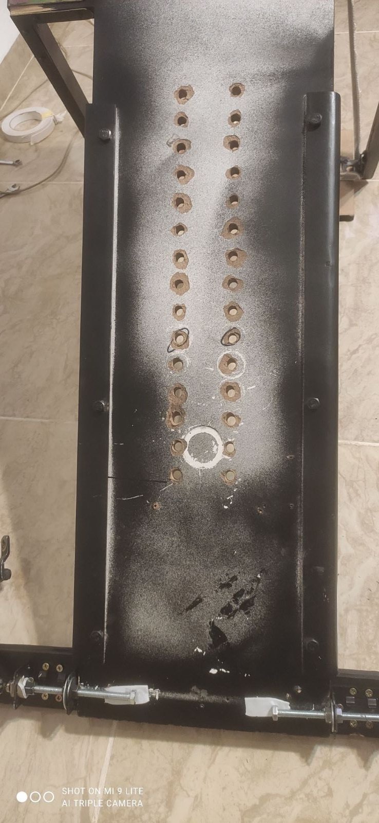

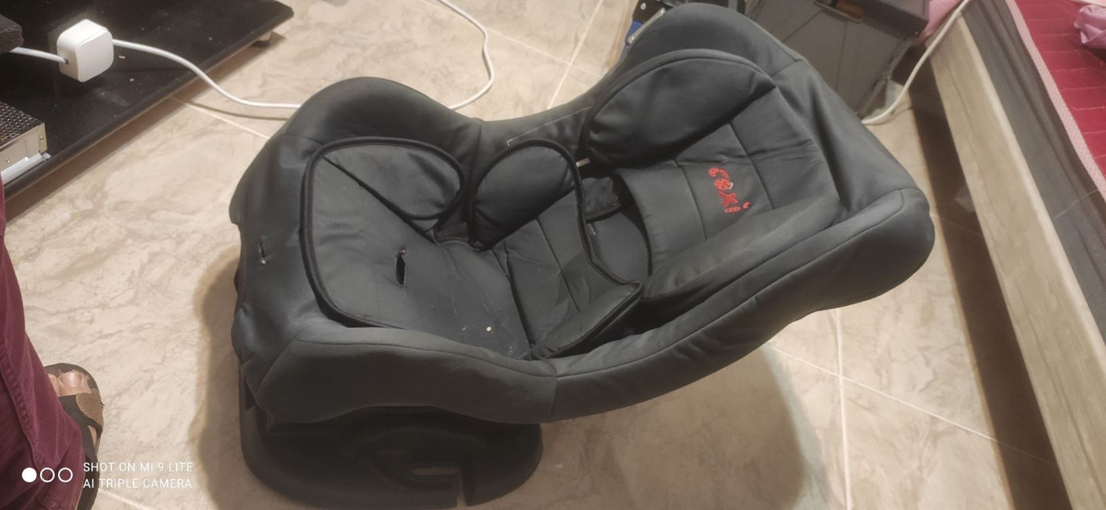

    2. The seat, steering wheel and pedals

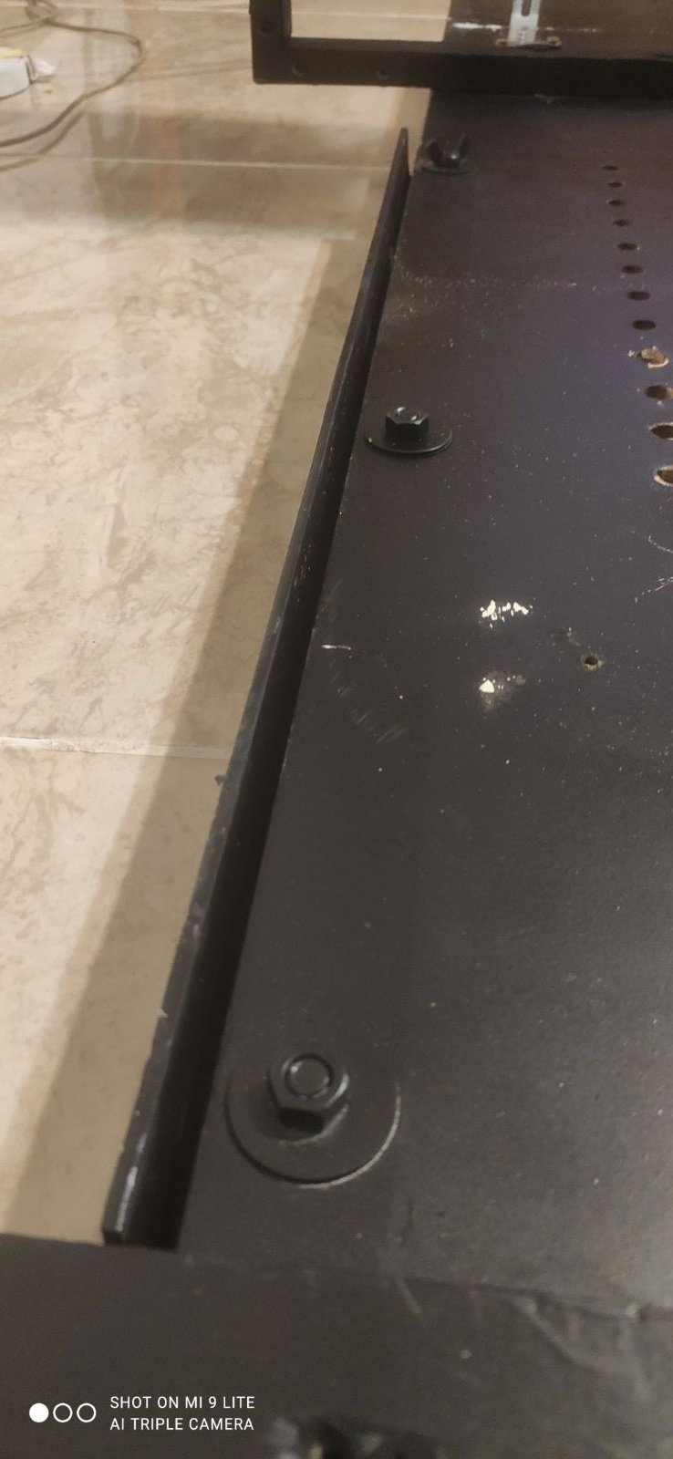

    A long board is used to fix the elements, reinforced by 2 metal angles on the side edges, to avoid bending due to weight and movement.
    Several holes are used to adapt the seat position to the center of gravity once seated.
    The steering wheel and pedals are fixed like this:
    IMG_20220114_193317.jpg IMG_20220114_193321.jpg IMG_20220114_193331.jpg IMG_20220114_193351.jpg IMG_20220114_193400.jpg IMG_20220114_193402.jpg IMG_20220114_193453.jpg IMG_20220114_193517.jpg
    Finally, the system is attached to the gimbal and to the two motors; the whole system is securely tightened by nuts.
    IMG_20220114_201847.jpg IMG_20220114_202043.jpg IMG_20220114_202258.jpg IMG_20220114_202713.jpg

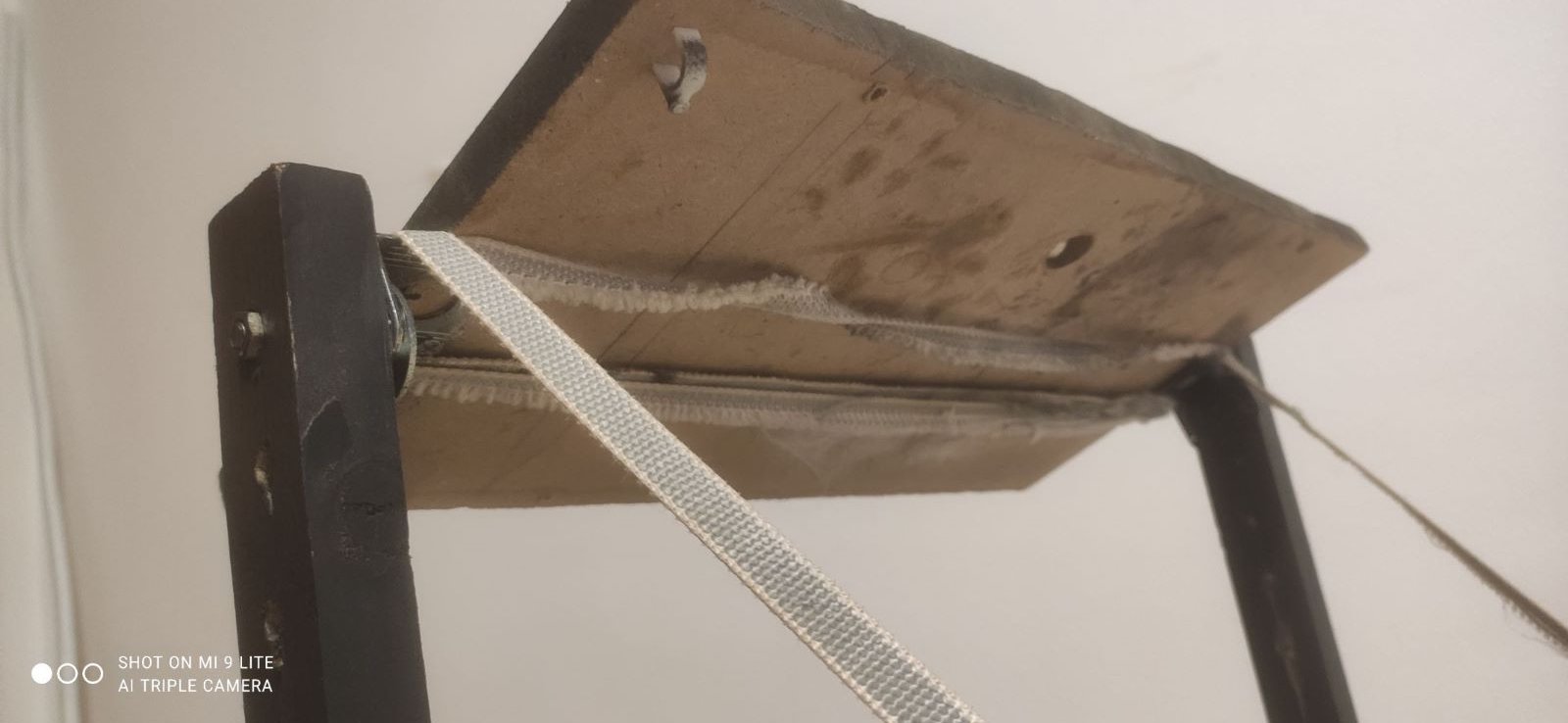

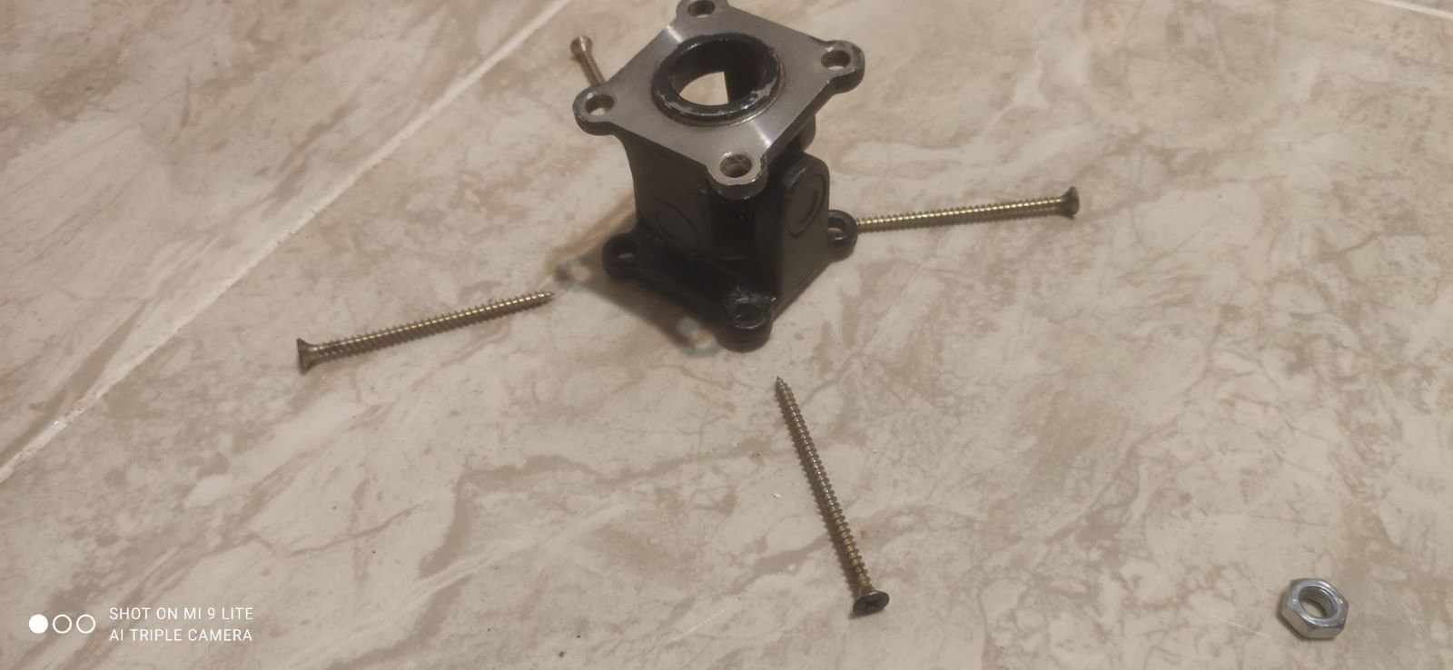

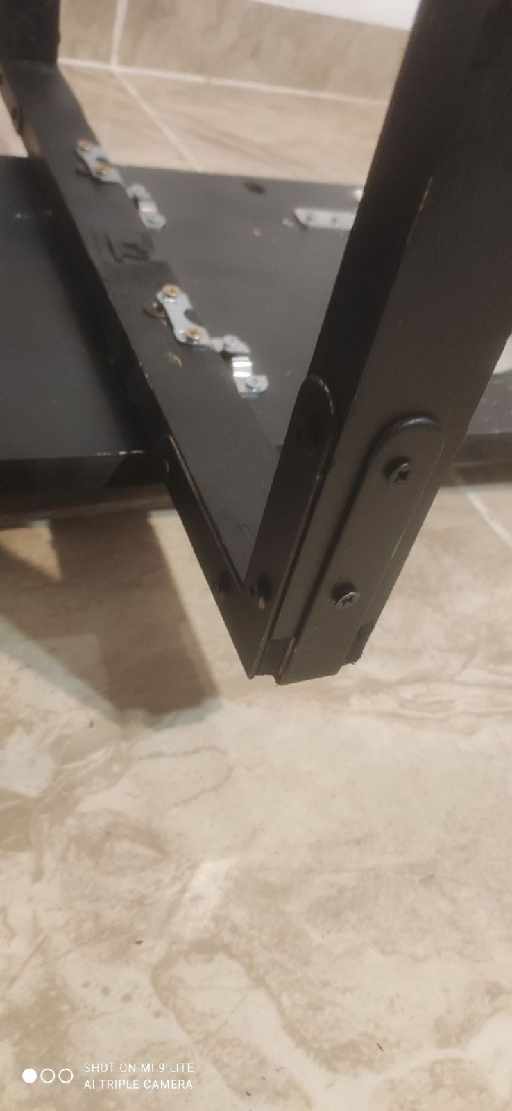

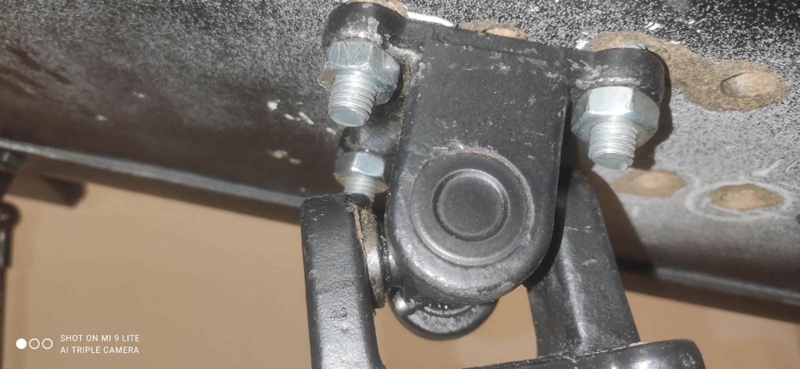

    It may be the camera angle but there seems to be torsional twist, what did you use as a universal joint?
    If there is torsional twist a panhard rod between the top and bottom frames can help control it.

    I would like to replay about the torsion twist problem, do you habe any suggestion to how can i eliminate it, using panhard rod or other things, it will be better with diagram, and what are the parts needed ?
    Many thanks in advance,
    Tayeb,
    21,592
    151,215Coins
    That looks to be a decent size uni joint you have used, so I am guessing it is the mount for the uni joint or perhaps the frame that is twisting?
    Panhard Rods run diagonally across between a top and bottom frame, with rose or heim joints either end, but may not help if the pivot base or frame is twisting, as a beefy uni joint does the same thing in terms of preventing lateral twisting.
