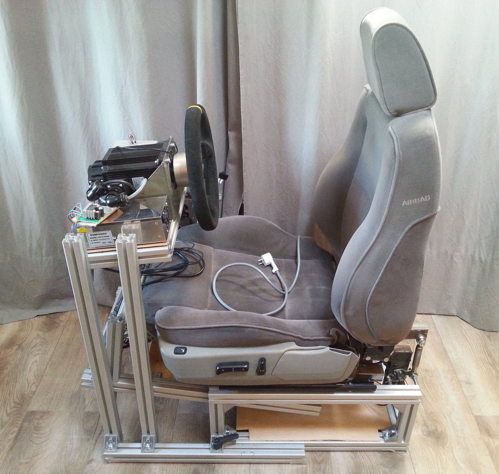

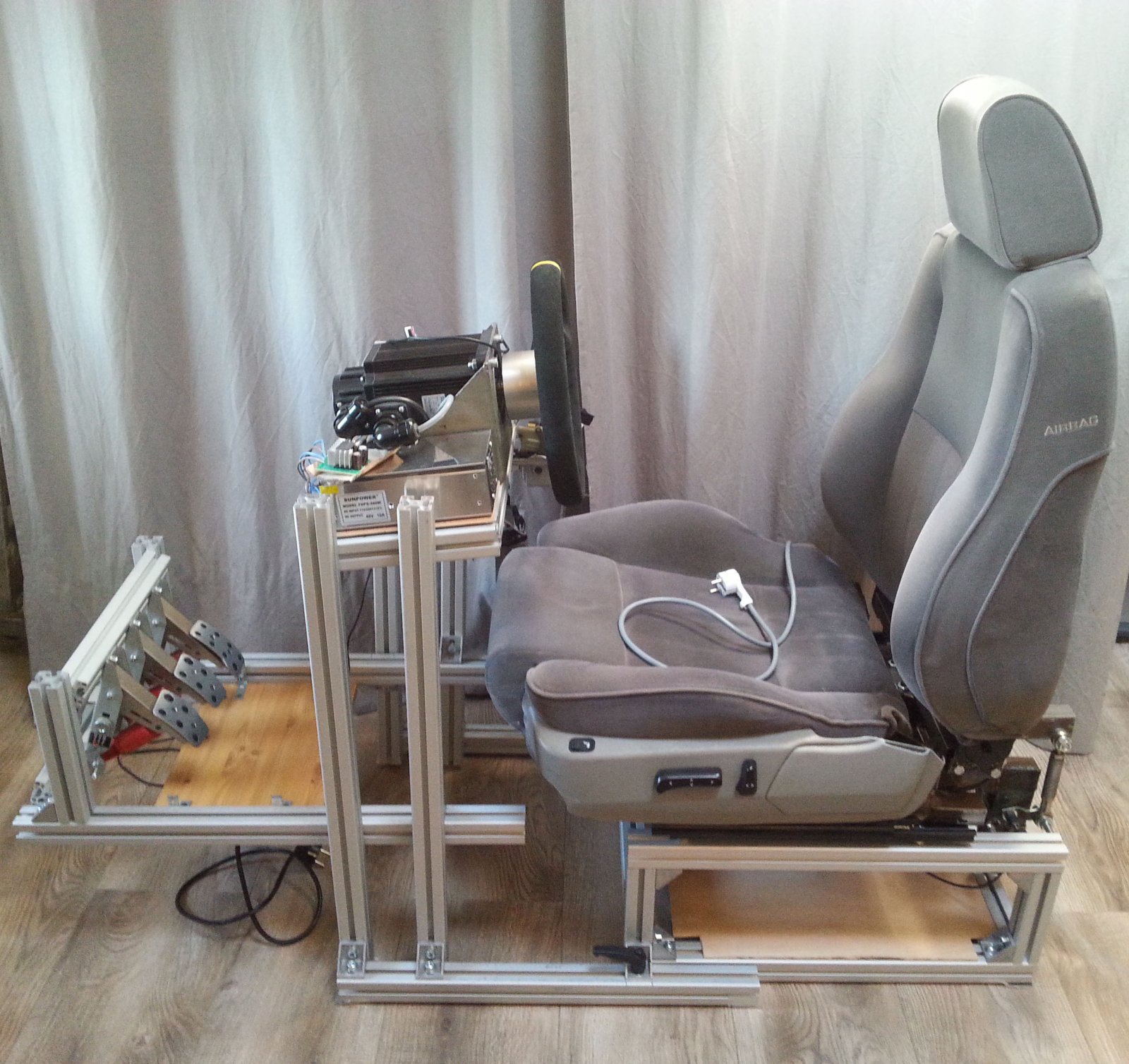

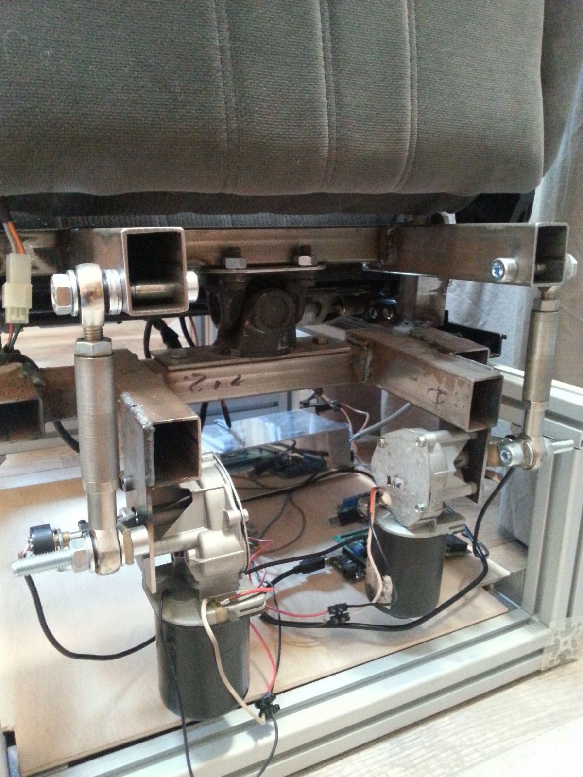

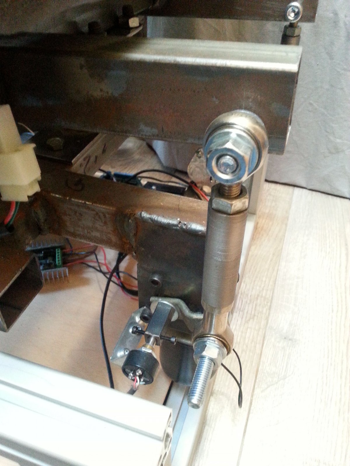

    I will present my simulator which is still in the prototype stage because I do not know if it 2DOF concept will satisfy me.
    The principle of this simulator is simple, I simply articulate the folder instead of the complete seat.
    I use wiper motors, AMC 1280USB and Sabertooth.
    Here are a few photos is better than a long discourses

    Nice work there @Vboull, the slide away pedal tray is really neat :thumbs
    It would be great if you could also detail information about your wheel, shifter and handbrake, as there are many members here who are very interested in DIT peripherals.

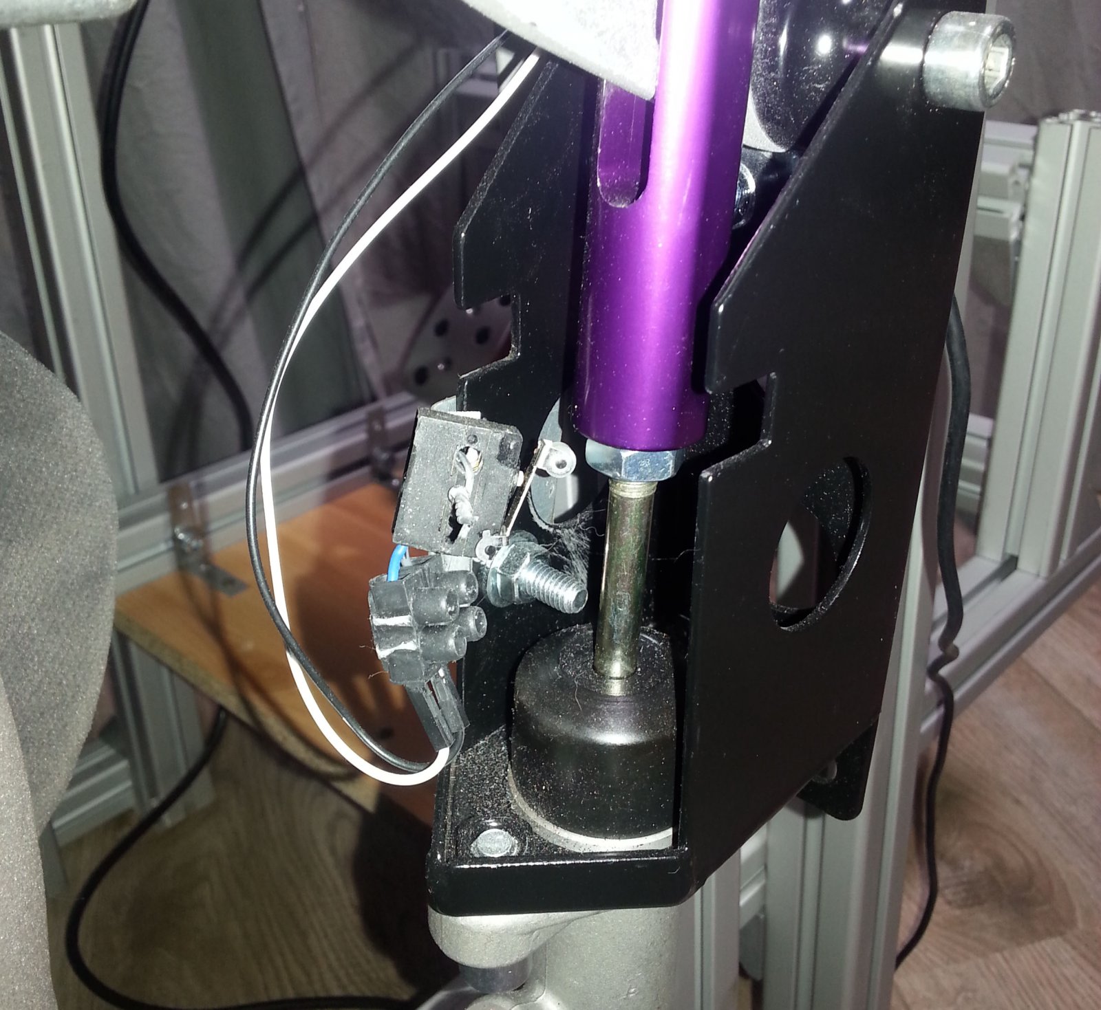

    My wheel is the same as that on this tutorial : RFR steering wheel - direct drive by RacingMat (sorry i can't post link)
    For the handbrake I use that, it is not perfect but it works well in the meantime

    DC motor, Arduino
    Sympathique réalisation très bien pensée !
    Quel est le modèle des moteurs utilisés ?
    Merci.

    I found these motor on Renault vehicles.
    The motor is brand Valeo
