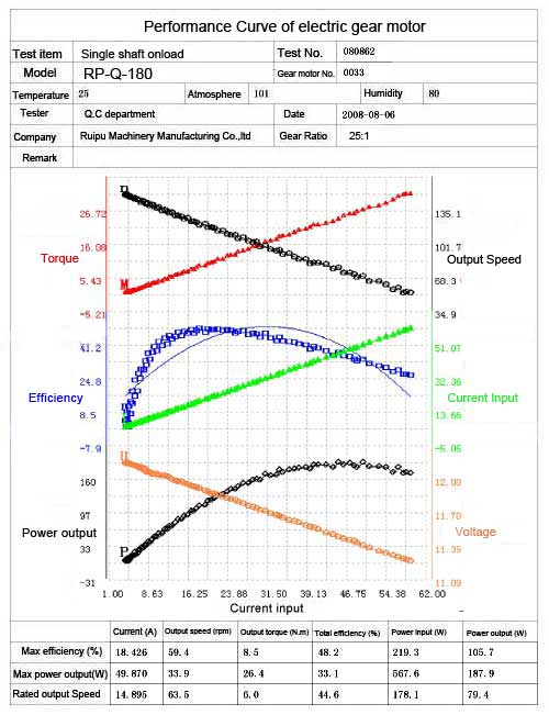

    It looks like i am still stuck with motor option.
    please have a look to this motor, specification is :
    Voltage : 12v
    Gear Ratio : 25:1
    Free load current : 1.7 A - 1.8A
    Torque : 30 - 45 N.m
    Net weight : 2.3kg
    Power : 180W
    Output speed 150 - 160rpm
    onload current : 9-12A
    Shaft diameter : 12.5 mm
    and price is $29.80 (still waiting confirmation for MoQ+Shipping)

  7. DonCorleonez
    DonCorleonez Member
    Mar 14, 2009
    80
    195Coins
    +15 / 0 / -0
    this is performance sheet, need your comment. This must be related to what kinds of electronic that match.
  8. RacingMat
    2,237
    21,028Coins
    it looks good but... Min.Order Quantity: 50 Pieces

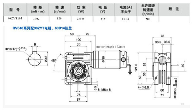

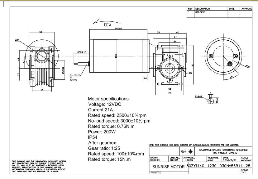

    Let me summarise my finding so far, the price is for minimum 1pcs purchase:
    1. 90ZYT105+with+NMRV40, $65.54 per pieces excl shipping (24V but can change to 12V) from http://m.alibaba.com/product/60123439708/12V-DC-Motors-worm-gear-motor.html
    2. RPQ180, $29.80 per pieces excl Shipping 1yr Guarantee
    http://ruipuco.en.alibaba.com/produ....html?spm=a2700.7803228.1998738836.138.T7EUUl
    3. 80ZYT140-1230-030NV56B14-25, $73USD per pieces excl Shipping (price for 1-10pcs)
    http://meisang.en.alibaba.com/produ...ECTRIC_MOTOR_BRUSHED_MOTOR_80ZYT140_4838.html

  11. Nick Moxley
    17,056Coins
    +2,506 / 30 / -2
    #4
    Min.Order Quantity:100 Unit/Units
    #3
    Min.Order Quantity:20 Piece/Pieces
    #2
    Min.Order Quantity:50 Piece/Pieces

    Thanks @Nick Moxley for comment, i am sorry forget to state that all the price is agreed for minimal 1 pcs of purchase.
    So what do you think the best value (quality/performance + price)?
