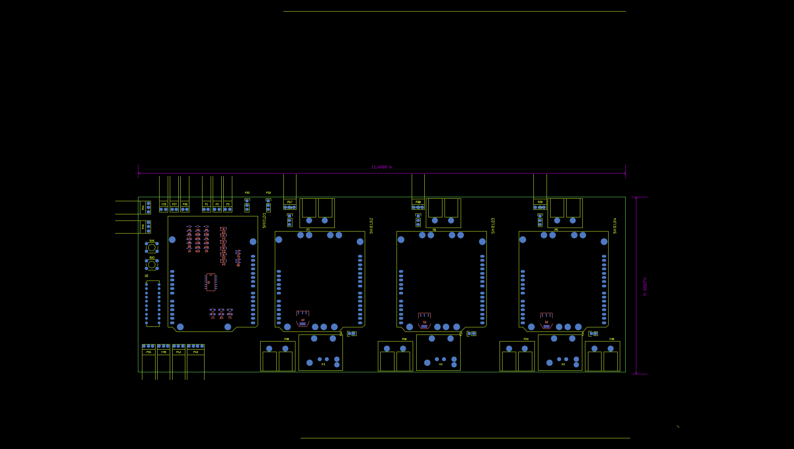

    Some more progress updates. I've taken a page out of another sim's book, and decided to make an interfacing PCB to manage the connections between the Arduino and the MMs (I saw someone else do it on here with smaller driver boards, but can't remember the thread, so I can't credit the user unfortunately :oops:). Aside from taking the signals from the arduino to the drivers, it's also going to have integrated mounting points to secure heatsinks, relays to shut motors down in the event of overheating/to reduce the constant motor coil whine when not using them, and an MSP430 microcontroller managing all of the external extras so that the Uno can focus all of its processing power on running the PID loop. The final board should be about 11.5''x4'', have mounting space for one arduino uno and 3 MM shields, and be able to screw into standard motherboard mounting holes inside of a PC case. I'm finalizing the schematic right now, and would appreciate it if any other electrical guys on here would mind giving the PDF schematic attached a quick look over to make sure I haven't make any terrible mistakes (I'm not too worried, but it's always a good thing to get another set of eyes on a project).
    Once I've ordered/tested PCBs to make sure they work properly, I'll upload the gerber files for anyone to use if they want them. On another tangent, does anyone here have experience with CY Industrial PCBs? They seem to offer 3oz copper boards for ridiculously cheap (I'm sure there's a catch somehow, it is China so you do have to be wary). I could go down to 2oz copper for the board, but seeing as it'll be running 30 amps per MM I'd rather have too much copper than too little.

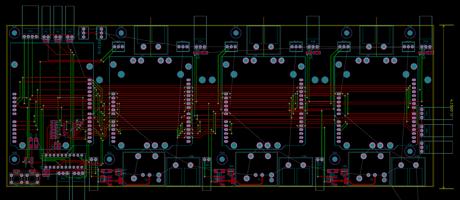

    Board is maybe 30% routed, the most time consuming part is done I think.

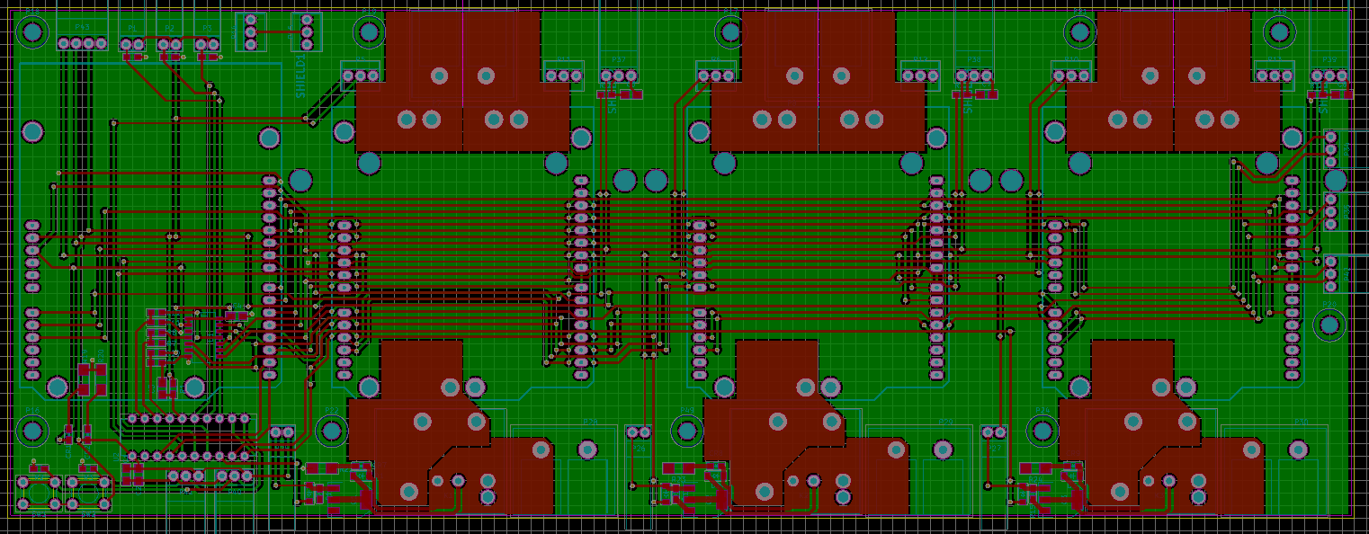

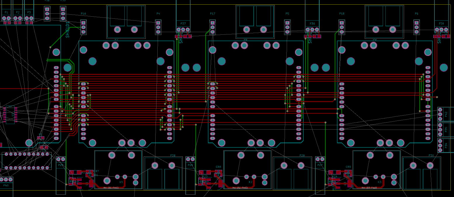

    More progress. I've completely finished routing the signal portion of the board, and added mounting holes as well. Unfortunately I wasn't able to make the board size work nicely with standard ATX motherboard mounts like I originally wanted to, the dimensions are just too odd. All that's left now is grounding, copper pours for the high-current traces, and a proper silkscreen. Something else I wanted to get some opinions on is whether or not it would be worthwhile also designing a through hole only board, as I don't really know how comfortable most sim builders are with soldering small SMD components. I'm planning on just using solid core house wiring (14-16AWG?) to connect the MMs to the PCB. I looked into machined pins, but they were just too expensive/not conductive enough to justify the cost. Both the arduino and the MMs will be seated using the standard row-headers, allowing them to be easily removed when an MM inevitably breaks.

    I use 14gauge stranded for my motos. Solid wire is harder to work with and is more susceptible to breakage.
    I'm surprised you chose to route the 12volt thru your board. That's a lot of power in some instances. Peaks over 50amps depending on system.

    It is a very high amount of current, but this was the easiest way to keep the wiring with the shutdown relays to a minimum. I'll do my due diligence and test everything, but I think I'll be able to make it work. The board will have thicker copper than most PCBs (2oz or 3oz rather than 1oz), and the current only actually has to travel a very short distance through the PCB (from the barrier terminal to the relay, from the relay to the MM, and from the MM to the output terminal), so heat generated in the trace should be manageable if I'm careful with how I design the copper pours.

    Power planes are mostly done, just trying to come up with a workaround to some of Kicad's thermal relief settings:
