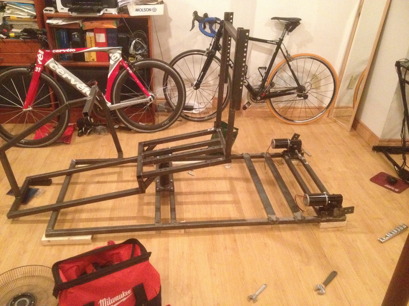

    Still waiting on the MMs sadly, they should be arriving within the week.
    I shortened the driveshaft supporting the frame a bit, to lower the center of gravity of the base frame as well as to stiffen it.

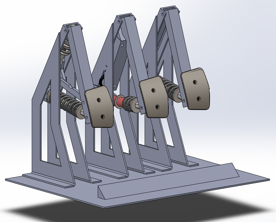

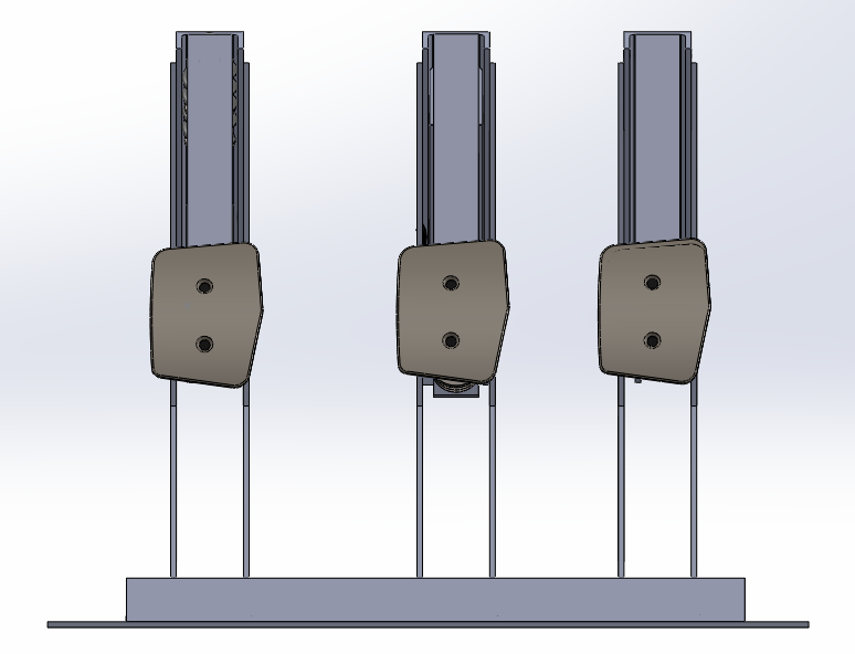

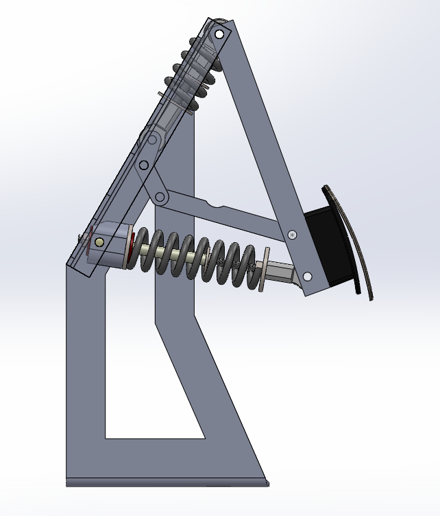

    I also made some progress on the pedal set that I've been slowly dreaming up a CAD model of. This probably won't happen for a while because construction will be very labor intensive and aluminium isn't cheap!
    Credit where credit is due, I took a few very clever tricks from MajorTinkers wooden pedal set:
    https://chippedwood.wordpress.com/2015/09/03/diy-hydraulic-load-cell-sim-racing-pedals/#more-206
    Most of the fab would ideally be done in aluminium for weight saving purposes (it does have to sit on the end of what is essentially a large lever arm on my sim).

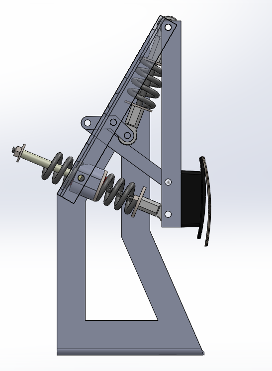

    The brake will use a load cell as the measurement element. A two stage spring consisting of a "pedal to pad" simulator, as well as urethane compression springs for a progressive feel.
    Nothing much special about the throttle

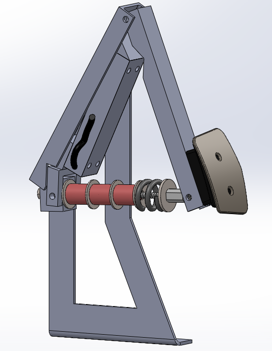

    The clutch has a two spring system to simulate the degressive "heavy at first, then lighter" feel that a normal clutch has. When the pedal is depressed, it rotates the cam that the secondary spring is attached to. This rotation causes an extension of the secondary spring, which acts to assist the motion of the pedal, and make it feel lighter the more it's pressed.
    I plan on adding oil dampers to each pedal, but was having some trouble sourcing ones. Has anyone had any experience with these kinds:
    http://www.ebay.ca/itm/Alloy-F-R-Sh...197653?hash=item280fa58555:g:~~8AAOSwwPhWloHP
    These RC shock absorbers are readily available, and about the right size, but I have no idea what kind of damping action they'll have.
    Ebay items never seem to have any actually useful specifications which annoys me to no end. Advice from anyone who's done pedals in the past would be greatly appreciated.

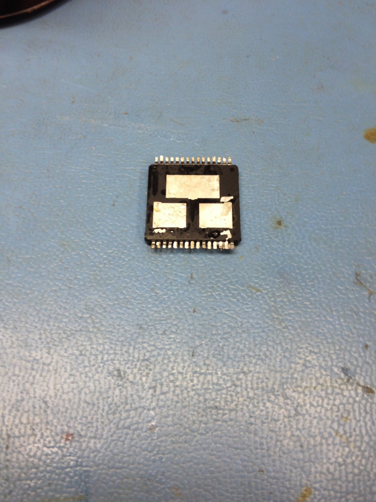

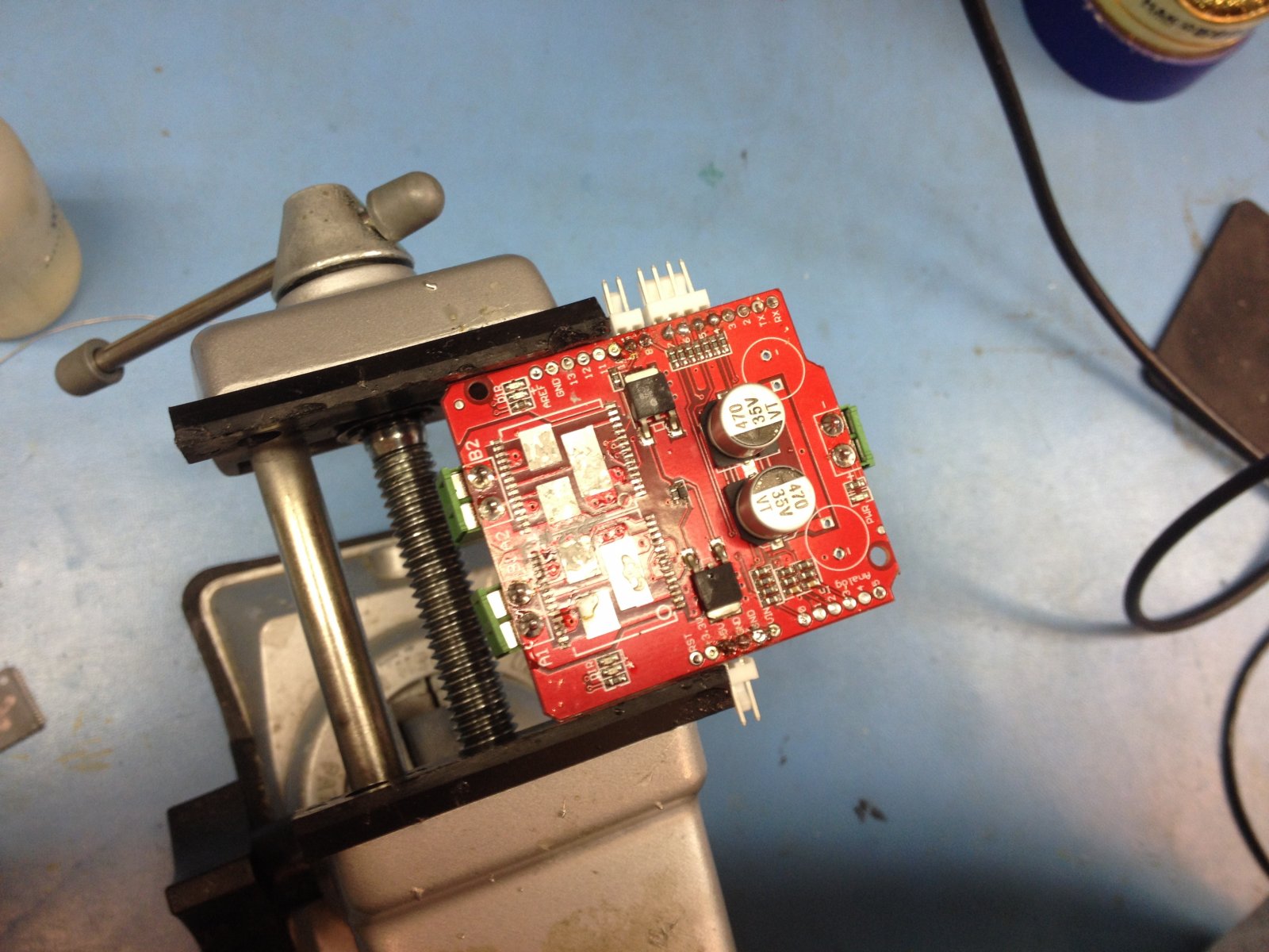

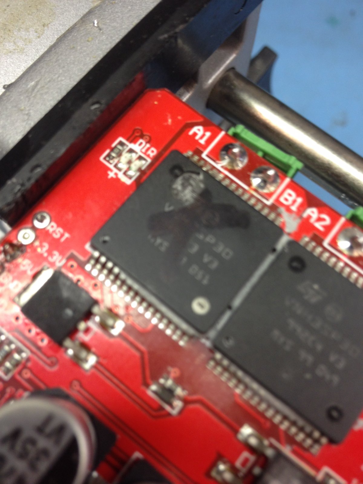

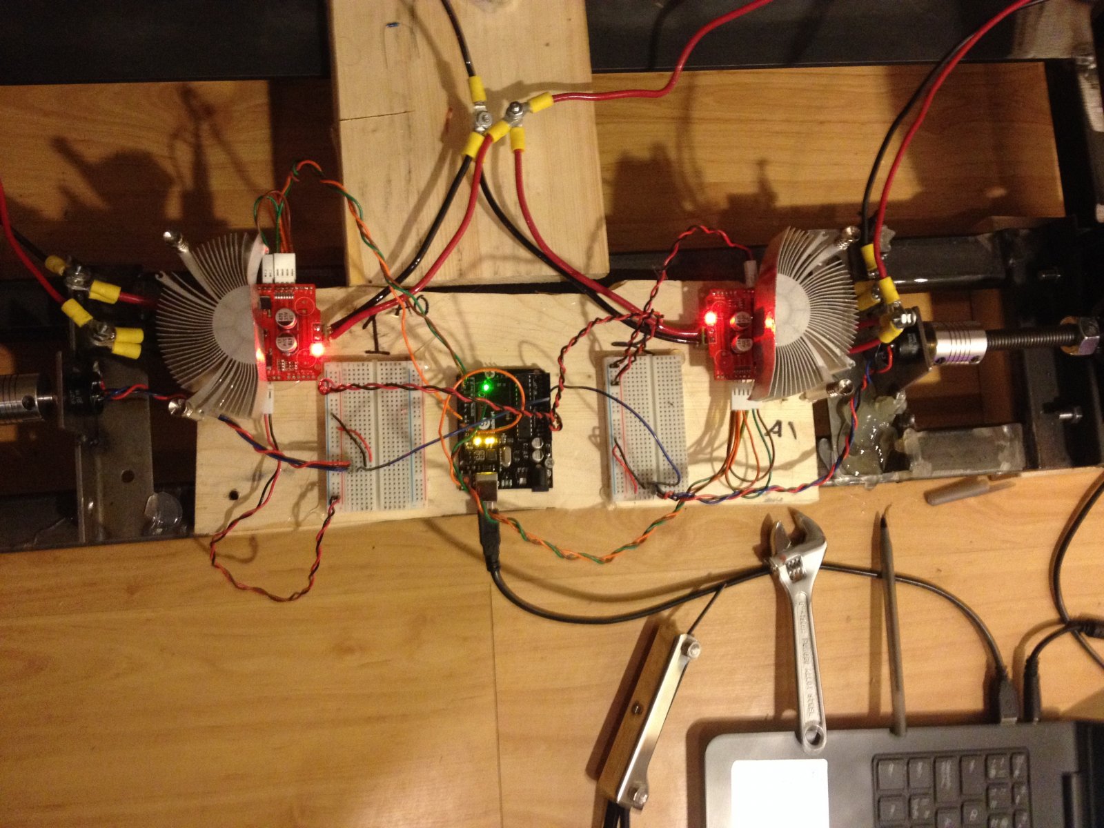

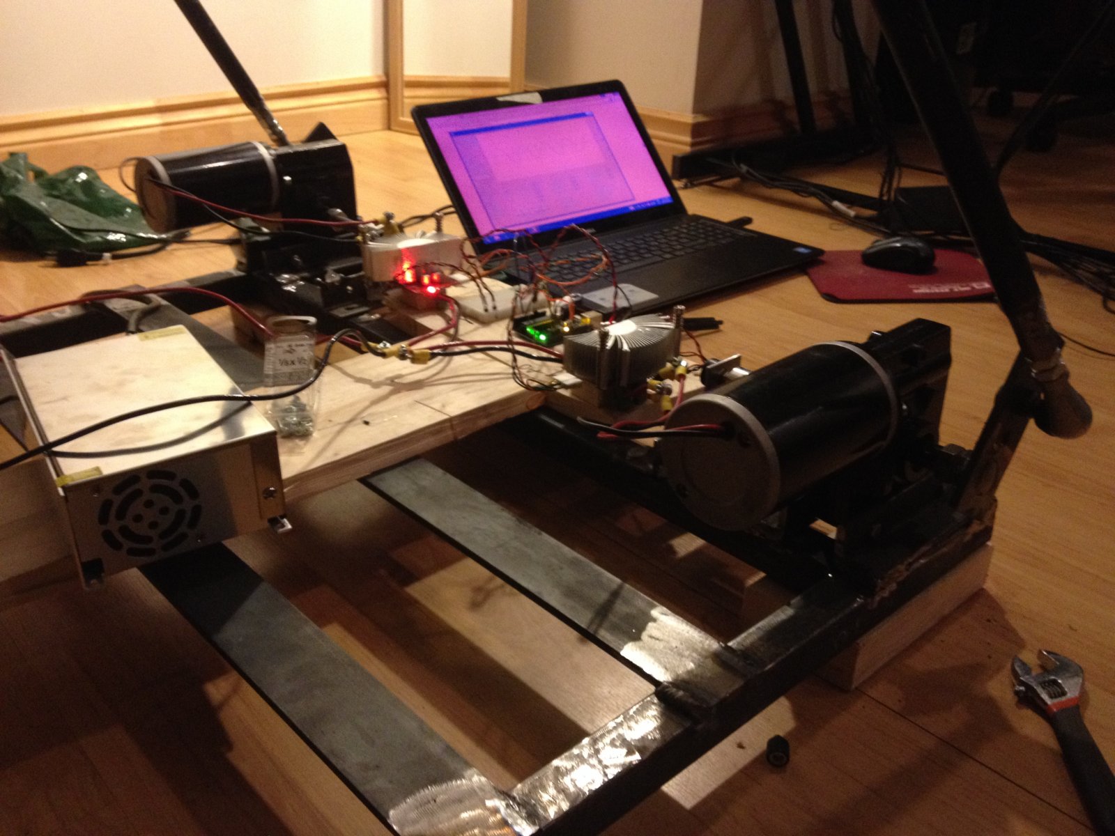

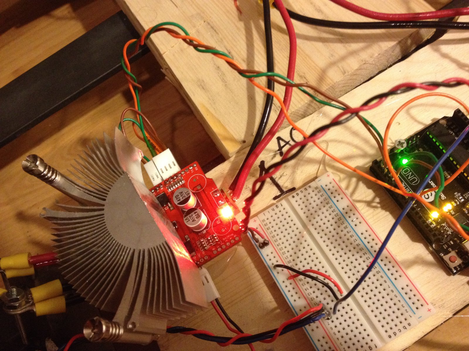

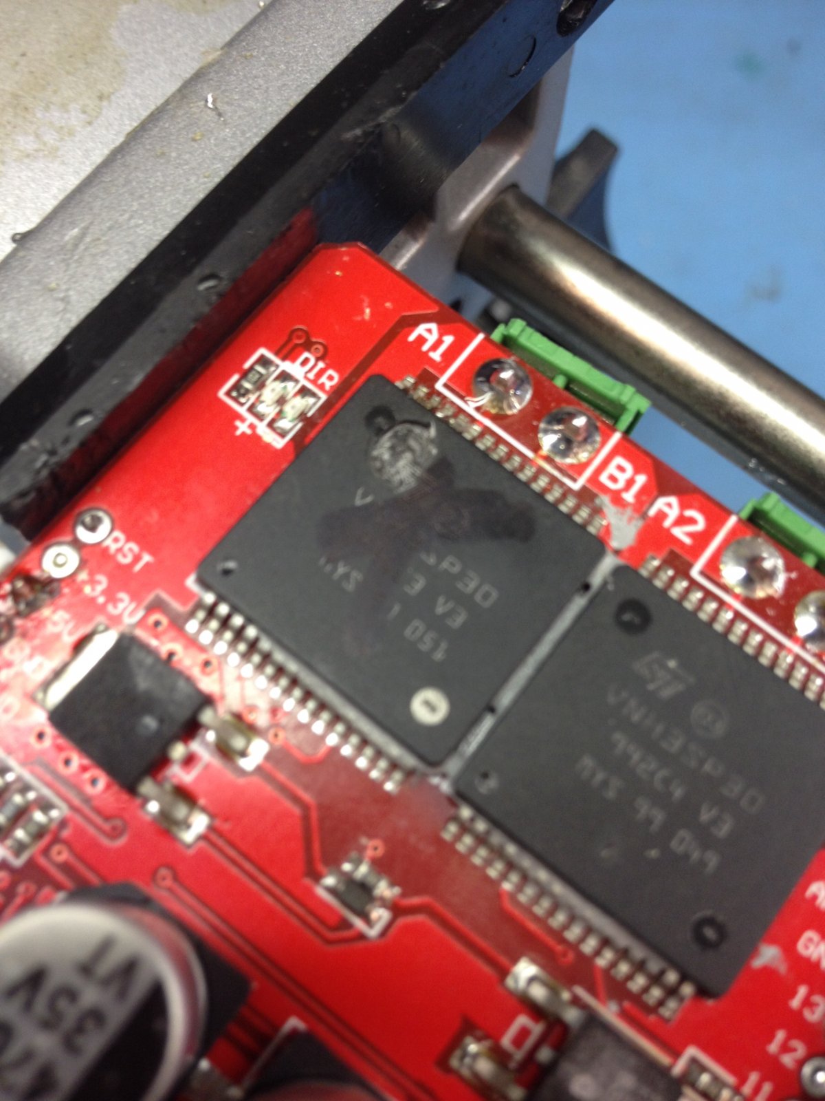

    I got sick of waiting on the slow boat (airplane in this case) from china, and decided to take matters into my own hands. I ordered two pin-compatible H bridge replacements for the motor drivers.
    http://www.digikey.ca/product-detail/en/stmicroelectronics/VNH2SP30TR-E/497-4501-1-ND/725672
    Now these ICs aren't like a normal SOP chip, you can't just use a normal soldering iron because they have these thermal pads on the bottom that act as heat slugs:
    Fortunately, I have access to a hot air rework station, which made quick work of them (you can see where the left chip exploded in the first picture):
    Interestingly enough, these chips actually failed because I short circuited them, and in each one the "high" side of the bridge was the one to fail. This is most likely because the high side switching MOSFET transistors are P-Channel, which always perform worse than an equivalent N-Channel. Nevertheless, I wanted to be sure that they'd work, so I replaced all 4 ICs.
    Two nervous tests later, I was glad to find that the replacements had succeeded!
    Here's a picture of my shameful wiring, I'll clean this up and put it in a project box in due time:

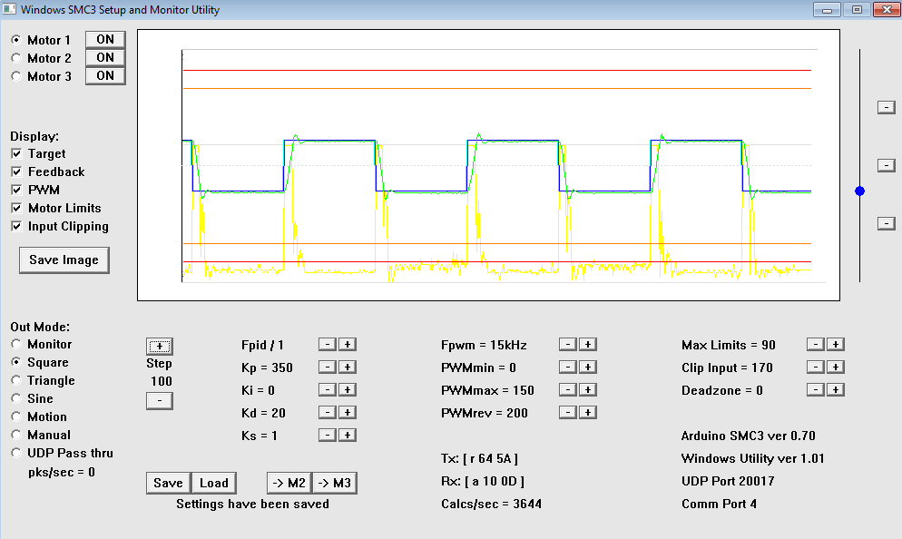

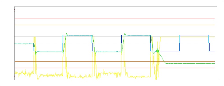

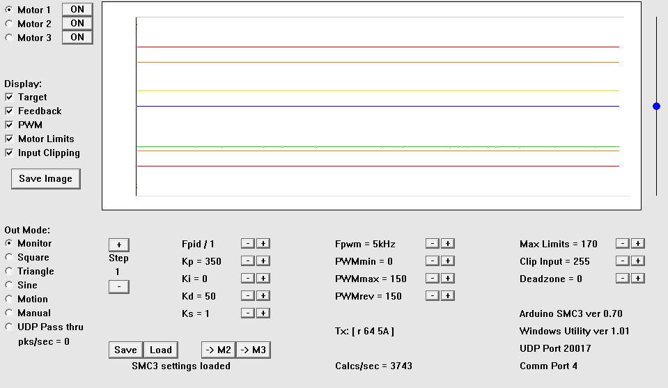

    I've got another problem. Sometimes my left motor will shut down under what would appear to be normal circumstances. It usually happens with abrupt step loads. The motor appears to just "give up" even though the PWM label in SCM3Utils is showing maximum. The motor isn't receiving any actual power because I can't hear the PWM when this happens, and when I probe the inputs I get no voltage. I've checked my connections, and they seem to be good. Moreover, if I restart the windows utility and try moving the motor again, it works fine. I've attached some photos of the SMC3 graphs:
    It might be possible that the chip is going into thermal shutdown, but my heatsink is barely warm. Do MMs usually shut down if the supply rail goes undervoltage?

    Sorry, I should have specified:
    PWMmax = 150
    PWMrev = 150
    Kp = 350
    Kd = 50
    Max limits are 170
    clip limits are 255
    pwmFreq = 5k

    I should also note that I can push the motor back towards it's target position, and if I try to push it past the target position, it starts to push back against my hand, but only in one direction. Are there any bugs with SMC3 that would behave like this? I'm using V0.7

    It did happen originally after an in game crash, but I've been able to replicate it in the windows utility using a square wave. It may be thermal limiting. I reattached my heatsink with more thermal paste and that seemed to alleviate it. I'll post if it happens again

    change fpwm to 25khz
    this is not the problem but it is too low
    what happens when you increase pwmmax?
    even with a heatsink a fan is also recommended
    also switch sides see if you can duplicate this with other equipment.

    I've tried switching sides and my left motor seems to be fine. Increasing PWMmax doesn't seem to change much, it might be happening slightly less frequently. I've got fans on them now, I'll see if that helps

    I feel like this profile still needs a fair bit of tuning, but the vid does a nice enough job of showing how aggressive the motion gets. It's still limited to 58% PWM Max duty cycle using single driver configuration on the MMs. I'll try gradually turning it up to full blast in the next little while :confused:.
    A couple more questions for those who can answer them:

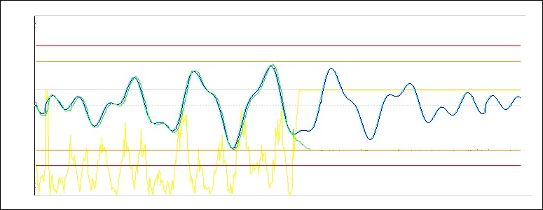

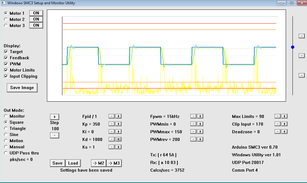

    I can't seem to get the PID controller that runs on SMC3 to tune properly. I've learned a little bit about control systems in school, so I'm familiar with how PID loops work. My problem is that the Kd parameter doesn't seem to be doing anything. If I crank it up, all I get is some extra coil whine on the motors. I've tried it with a range of values, and on both motors. The motors do have some backlash in the gearboxes, so this might be contributing. I still have overshoots on the step response of the sim, pictured below:
    Left: Low Kd value, Right: Maximum Kd value.
    Also, has anyone found a fix for the sway/surge values in the dirt rally plugin? They seem to sit still half the time and spit out erratic values the other half.
    Finally, is there any way to look at the math/parameters of the simtools axis filter algorithms? I'd like to be able to play around with the washout filter in particular, but the "% of axis" slider doesn't mean much to me.
