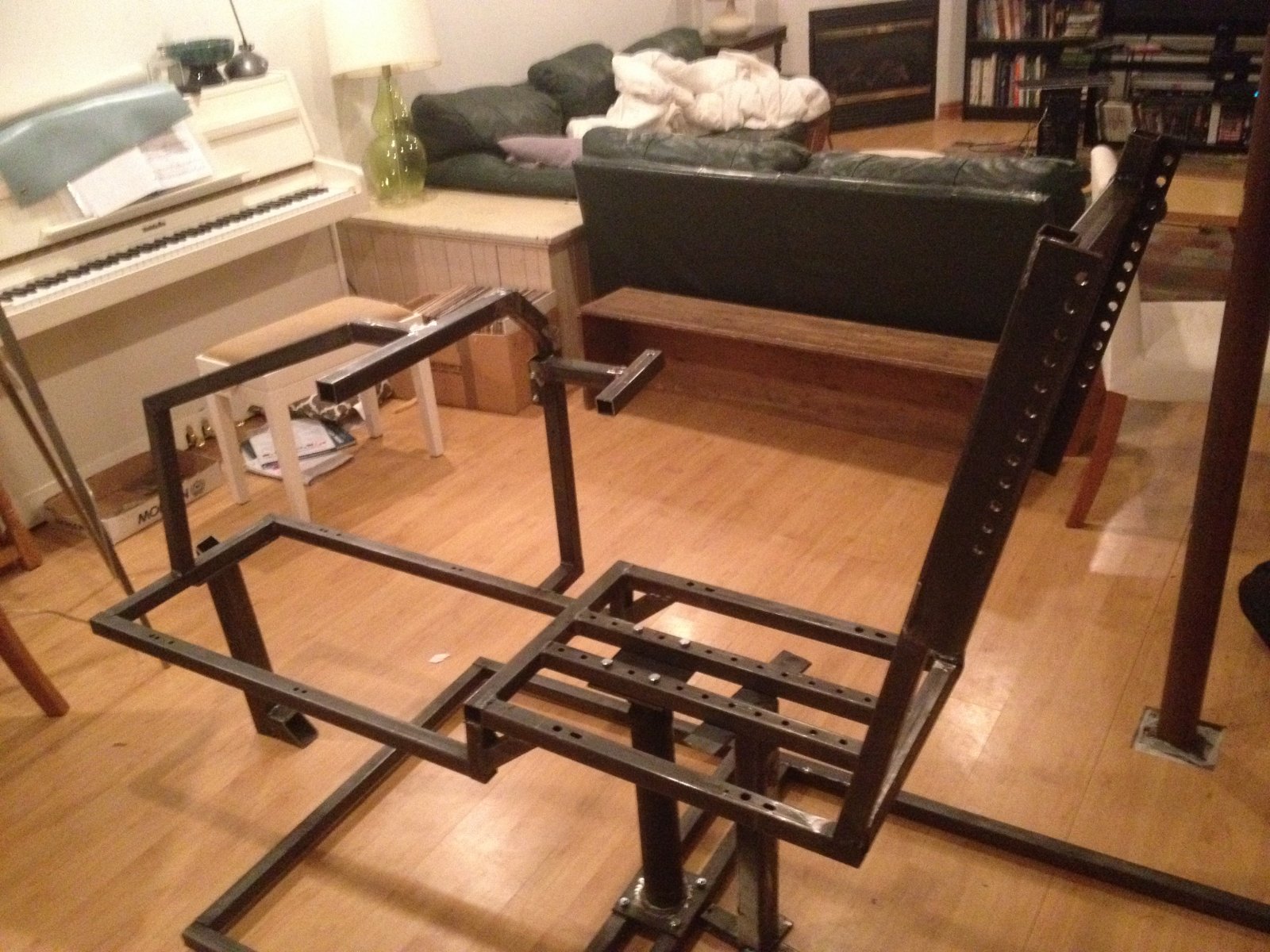

    Finals are done! Although I may not have access to my welder until a bit later, I look forward to making some progress now. I've got some of my metal cut and have mocked up the top frame. The person who was supposed to sell me the driveshaft flaked out on me like people on kijiji do oh so often :mad:.

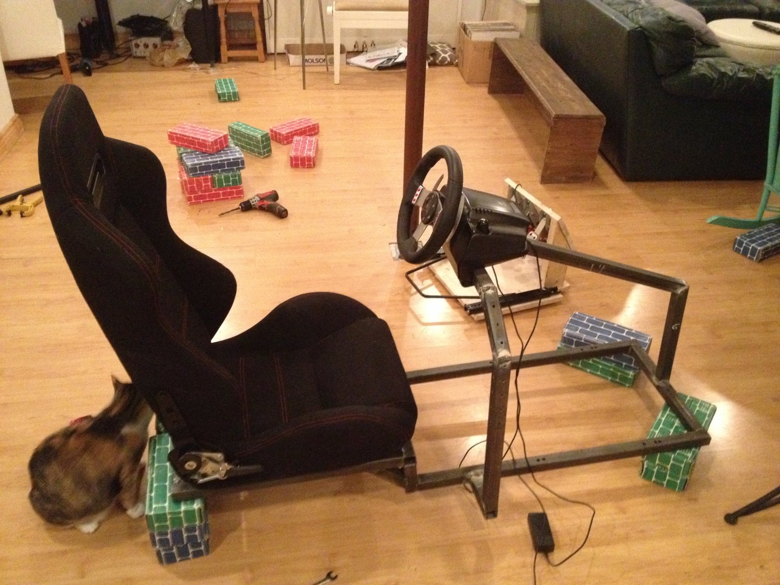

    I finished all of the high priority cuts at the school shop today, but unfortunately it's closed for Christmas now, and I won't have access to it after that. I'm thinking of just buying a drill press and an angle grinder to finish them up on my own. I'm sure I'll need them in the future at some point.

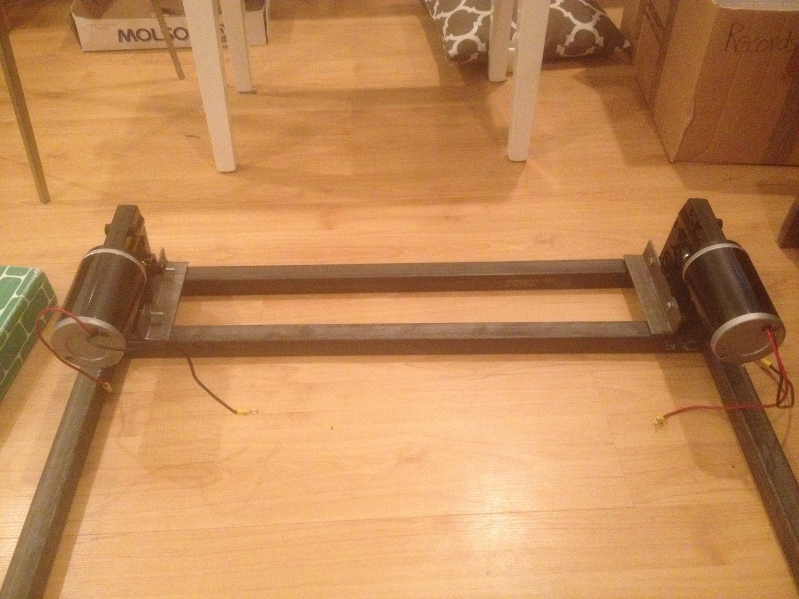

    Question for those with the experience. When mounting my motors to the base frame, does it matter if I mount them in-line with the front axis of the frame like so?
    Or should I angle them inwards so the CTC lever is in-line with the rod connecting the motors and the seat, like so:
    22,211
    154,729Coins
    +11,213 / 57 / -2
    Both would work but most go with the top option, as it is much easier to construct and ensure that both sides are the same.

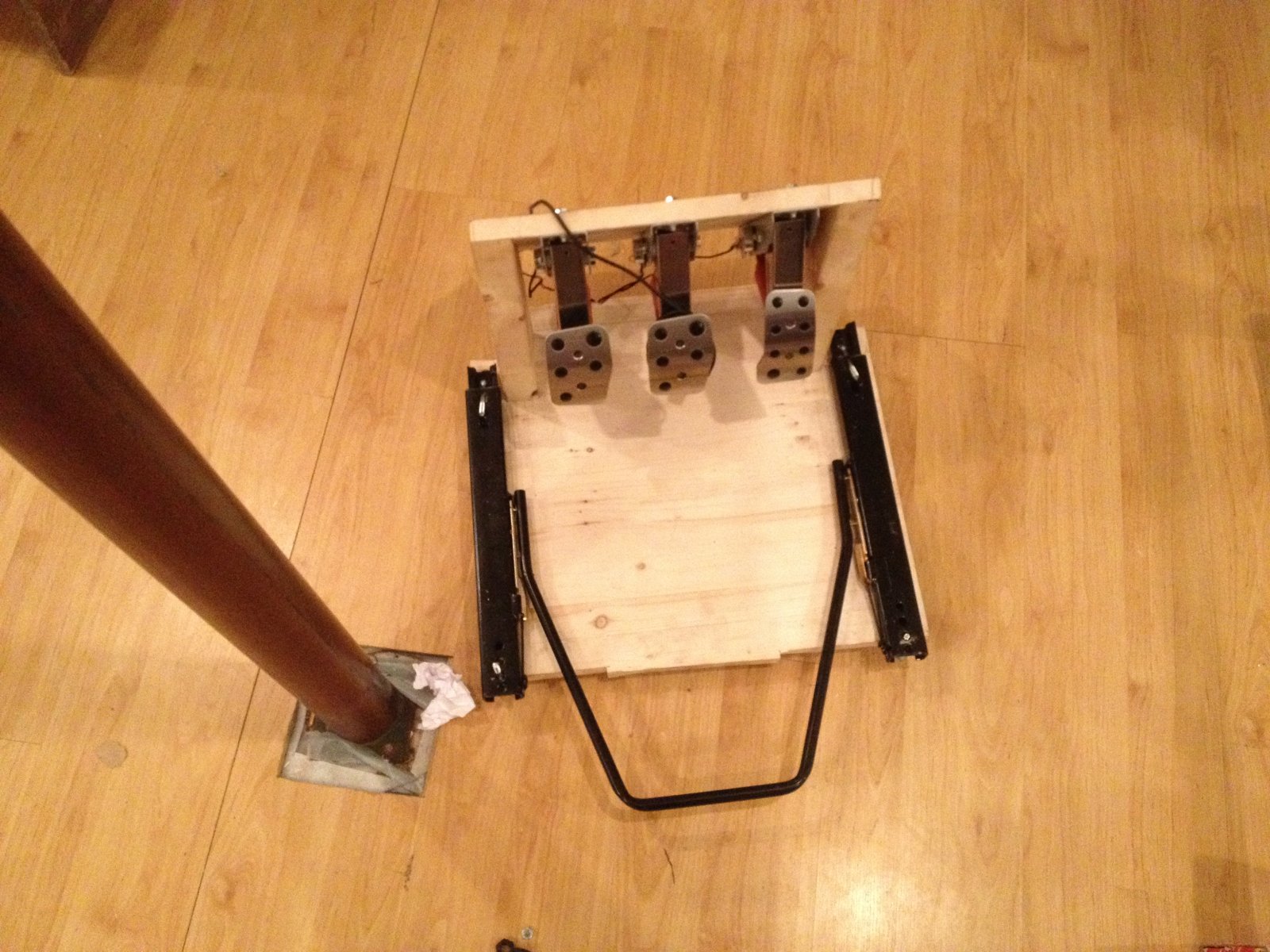

    Hello again everyone! Sorry for going dark there for a while, work/life got in the way and I was suddenly very busy.

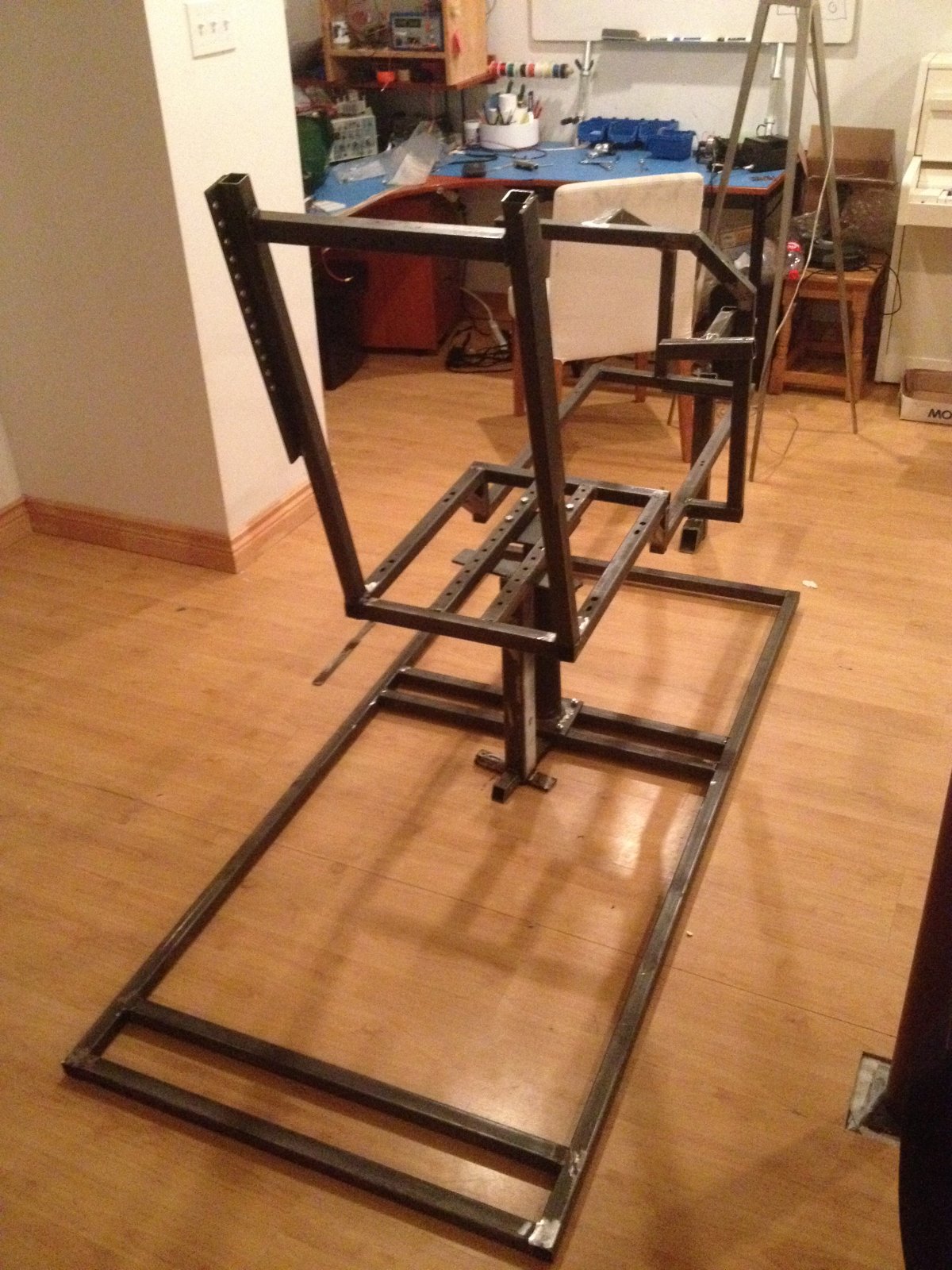

    I managed to make some progress over the weekend, I finally made arrangements to use a welder , and I've got the top part of my frame done up.

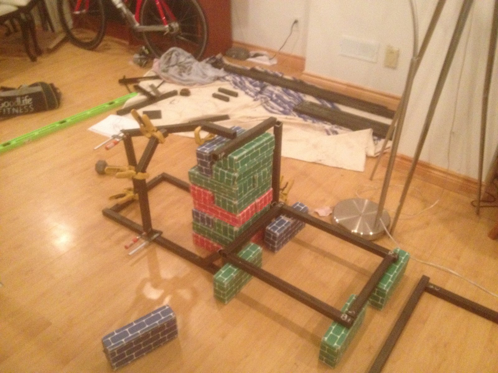

    And I've cobbled together a temporary mount for my pedals using the slider that came with the seat.
    Progress should be more steady from here on out.

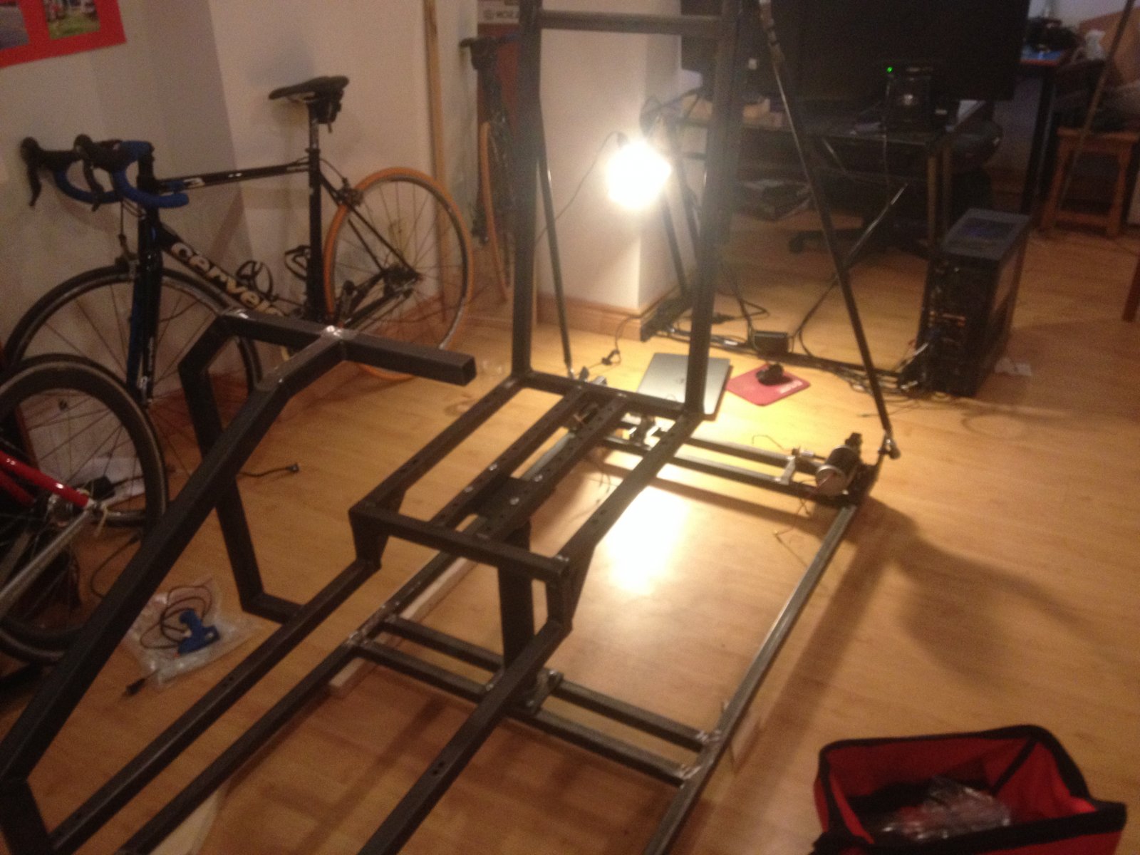

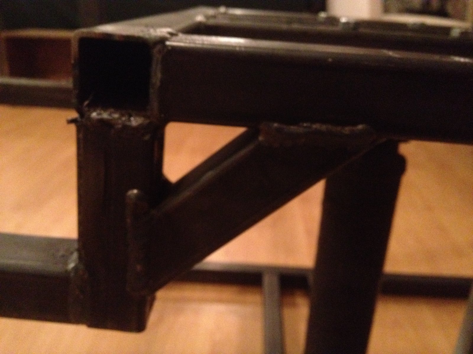

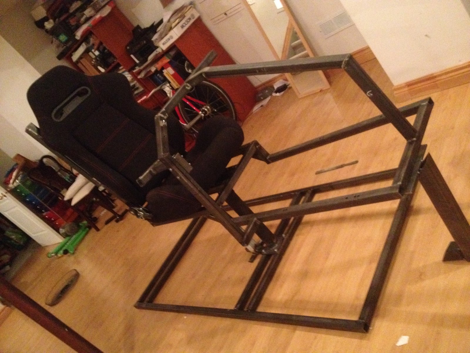

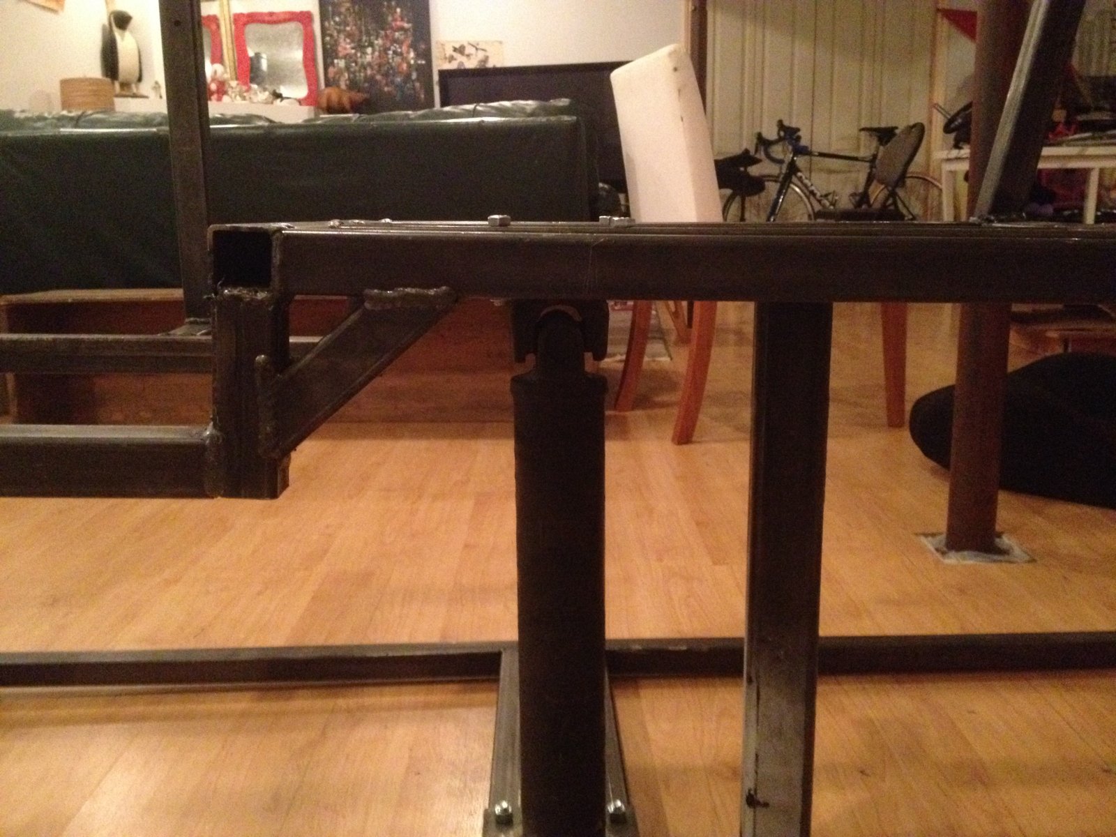

    Update time again! I got a lot done today. The top frame is completely done, and the bottom frame is nearly there. The only things I have left to do are the motor arms and proper CTC levers (the ones in the pics are placeholders for now). How thick of a steel do you guys usually use for the levers? I have a lot of 1/4 inch bar stock lying around, but I'm worried it's going to be too thin.
    My hall effect pots are set to arrive on monday, so I'll probably start wiring up my power supply and driver boards now too.
  18. noorbeast
    22,211
    154,729Coins
    +11,213 / 57 / -2
    Great progress :thumbs
    My levers are 7mm, which is a bit of overkill, but they are punished pretty hard. So you could go down a bit but do make sure your levers are rugged.
  19. Nick Moxley
    17,057Coins
    +2,507 / 30 / -2
    1/4 is perfectly fine for levers.

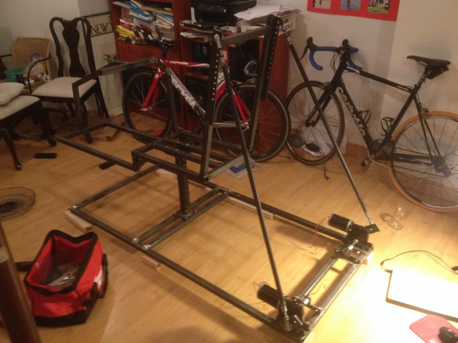

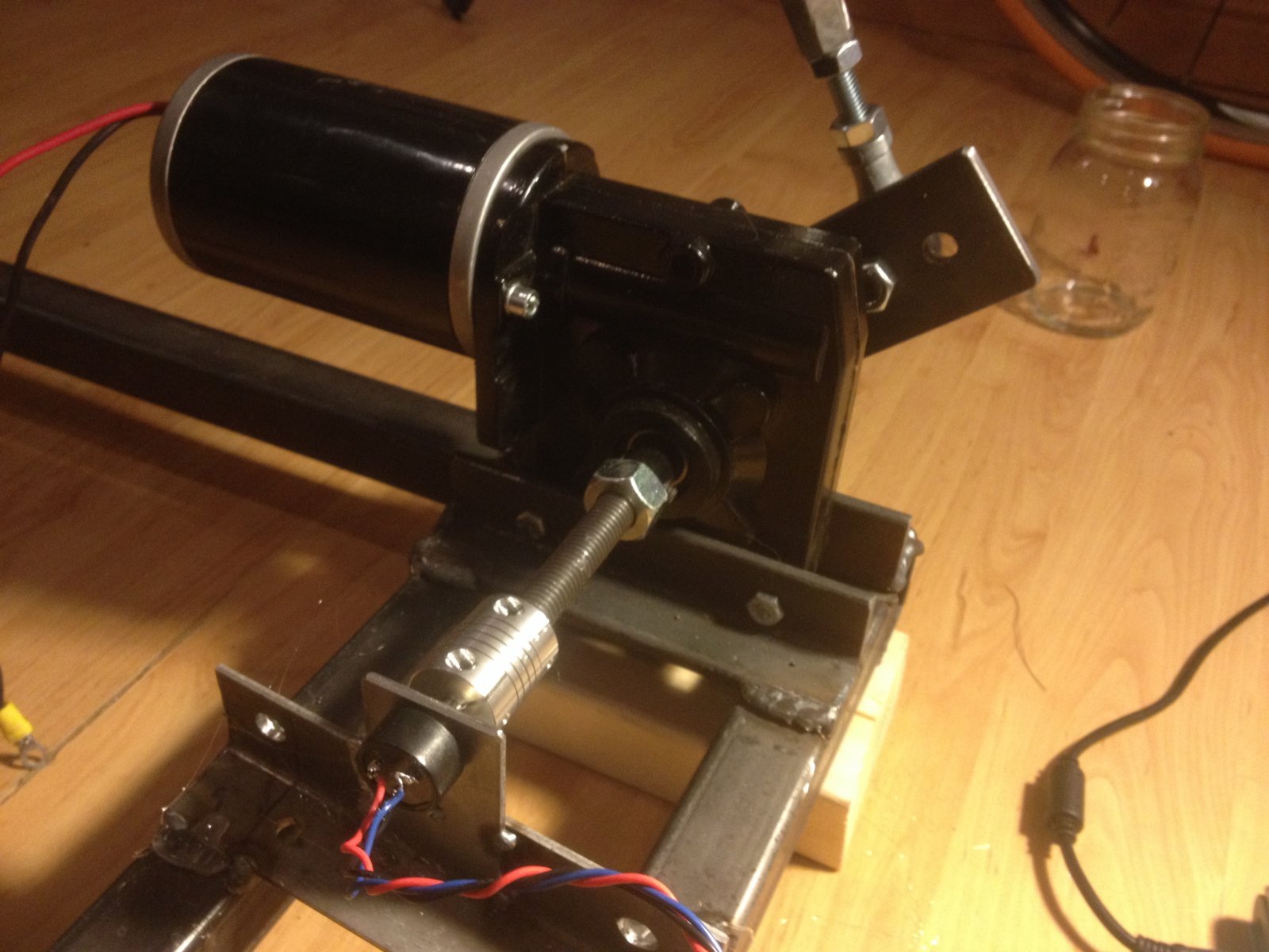

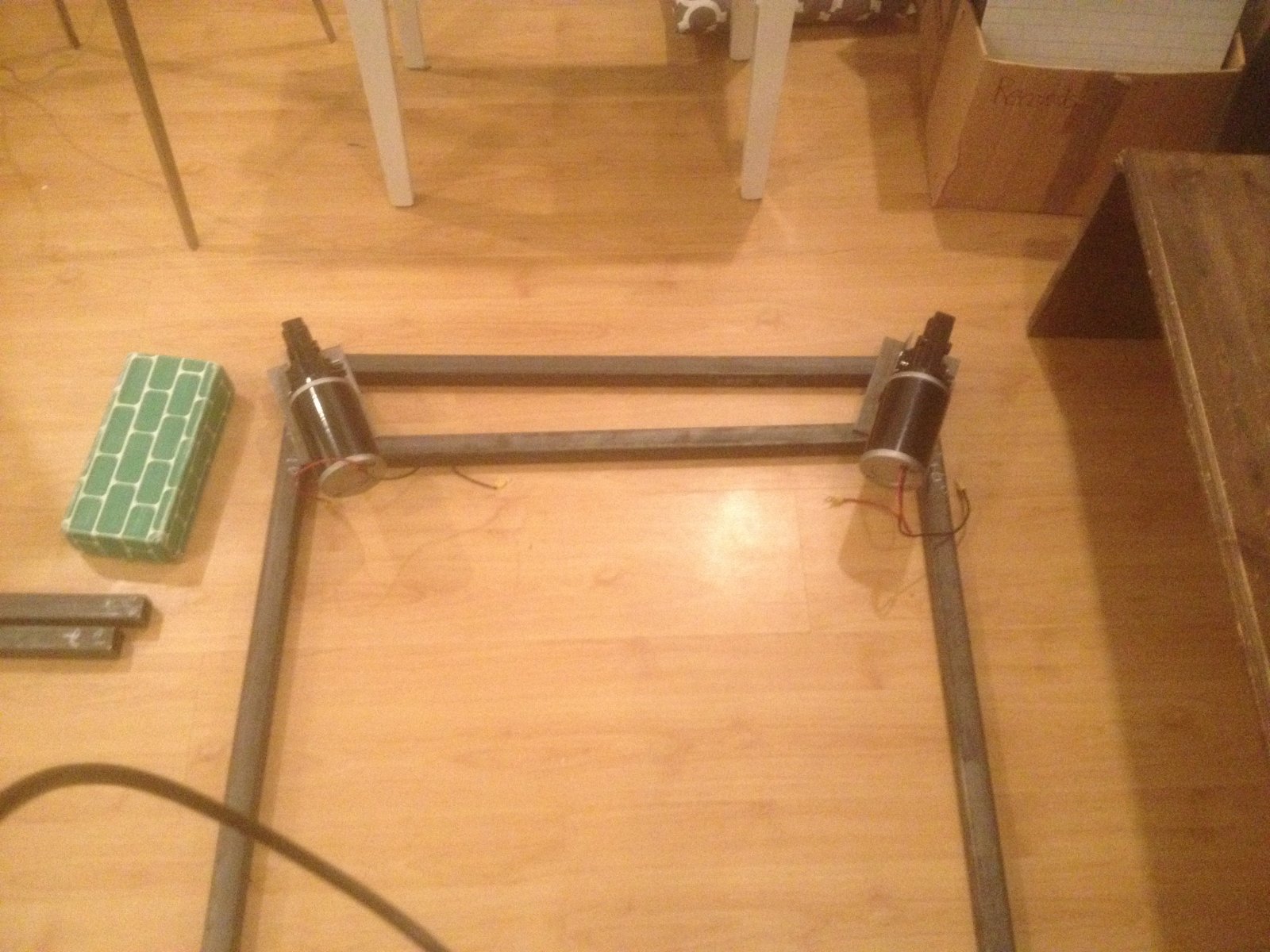

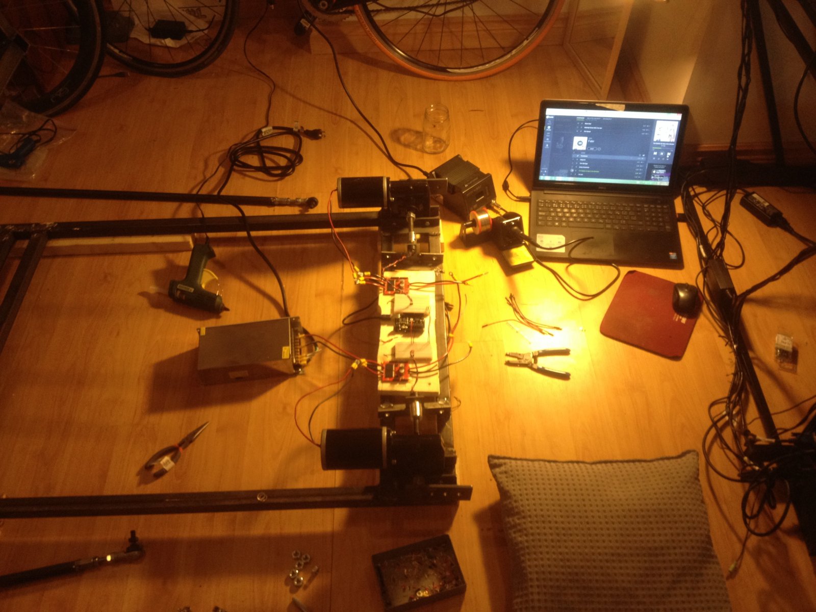

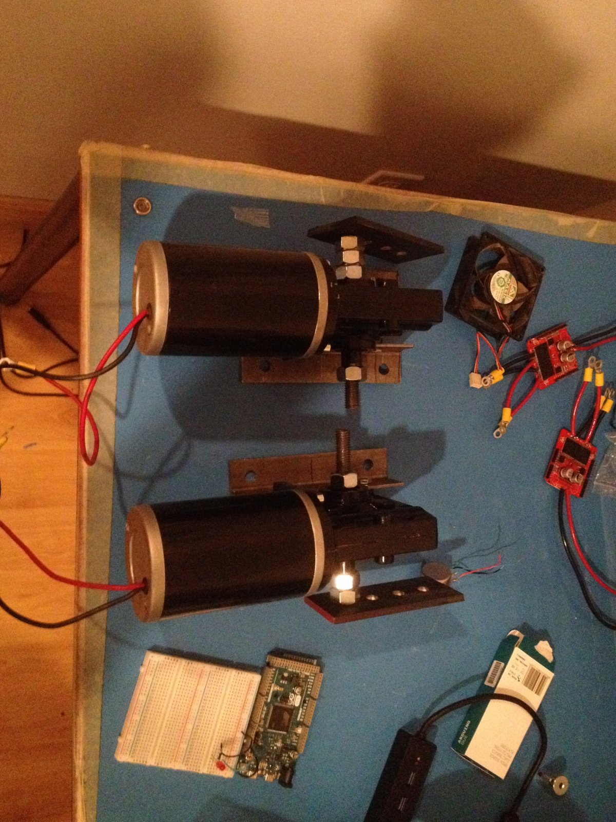

    Update time again! So all of the mechanical parts of the sim are fully assembled now. I made better mounts for the motors out of thicker angle stock, and I plan on putting a bar between the motors like @noorbeast has done, but I'm waiting on the lathe in the workshop to come online for that.
    So I set about getting the H bridges working, wired them up, started SCM3 aaaaaaaand they promptly caught fire.... It turns out when I wired them up three months ago I got one of the input polarities backwards. Always check your wires folks!
    On another note, what heatsinks do you guys usually use?
