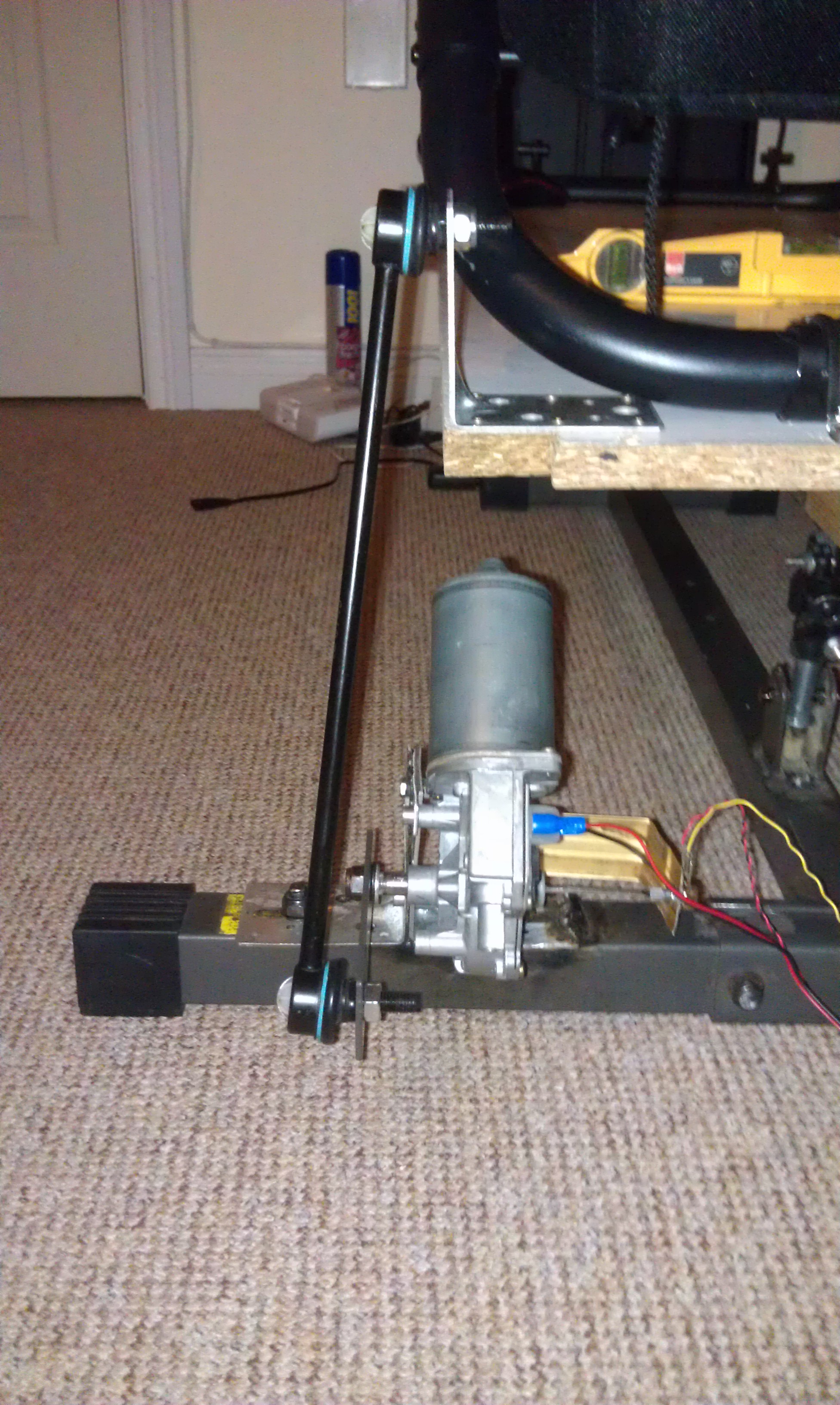

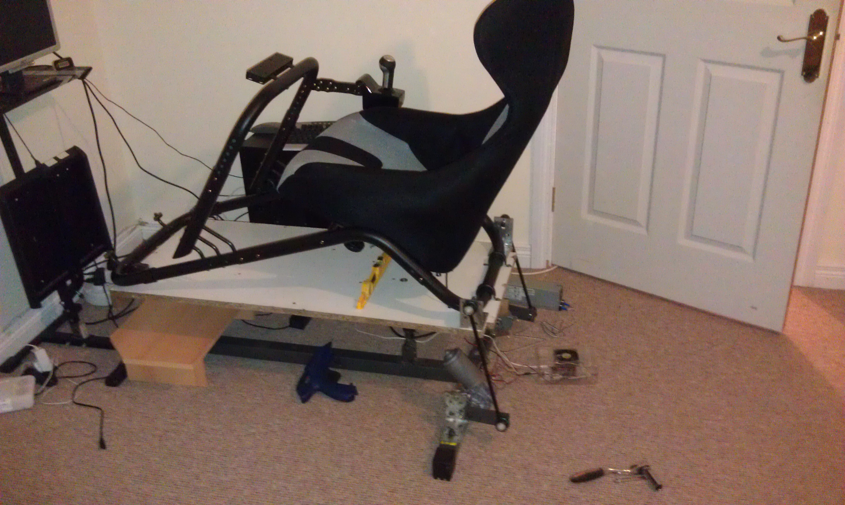

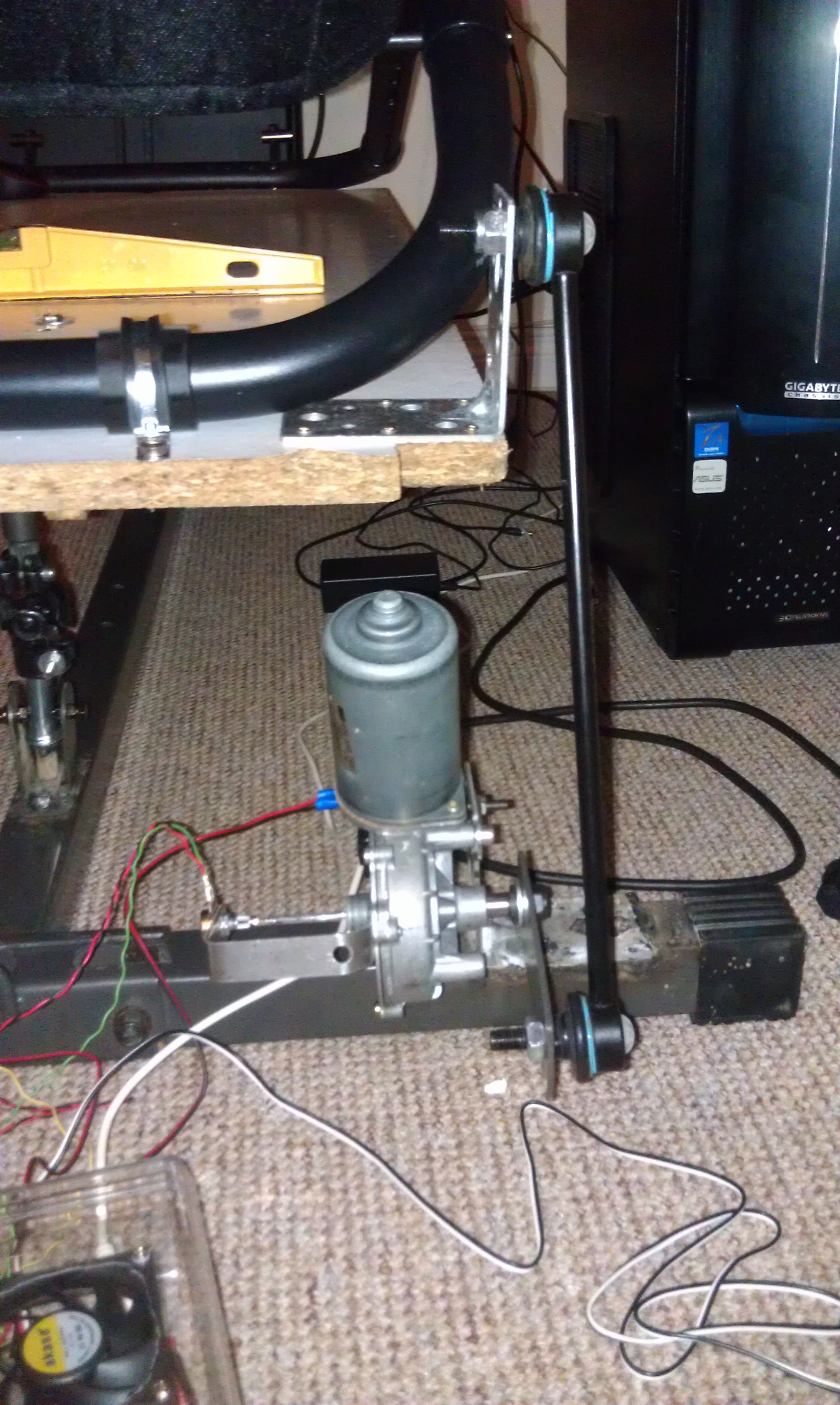

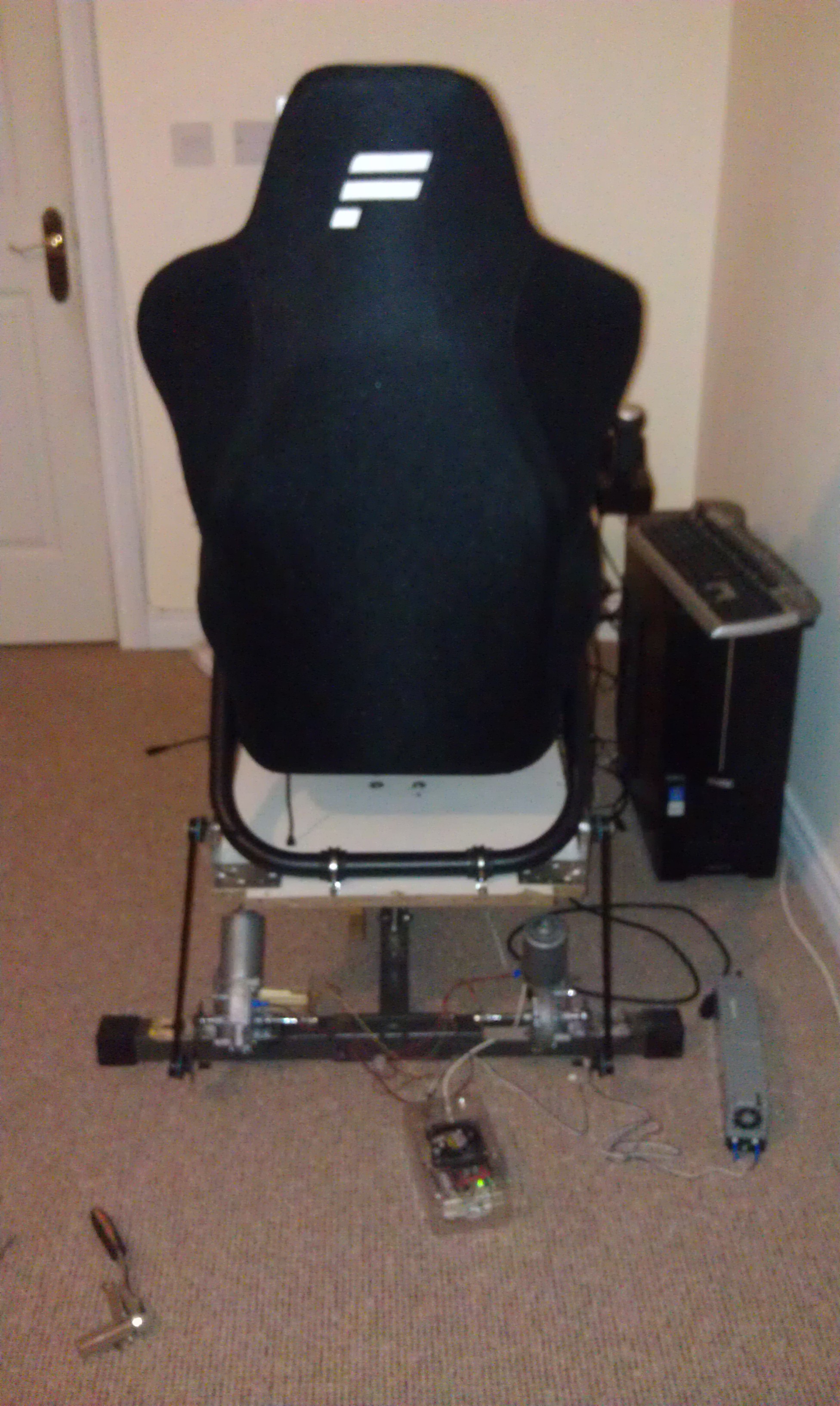

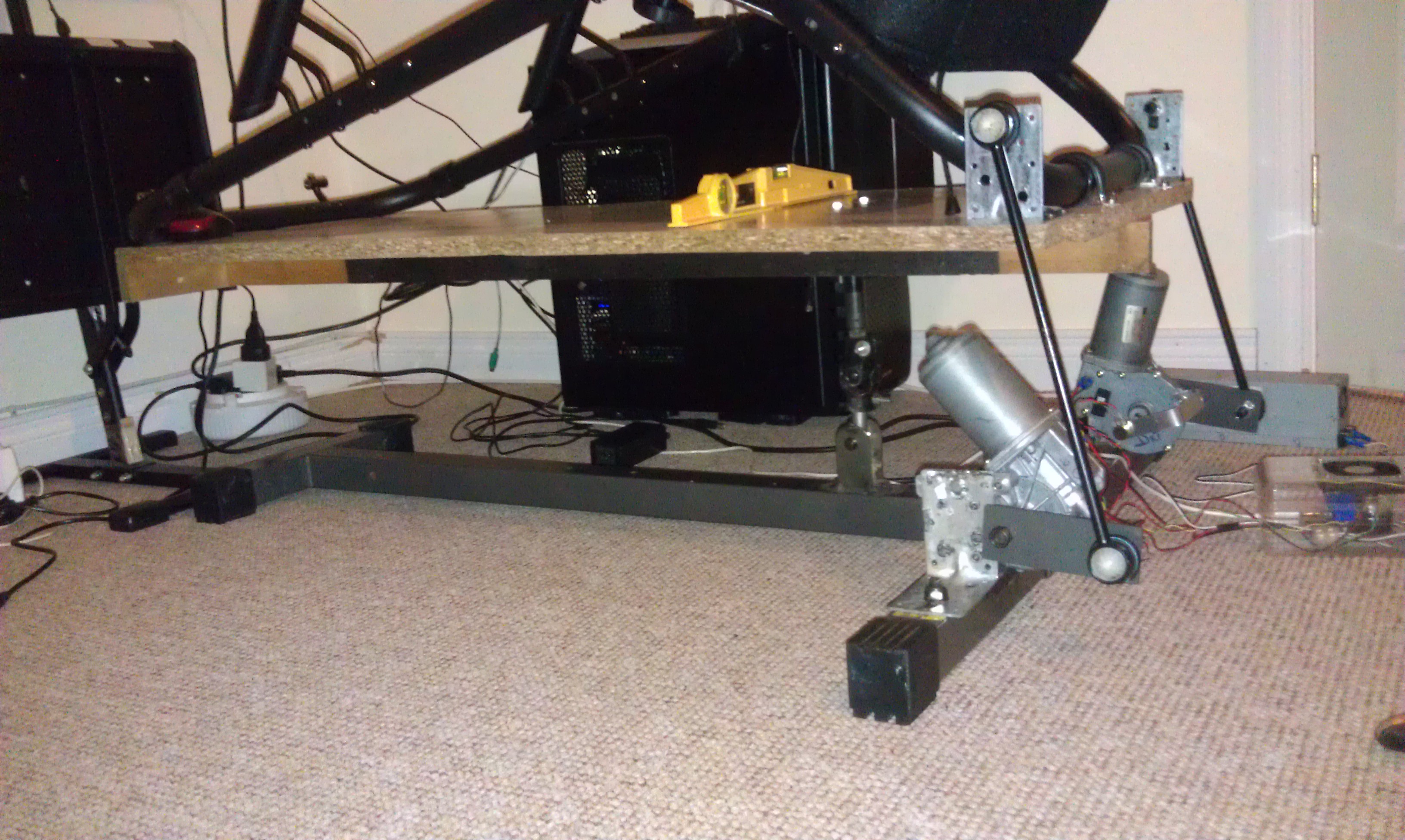

    well here are some pictures , is nothing special but is my first attempt
  6. RacingMat
    2,234
    21,094Coins
    Well done! It takes shapes :cool:
    You already had some fun being shaken or not yet?
    I hope your motors won't try to make a full turn... do you have fuses?
    Mat

  9. bsft
    Nice set up, but I must point out something after 14 builds experience and others help and guidance.
    The motors at the back connect way too low below centre of gravity. The wipers will struggle like anything.
    May I suggest moving them up the front and connect them to the steering mount , like I have suggested in the picture.
    This way the motors connect higher and because they are working above the weight of you. It will make a big difference on improving motion.

    Looking good but aren't you afraid the pivot is too small?! I ask this because I am looking at a pivot solution..
    Will go to a scrapyard this week to find out my options..
