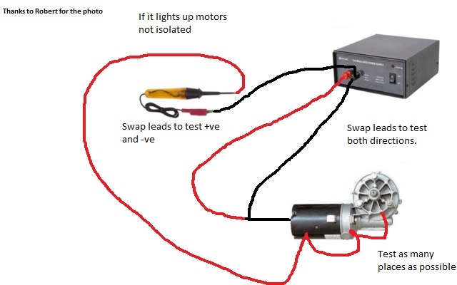

    Did you need to open your motors for isolate the earth cable or was just plug and play?
  18. bsft
    With wipers, YES, must earth isolate. If that is too hard, best buy big worm gear motor which are already done, that and they are faster, stronger.
  19. RacingMat
    2,233
    21,082Coins
    The motors I linked do not need any hardware dismantling : they are ok like this!
  20. bsft
    Check it anyway, better spend 5-10 mins per motor than accidental nuke a board or two testing motor.jpg
