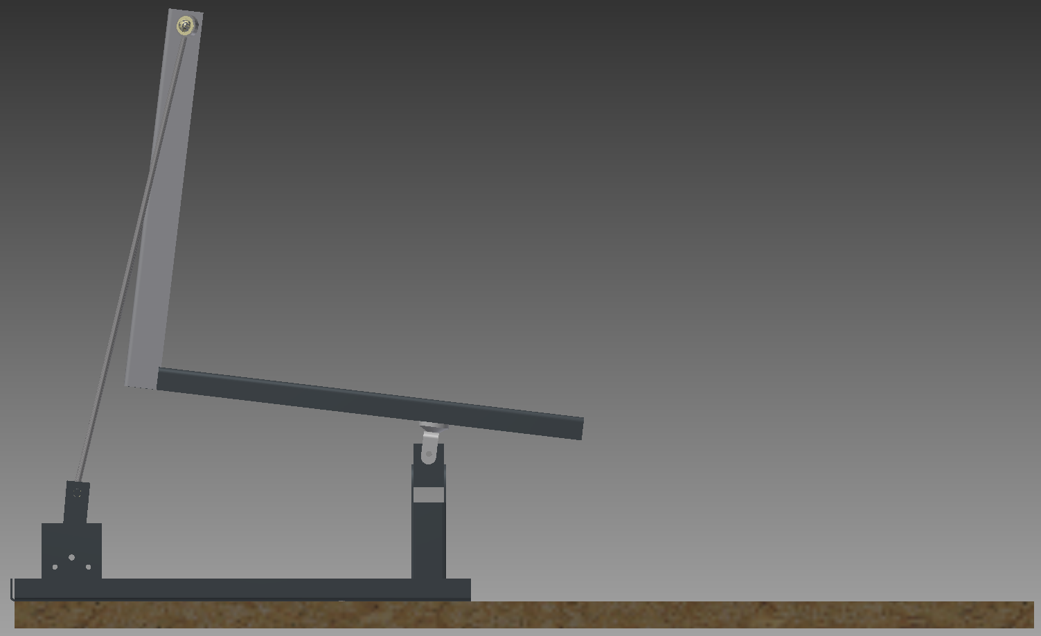

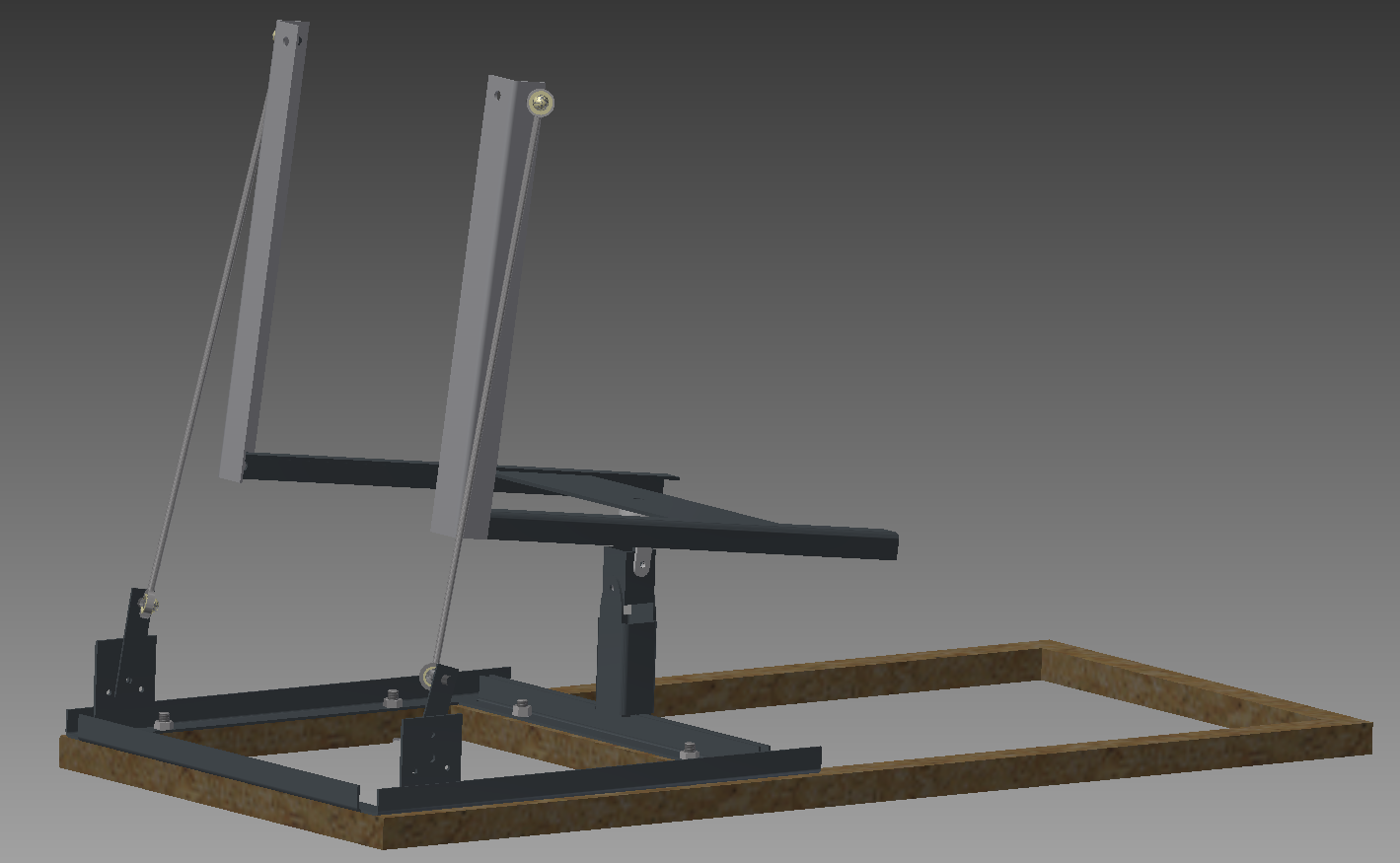

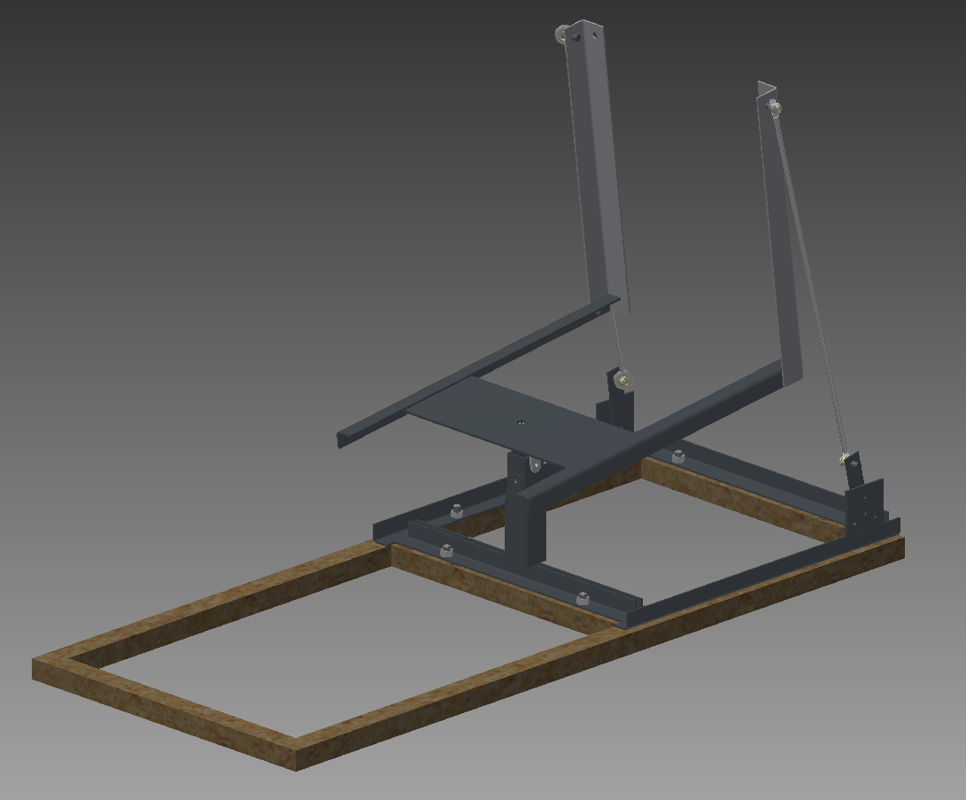

    I have based on RacingMat project.
    I used Autodesk Inventor to make the drawing.
    Using this Cockpit from WSGT and a Logitech G27.

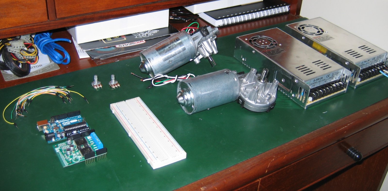

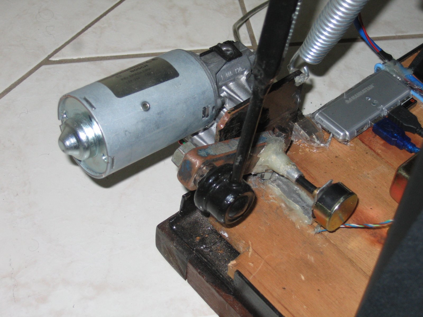

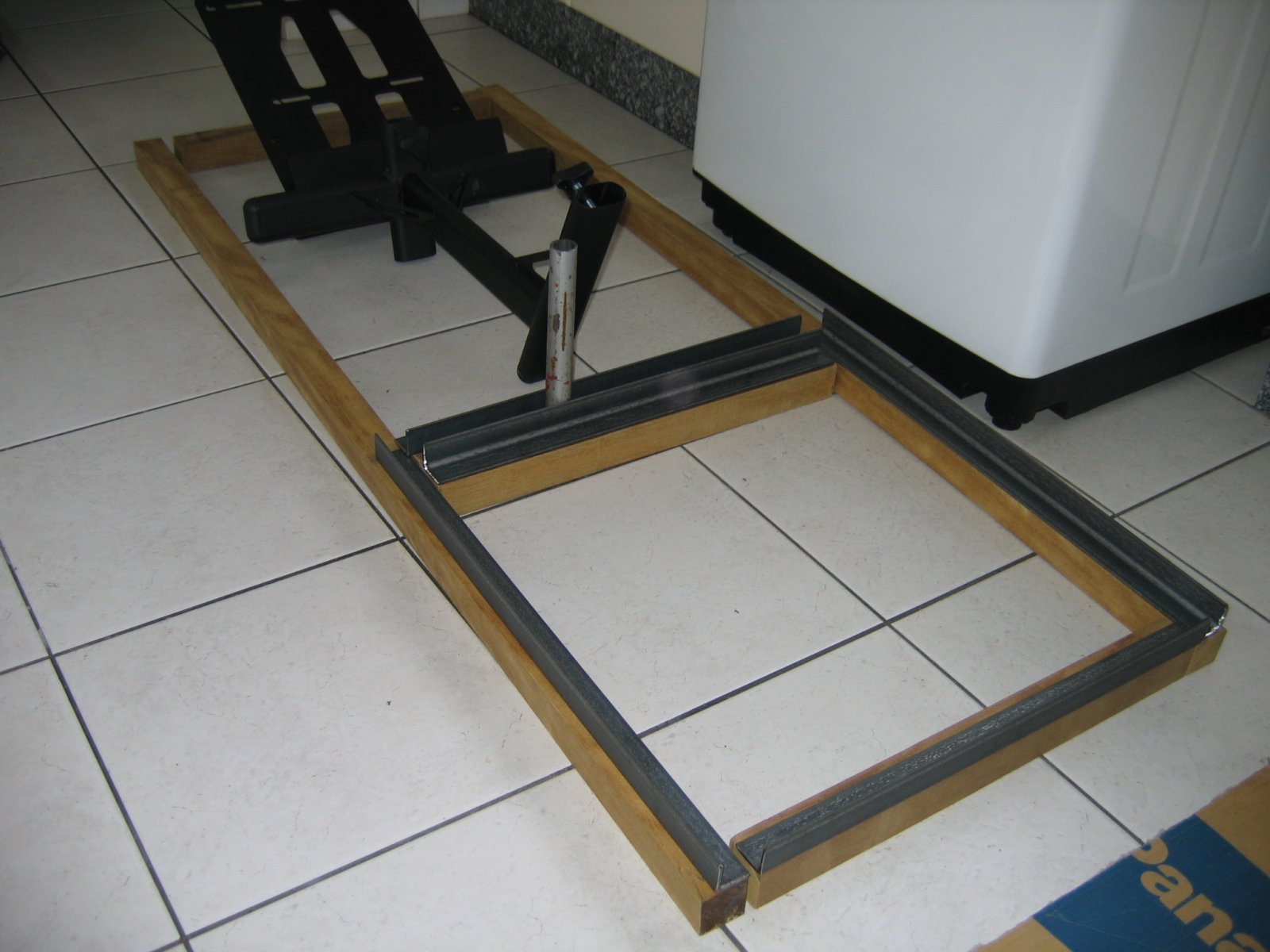

    Two Bosch wiper motor 24v / Arduino Uno / Pololu VNH5019 / Two PSU 24V 14,5A in parallel.

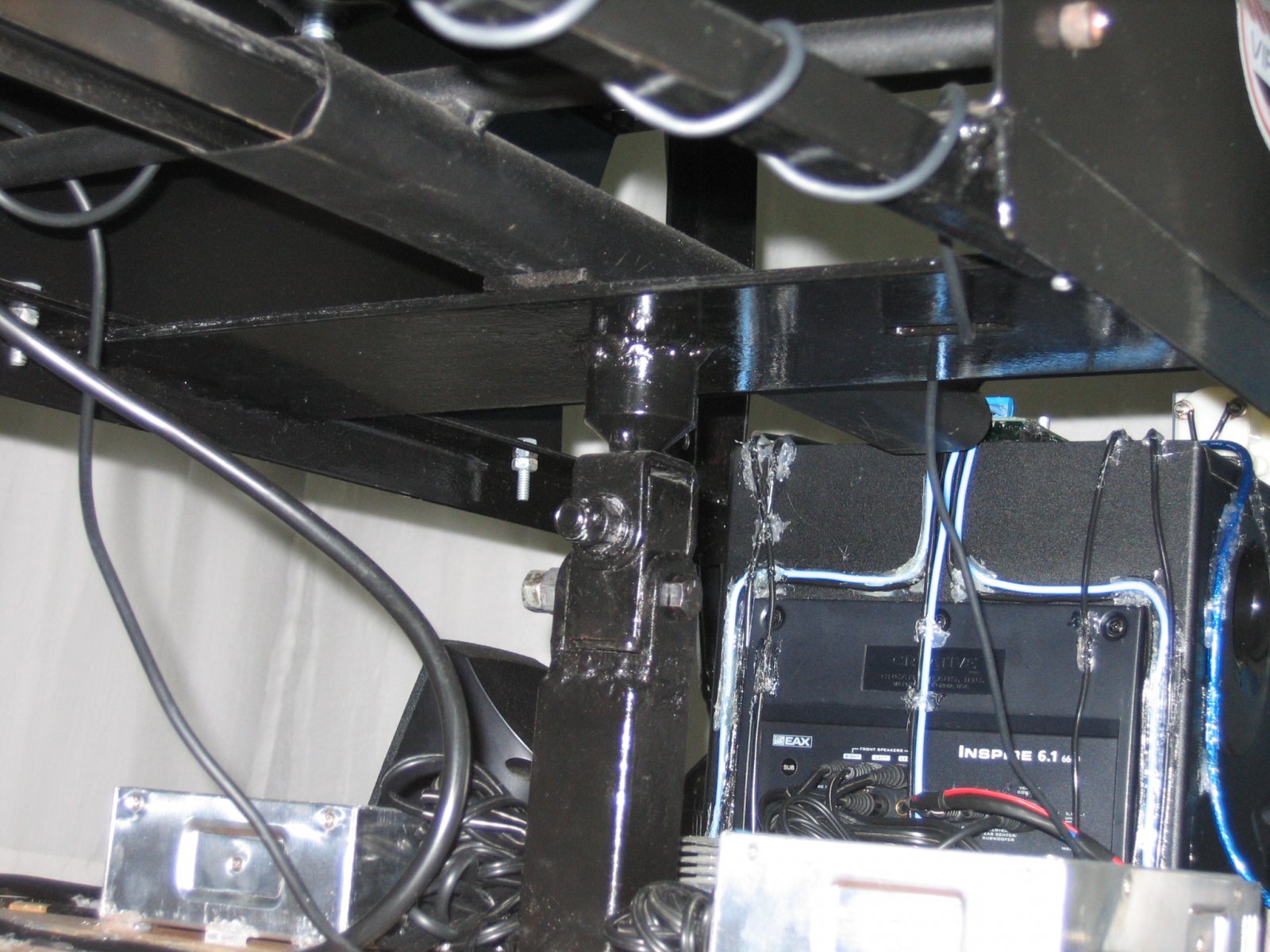

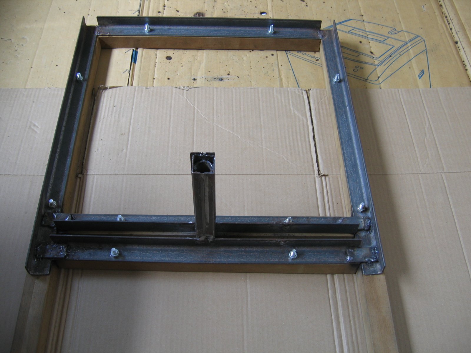

    The base made of wood and steel.

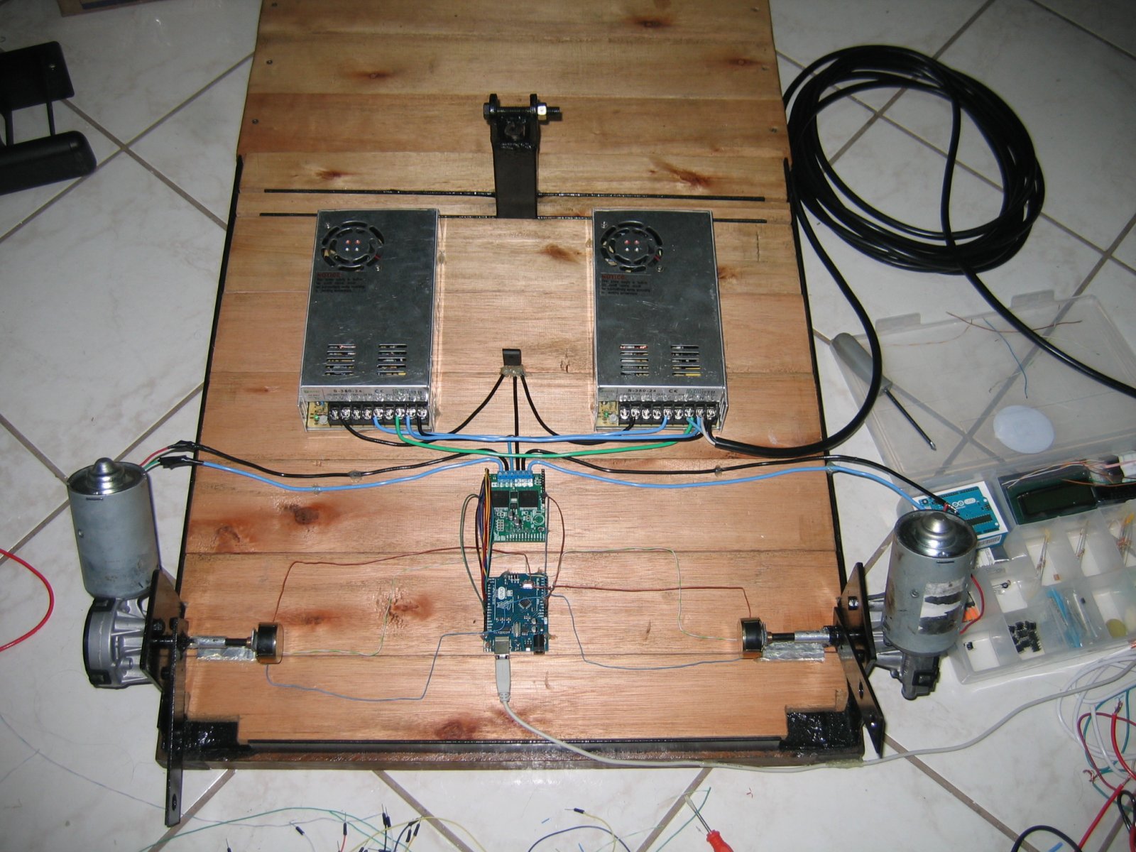

    Base welded.
    Base with more wood and all the electronic mounted for testing.

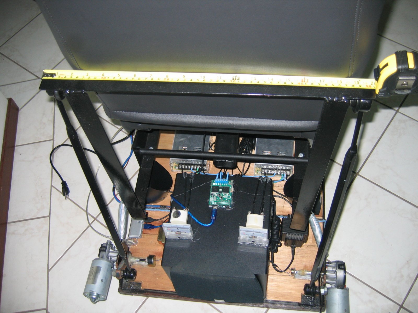

    I uploaded the RacingMat code to the Arduino and tested sending commands by Serial Monitor and worked great!
    Than I install the cockpit on the base and add a Creative 5.1 sound system.

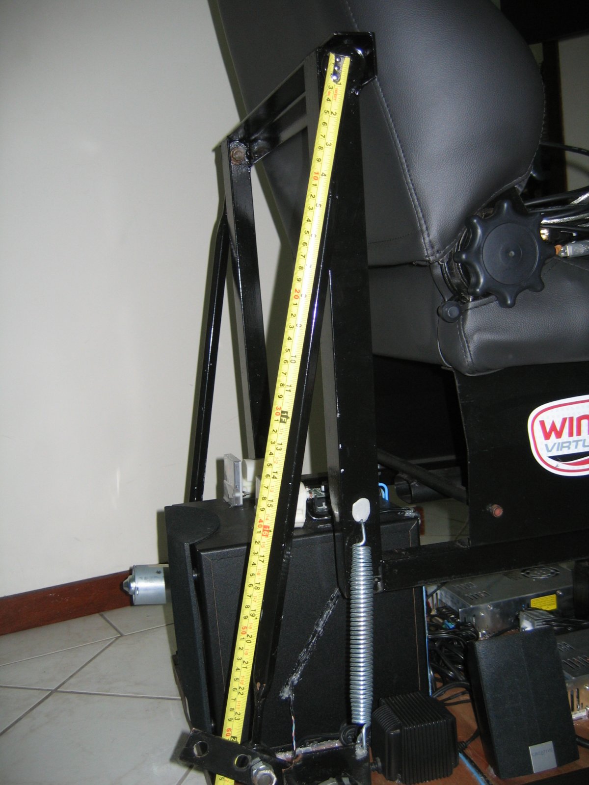

    Have to add two springs because the weight was too high in the front.
    Changed the pots to better ones too. Everything stuck with hot glue for now :p
    Some measures to have a better idea.

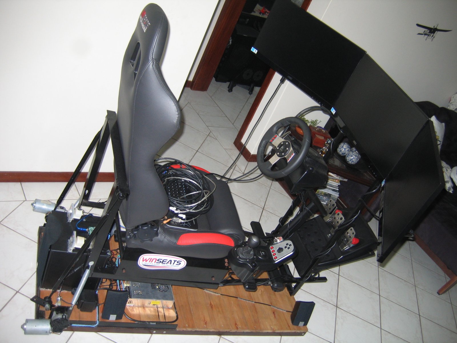

    Installed the monitors and finally done! :)
    I will post more details and some videos later.

    Yes, the feedback is given by the Arduino.
    The pots for positioning are connected on Arduino and then go to the Pololu.

    Finally tested! Works perfect! :thumbs
    Here is a video of my sim in action ;)
    Thanks!

    Nice job !! Looks like a lot of fun :popcorn
    You got some flex there the base is lifting off the floor, also do those motors get hot at all ?
  13. Fabiosb
    Fabiosb New Member
    Sep 22, 2016
    11
    Florianopolis, Brazil.
    167Coins
    Yes, the base should be wider to become more stable.
    After two hours playing the motors became warm only, also the Pololu. Even without heatsink.

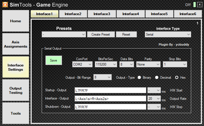

  17. Fabiosb
    Fabiosb New Member
    Sep 22, 2016
    11
    167Coins
    Hi Thomaz!
    I'm glad I helped you!
    I never used SMC3Utils, is this just for testing?
    I just used the SimTools software, here is my config:
