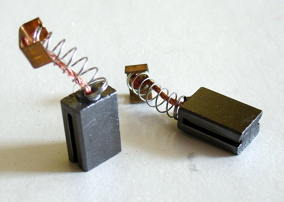

    OMG There must be some curse on me ;( A few days earlier one of my motors on my back seems to get weaker. To work at the same power that the first one I had to incrise Pwmax through SMC3utility (first was warking with Pwmax 110 and second should have about 140 to work equal). I changed MM by sides and the same story (same motor was weaker) so I think that is something with the motor itself.
    But today the worst thing even has happend - another motor, this time form my platform beside, stopped working. NOTHING. Made some tests and finally I brought it to my car battery, and no life at all ;( I think it's dead. Strange because today morning I was racing and everything seems to be OK. Than I turned it off, back later after my work, tried to turn it on and nothing. Another motor is OK.
    How do You think guys - Should I use my warranty for the first engine too? For the second one it's obvious I should... but this bothering me even more 'couse I don't know why it has happned. They work great, were hot during play, but no too much, rest of electronic parts are OK, PSU was good, mounting too... I don't know really. Maybe You have some more experience and can tell me what can I do to stay away from such a disasters ;)
  11. Pit

    Hmm, I don't think so @Pit, beacuse all the motors were new. They were working for one month...
  13. Nick Moxley
    17,057Coins
    +2,506 / 30 / -2
    Are you confident in opening them up and having a look ? Worst that can happen is the Brushes pop out and a flexible tension spring comes off the end of the rotor or out of the end cap....you can actually remove the end cap while using the tension spring to hold the brushes in place. (A little tricky but can be done)

    I don't want to open it in case to not lost the warranty, but thx for this instruction I will use it if warranty doesen't work in this case ;/ But... why the brushes could pop out??? Also something smells like burned...
    Do You think there is something wrong with the other mototr that is weaker now? Maybe went hot too much and something happend inside? Now I gave two 120mm fans for each motor.
