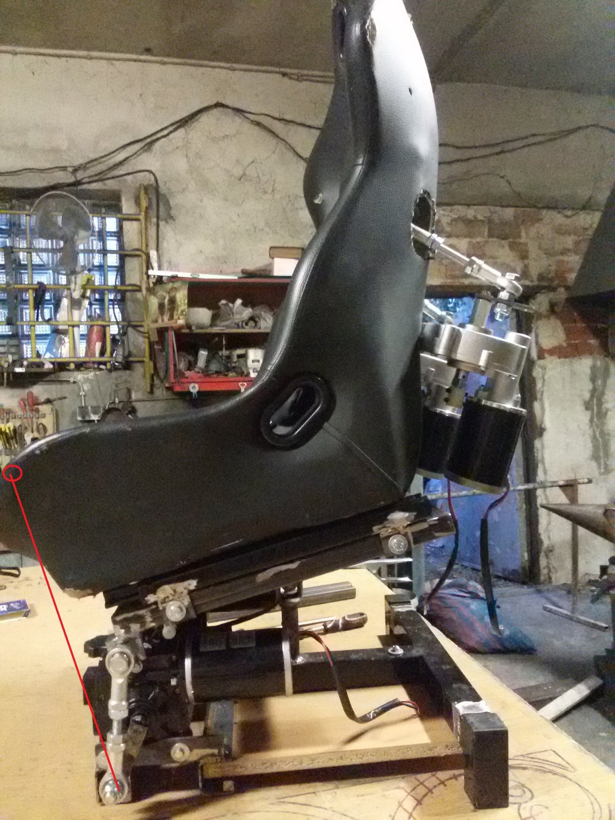

    Thx @Blame73 I'll The Gt3 car and I think it will be in the middle. Copy/pase with the decimal works gr8, thx again. Today I'll check MM powering and soldering, but mor of my invetigation in a moment.
    Thx @Pit . I changed some parameters in the Utlity. Now it looks like this:
    I also swaped the motors with MM and pots. After some tests the problem is still there, but, as you can think, on the other side, because of swaped motors. So definitly is something wrong with one of the MM under high load.
    I checked another time Utility and this time I chose square test. Results below:
    Motor 1 - you can see slow response when seat is going from back to the front. Another direction is OK (I was on the seat)
    Motor 2 - it's even more interesting. During the test Motor coudn't return at all for a moment. I had to help him and then it was working as the first one.
    I thought that my pivot point is more important that I was thinking. Actual my pivot point is not as it should be, but more to the front. Moreover on the back of my seat there are two heavy motors that bring the center point even farther. So I unmounted these two motors and make test again.
    Result:
    What Do You think guys now? I thought thet center point is more important with te platform project, not shaking seat. Besides I was suppose that my 200W motors are strong enough to carry such a construction, but now I doub it.
    I need to take a few laps without balast on my back and see.

    After the tests without motors on my back I have to say that both motors under my seat work OK. No problems at all. I think there are 2 problems in my rig. 1 - I need to change my pivot point, 2 - under very high load one of my MM stops working. So back with my rig to the garage and try to find bad soldering in MM.
    If pivot point will be allright than weight of my motors hanging behind my back doesn't matter for bottom motors, right?
    21,723
    152,051Coins
    +11,063 / 56 / -2
    The motors hanging off the back add to the mass to be moved, but balancing the rig with them and yourself in it will help a lot: www.xsimulator.net/community/faq/find-the-center-of-gravity-to-balance-a-motion-simulator.55/
    At the moment the rods from your motors are attached to the base of your seat. It would help if the attachment point were higher so it is over the COG, so at least as high as the seat swab. It means more fabrication to extend the frame but it would help a lot, see @bsft's sim as an example: http://www.xsimulator.net/community/marketplace/desk-racer-2-dof.91/

    Good news! After resoldering all the pins motor works great. One issue is behind. Now change the pivot point and test my G-Seat option.
    Thx guys, and I really appreciate Your help. Without it I would be nowhere...

    Welcome back after few days of being absent. I was working hard to make machanical changes to my platform, and today I finally bring it home! Give You some pictures later, but for now some old things.
    Everybody that has tried to help me with Rf2 and the plugin - thank You very much and I'm very sorry at the same time ;( You can say I'm a newbe here so sometimes I make mistakes. That is why Rf2 was not workin correctly. I made mistake during plugin update. I found it when a lot of people was talking that my problems are related to the older version of the plugin. I found the folder with the plugins and checked it twice manually, and I realised that file dll of the plugin in my folder is different that the new one... overwriting the file solved the problem. Now every of my sim work gr8!
    Now about my platform - I changed pivot point (more to the back) and add mounting for my DIY HShifter. Changed safety belt mounting also. As I said - pictures and maybe some movie later ;)

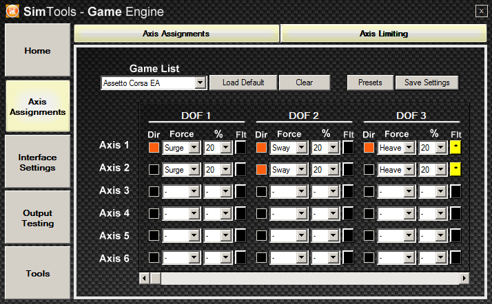

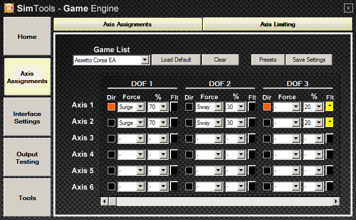

    Now under SMC Utility all tests were OK. Great G-Seat is working! but... then I realised that Simtools has the ability to use several interfaces, but You can't configure the axis for each ;/
    For example for Assetto Corsa profile I need to configure my Platform:
    and configure my GSeat like this:
    So am I right that at the current stage I can't use Simtools to use pltform+Gseat simultaneously? O fcourse I can use it but with wrong settings for one or another... It's sad, because I put a lot of effort into it.
    If anybody cant tell me how to do it please help.
  20. Pit
    3,012
    30,490Coins
    +3,100 / 31 / -0
    Generally speaking you can use up to 6 interfaces simultaneously. They are working completely independent. First did you checked the interfaces by testing the Axis output? Then you have to set Axis 1 and 2 for the seat motors, and Axis 3 and Axis 4 for the G-Seat (my recommendation). By all means please upload your interface settings for a better analysis. :)
