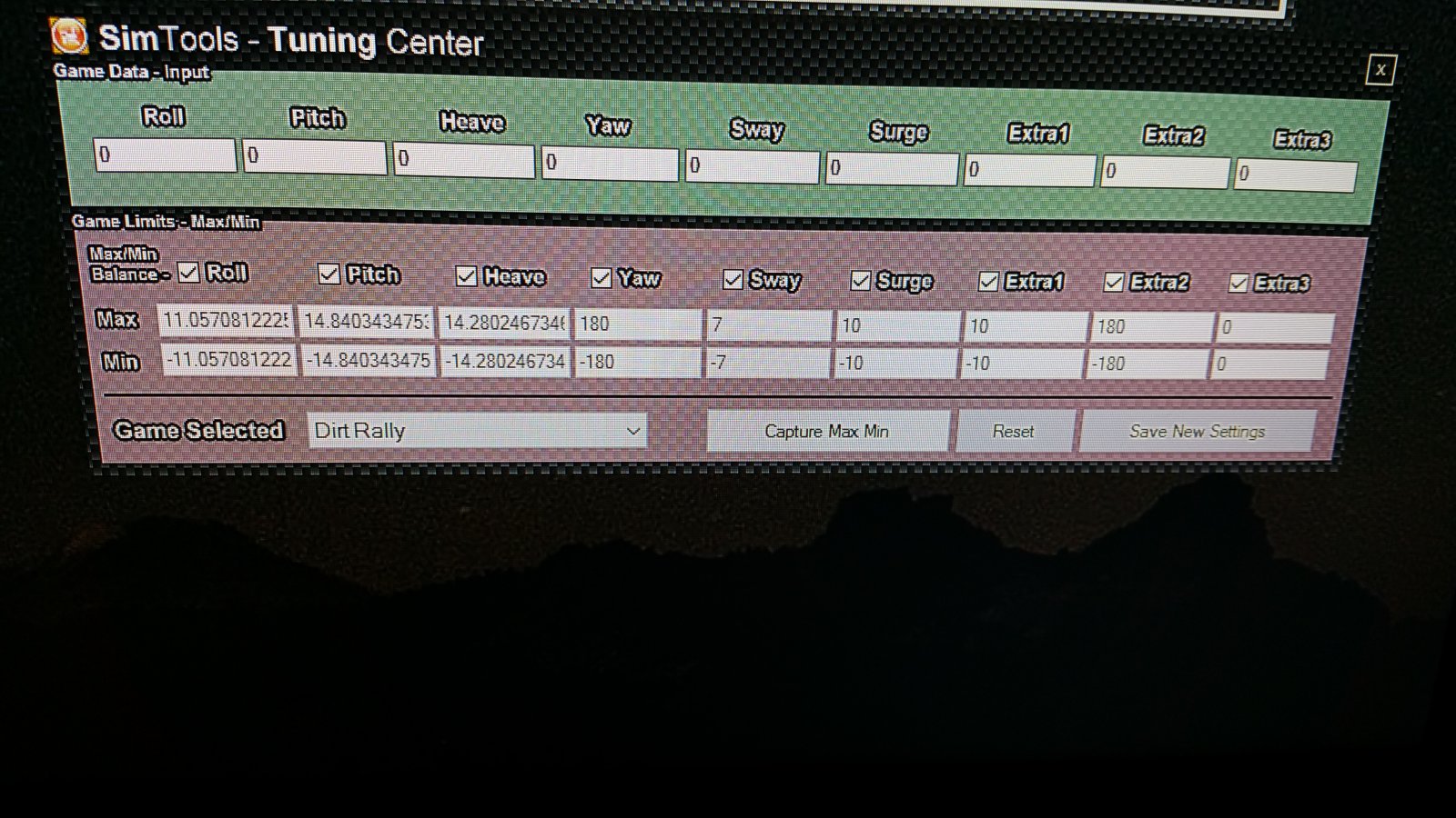

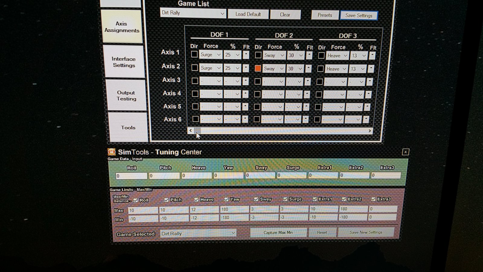

    @Nick Moxley ,, I've been playing with the tuning and i took your tuning center settings that you posted in the dirt rally thread and then used @eaorobbie 's axis settings as a base and turned them all off and tuned them all separate and ended up with this ,
    I had to turn the heave down to 13 because i nearly sh!t my pants though but its pretty intense now,,,,i'll do another vid in a bit,,, just gonna chill for a bit and have a cuppa.
  3. Nick Moxley
    17,056Coins
    +2,506 / 30 / -2
    Try a Wack load More roll and Pitch axis %, In this case its more than acceptable to go beyond the 100% rule...then put 2 tires in the ditch and gauge how much more/less you need for Roll.....Pitch is unique one that requires more personal setting's.

    I bumped Pitch up to 15 and Roll up to 10 and yeah that seems to have opened up a lot more depth to the track ,,and especially fun when flying through the air ,,,lol ,,,
    cheers for that dude :)
  5. Nick Moxley
    17,056Coins
    +2,506 / 30 / -2
    Try even more......can always go back down....im near 3X to what your running.

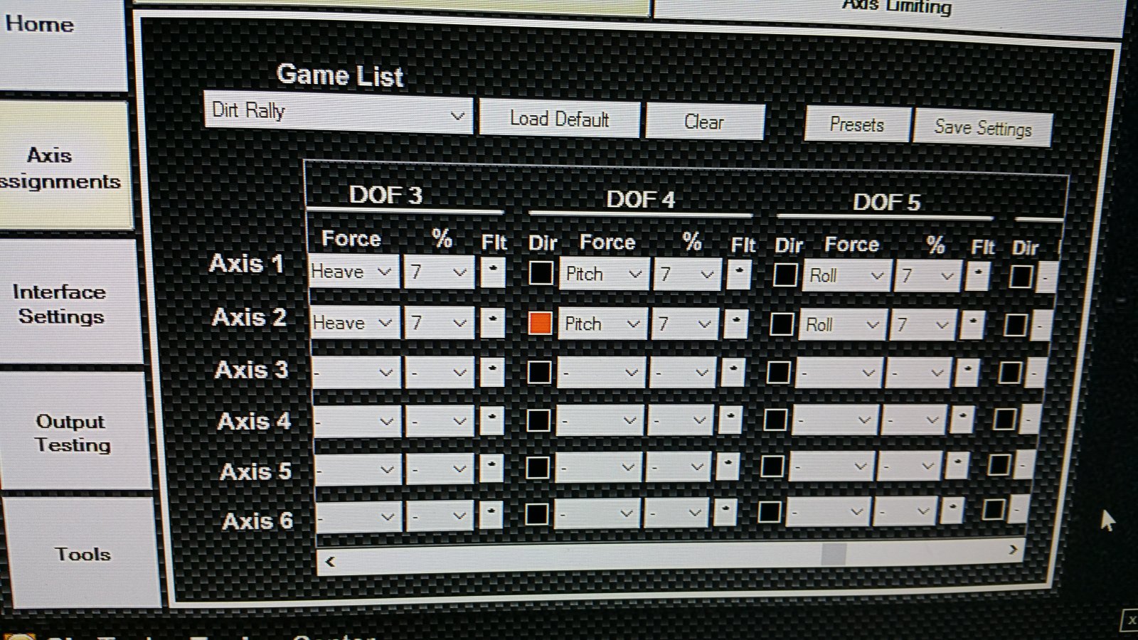

    This is with the setting's i had last night just before i hit the sack ,,
    I'll try cranking the Pitch&Roll right up today ,,

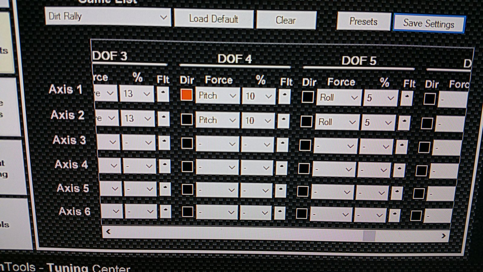

  11. Rastus
    Rastus Active Member
    Oct 8, 2011
    117
    Sydney Australia
    11,518Coins
    +151 / 2 / -0

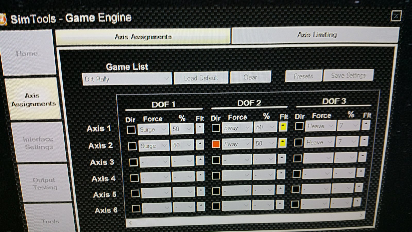

    @Nick Moxley I notice that the pitch has 1 motor inverted, then the other in the above pix. As the sway has 1 motor inverted I assume the 2 motors are synched correctly therefore the 2 pitch settings should be the same either on or off, that's how I've got mine setup and it seems right, up hill and down dale so to speak!!
  12. Nick Moxley
    17,056Coins
    +2,506 / 30 / -2
    IF thing's are done properly as we suggest and doing 1 force at a time. Its pretty hard to screw it up.....BUT, it wouldn't be the first time some one's had a Force counter acting what its supposed to be doing.......Double check @stevemontuno by either turning the %'s to 0 in the Axis or by using Really high Tuning center #'s and Test all forces individually. A wrong setting is again rather easy to pick out when there's only 1 force at a time.
  13. stevemontuno
    stevemontuno Active Member
    Apr 24, 2015
    316
    UK
    1,461Coins
    +335 / 0 / -0
    @Rastus @Nick Moxley Thanks for the heads up guys ,,for some reason i had my Roll & Pitch mixed up ,,,,, sorted now ,,,,,,that had my head bamboozeled for a bit ,,,lol

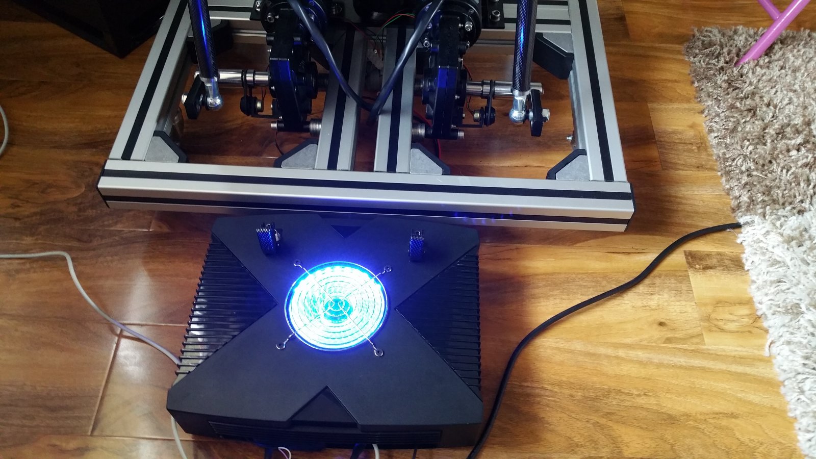

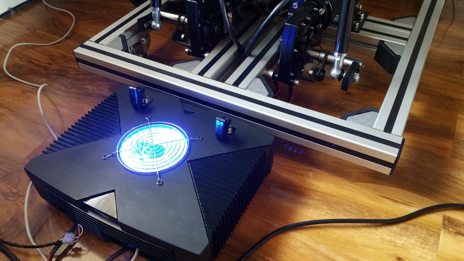

    A small update ,,I was thinking of buying a control box to put my wiring inside and then i remembered my brother saying the old original xbox i gave him years ago was dead so i went over and picked it up,,stripped the guts out of it, drilled a nice hole for a fan & put a couple of missile toggle switches on it and hey presto,,,
    I still need to put a couple more Monstermoto's in there and add some aviation connectors but it will do for now.

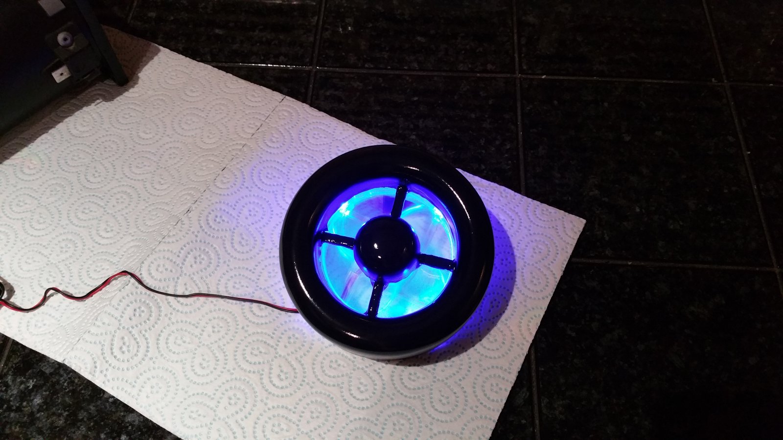

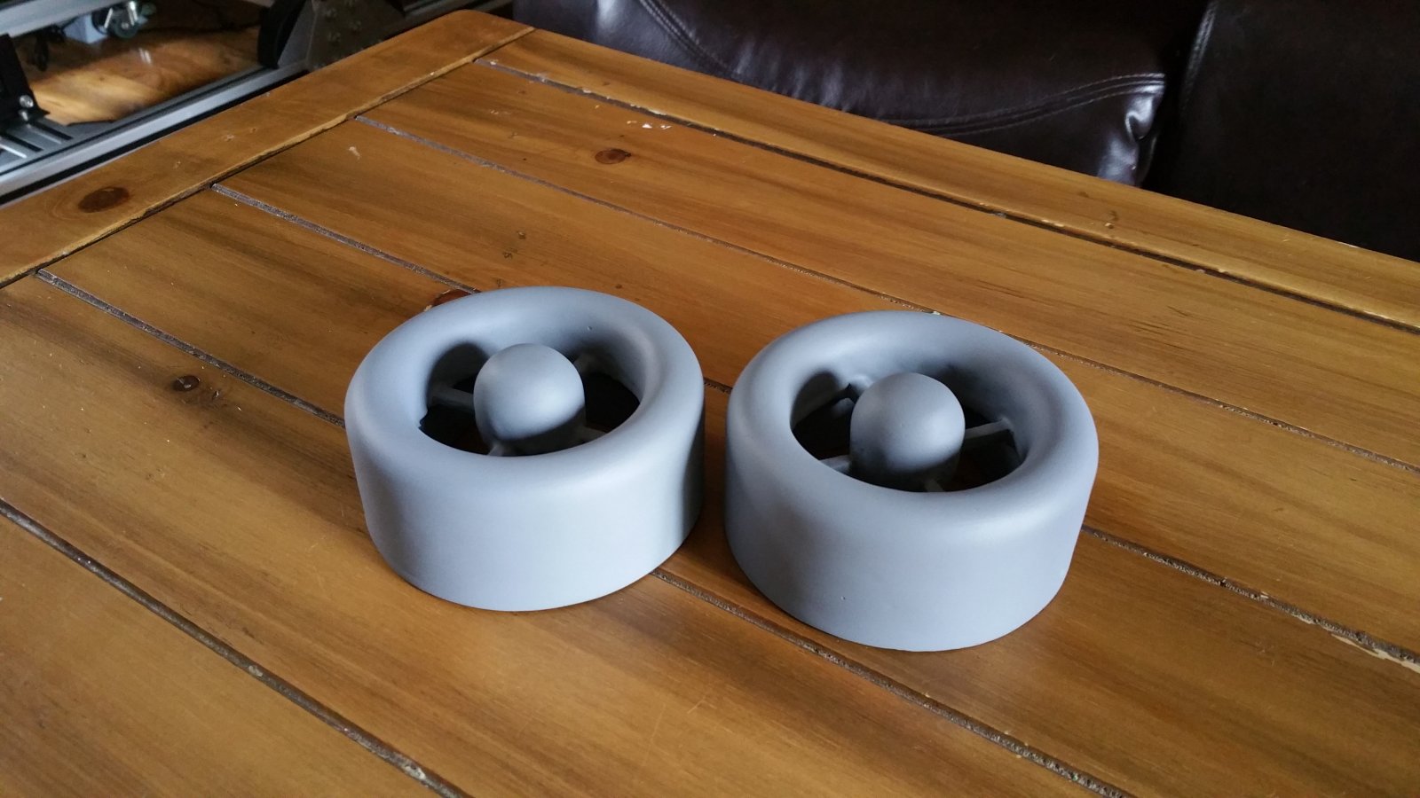

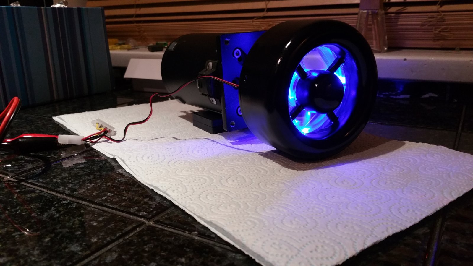

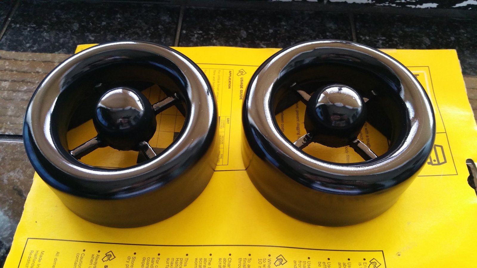

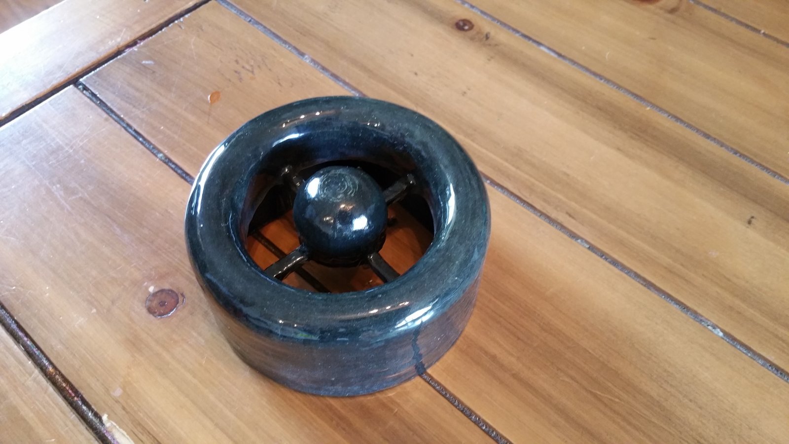

    Thought i'd throw in a long awaited update ,, I had to stop putting any more money into my 2dof project and put it into the wifes holiday fund project ,,,lol ,, Anyways we're back from the hols and 2dof fund is open again :) ,,,gotta keep em sweet ..
    So only thing i've done in the last couple of months is knock up some cool looking fan cases on the 3D printer ,,, i was finding after a couple of hours solid use my motors were getting quite hot , not burn your fingers hot but enough to make me think about cooling them down a little ,,
    Printed them and gave them a few coats of resin glue
    Then sanded them
    Few coats of Primer
    Few coats of black gloss
    Insert fan
    Jobs a good un
  20. noorbeast
    21,722
    152,045Coins
    +11,062 / 56 / -2
    Nice craftsmanship on the fan shrouds :thumbs
