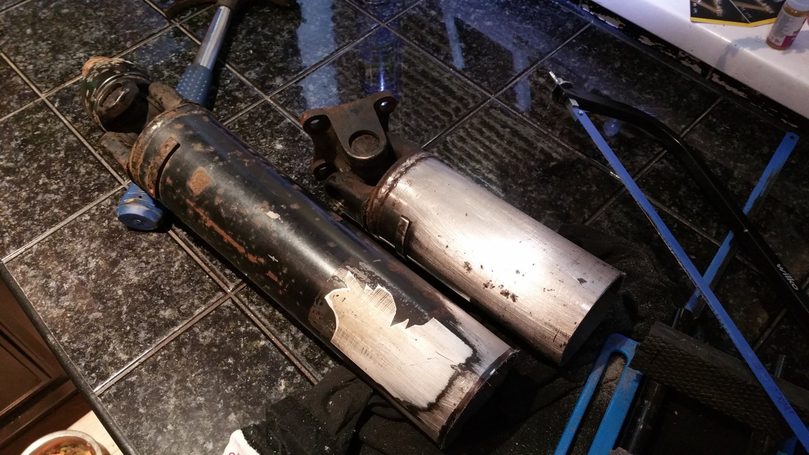

    hi, how did you get the thing so nicely cleaned up?
  5. Nick Moxley
    17,057Coins
    +2,507 / 30 / -2
    Looks like a good old wire brush scraping and i might even spy a rebuild job on there as well. And of corse the obligatory coat of black paint which makes anything look pretty slick.
  6. stevemontuno
    stevemontuno Active Member
    Apr 24, 2015
    316
    UK
    1,461Coins
    +335 / 0 / -0

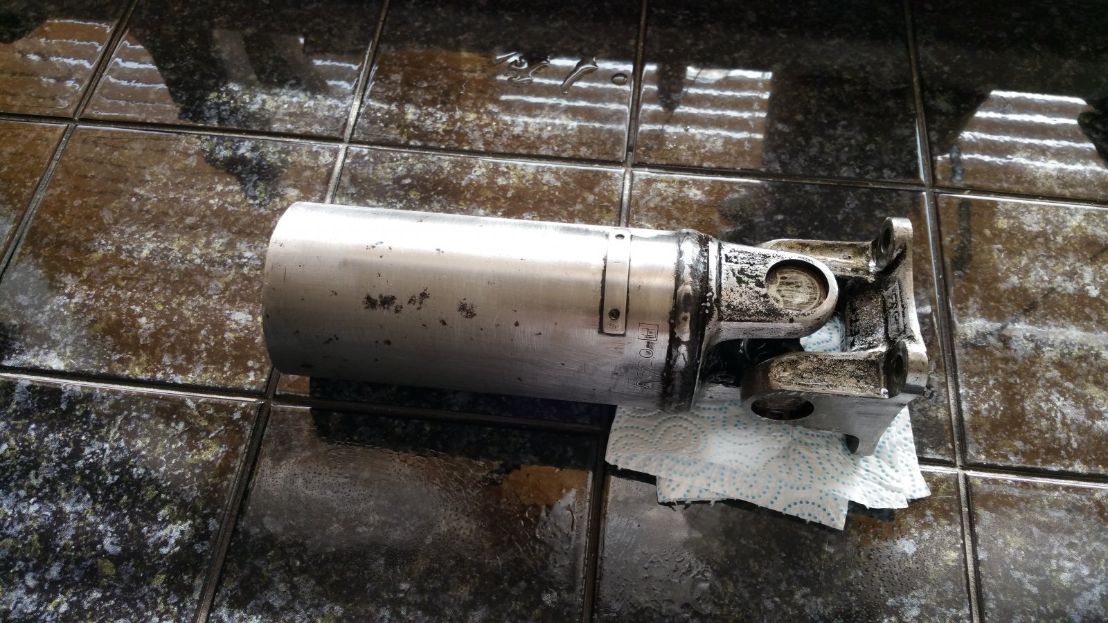

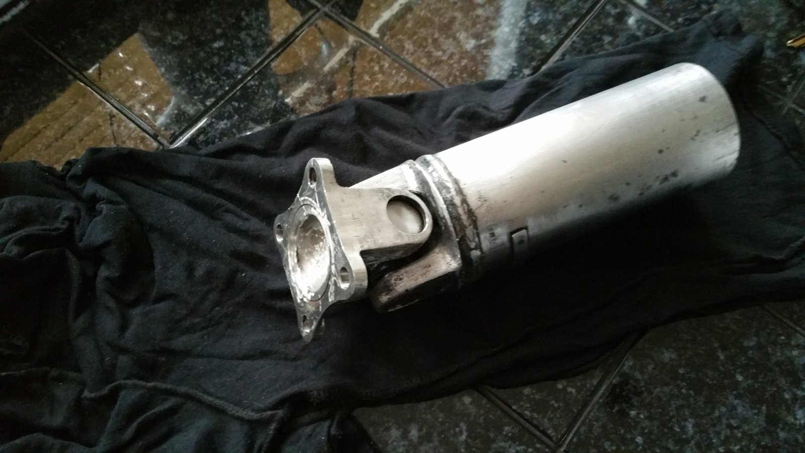

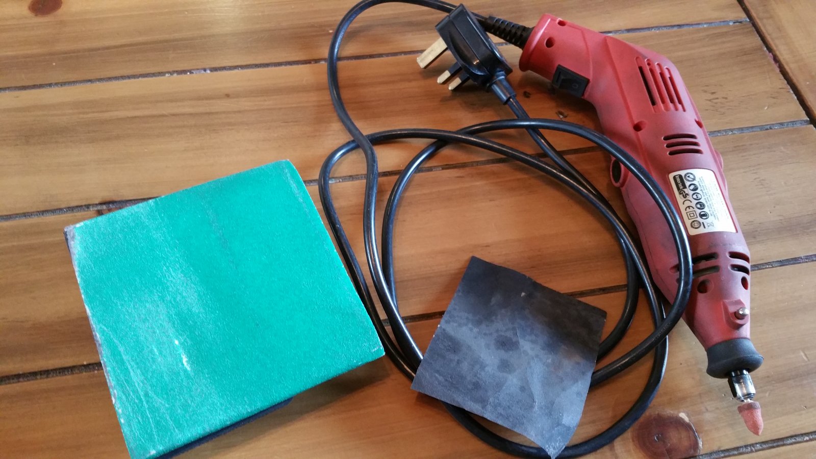

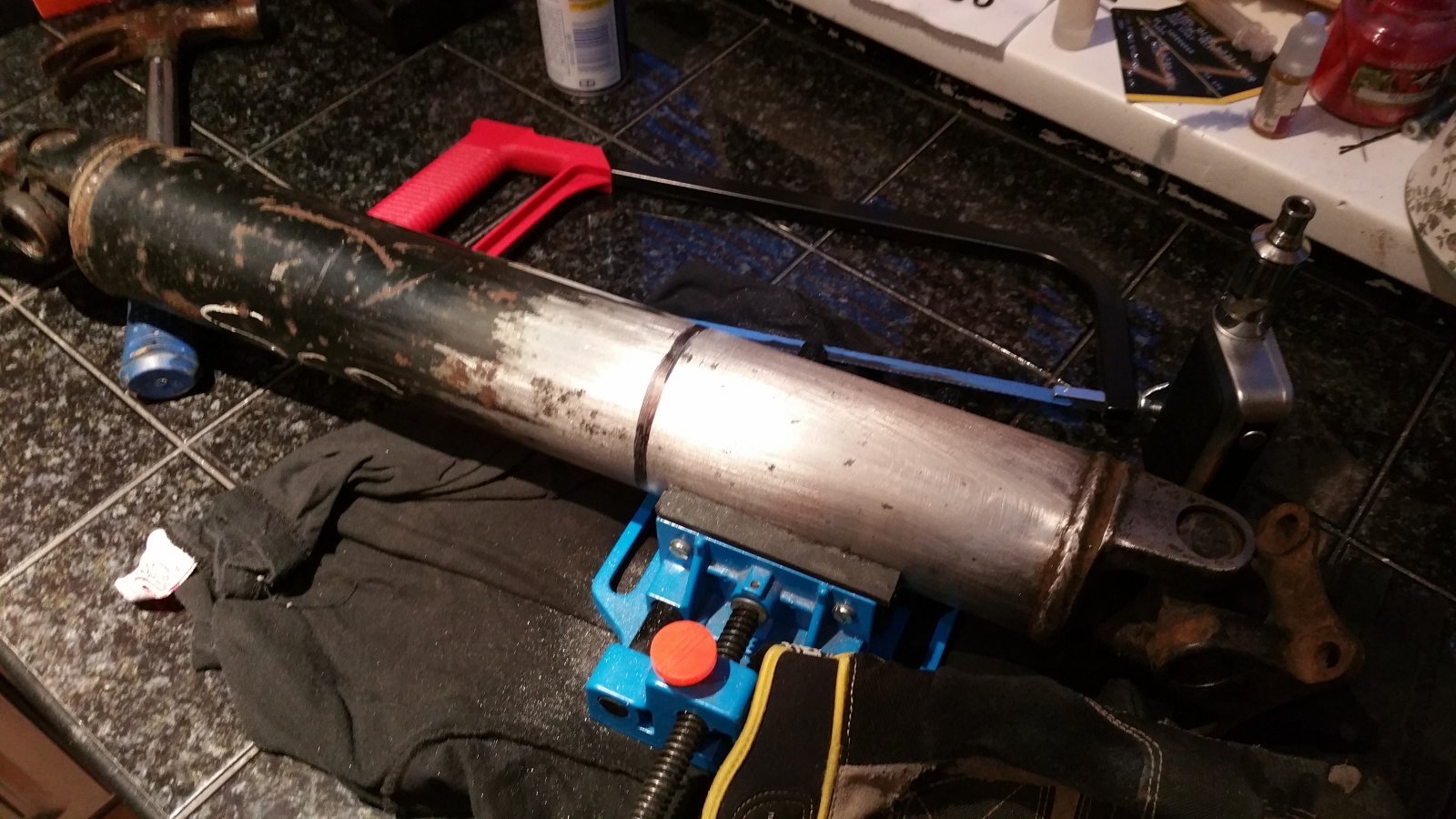

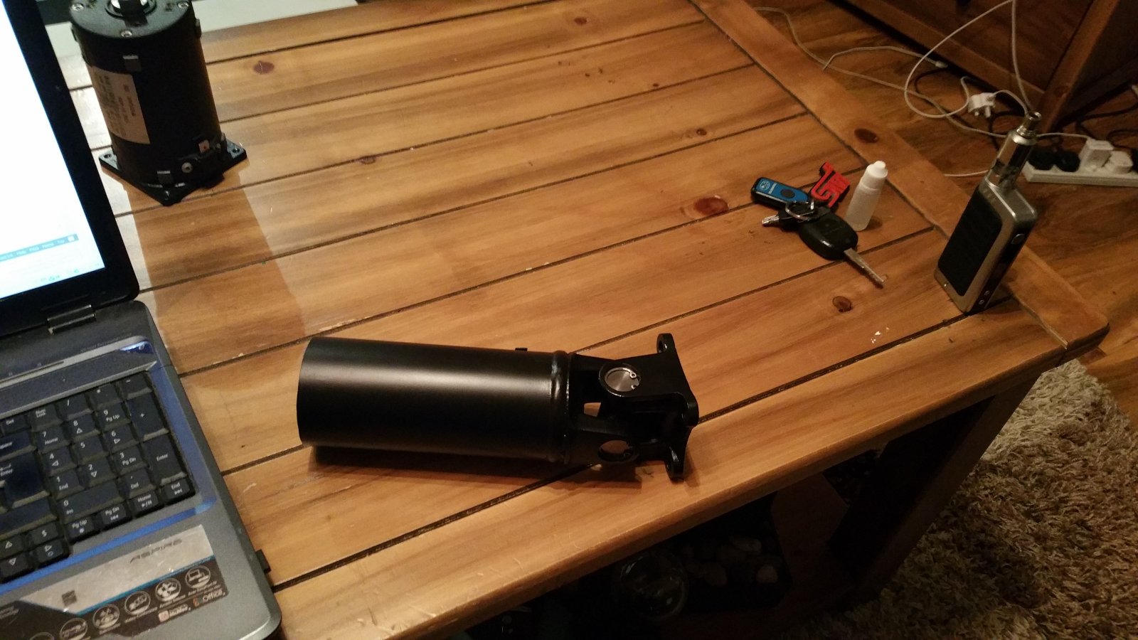

    @Sebj Pretty much just hours upon hours of sanding and dremeling & finished it with a couple of coats of primer then 3 coats of black satin,,,
    @Nick Moxley I was going to pull the joint and rebuild it but after i got the circlip's off and put it in a vice to get the caps out i realized it could easily turn into a nightmare ,,,lol , so i decided not to bother taking it apart,,
    Sanded the shaft & measured and rapped some A4 paper round the shaft to mark a cutting line,
    Cut it with the hacksaw,
    I used the green grit sandpaper for the shaft ,,,the dremel with a stone tip on it for the joint & the fine 240 grit sandpaper for the caps, i also used metal polish on the caps,
    Once i had it looking pretty clean i painted an anti rust solution onto the very small speckles of rust that were too fine to sand out,
    Then i sanded and dremeled again,,,lol
    And then the best bit ,,,Spray Paint ,, i glued a 1 euro coin to a bolt which fit perfectly into the cap hole so i wouldn't get paint in the caps, and lastly i dremeled and sanded the circlip's and put them back in.
    A bit overly done i know but i wanted it looking like new.

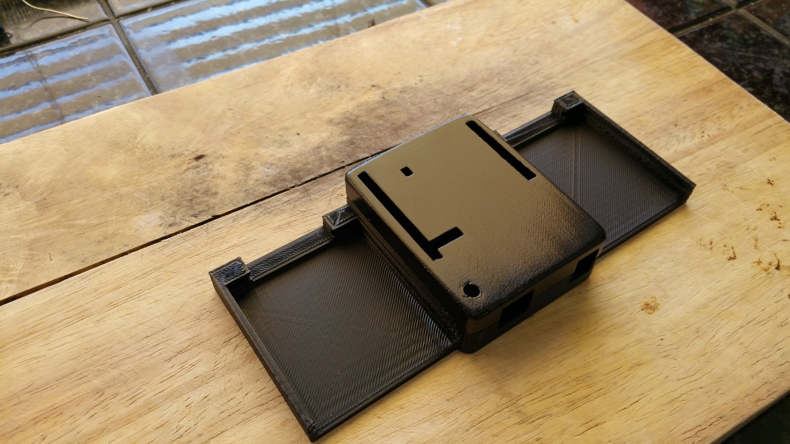

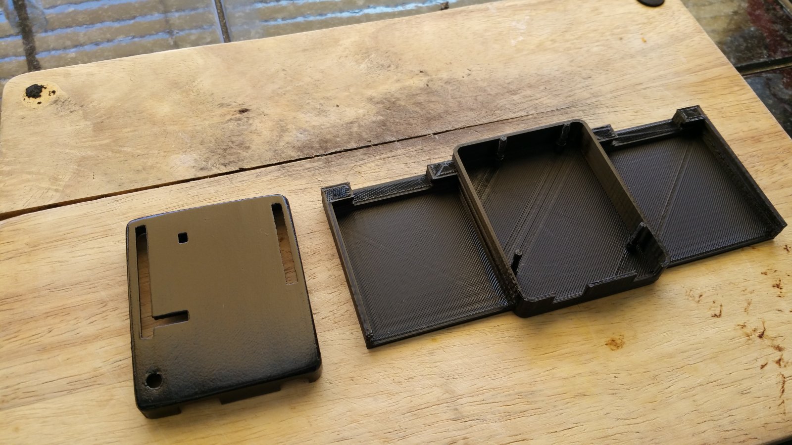

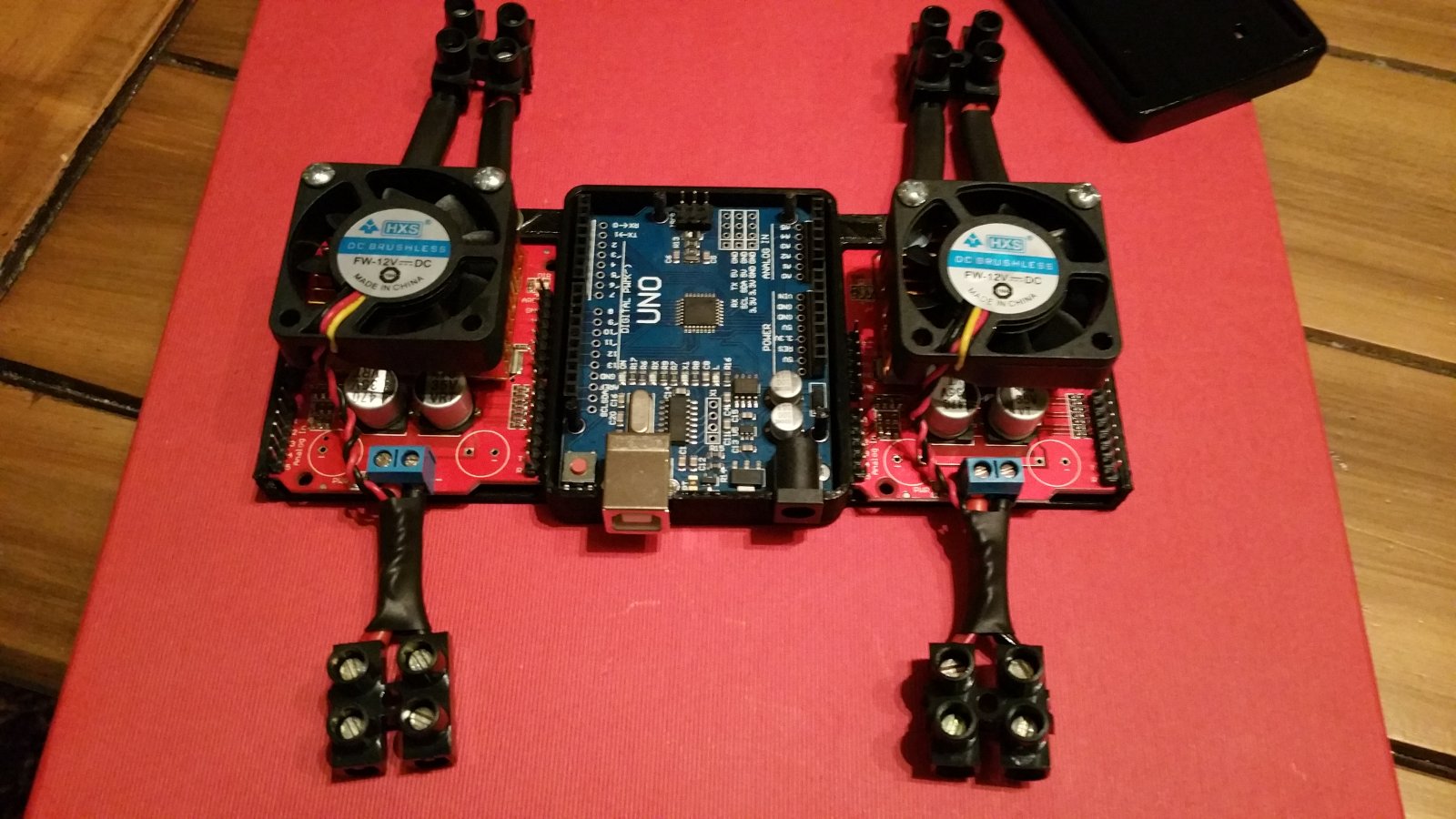

    A little update ,,,I got my second PSU & MonsterMoto in the post yesterday so i've been busy playing ,,, I wanted to try to put the electrics together so that it doesn't look too messy , so when i get a case to put it all in i'm not p!ssing around with a big mess of wires ,,lol
    So i went on thingiverse and found an Arduino case , then downloaded and put the file in Sketchup and added a couple of MonsterMoto wings too it,,added some grooves for the MM's to slide in as i wanted them raised off the deck in case they get hot,,,and then 3D printed it,,,,definitely made things a lot easier to work with,

    +11,196 / 57 / -2
    Brilliant idea @stevemontuno!
    Can you please provide links to the 3D print files?

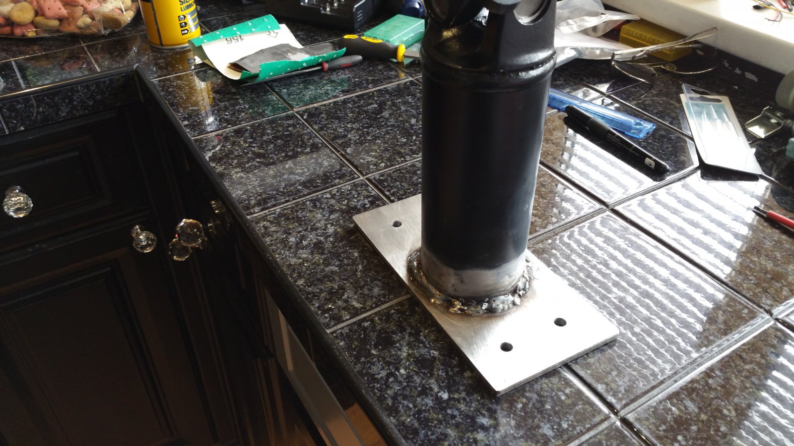

    Finally got my U-joint welded ,,My mate who is a bit like "The Big Lebowski" was taking forever so i went and saw a mechanic i know this morning and he welded it me for free :) ,,,top lad,,,

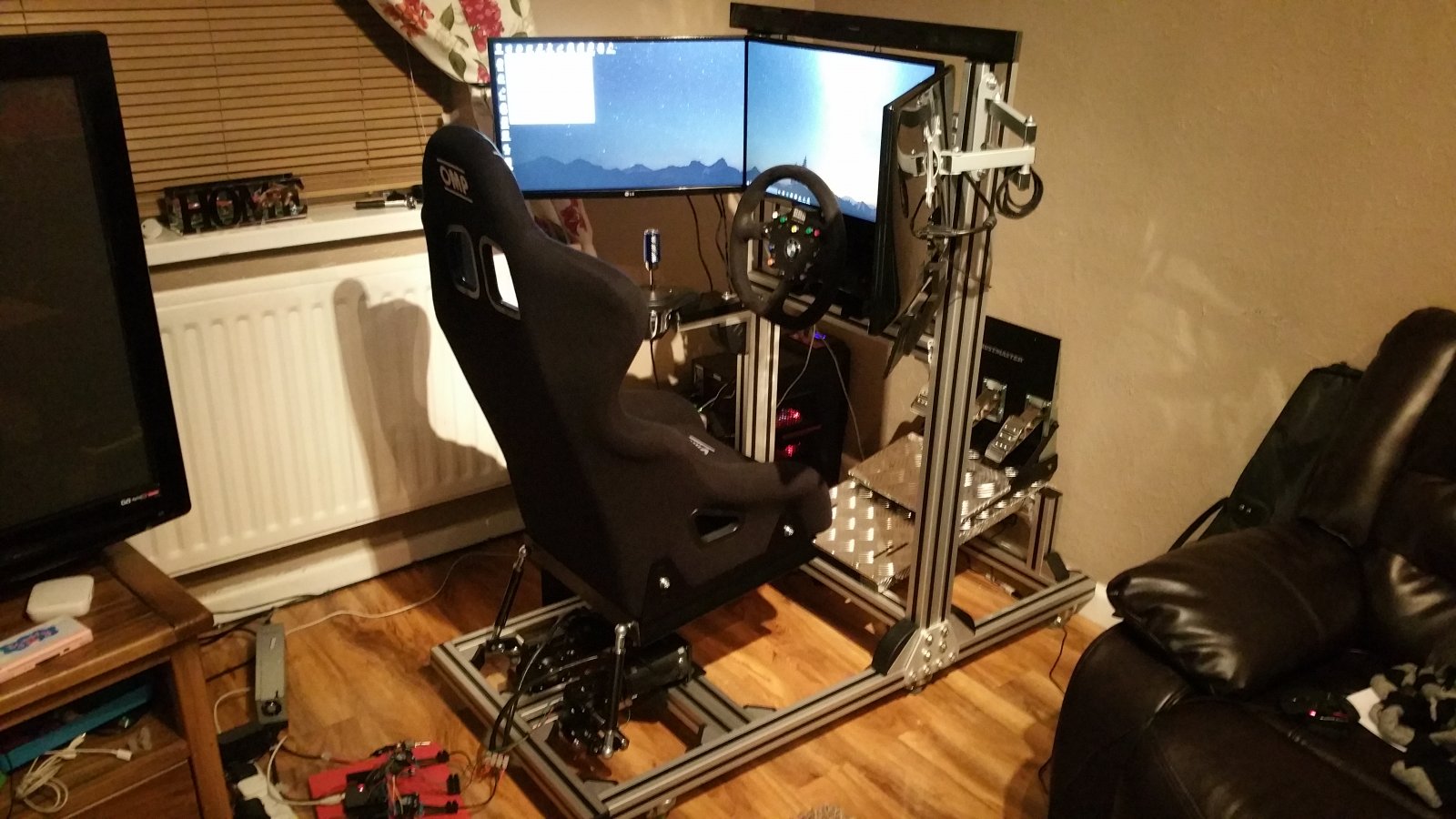

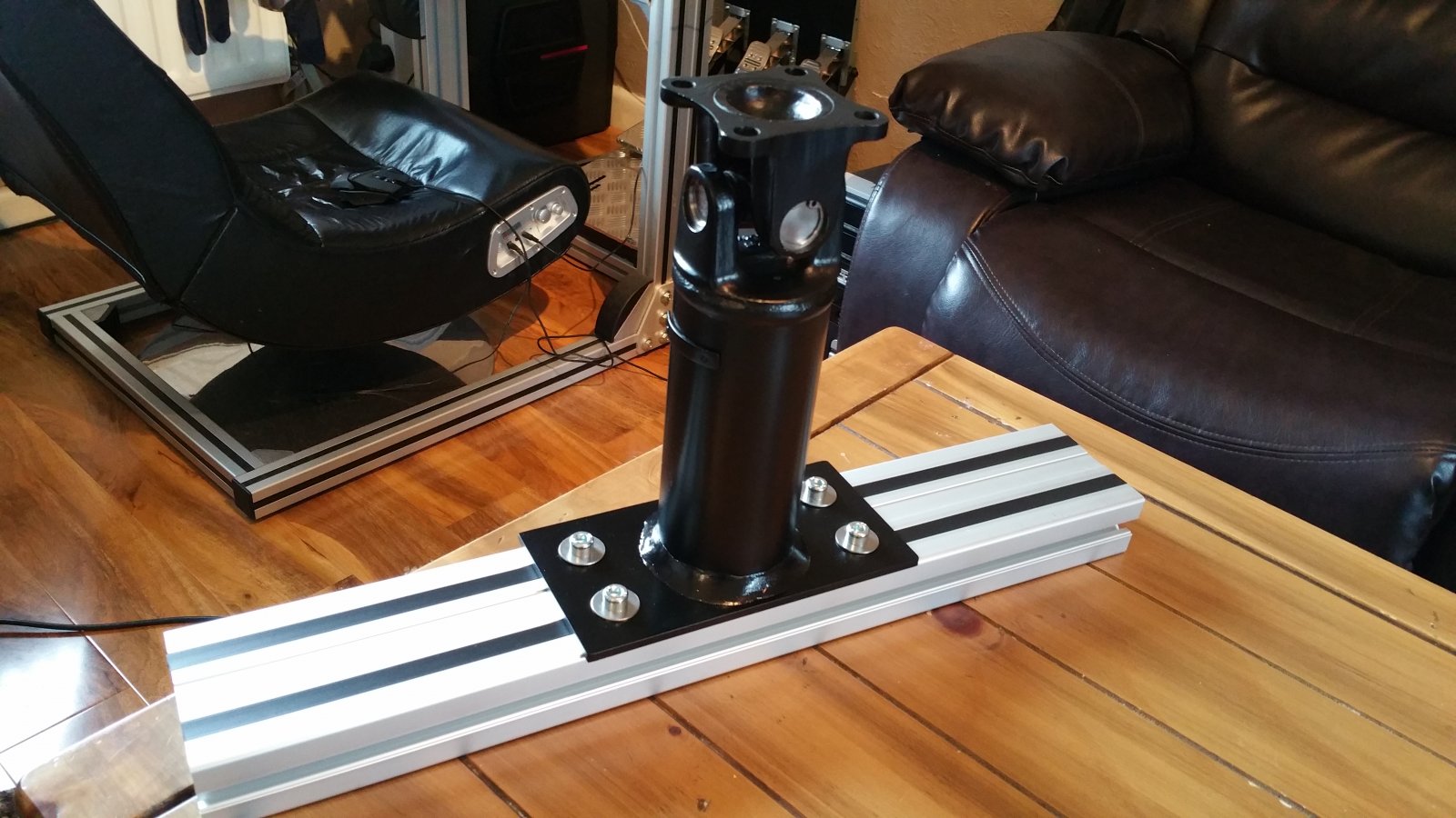

    Well it's been hard work the last couple of day's but it's paid off as i'm officially up and running ,,, :D
    Excuse the mess off wire's and stuff ,,,i still got plenty to do but at least i'm on to the fun stuff now ,,, :)
    • Like Like x 5

    i just need to get some thermal paste now as the thermal heatsink pads i'm using are real crappy and my MM's are getting really hot ,,Might need to get a couple more MM's and use 2 for each motor if that is a better way of keeping the heat down ,

  19. Nick Moxley
    17,057Coins
    +2,507 / 30 / -2
    Sweet, now lets try and get a little more twitch from that setup....care to post up your tuning center and Axis settings ?
  20. stevemontuno
    Apr 24, 2015
    316
    UK
    1,461Coins
    +335 / 0 / -0
    Cheers Nick ,,, Yes no probs mate i'll post them up in a bit for you to check out,,
