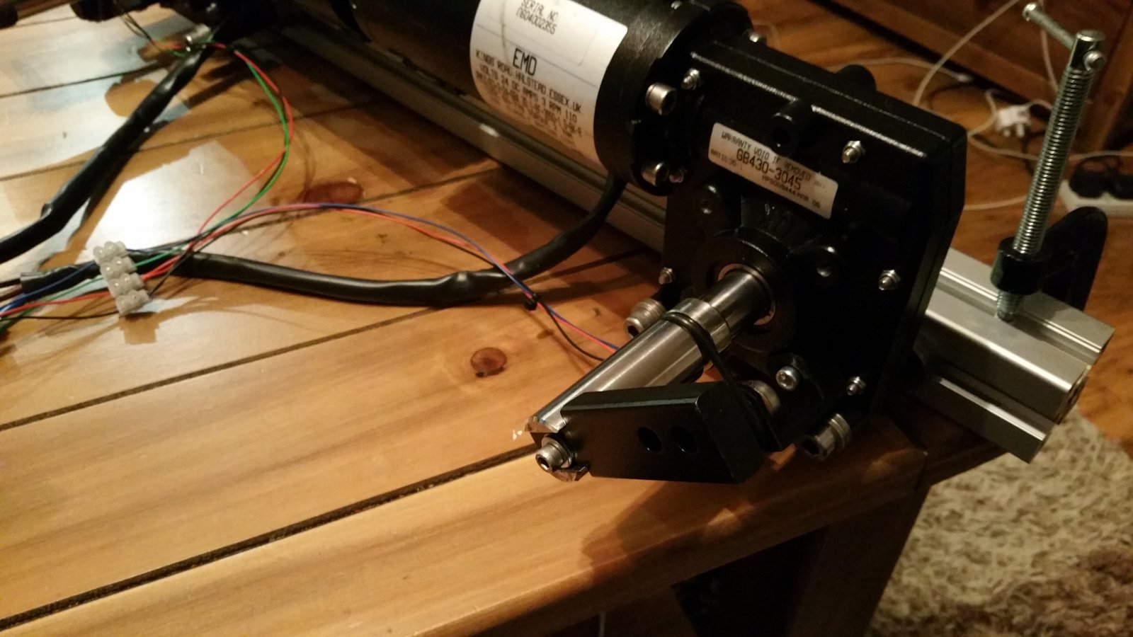

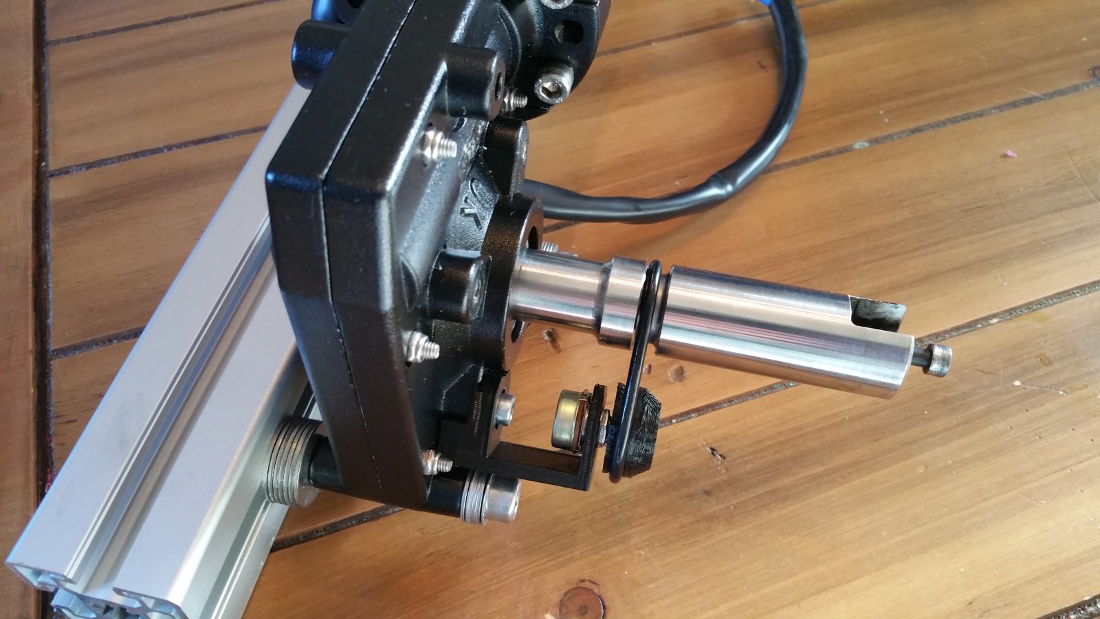

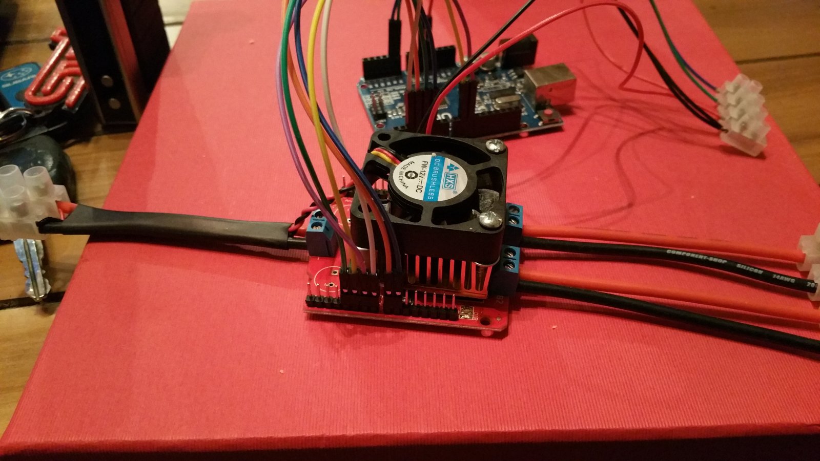

    Well my O-ring kit finally arrived today :) so was able to check if my pots were going to turn ok with my 3D printed bracket & spool ,,,everything turned like clockwork so hopefully they will work ok when i do some tests,,
    By the way those pots are super cheapo but just wanted to test the theory before i get any decent ones,,
    Just going to be putting 12v though the motors with the Ard + Monster Moto for now until i get a sabertooth.

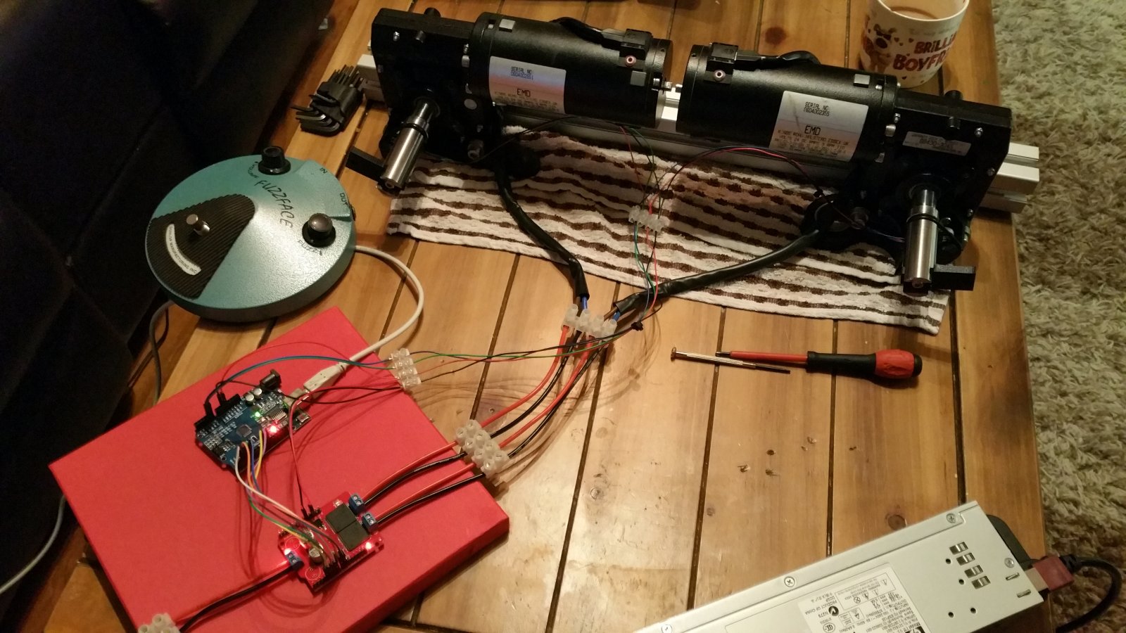

    Wooohoooo ,,,,,,lol :D ,, i got everything connected and linked up to the PC tonight using @RufusDufus SMC3 ,,and after a very basic setup in Simtools & SMC3 i got to see it working in game ,,,i know its only the motor's moving but i'm feeling on top of the world tonight :)
    I guess the next step is to sort a new seat and a U-joint,,
    P.S the guitar pedal is just a paper weight for the Ard usb cable,,,

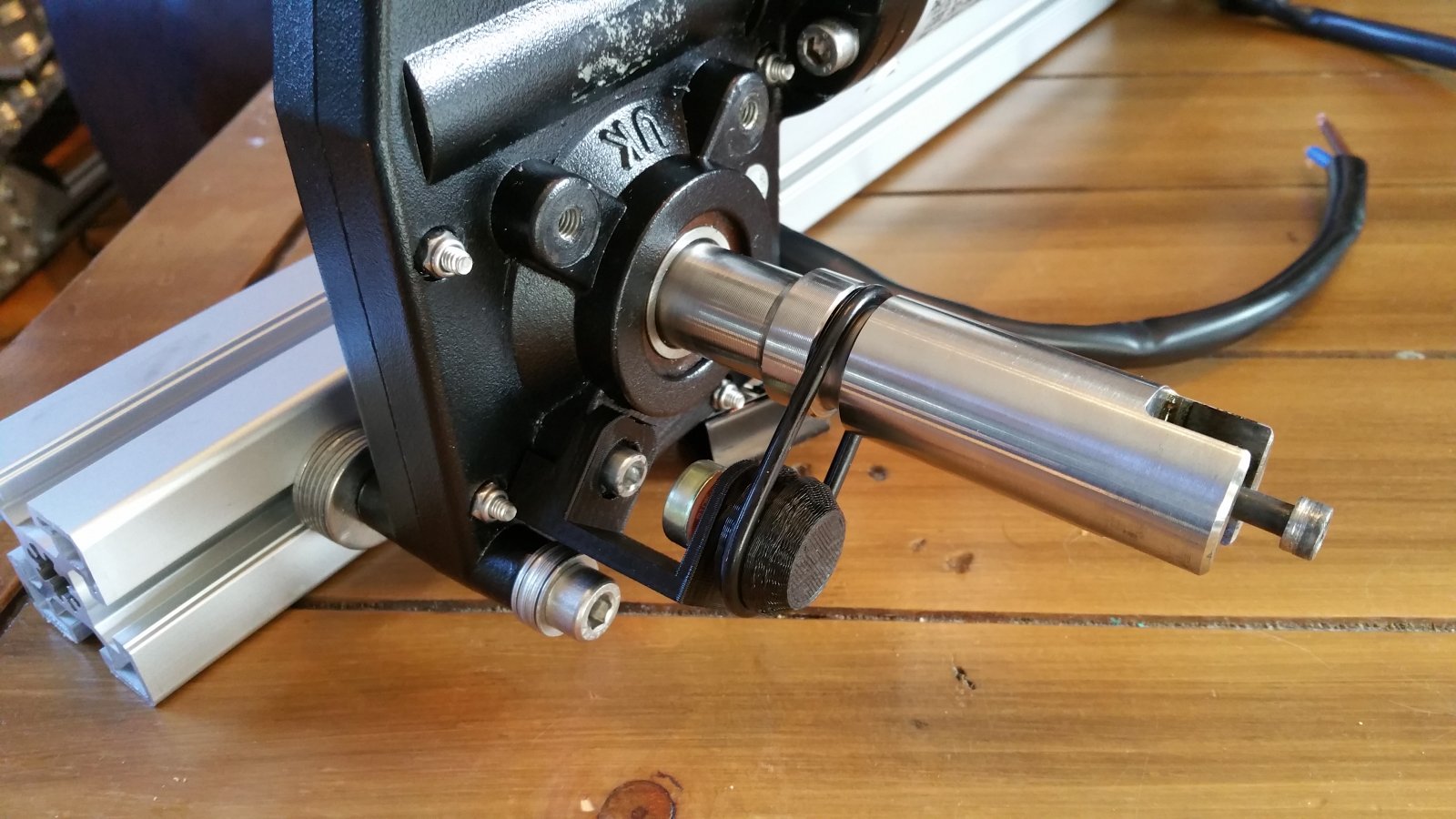

    @stevemontuno just a word of caution on your pot mount system. The way you have them connected to the output (rubber o-ring) puts a great deal of side force on the pot shaft. This could kill them early. A direct link on the other side of the gearbox might be safer and more accurate.
    • Agree Agree x 3

    Cheers for the heads up @Historiker ,,,There isn't really much force coming from the O-ring's to be honest ,,but i guess they are going to be doing a hell of a lot of work so i might try drilling the center of the axle this weekend and mount them like you say,,, thanks for the input dude,,,

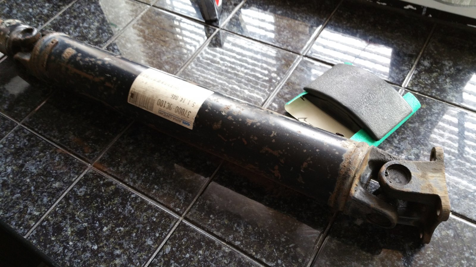

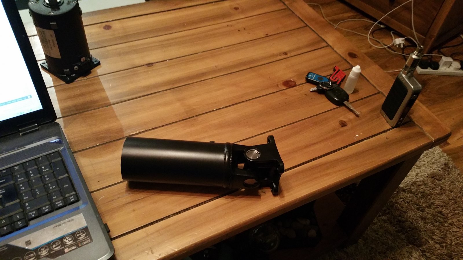

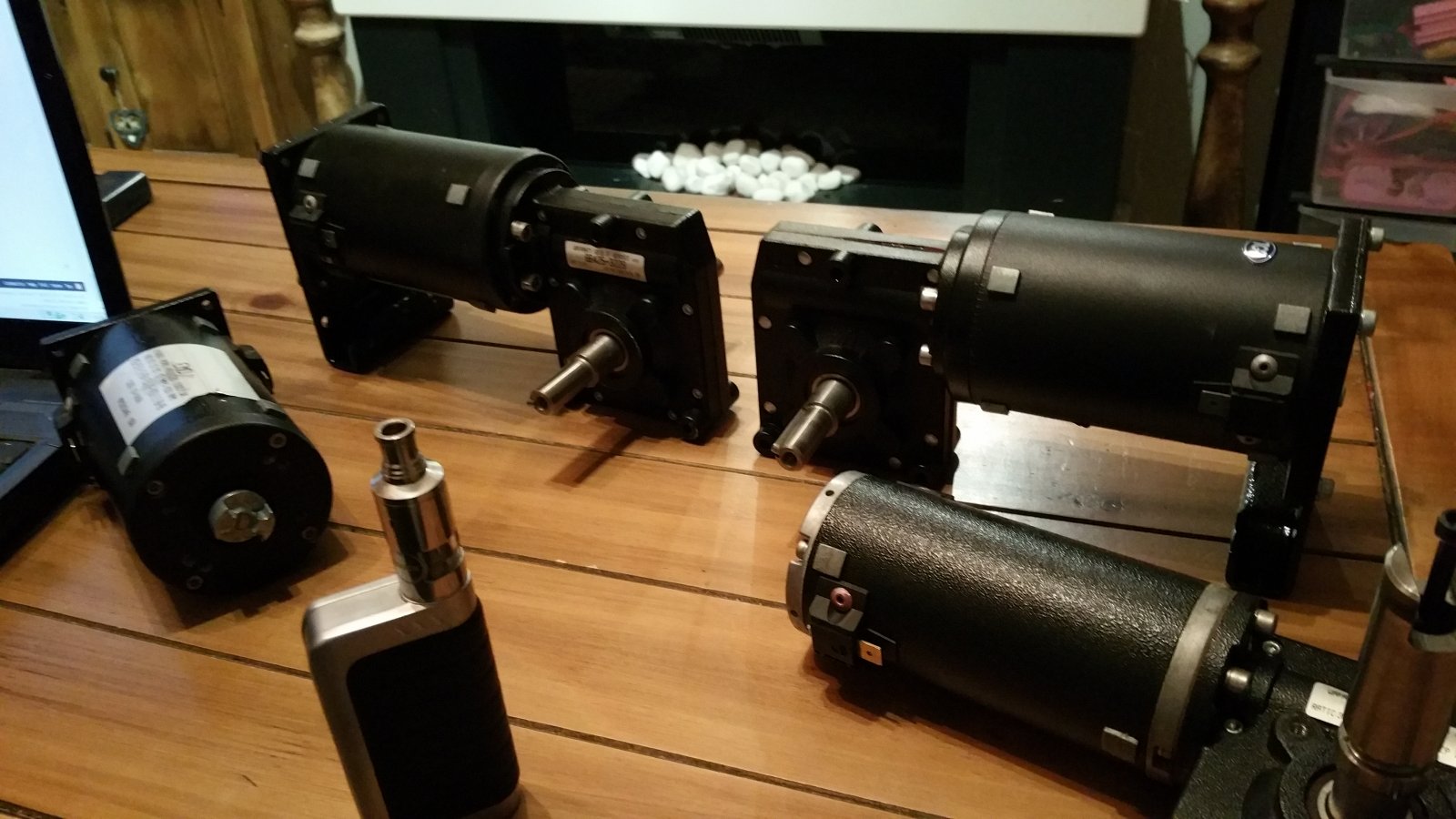

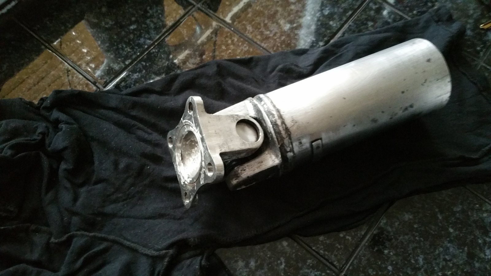

    Just a few minor updates ,,,,,
    I made a couple of paddles for the motors,
    Also went to the scrappy and picked up a Propshaft , just waiting on my mate to come round now with his welder so i can weld it to some steel plates,
    Put a heat sink and 12v fan on the monster moto,,need to grab another MM and do the same again,,

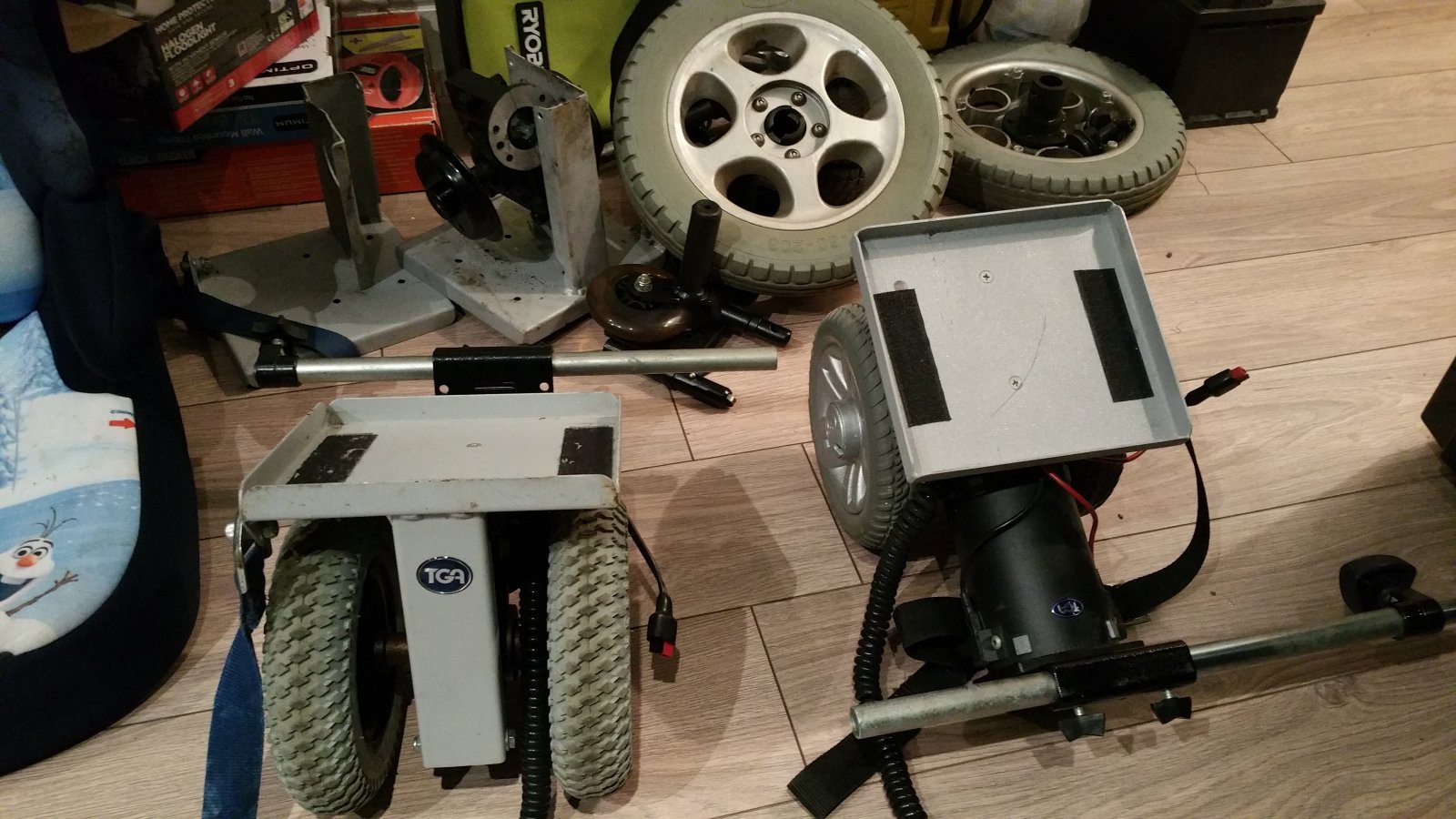

    Also tonight my bro came round with another 6 motors for me , 2 of which were the 24v ones with the 30/1 gears , but 4 of them were 12v motors on the same type of gears but 25/1 ratio 3 of which were really big ,,
    The specs on the large motors are ,,12v , 15amp ,, 150rpm ,,, and 200w ,,it doesn't mention the torque ,,they are pretty beastie though and also have a bracket on the back of the motor for support,,,
    This might interest you @Nick Moxley ,, he said they are off of a TGA power pack for electric wheelchair,,the larger motors have 2 wheels attached to them,, the smaller ones having 1 wheel,
    kinda made my day seeing 12v on those motors ,,,i'll be putting those on the 30/1 ratio gears.

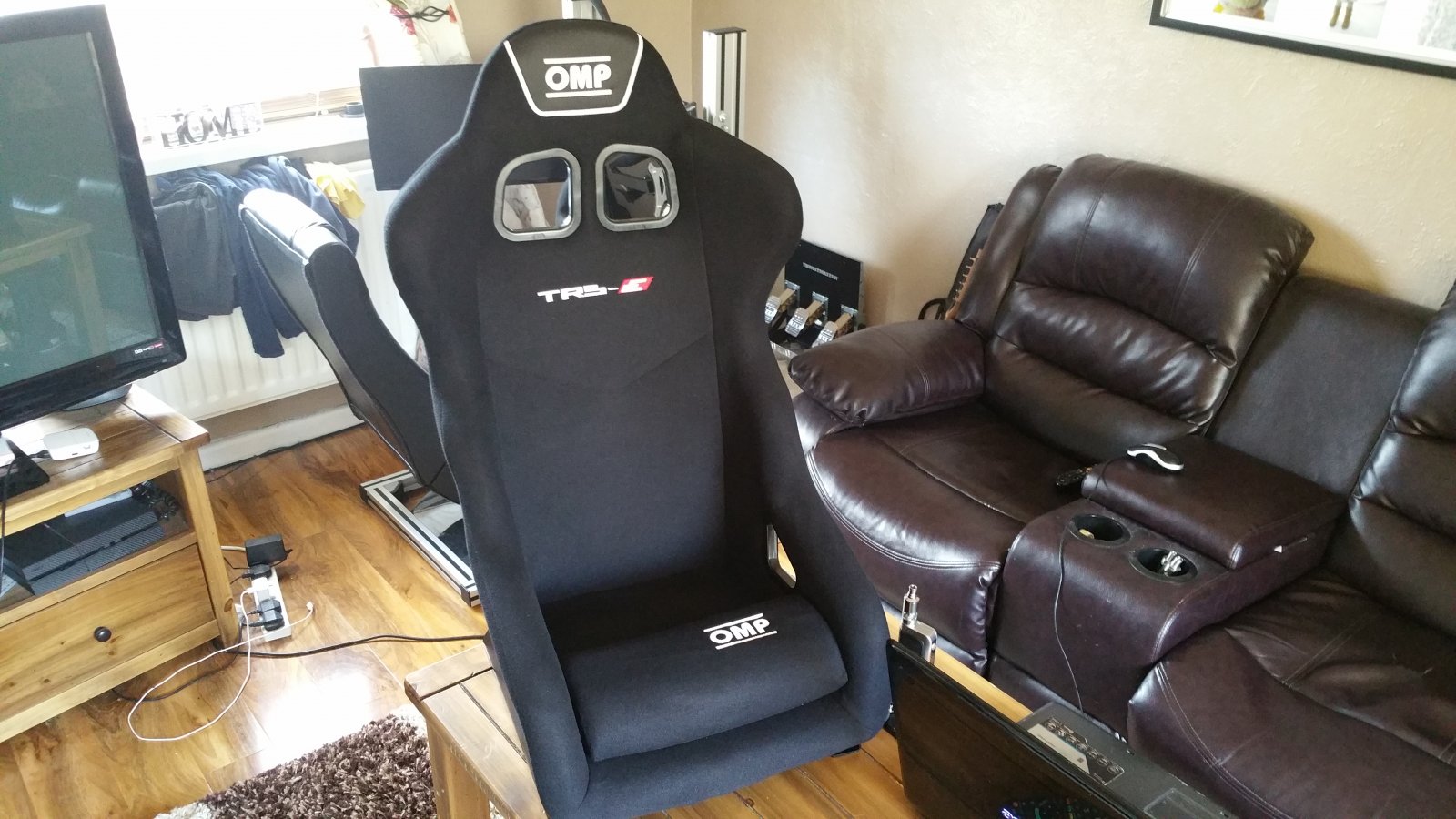

    My new seat came yesterday,,, i can finally start to take measurements and work out where things are going ,,,,it feels like i'm slowly getting there now,,
