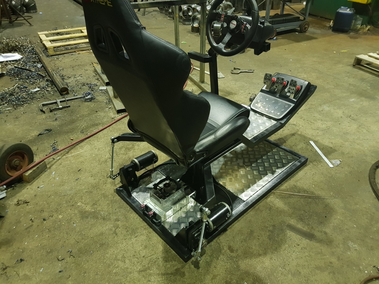

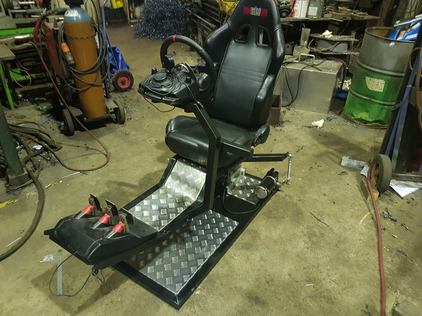

    Firstly I would like to thank everyone here for your wealth of knowledge. I had never used arduino before and have no real electrical experience and have managed to build a sim from scratch from reading all of your posts.
    I have just competed my full frame 2 dof sim and have tested it successfully. I am using SMC3 with Arduino, 2 x MM, 2 x HP server PSU and 50:1 motors.
    I was wondering how people have dealt with the slack in the gearbox of these motors?

    Great to see your rig and I look forward to a future video of it in action :thumbs
    A little bit of weight bias on the motor, rather than perfect balance, helps reduce how noticeable free play is.
    The longer the CTC the more noticeable the free play, so keep the CTC as short as it can be for your design goals.
    All wormdrives have a bit of free play, and need it for lubrication, it is more apparent after some use but this is about average:

    Thanks @noorbeast My motors seem to have a little bit more than that but I will try as you suggest and shorten the CTC and increase the movement in game.
    I will be adding a seat belt with tension springs on the shoulder straps to simulate braking. I am hoping this is enough to overcome the play.

    Thats looking good, impressed. Do you thing the wheel base will hold a direct drive? If so, I may make mine the same way.

    I haven't had the pleasure of using a direct drive so I'm not sure. I fabricated the frame from 40 x 1.6 SHS so it's light but fit for purpose.
