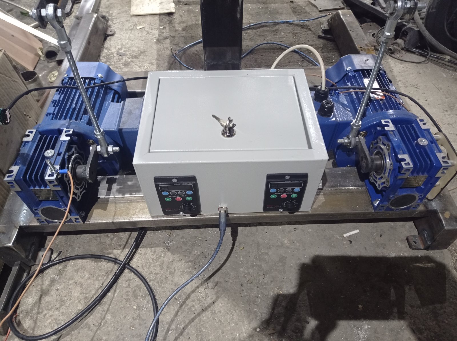

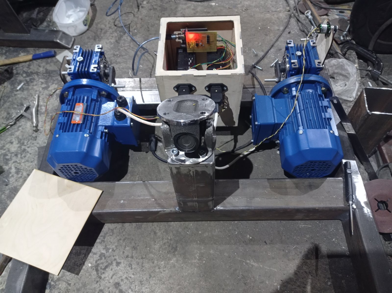

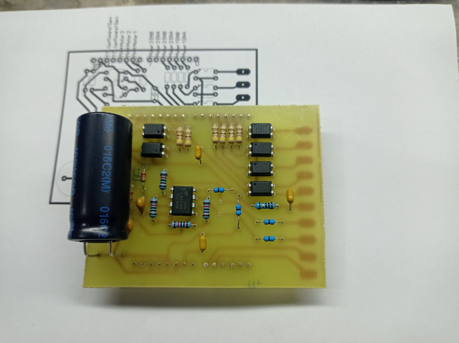

    I am building a motion platform on three phase motors.
    Controlled by SMC3
    The platform is almost built. There are some minor management issues. I want to use a platform with glasses. But when the Oculus quest 2 motors are running, it issues a communication error with the computer

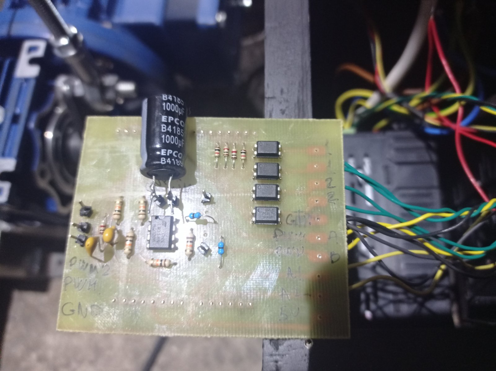

    Arduino uno and homemade shield pwm-analog. Lm358

    This frequency converter uses a 5 volt analog input. On the board, I did not provide an opto-link to the operational amplifier. I'll redo the board soon.

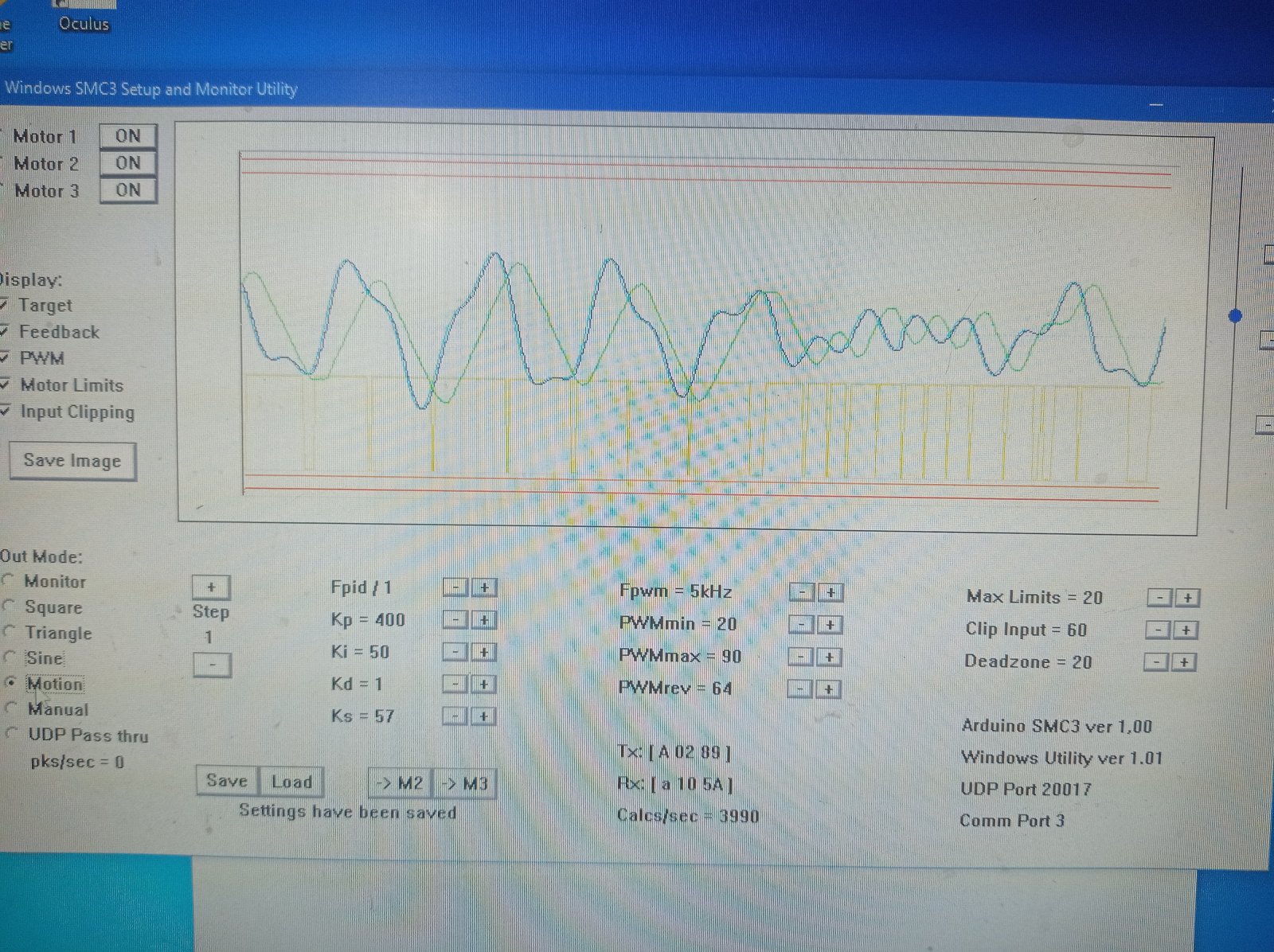

    The oscilloscope shows small fluctuations on the 5 volt line. I tried to install capacitors on the power supply.It got better but the problem remained

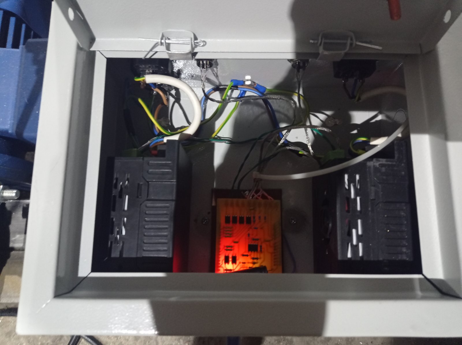

    The problem is most likely interference. I redid the board, added an optocoupler to pwm - analog. It did not help. I can attach oscillograms if necessary, but when the motors are running. Interference can reach one volt. Now I plan to put the frequency converters in an iron box. I tried to isolate the control board, which did not bring the desired result.

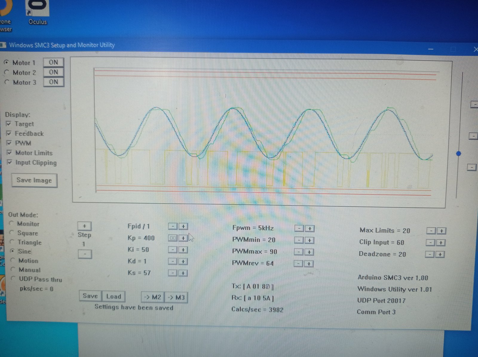

    Please look at the delay in work. This is fine? Who faced? I looked through the entire forum, but there is little information on the vfd motor

    Of course they were grounded. I needed to additionally shield the signal wires. After changing the box and shielding, everything worked perfectly. There is no interference at five volts. Glasses no longer fall off. Thanks to all who responded.
