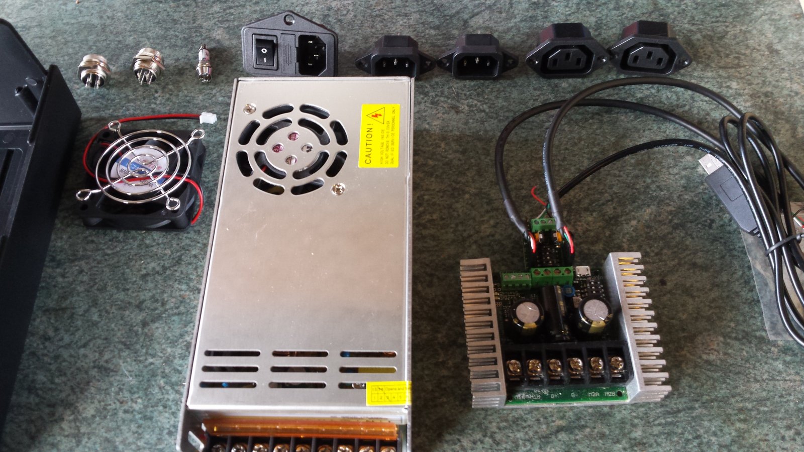

    I’ve set-up a mock-up to familiarise myself with the basics of the Dimension Engineering Kangaroo and Sabertooth.
    My 1st goal was to see if I get ant response from the wheelchair motors and I performed an auto-tune directly on the Kangaroo
    And there is life !!!!

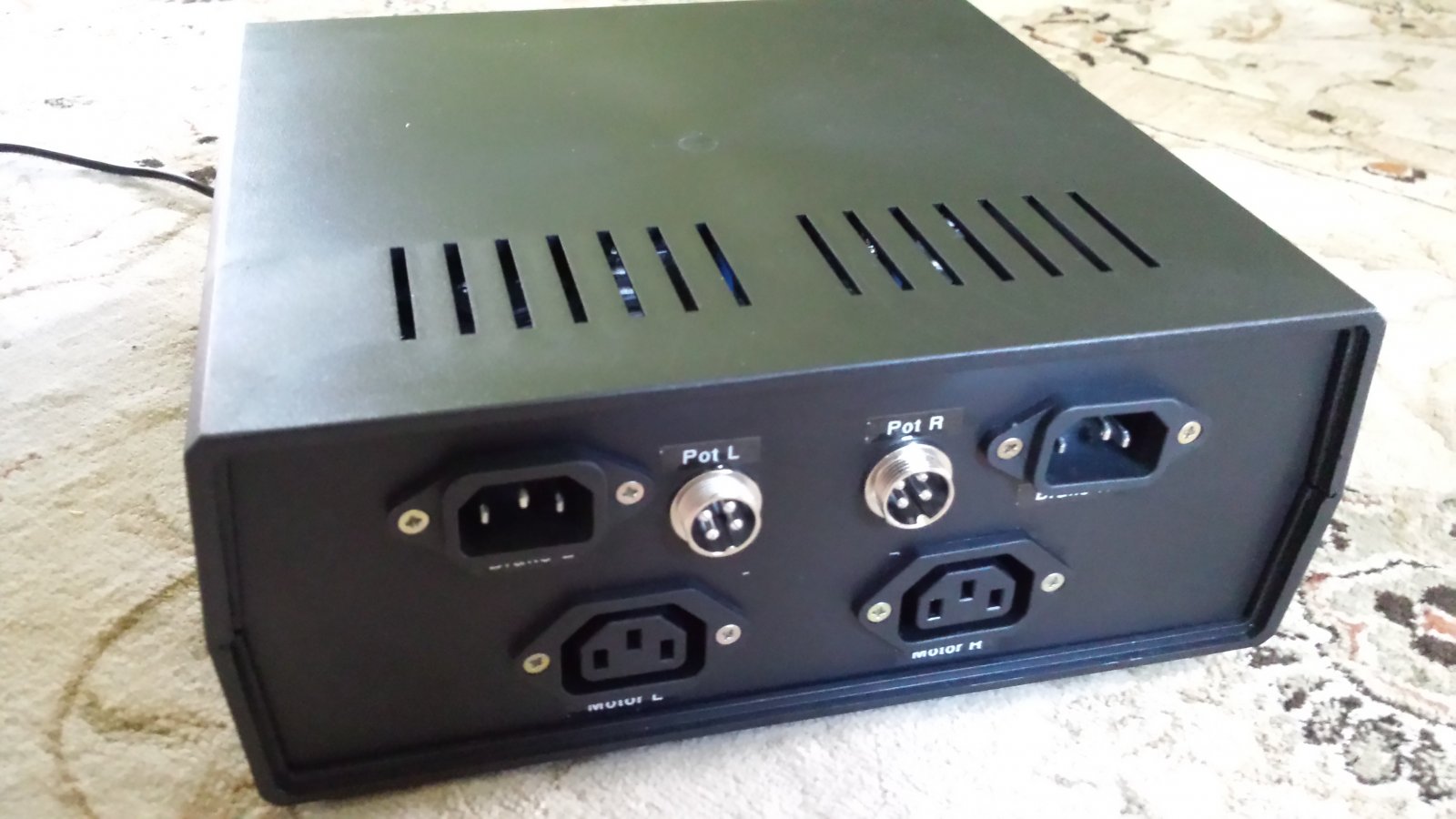

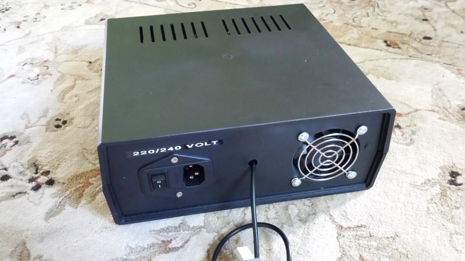

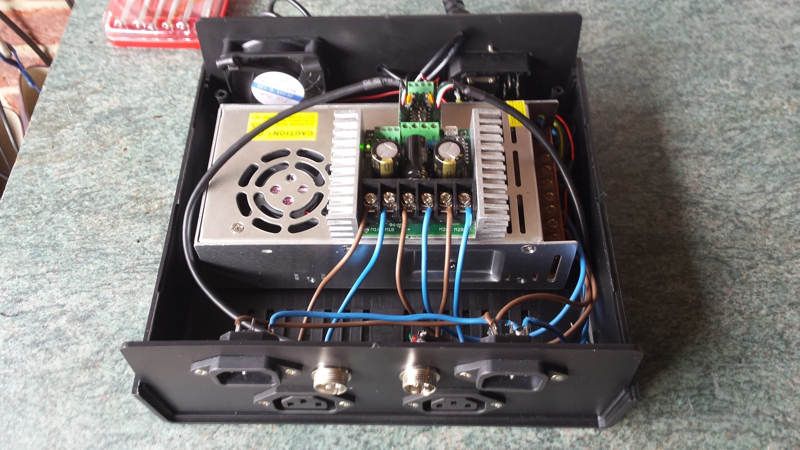

    The "electronics" are coming along nicely.

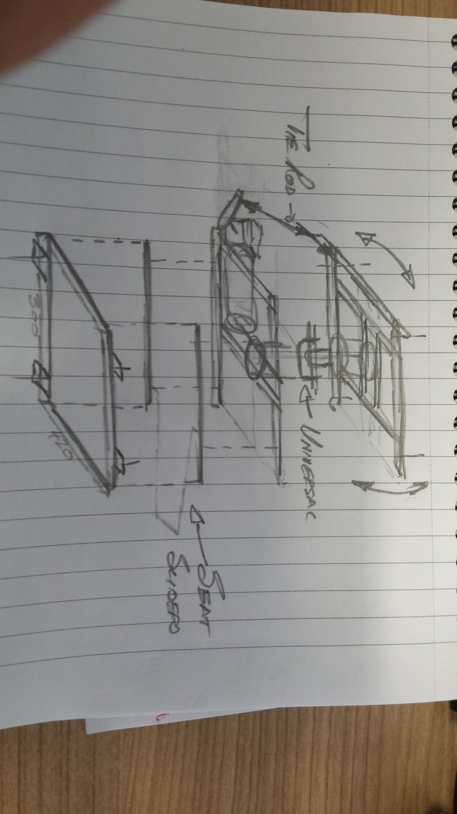

    The electronics was the fun bit. Now for the hard/dirty work.
    This is a complex build as the "seat mover" mechanism needs to fit into my existing rig. Space is limited meaning that the mechanism must be compact.
    It all starts by putting my ideas to paper (This is due to change as I progress with the build)

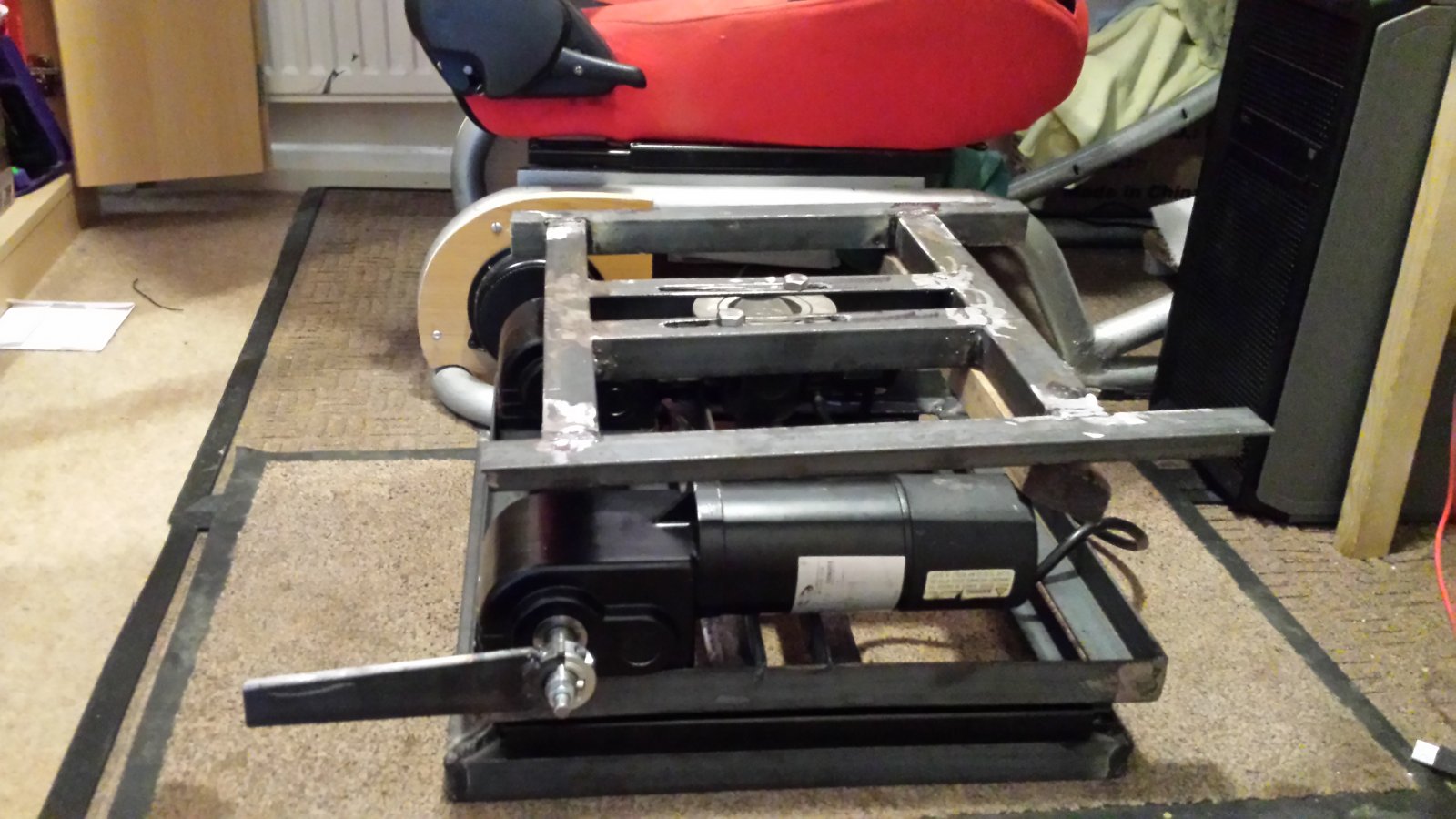

  6. Willem Pienaar
    Willem Pienaar New Member
    Feb 9, 2016
    29
    UK
    488Coins
    +16 / 0 / -0
    The concept is starting to take shape.
    Still a long way to go. The motion mechanism will eventually bolt into the existing rig (visible in the backgrounn)
  7. Tim McGuire
    Jul 26, 2015
    261
    Canada
    2,164Coins
    +313 / 2 / -0
    3DOF, DC motor
    That's some damn clean wiring! Nicely done! How much is that PSU rated for?
  8. Willem Pienaar
    Feb 9, 2016
    29
    UK
    488Coins
    +16 / 0 / -0
    Hi Tim. Thank you for the compliment on the wiring. The last time I've done something like that was around 40 years ago at school.
    The power supply is a "SANPU 24 Volt LED Power Supply Driver 600 Watt Constant Voltage"
    Regards
