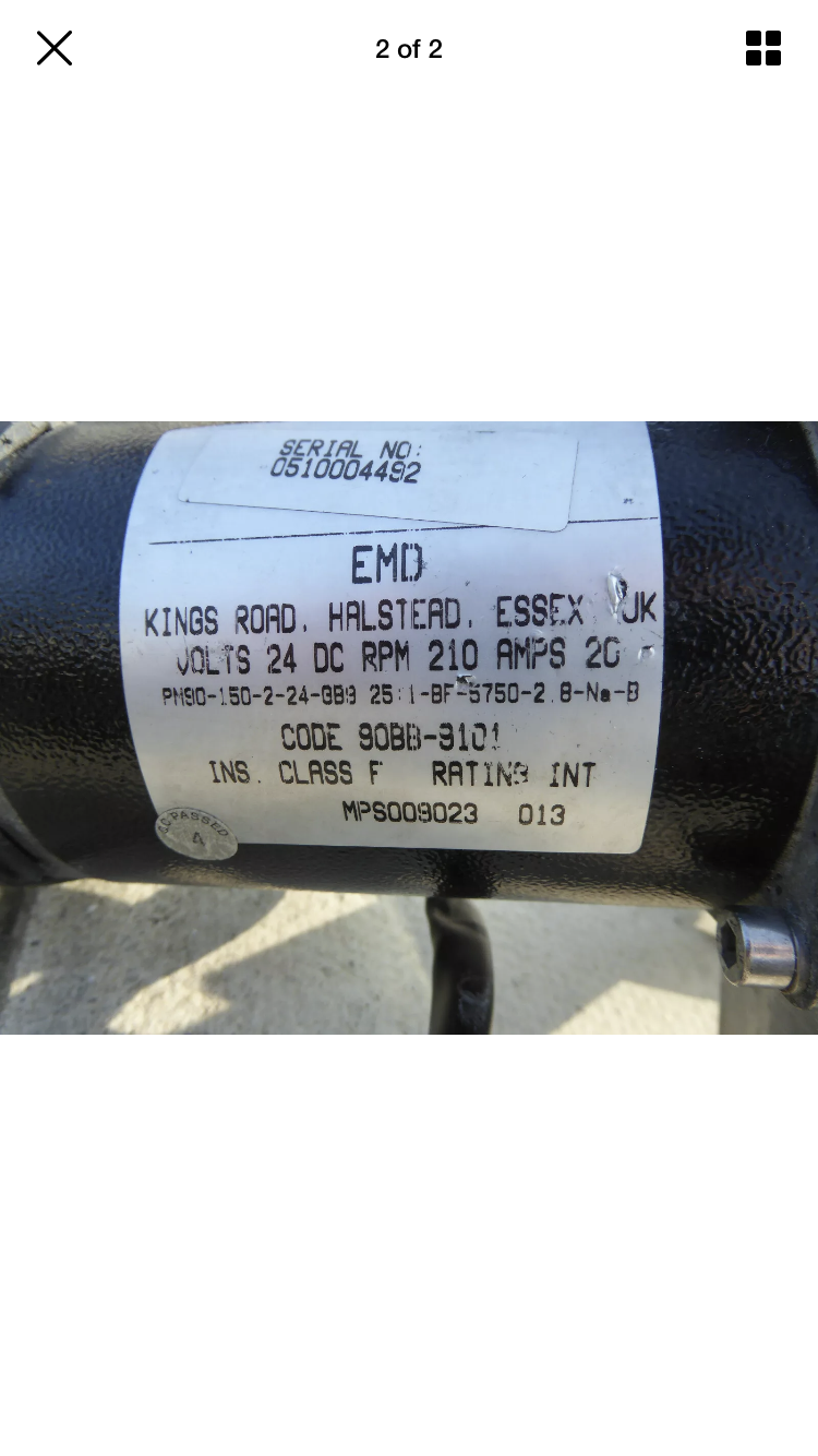

    Hi guys! Which controllers you will recommend to use for these motors? Thank you!

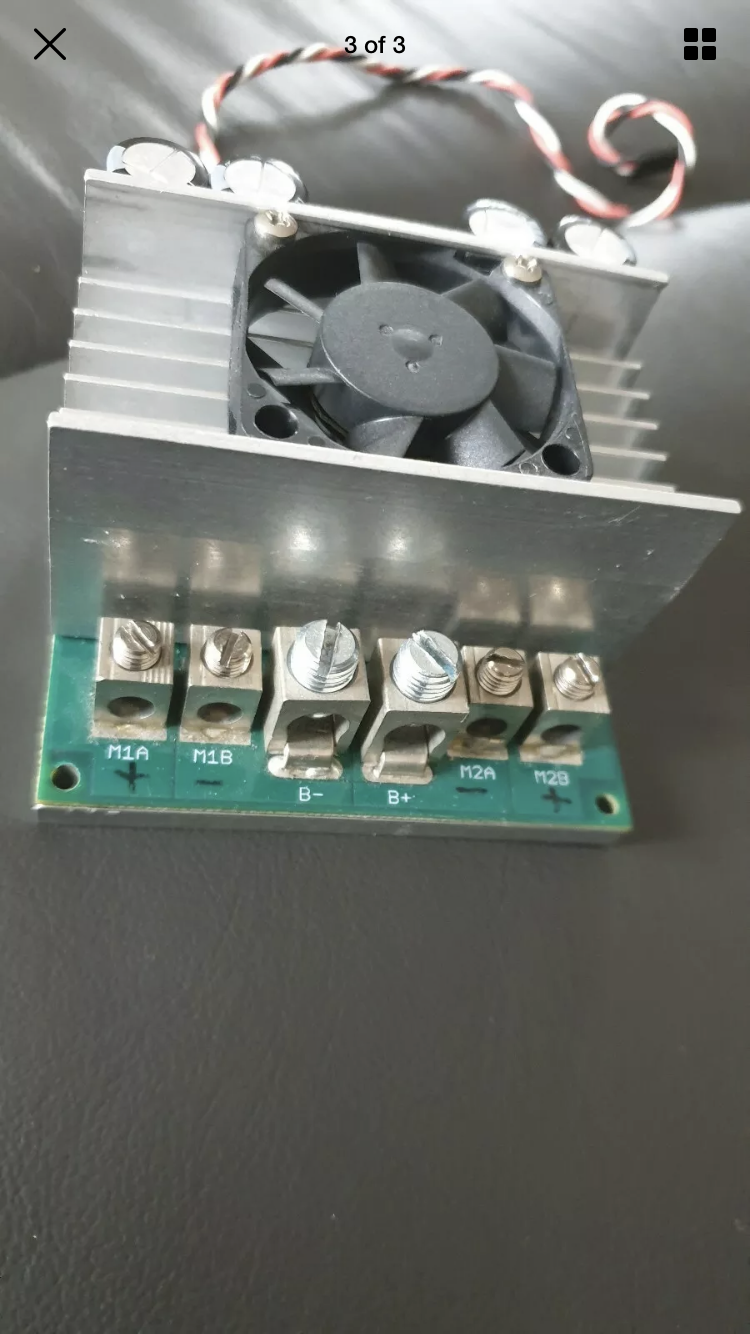

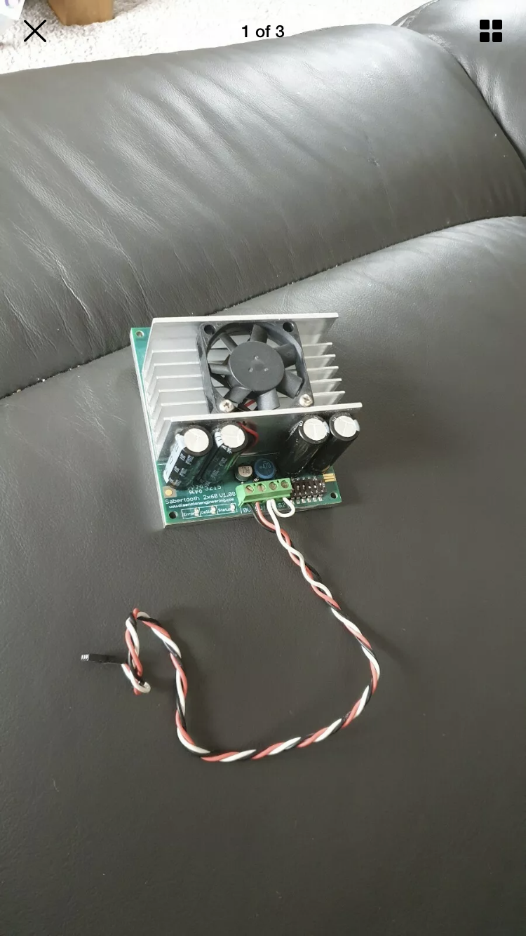

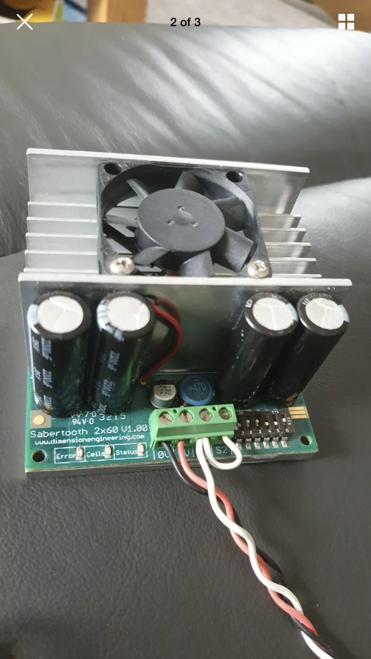

    I found Sabertooth Dual 60A 6V-30V Regenerative Motor Driver for £100
    How do u think is it good driver? Is it easy to setup?

  19. My.stAr
    My.stAr Active Member
    Sep 7, 2012
    151
    Engineer
    1,064Coins
    +63 / 0 / -0
    DC motor
    If you use the Sabertooth 2x60 you will need to use batteries. There is no option to get rid of the regenerative current with resitors. Keep that in mind.
    Instead of an arduino you can use Kangaroo X2 Motion controllers. They are much easier to handle. And you can use encoders. It looks like yours motors have a brake. If you don't want to use the brake, you could use the shaft to mount the encoders. You can use the brakes with the Sabertooths controllers.
    I recently bought my Controllers here: https://www.robotshop.com/uk/
    You can also order the kangaroo x2 there.
    It's up to you, which way you want to go. Sabertooth 2x60 or 2x32 will work. Arduino and kangroo should also both work fine:)

    So my friend are you telling me that I cant use 2x60 with my pcu power supplies?! :(
