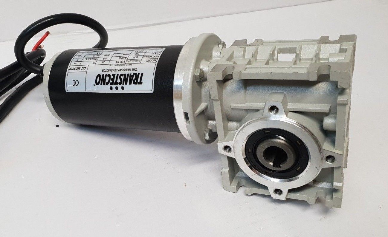

    MY first post so forgive my ignorance.
    I am planning on building a basic budget 2 DOF Rig and to keep costs down I am looking at some 24 Volt Gear Motors

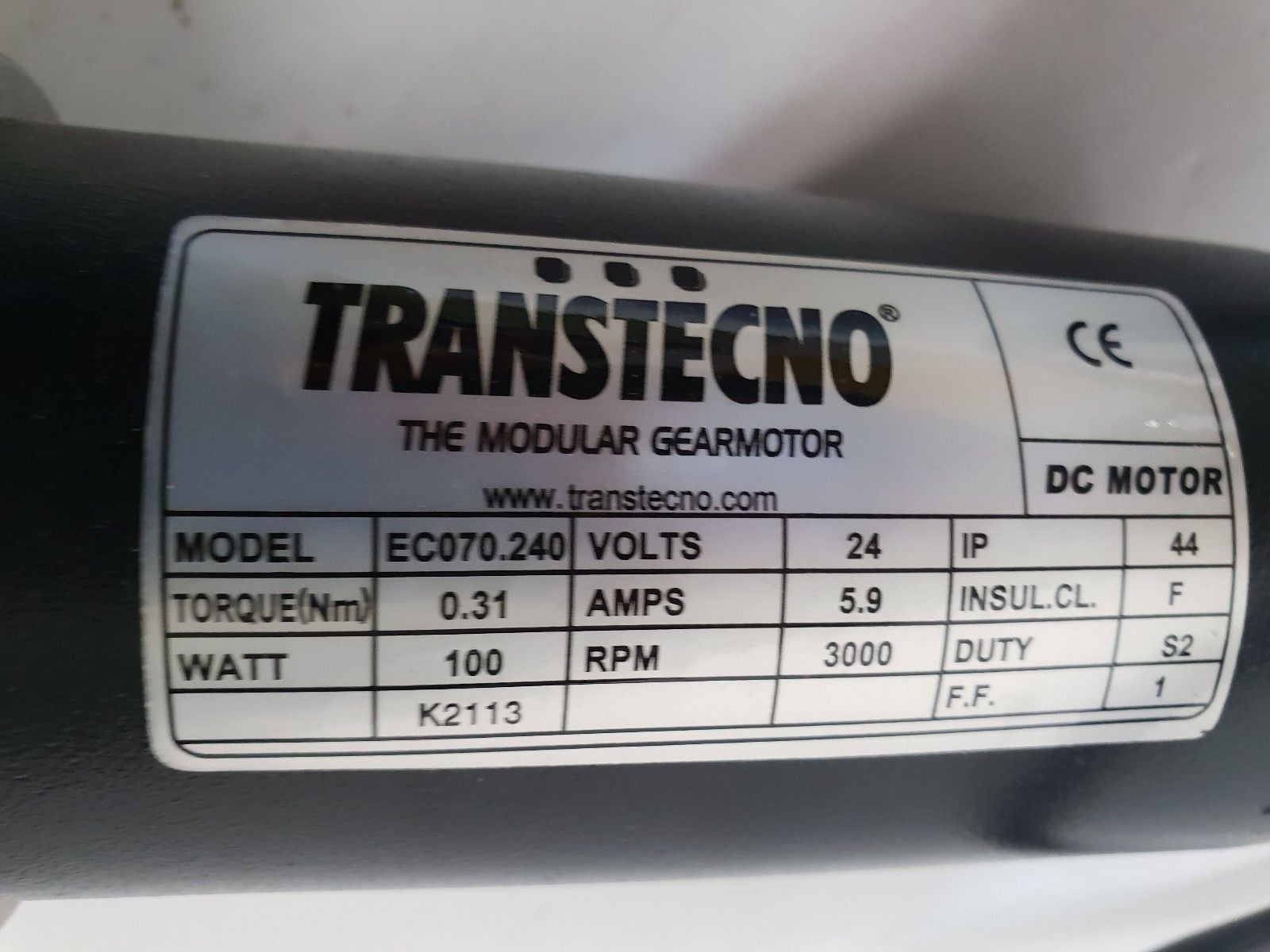

    Specs are:
    Size 30 Ratio 15:1 200 RPM Gearbox with 100 Watt (0.10kW) 3000rpm,Torque 0.31Nm. DC 24Volt
    Gearbox size 30 has a 14mm keyed hollow output
    Would these be suitable or too low in torque or speed ?
    I thought that they would be better than 24V. truck wiper motors which are a little more expensive
    Your Thoughts GearMotor.jpg GearMotor2.jpg ??

    it seams low on torque, i dont remember now what is the actual recomended torque, but it is up to 10N.m and this one says 0.31 wich is super low, but also says 3,000 rmp which is super fast, i guess this is the torque for the motor without gears (your motor has worn and gear mechanism) tray to search the torque for the whole thing, motor+gears.
    but from the out side seams powerfull just be shure
    fer

    Yes, it is 0.31 x 15 (15:1 gearbox) =4.31NM, plenty enough for a 2dof. with great speed (200rpm):thumbs

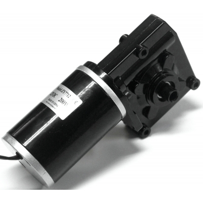

    I thought that the torque was pretty low, but never mind I have found a better alternative with more torque etc from another build on here and they are available in Australia where I live and are almost half the price, so a win win situation.
    Here are the specs of the motors:
    • 12v No Load Current: 1.8 Amps
    • 24v No Load Current: 0.9A
    • Working Voltage: 12V or 24V DC (12V or 24V
    • Rated Torque: 20 Nm (Locked Rotor Torque)
    • Optimal torque: is 12.5Nm
    • Motor Speed: 3600 RPM/160-180 RPM at Gearbox dependant on load.
    • Rated Current 12/24 Volts: 16amps at 12v OR 8 Amps FOR 24v, No load rating of 1A

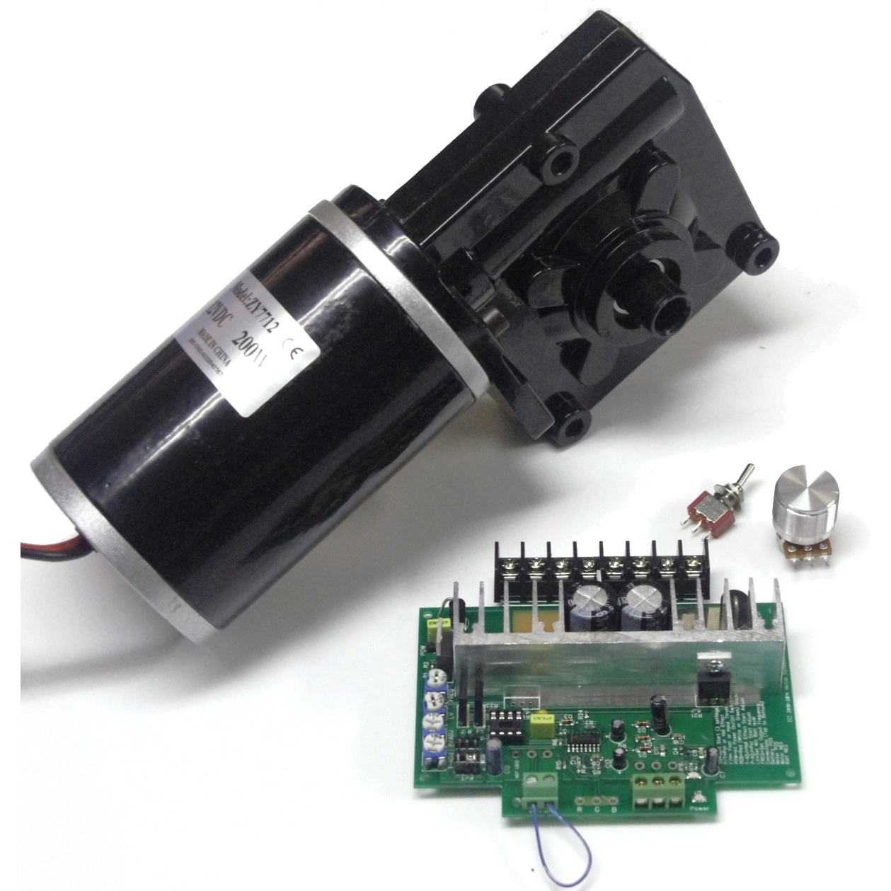

    As far as I know the controllers have not been used for motion simulation, where they would be subject to high loads and constant high speed reversals, so they are an unknown quantity.

    I am only familiar with CNC electronics where the normally have one motor, stepper or servo, one driver per motor, an then a break-out board for communication between it and the PC and in a hobby situation you would usually run Mach3 control software to translate the G-Code files into step and direction commands.
    You can typically get a 3 axis CNC kit with stepper motors, drivers, breakout board and power supply suitable for a small mill or router from Fleabay for about $400 or thereabouts.
    So what controllers do you recommend to use seeing that you have used the same motors, and remembering that I am on a tight budget here.

    OK so I am basically just copying what Noorbeast used in his build for his electronics and motor combo.
    This is my shopping list so far, so what have I forgotten ?
    2 x Controller - Pololu Jrk 12v12 USB Motor Controller with Feedback
    2 x PSU-
    Input Voltage : AC110/220V
    Output Voltage : DC12V
    Output Power : 40W/60W/100W/150W/250W/350W/500W
    Output Current : 3.3A/5A/8.3A/12.5A/20.8A/29A/41.6A
    2 x Motors - 50:1 Worm Drive Motor 12V/24V 200W, 180 RPM, 20Nm Torque
    2 x Pots
    1 x Powered USB hub
    2 x USB A to USB B Mini cables
