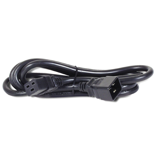

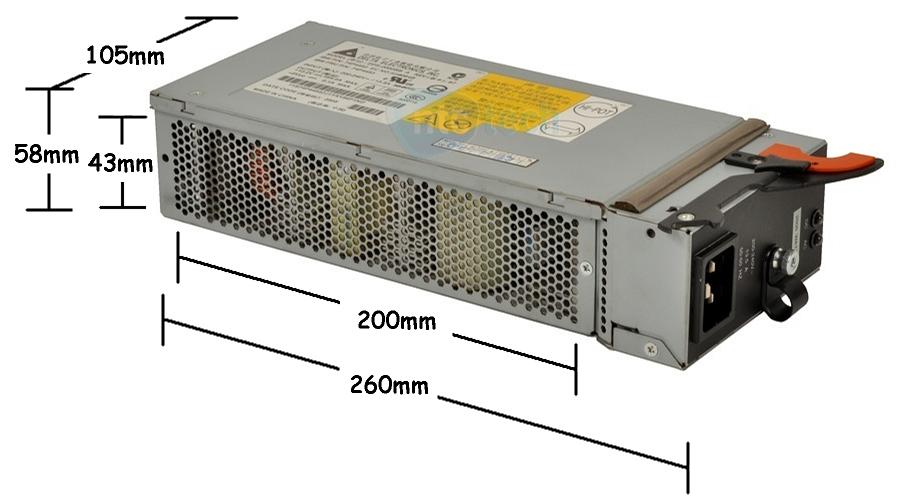

    My winches are drawing 1500 watts (max. and together), so why not using one PSU instead of two. The DPS-2000 BB sever supply shows some very impressive specs. The maximum output current of the DPS-2000BB is 164A at 12.2v minimum and spits out 2000 watts. This gadget is typically about $40-$50 on eBay . To fire it up up you need an IEC C19 power cable. BTW the DPS-2500BB has 2500 Watt but hardly available. The pinout you will find here.

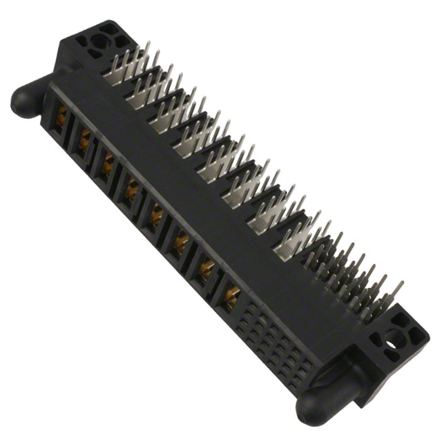

    If you want use some sockets, here you go:
    http://www.digikey.com/product-detail/en/51762-10802400ABLF/609-4020-ND/1492063

    Final thoughts after testing: the PSU works great, but has some security routines implemented which do not allow very high current peaks. One PSU will shut down anytime if you are using more than only one very powerful motor. One PSU - one motor - no issues. If you are using 300 or 400 W motors one PSU should do the job for two motors.

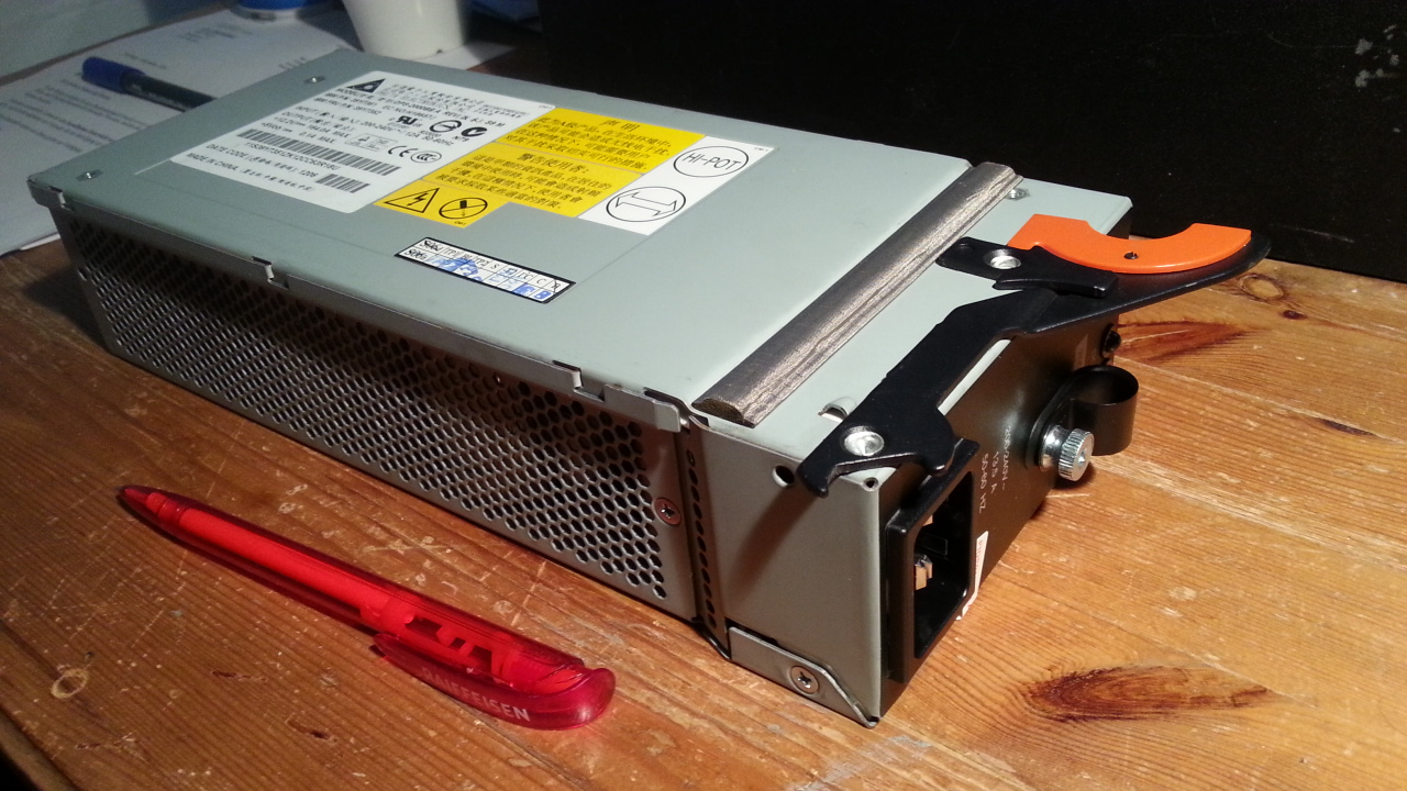

    @Pit : have you found the way to start this reference? plug the 230V is not enough...
    Do you know if there are noisy?
    I know I have to make a video for you of the 1400W PSU to tell you if it's noisy (coming soon)
    21,604
    151,281Coins
    +11,033 / 56 / -2
    I expect these beasts to be noisy. Mine is due by the end of the month so I won't have long to find out.

    You won't be able to run this supply off a normal household wall socket as it draws 12A AC (likely more). Your standard GPO is 10A rated. It should be ok if you are only planning on using about 120A DC max but if you are planning on running it near maximum capacity you should find out what kind of circuit protection you have at home and if that will prevent you from using this supply.
    Also DO NOT try to hack up some 10A cable to fit this supply as I'm pretty sure it is a 15A cable that is required (larger earth pin, larger cores to take more current).

    This PSU doesn't have an internal fan, so I have to mount one externally.

    Here is one running with 2 external fans, which is not too bad noise wise:
  11. Nick Moxley
    17,056Coins
    +2,506 / 30 / -2
    Not Very loud at all, more than acceptable, what size fans are those 80mm ?
