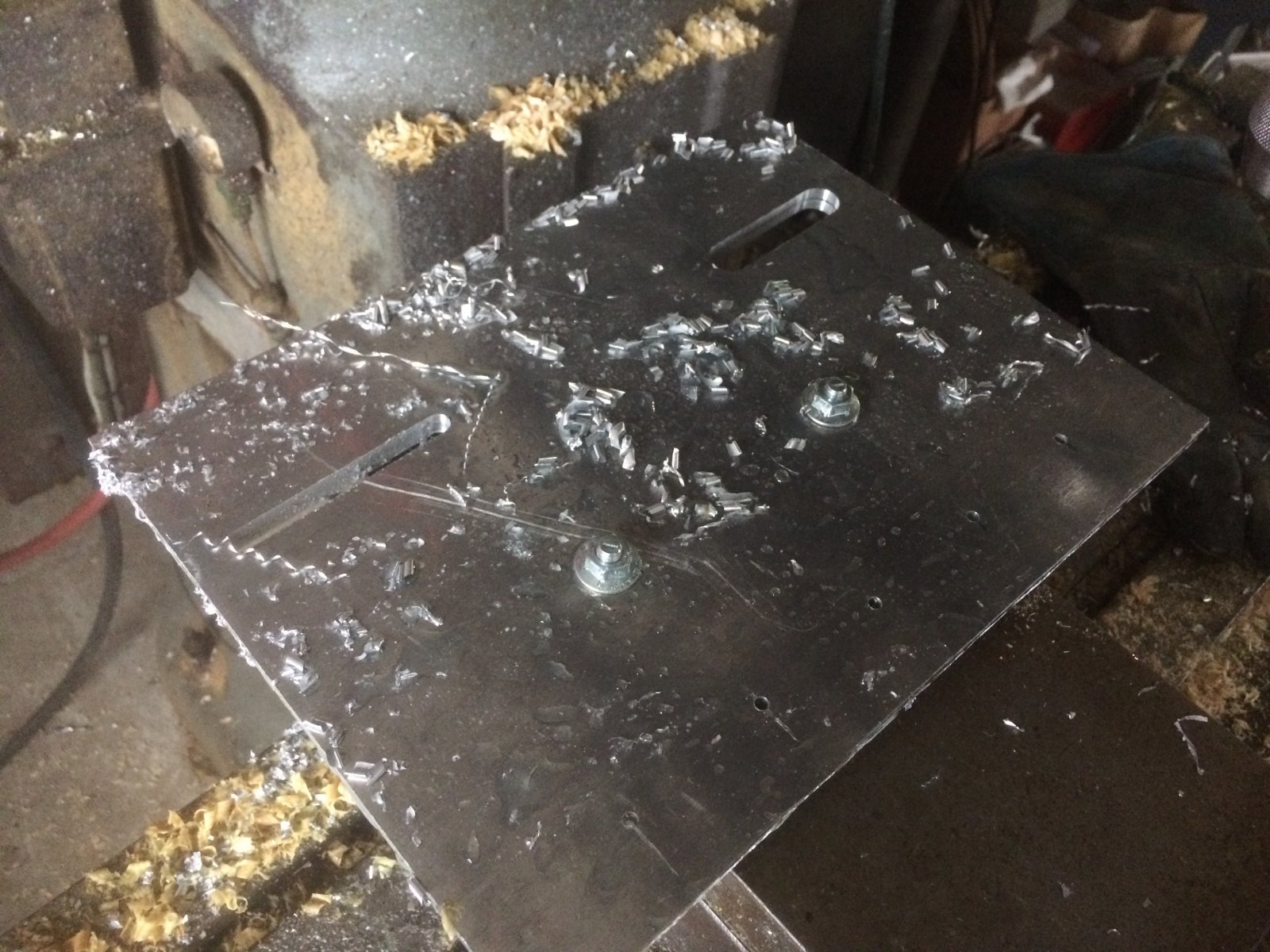

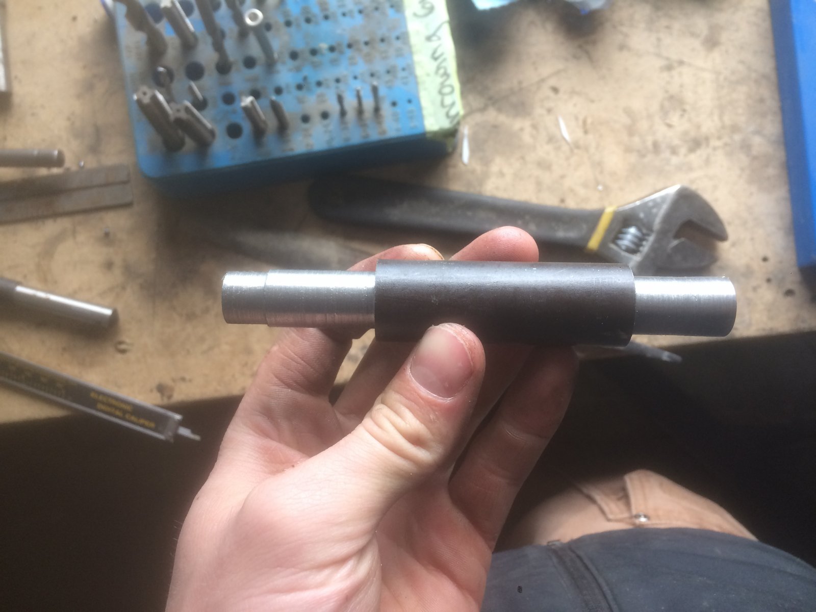

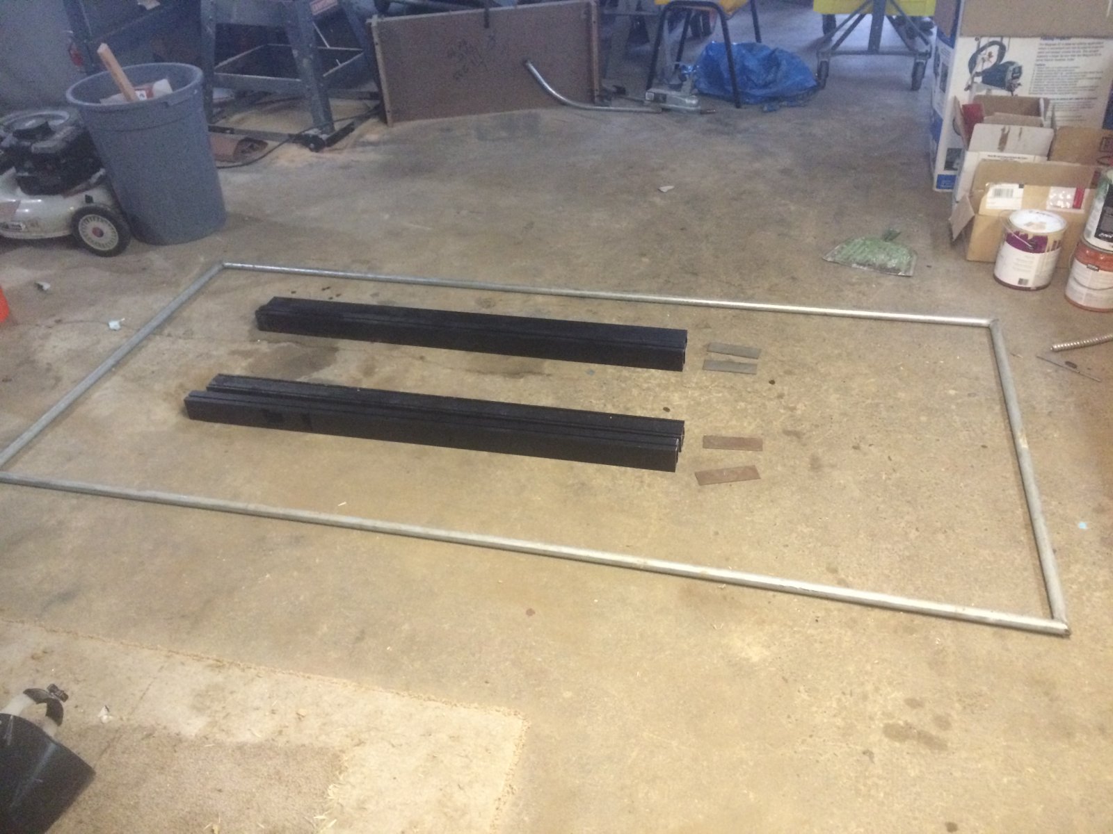

    Update!
    So over the summer I got caught up in other things, but I have begun work again and made some big progress!

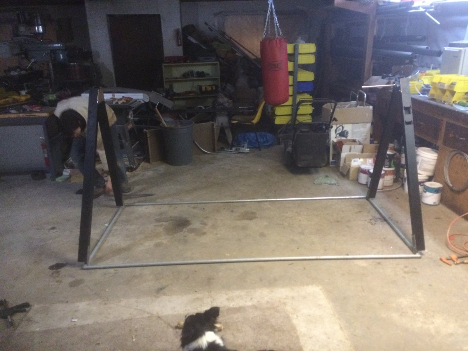

    I started with making a carriage for holding the frame that I built previously:
    Then I mounted the frame on the carrage:

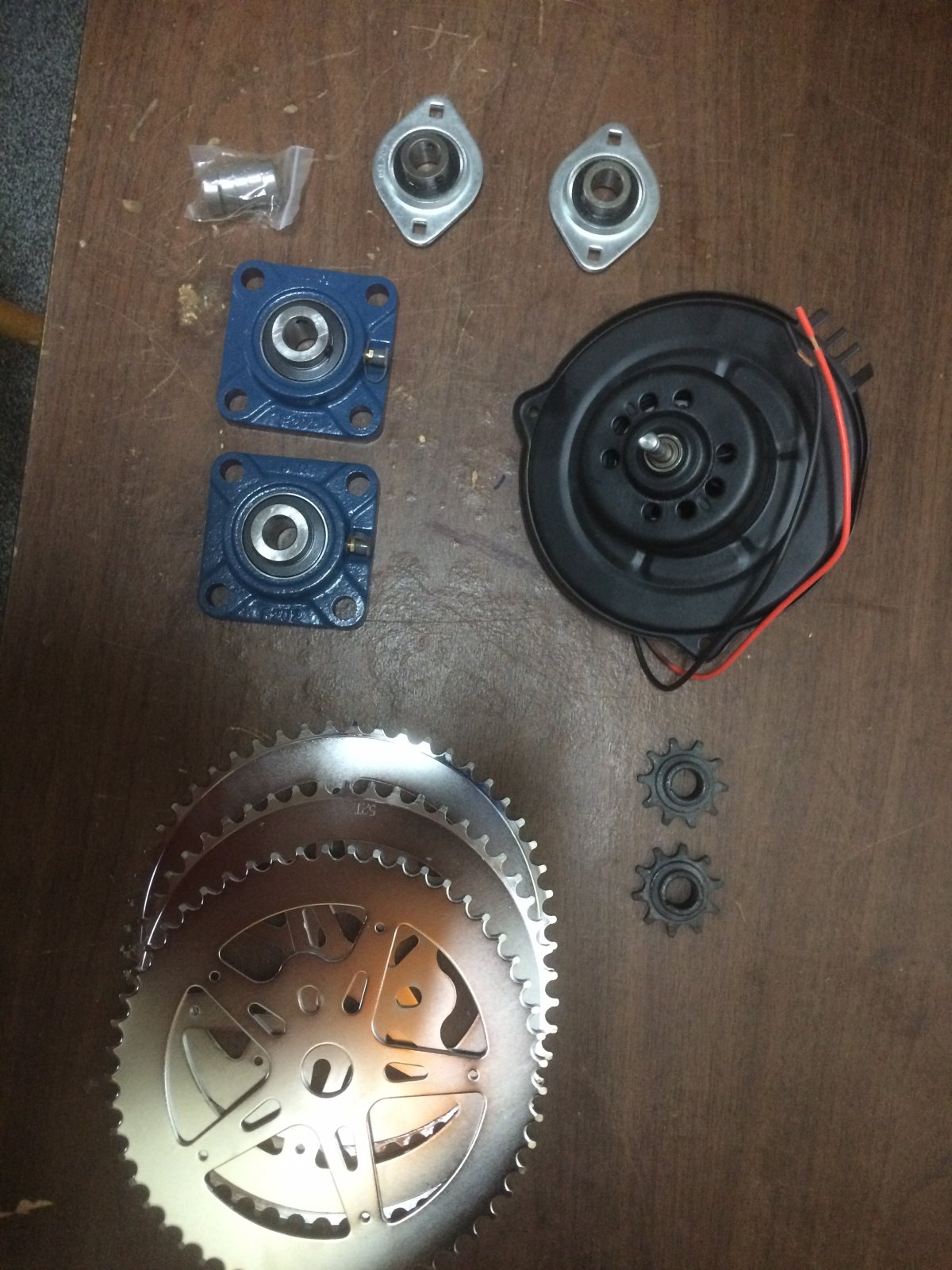

    Starting work on the gearbox:
    Cool lathed idler shaft:

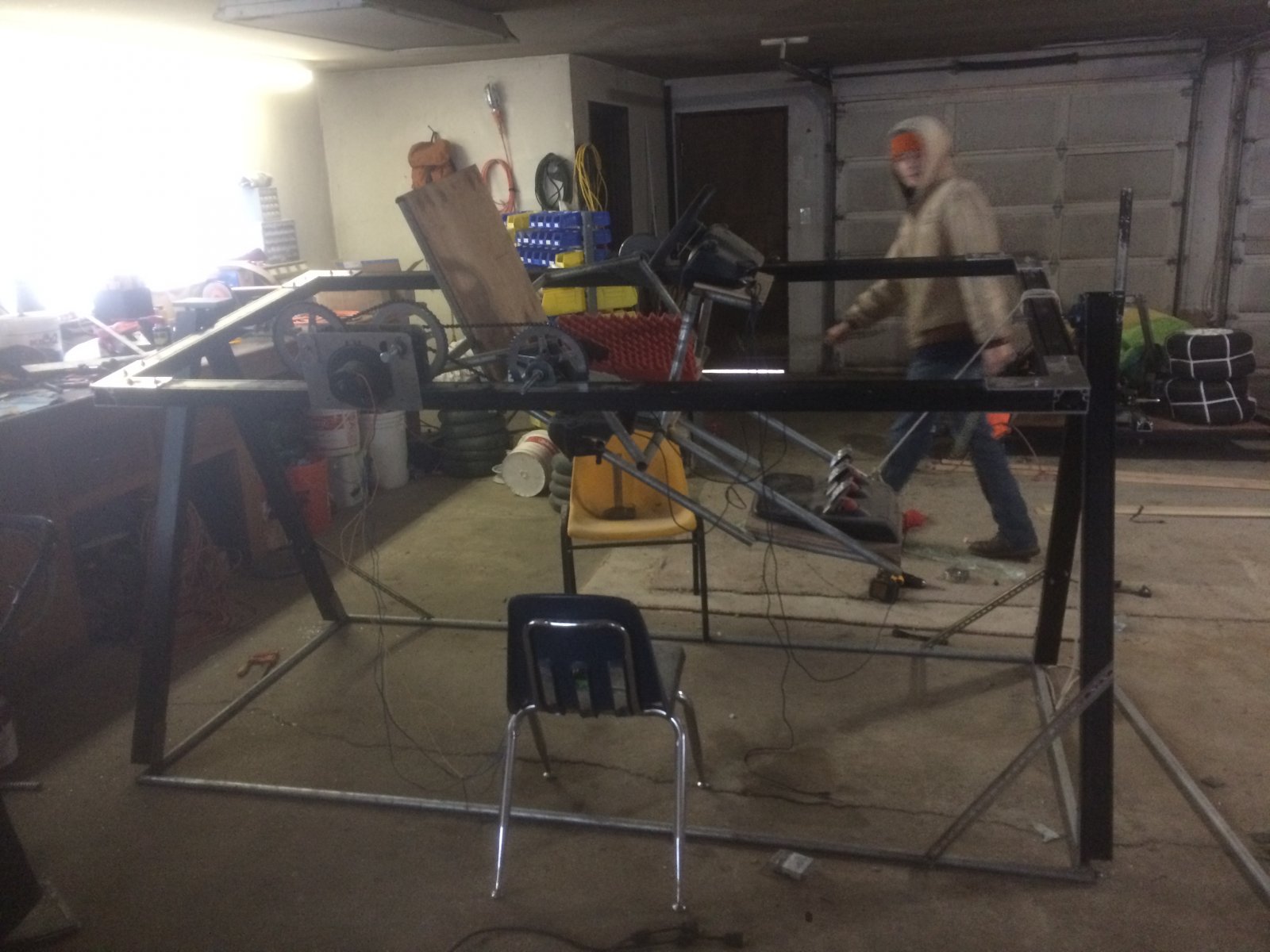

  8. Zoxks
    Zoxks New Member
    Mar 29, 2016
    28
    Oregon
    125Coins
    +29 / 0 / -0
    Yay! Test dummy!
    And yes, I did put in a four point harness. :D
    It seems to be a bit top heavy, so I will need to balance that out:
    • Funny Funny x 4

    2,572
    Would not worry yet, when you mount all the computer and other systems onto the moving rig it may balance it out a bit better.

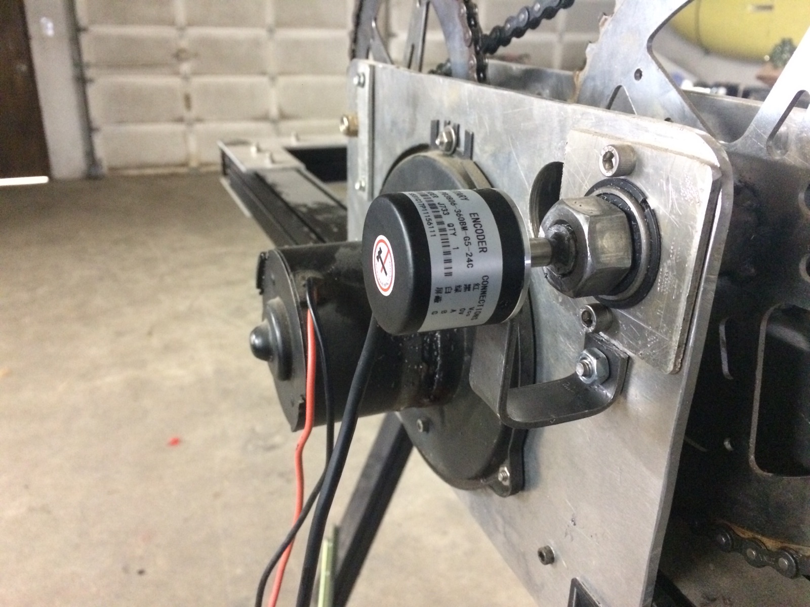

    +29 / 0 / -0

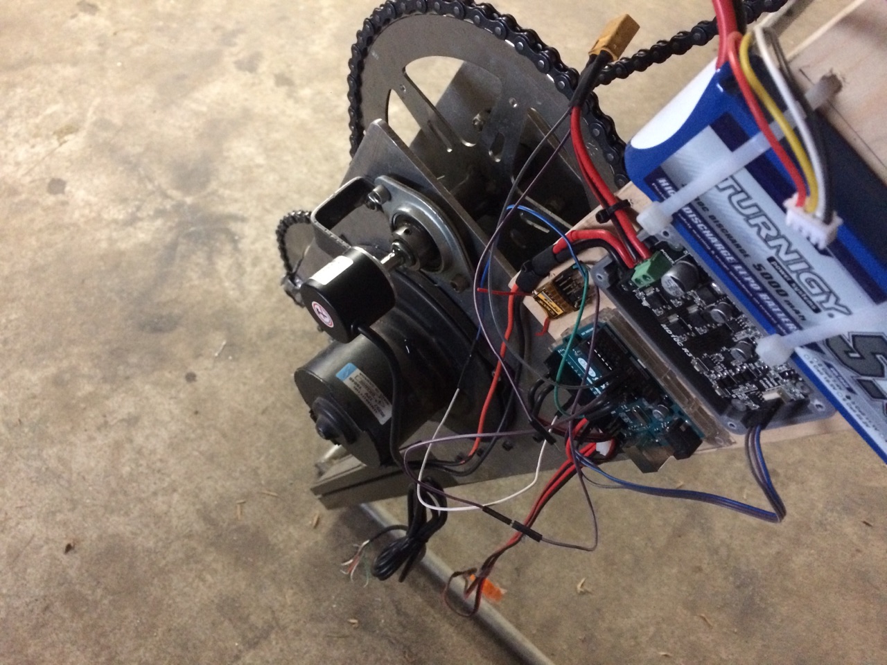

    I'm back!
    I've decided to convert the sim to a continuous rotation platform, so I can use it with my RC airplanes.
    Started by removing those potentiometers and replacing them with rotary encoders. I am also converting each axis to battery power so I don't have to run and cables to them.
    And yes, I plan to clean up all that messy wiring. :D
    I'm planning on controlling each axis with a board hacked out of a spectrum RC transmitter that I will hook up to an Arduino up on the airplane. The Arduino will get the roll and pitch from a MPU6050 gyroscope.

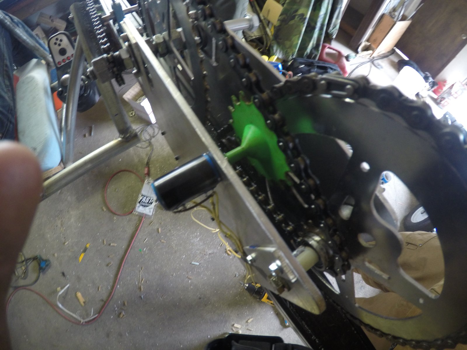

  17. paulopsx2
    paulopsx2 Active Member
    Apr 2, 2016
    616
    brasil
    647Coins
    +165 / 2 / -0
    I'm following your project ... correct me if I'm wrong, but it seems to me that the pulleys together with the chains, generate a certain delay in the response of the movement ... is it within your expectations, or do you want to change something?
  18. Zoxks
    Zoxks New Member
    Mar 29, 2016
    28
    Oregon
    125Coins
    +29 / 0 / -0
    Yeah. The gearboxes aren't optimal, but they seem work well for what we are doing. We really needed something that could continue to turn the simulator indefinitely and this is what I came up with at the time. I would probably do it a little differently if I were to do it over again.
  19. Zoxks
    Zoxks New Member
    Mar 29, 2016
    28
    Oregon
    125Coins
    +29 / 0 / -0
    UPDATE! Got it all working with those encoders. It will now go to where I tell it with my RC remote!
