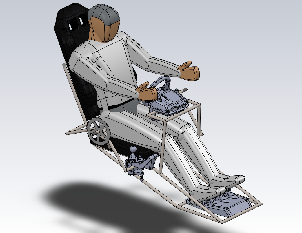

    Hey guys! A few of my friends and I have started work on a 2DOF sim, but as it's quite unique, I figured I'd post the progress here for you guys to follow.
    First we started out with the motor. I wanted this thing to roll all the way over on it's side, so linear actuators wouldn't work. I had an old heater blower motor hanging around, so I set about figuring out if it would be possible to use that.
    This is the motor that we have:
    My cousin and I went and measured the torque of the motor, and found it to be ~ 1 foot pound, with a rotation of 4400 RPM. I did some math with these numbers and found that the motor could provide 140 foot pounds at a speed of 30 RPM. Then, with the calculated moment of inertia, we found that this torque would be capable of accelerating the sim to full speed in 0.24 seconds - plenty fast for our use.
    Once we found that the motor would me good enough for our needs, we set about finding a motor controller. With the motor clocking at 9.5 Amps when stalled, we found that this 13 Amp motor controller would suit us just fine: http://www.robotshop.com/en/cytron-13a-5-30v-single-dc-motor-controller.html
    We also got an Arduino uno while we were at it, and as I have experience in programming, coding the Arduino wouldn't be an issue.

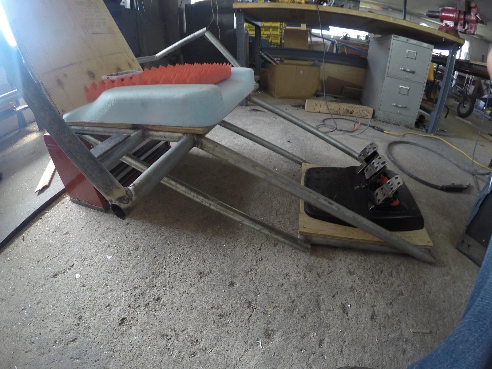

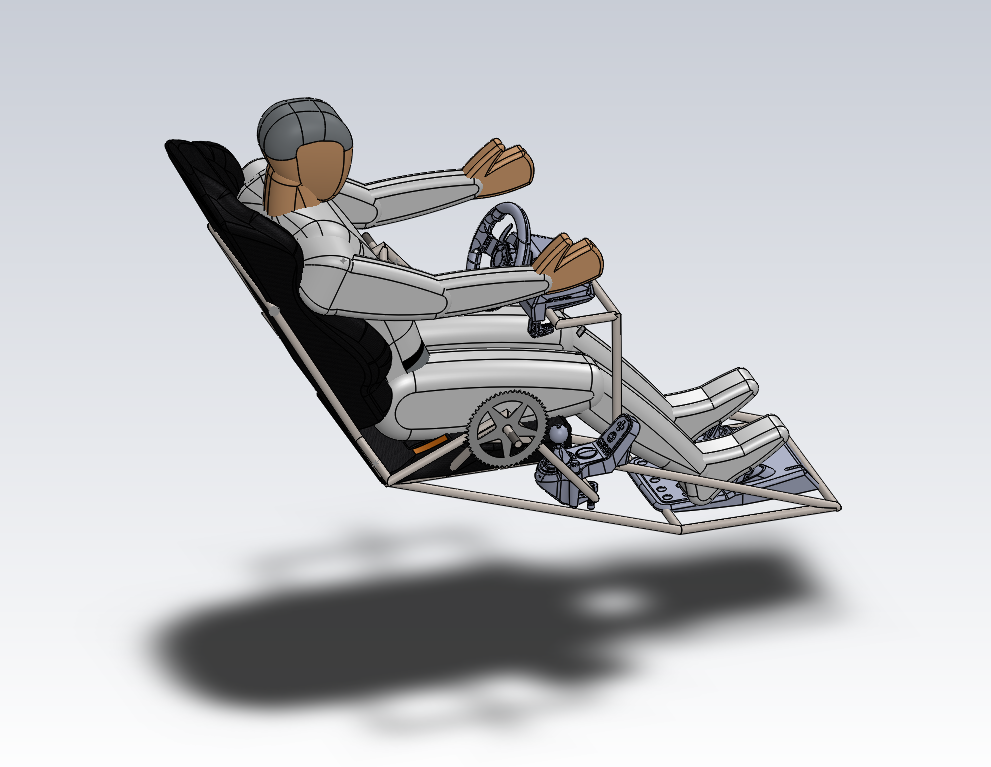

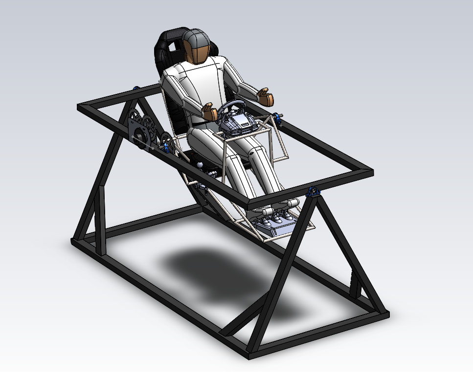

    I then started on the design, which I based off of 1' conduit piping that we got given.
    We were loaned a Logitech racing wheel set, that is pictured here. You can see the gearbox with the motor in it on the left. There will be another set driving the roll axis, but I haven't added it yet.

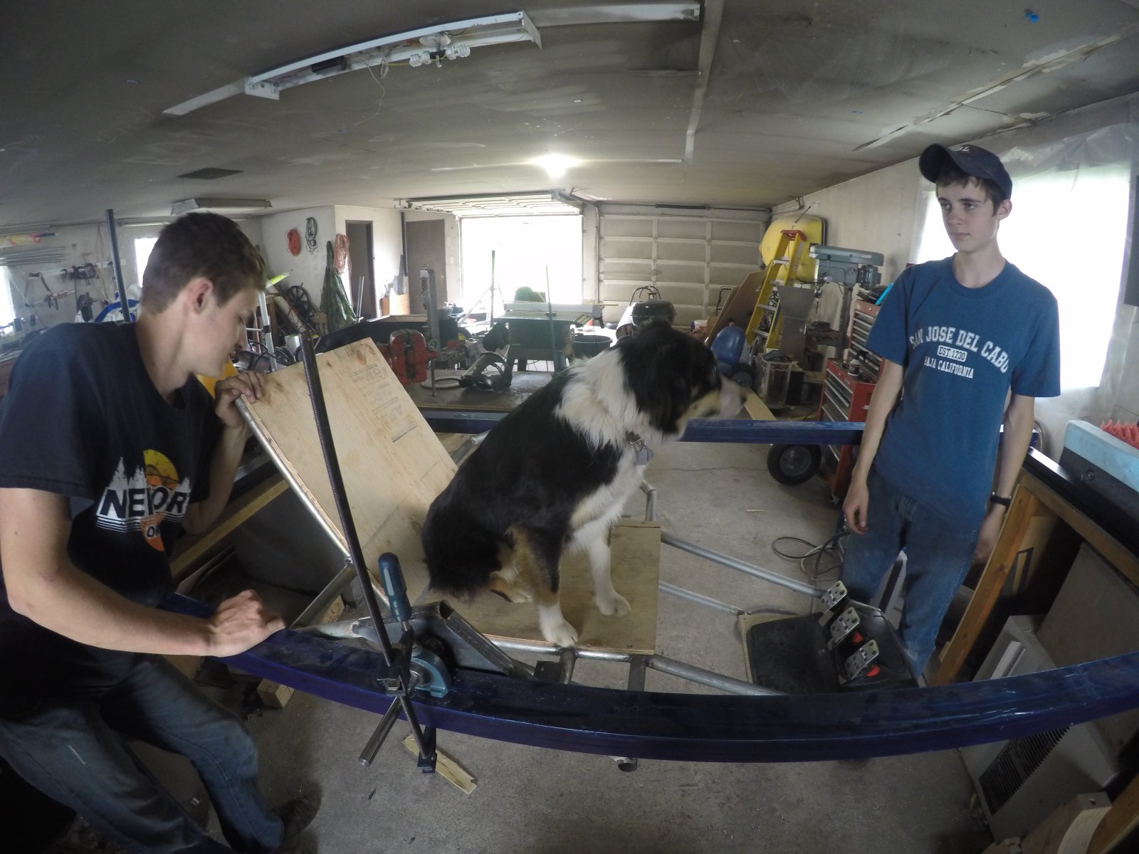

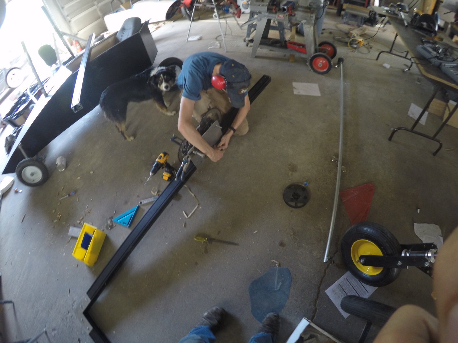

    With that we started work. So far we have almost completed the frame:
    After we mounted the shafts, we put it up on some temporary blocks to test the pitch axis:

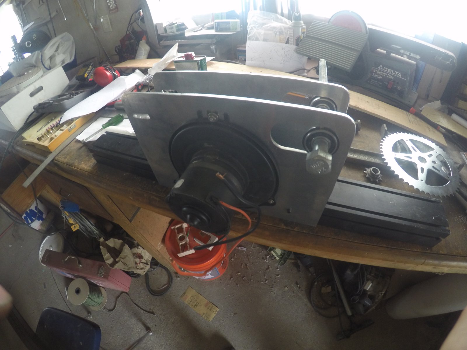

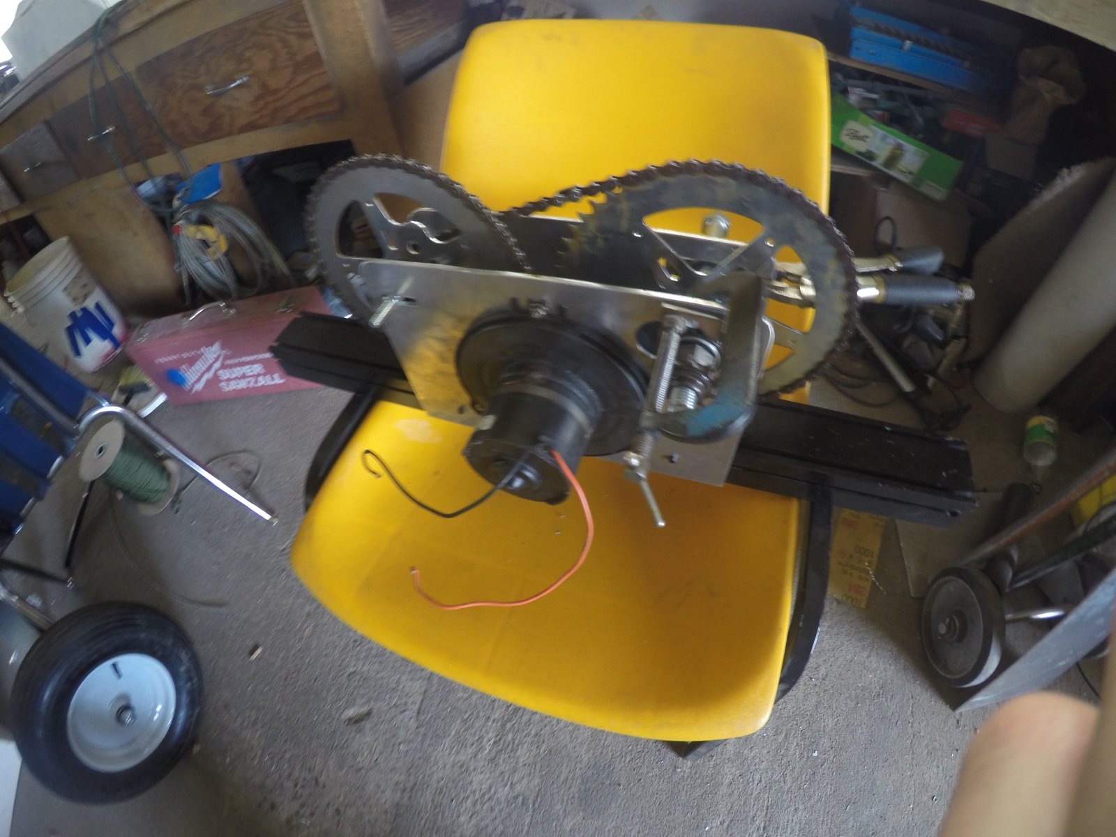

    Started putting the gearbox togethe. We had to remove the flange on the motor and flip it around:
    We put a Ft-Pound wrench on it and got 27 foot pounds! Not bad considering that the gear ratio at the moment is 27.04 to 1 (two 5.2 to 1 reductions)

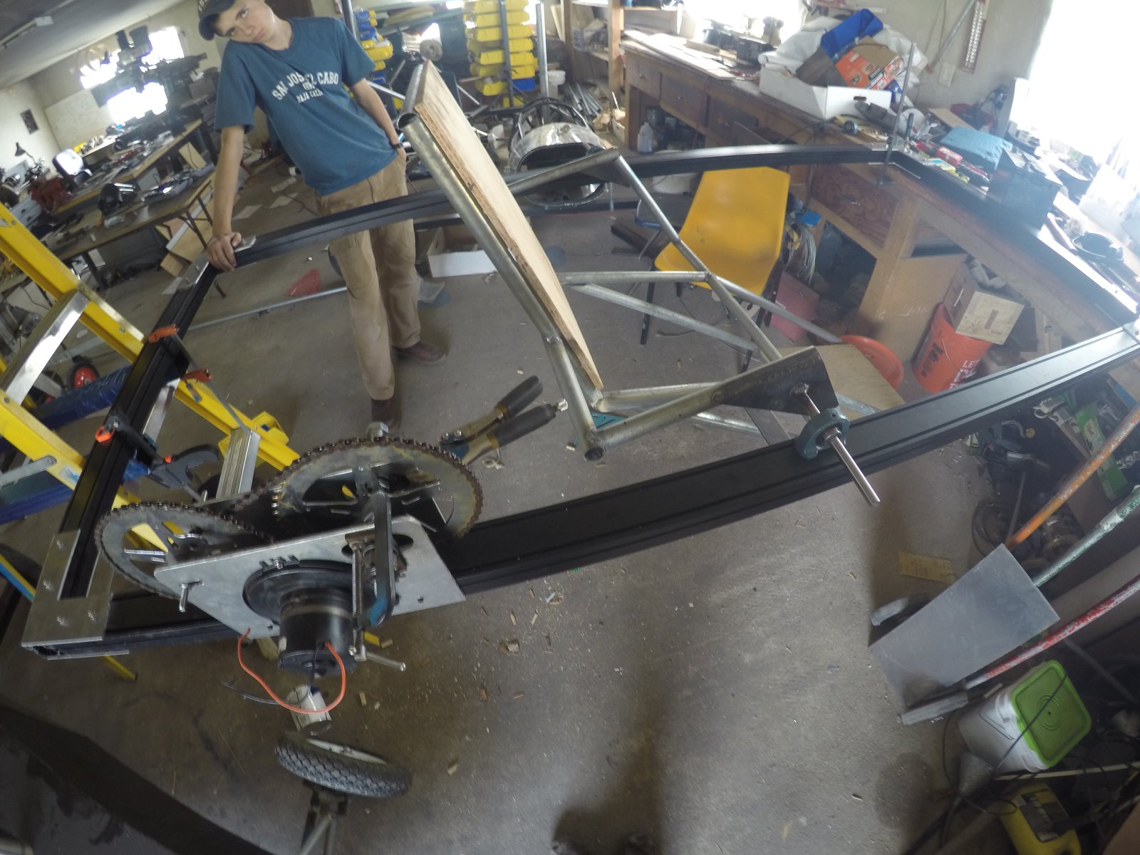

    Starting work on the carriage:
    Mounting the gearbox:
    And here is the finished carriage! We still have to hook up the gearbox to the seat. The gearbox isn't in its final position yet.
