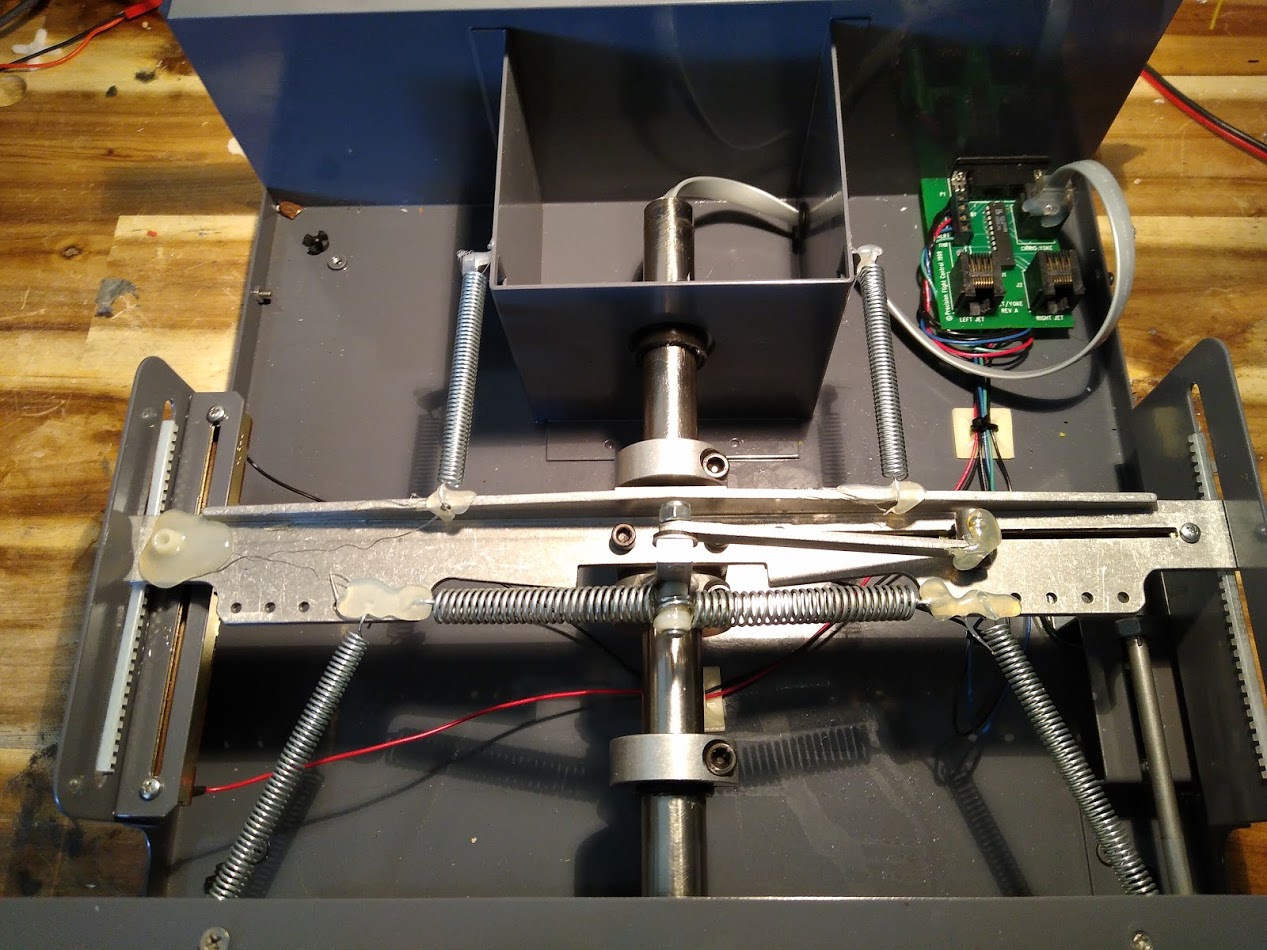

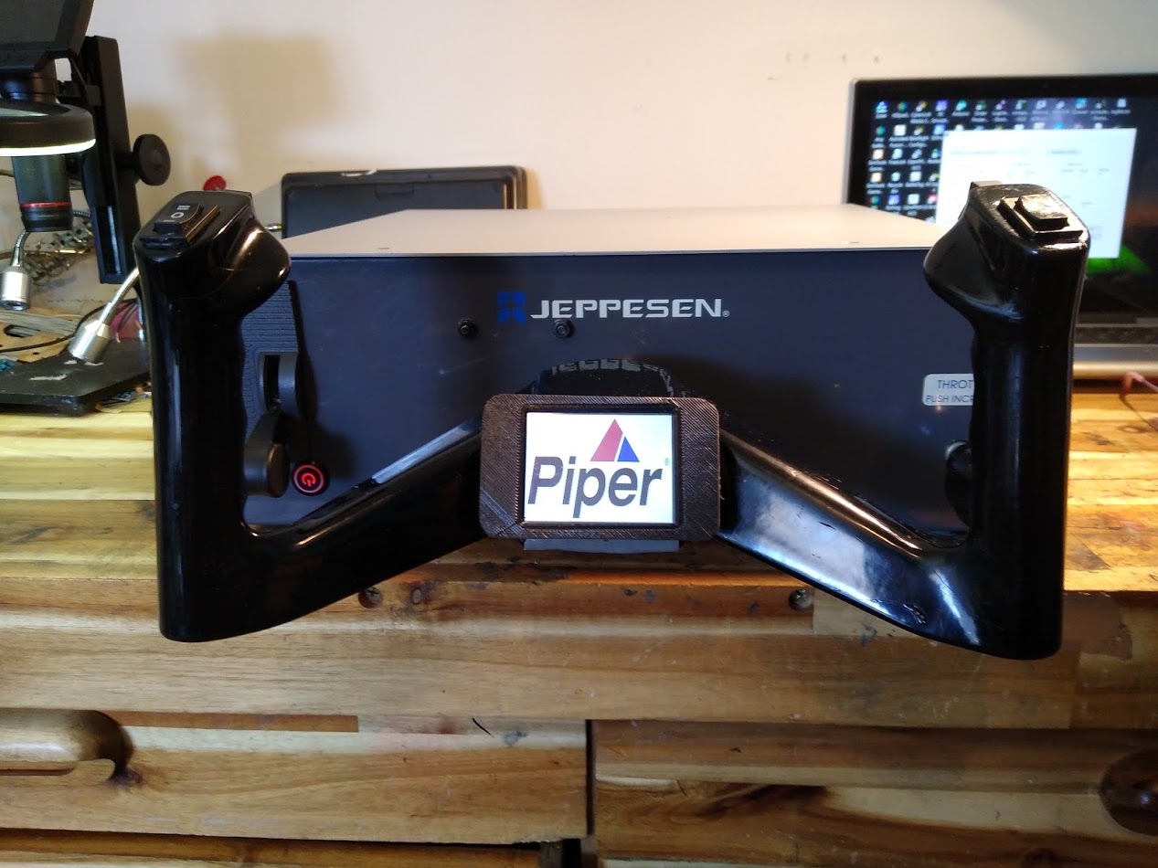

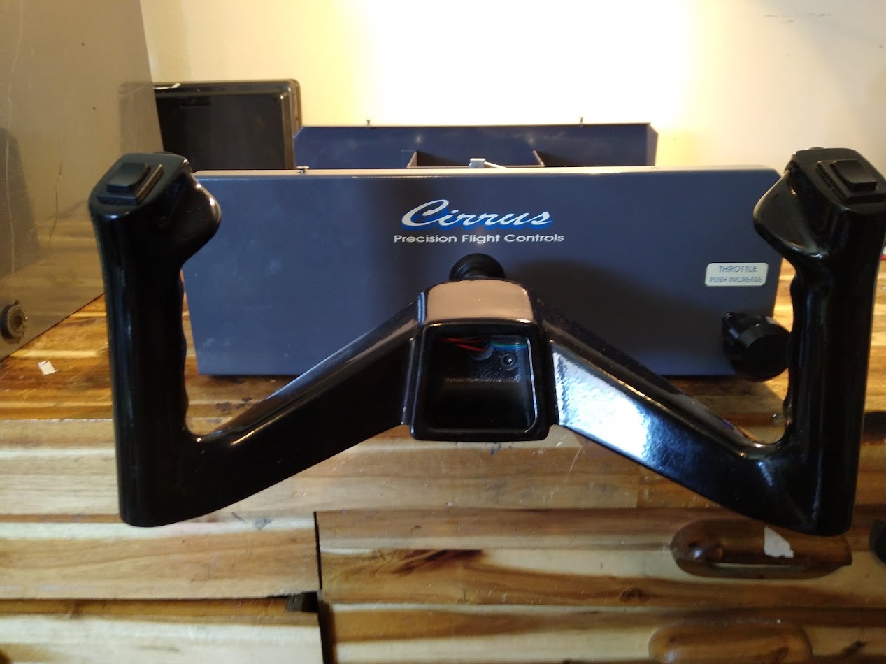

    This post describes my latest peripheral project. A Force Feedback Flight Yoke for Flight Sims.
    I have a previous thread on building a FFB yoke. This project takes it to the next level.
    It is still based on the Microsoft Force Feedback 2 Joystick control board sold on Ebay .
    It has been discontinued from Microsoft but still readily available.
    There is still 3rd party software support which allows its use on FS2020, Xplane, DCS and others.
    The new yoke is based on a Precision Flight Controls PCATD Desktop Yoke by Jeppesen.
    These are sold used on Ebay for about $150 US.
    These all metal boat anchors were part of a flight training system.
    The stock FFB2 control board does not have enough power handling capability to run the new 35 watt geared dc motors so an external H-Bridge MosFet output board was built.
    The set-up still allows the control board to regulate the power to the motors so it retains all the characteristics of the original joystick but with a lot more force.
    Most all the parts to make the modifications were purchased from Amazon.
    Example;
    www.amazon.com/gp/product/B07GBSYR8B/ref=ppx_yo_dt_b_asin_title_o00_s00?ie=UTF8&psc=1
    www.amazon.com/gp/product/B086CWFDTH/ref=ppx_yo_dt_b_asin_title_o03_s00?ie=UTF8&psc=1
    Some pictures.

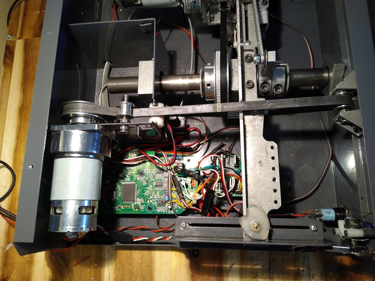

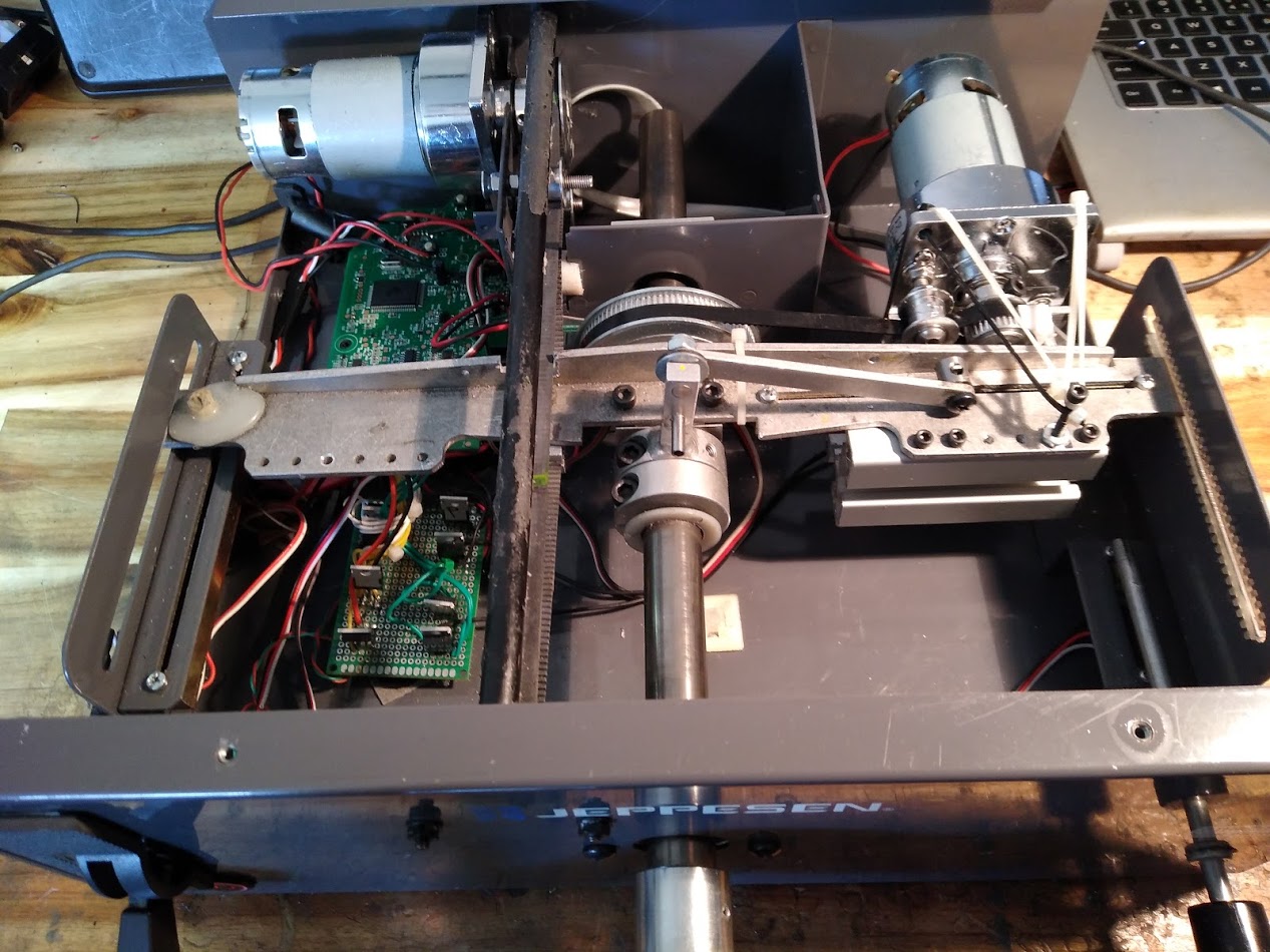

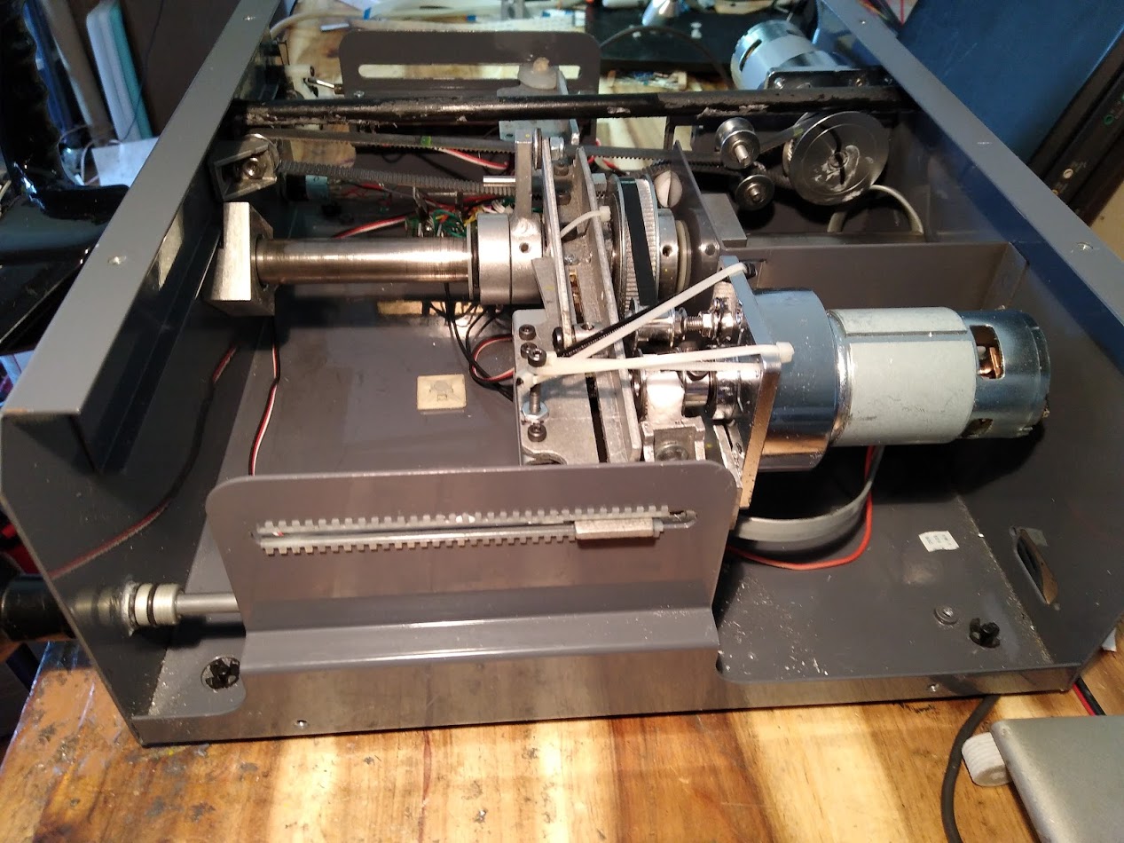

    Hello.. I am still using the PCATD Desktop Yoke but I did end up buying another one off ShopGoodwill dot Com.
    I did redo my system.
    I would not recommend geared motors. They have too much drag.
    Belts and pulleys or rack and pinion works very good.
    On the board modifications, I no longer use the outboard fets. There is a chip you can buy that fits right on the original circuit board (ForceFeedback 2). The new chips fits in place of the old ones. They can do 40V, 30A, 48W.....
    You will need some heat sinks. VISHAY SQJ500AEP-T1_GE3 / SQJ500AEPT1GE3....
    https://www.ebay.com/itm/233926287970
    I replaced the motors with Pittman 14204. (used off E-bay)
    The pittman motors can develop enough torque to pull the yoke out of you hands.
    Did you see this guys project? I almost started to build it.
    https://forums.flightsimulator.com/t/my-saitek-ffb-yoke-a-wip/489386
    It uses a Saitek yoke for the base..

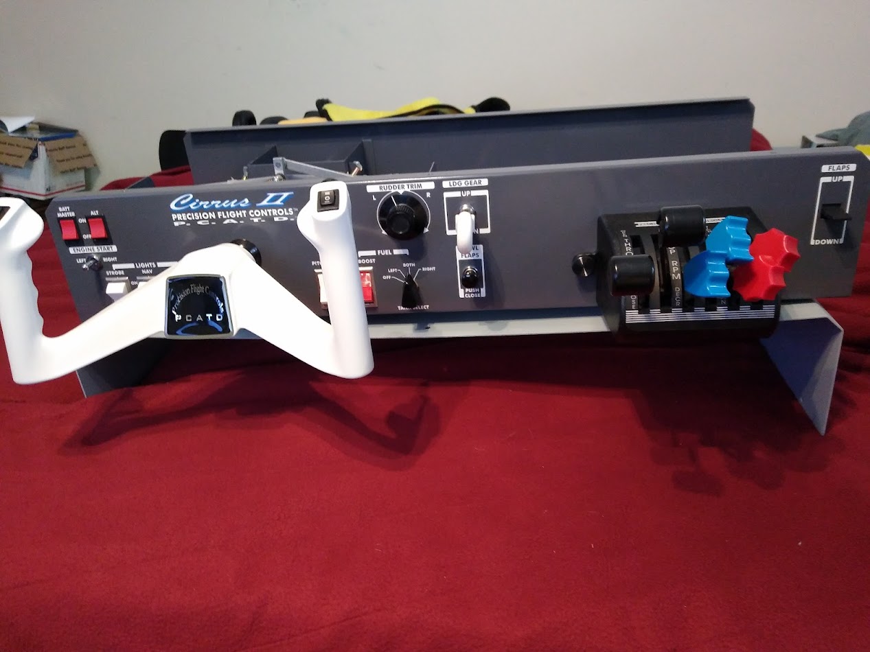

    I have a yoke exactly like that cirrus one (branded elite) in my attic. It has a serial interface and I was planning to put an arduino in it, but force feedback sounds much better. I might have time for this project next winter. If anyone wants to buy it off me, that is also possible (located in Germany), contact me via PM.

    Ok, I now also got the FFB2. It is the green LED USB version though, no red button. I hope that suffices.
    So do you use the original pots in the yoke?
    What power supply have you chosen?
    Is there any calibration or software adjustment necessary?
  8. T R Para
    T R Para i make stuff up
    Oct 18, 2018
    385
    Cincinnati, Oh
    2,436Coins
    +357 / 2 / -0
    AC motor, 6DOF
    Yes you can use the original pots in the yoke. You will have to add an additional wire to each pot. No red button is fine. Green led is ok. Any 24vdc power supply is ok. Unless you do a resistor modification the stock power supply is fine. Use the windows setting menu and search for USB game devices. This is where you calibrate the yoke. The throttle slide pot works also.

    I actually did try those motors. I do not think you will be happy with them. At the zero point (neutral yoke position) the cogging of the motors will be noticeable. You are looking for a motor specified as zero cog or low cog. The armatures are constructed so as to eliminate cogging forces at low rpm. It is like a helical twist in the laminations. The smaller pitman motors all tend to be low cog and the scrappers that sell on ebay seem to have them for sale quite often. I think they retail new for hundreds of dollars but I have bought them used for under $30 several times.

    Rotor with a slant cut sounds like the right design.
    The pittman I linked above is the actual motor I am using.
    So I know that one works.
    But regardless I think you are on the right track.
