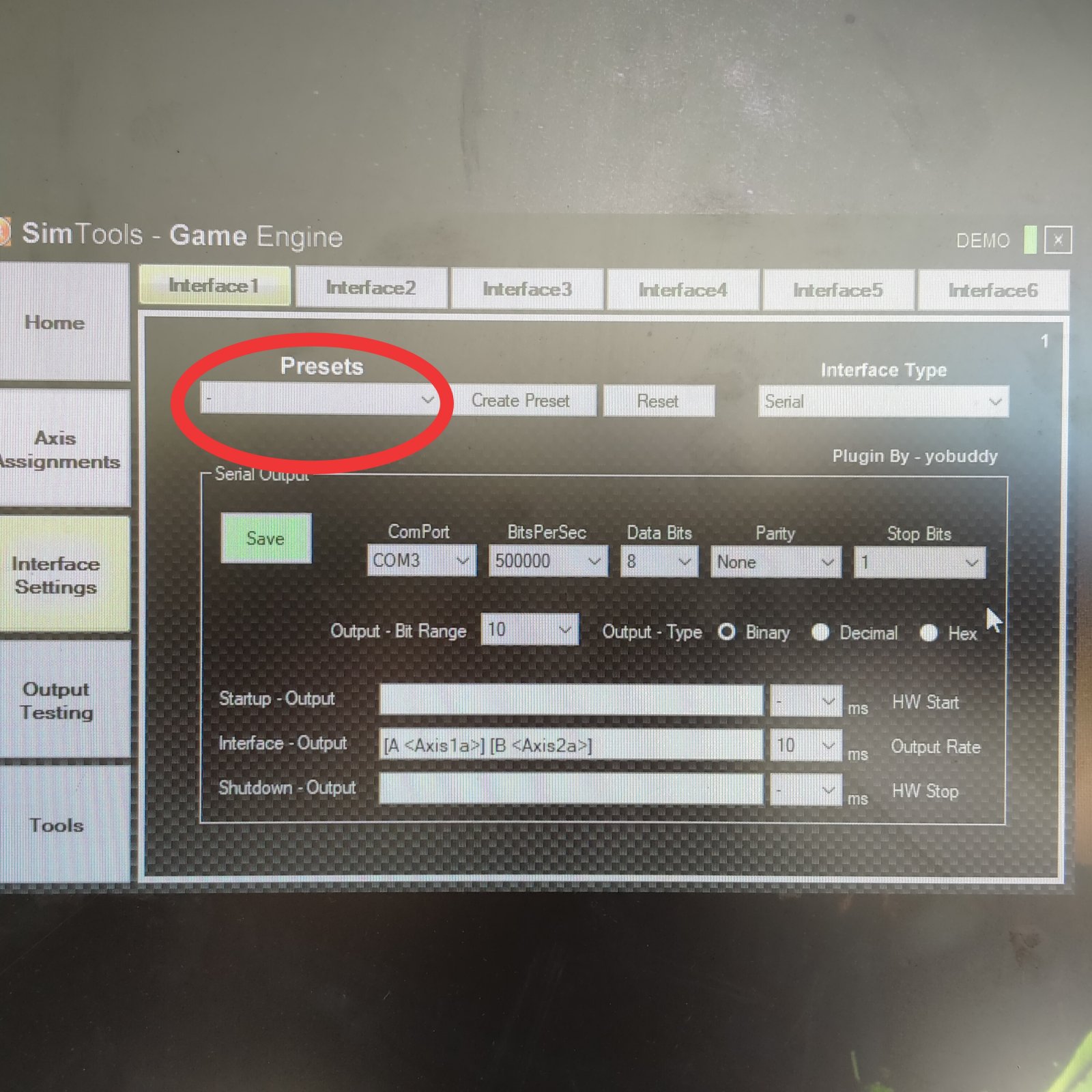

    No a preset is not required, just an option for loading predefined setups.

    I've not got anything in there, it's blank. Hope that helps.

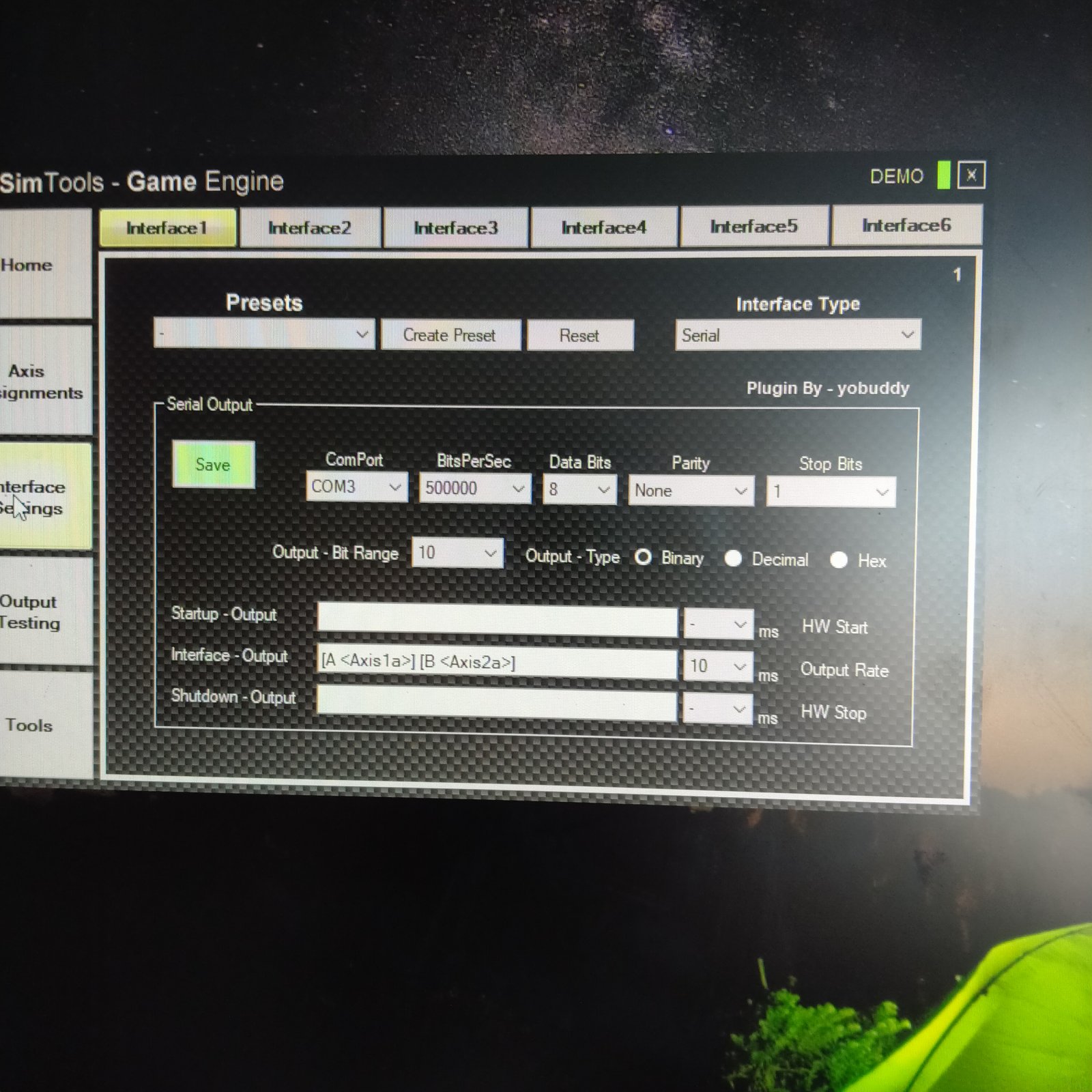

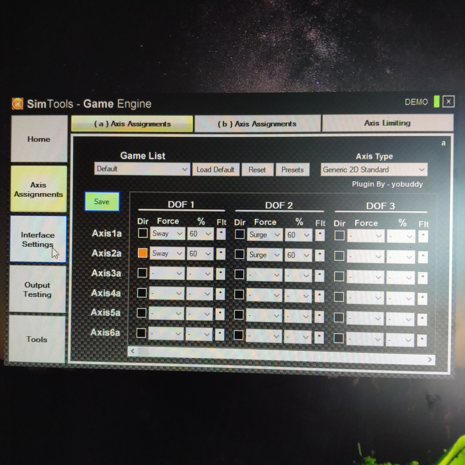

    2DOF, Arduino, SimforceGT, Motion platform

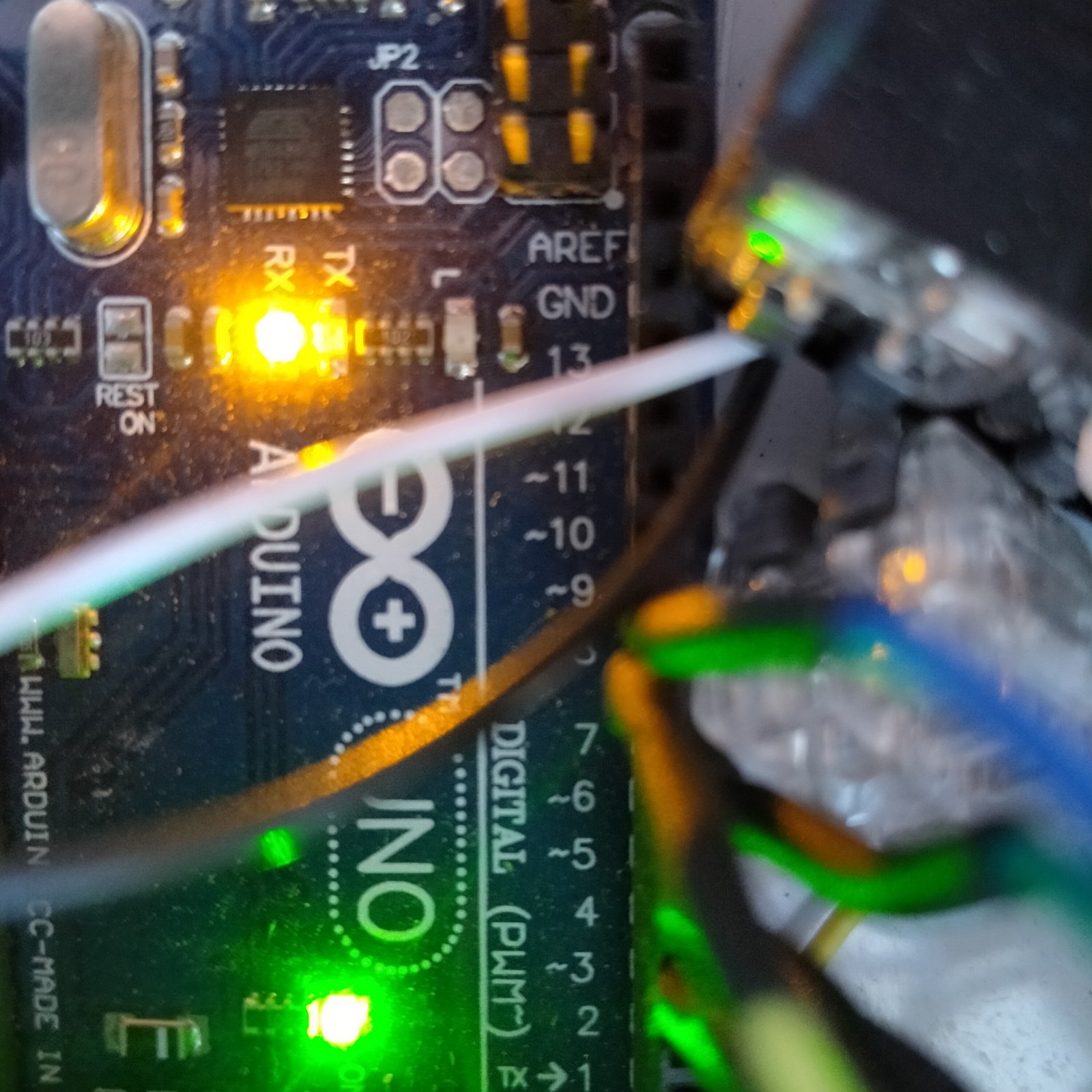

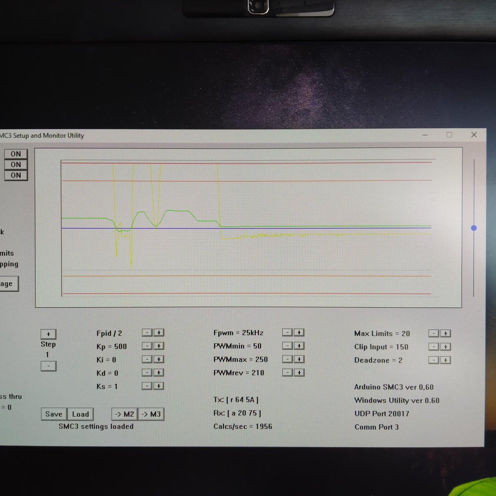

    thank you for your answer and the friends yes yes it's all good I understood I posted a photo of my configuration SMC 3 you can tell me it's not too bad I have problems with the light the LED RX and remains not fixed thank you friends

    +66 / 2 / -0
    Well the RX led is just a notification that your recieving Data, it should only flash when recieiving Data. Although on mine they are both almost permantently going when SMCUtils is running. Is SMC3Util working correctly, or are you having any issues?

    hello thank you for your answer look in the page number 2 I post a video you will see ld RX it is not fixed but the TX it is fixed I also posted a photo of my configuration SMC3 can you tell me to say it's not if it's good or not thank you;)

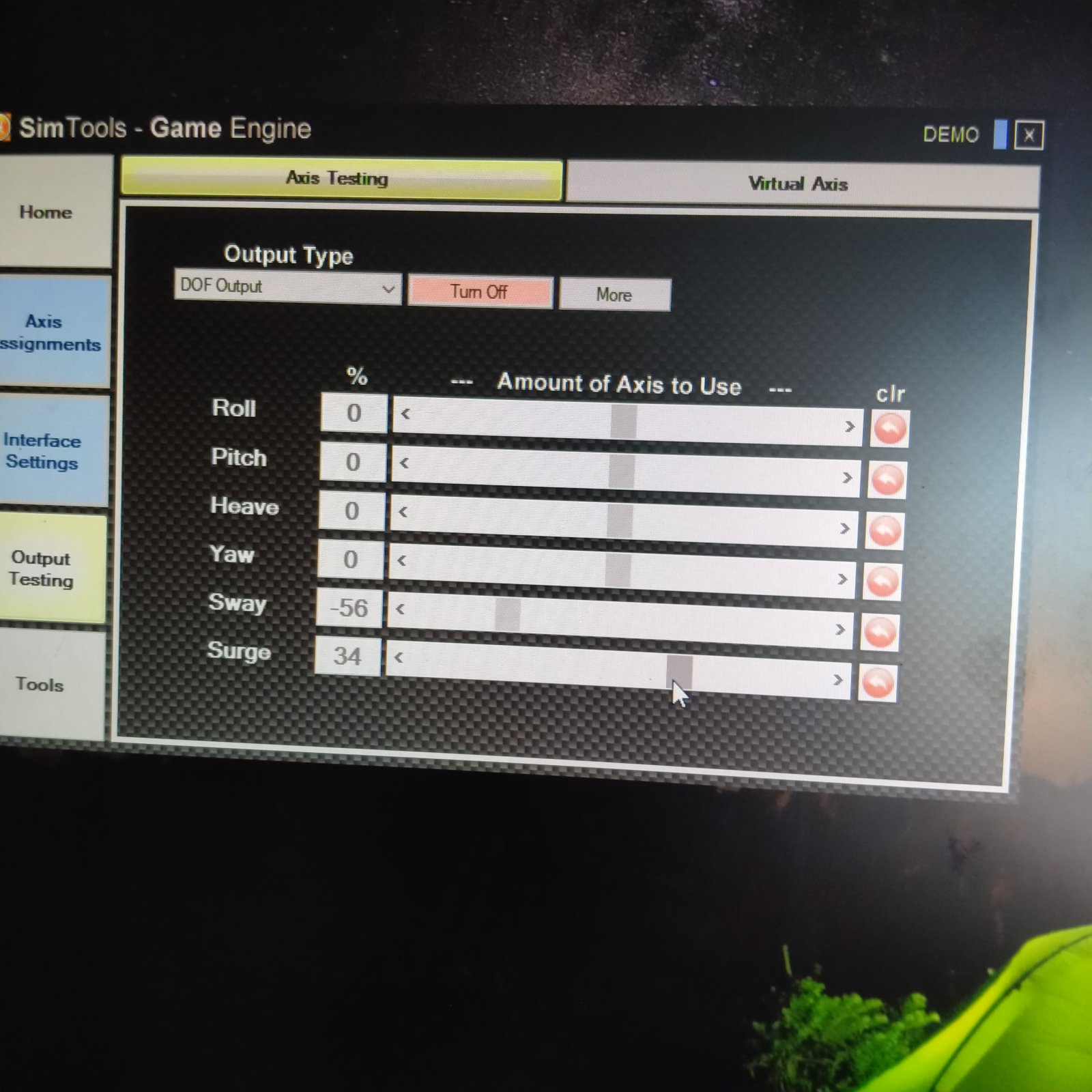

    hello yes I find problem I can not run the engine with the gamemanager simtools with the mouse. I also think my Arduino code is not good. Can you help me, thank you my friends

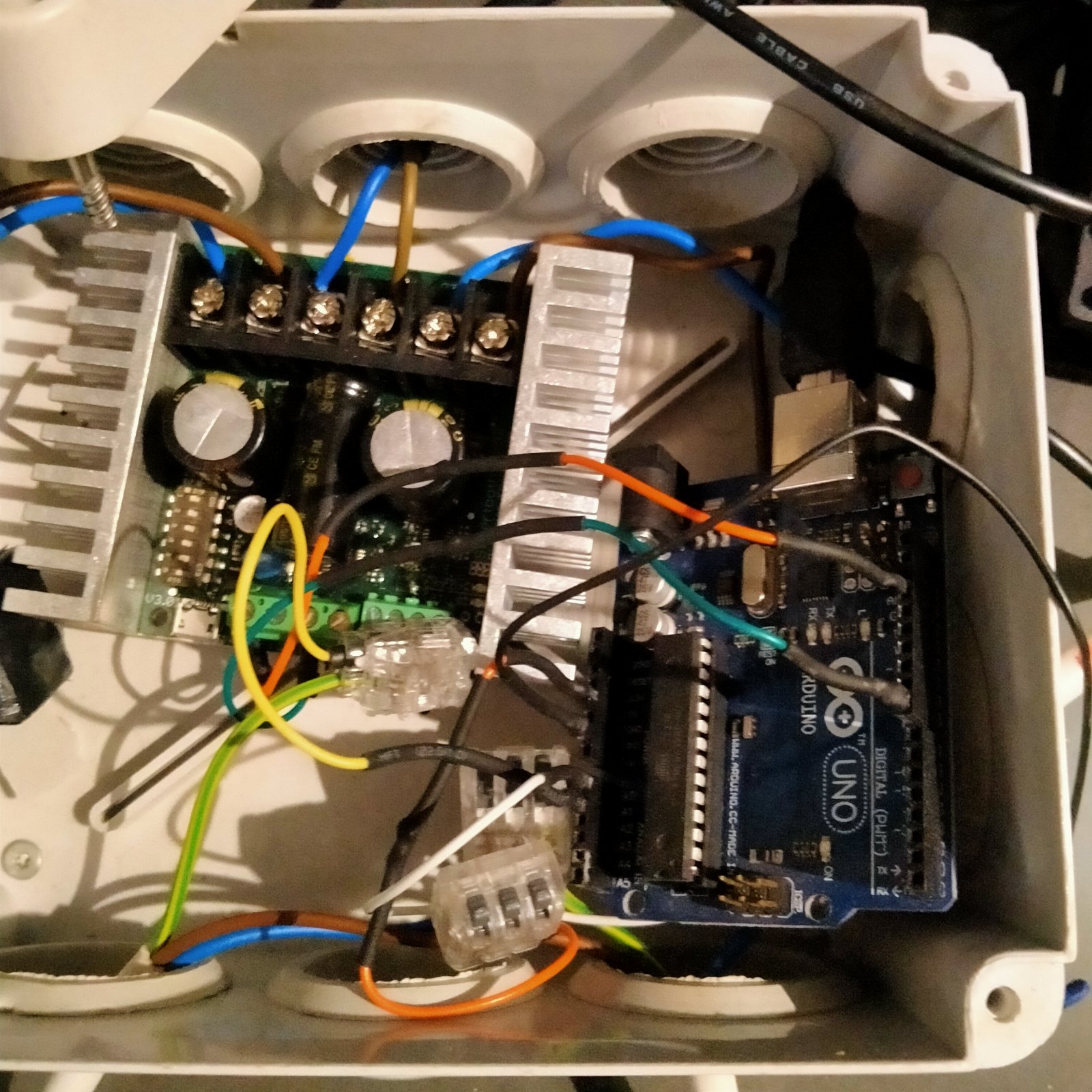

  8. titofe
    titofe Member
    Mar 21, 2020
    150
    652Coins
    +17 / 0 / -0

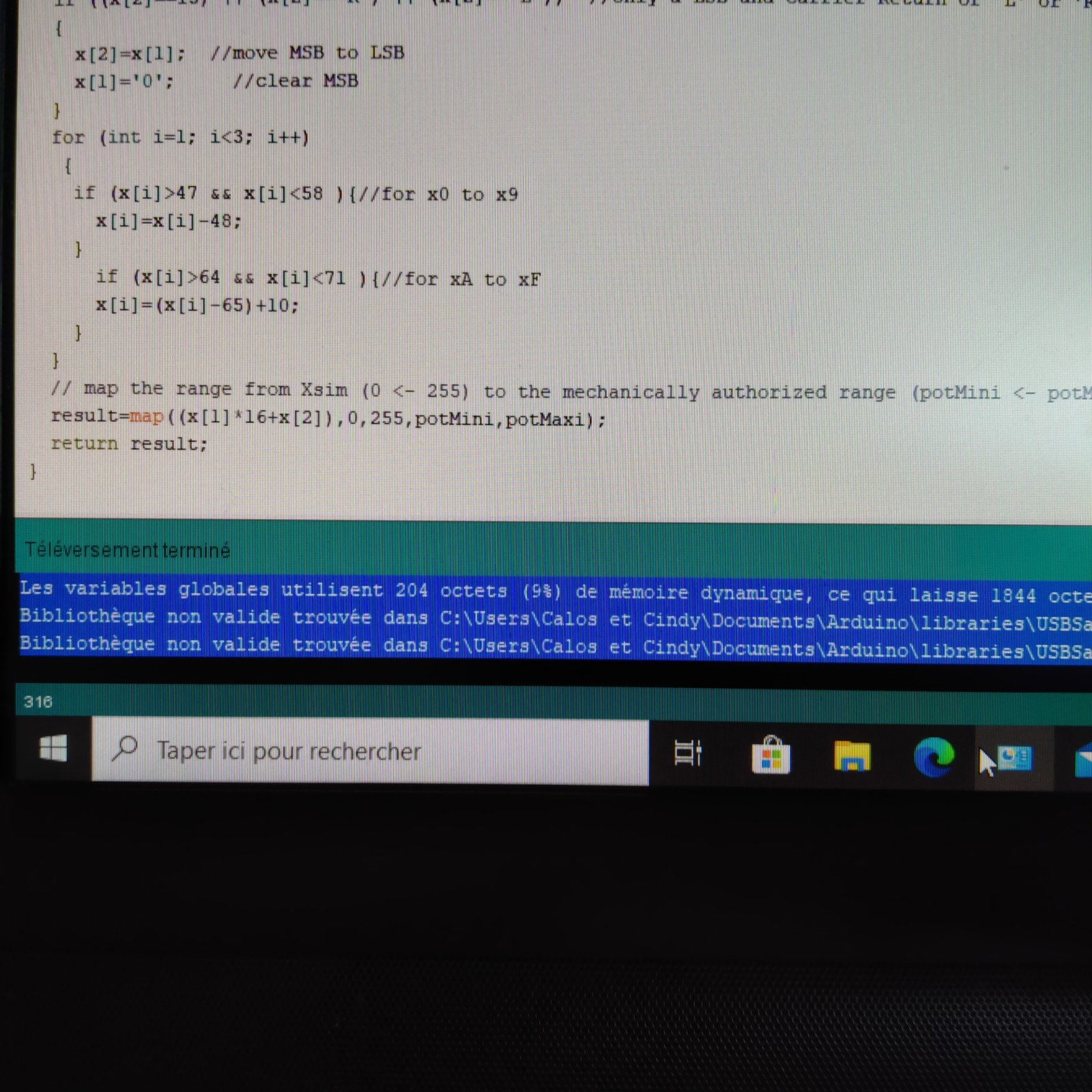

    hello thank you for your answer and yes I will post photos so that they grow see my Arduino code also it is not beautiful my opinion in the forum on will have person who has an Arduino code for MM IMG20200525190051.jpg IMG20200525190051.jpg IMG20200525185528.jpg IMG20200525185902.jpg IMG20200525185956.jpg IMG20200525190005.jpg IMG20200525190032.jpg IMG20200525190005.jpg IMG20200525185956.jpg IMG20200525185902.jpg IMG20200525185528.jpg IMG20200525190051.jpg
    hello friends I wanted to show you a photo of my arduinn I have a message that appears to me I want to use a mm card is it normal or not what is happening thank you beauty IMG20200525185902.jpg

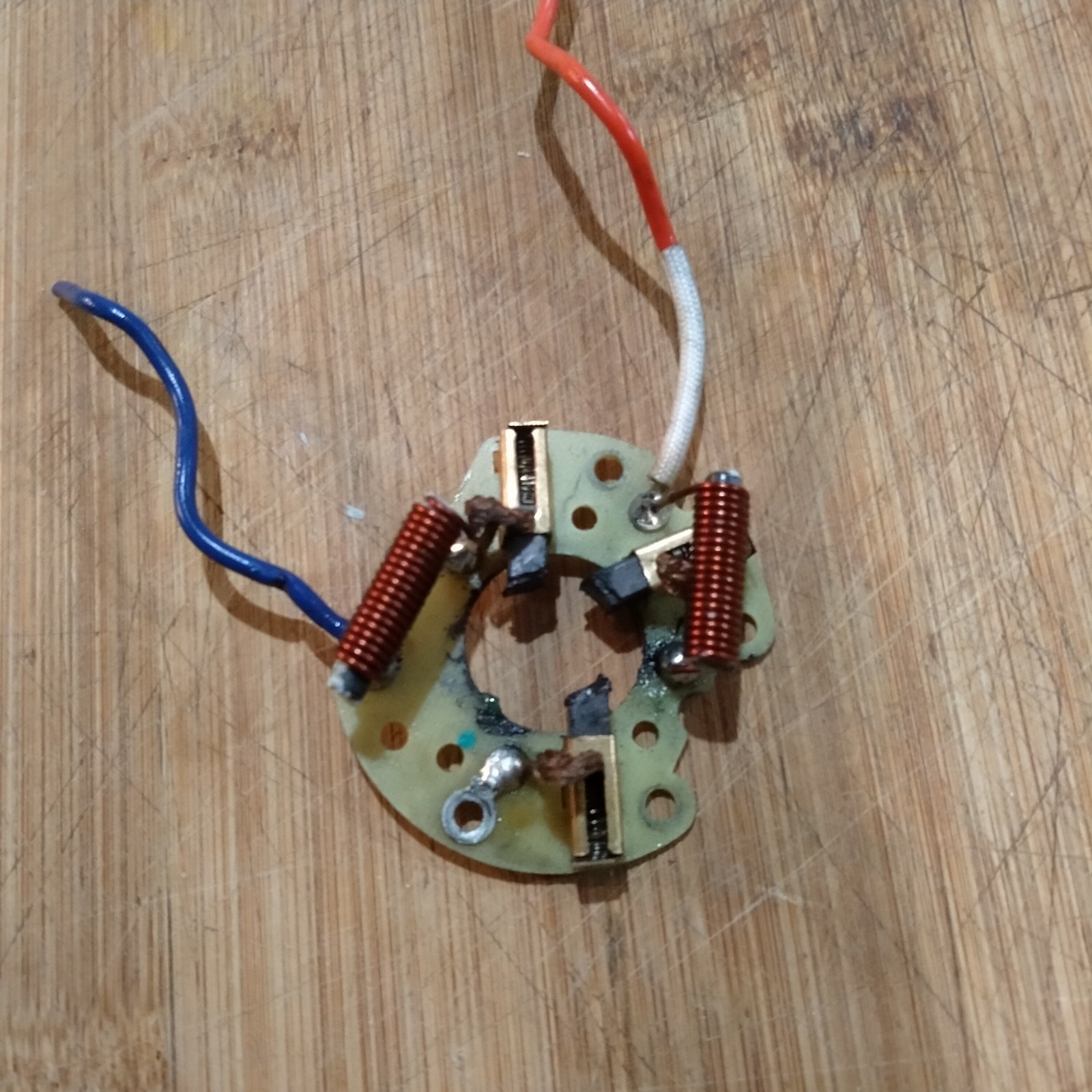

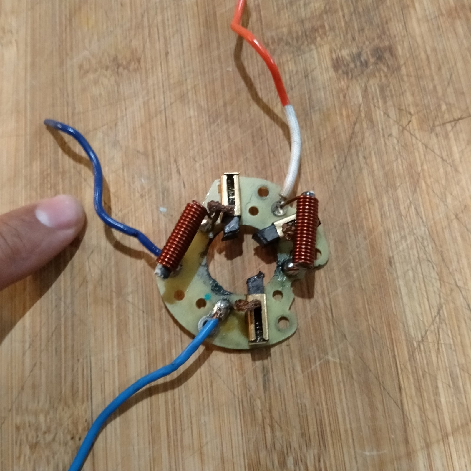

    hello friends I changed my cards I bought a new 2x32 sabertooth card I dropped the MM. I wanted to know my friends. I posted the photos of my engine is it you can help me m '' help with the isolation of the mass; in the photo there is dark blue and red I remove the dark blue and I put a light blue in that place is it good for me photo number 2 Thanks for your help

    +15 / 0 / -0
    Hello bon soir Titofe,
    Where you soldered the light blue wire for ground there is a "ring" connected to it where a screw goes into the Motor Chassis. To properly isolate the chassis you must get rid of that connection there. I just did that by folding the ring up, and pushed it to the side a little. Now the screw makes no connection anymore. (I don't know if that is the problem, it's just a small thing i noticed because i just did it myself) j'espere que tu peux fix it et commence à racer (excuse my french :D
    Hello, thank you for your answer; the dark blue thread I remove it then I keep the light blue and red thread thank you for killing the French are great don't worry mine is not better ;): inches: cheers

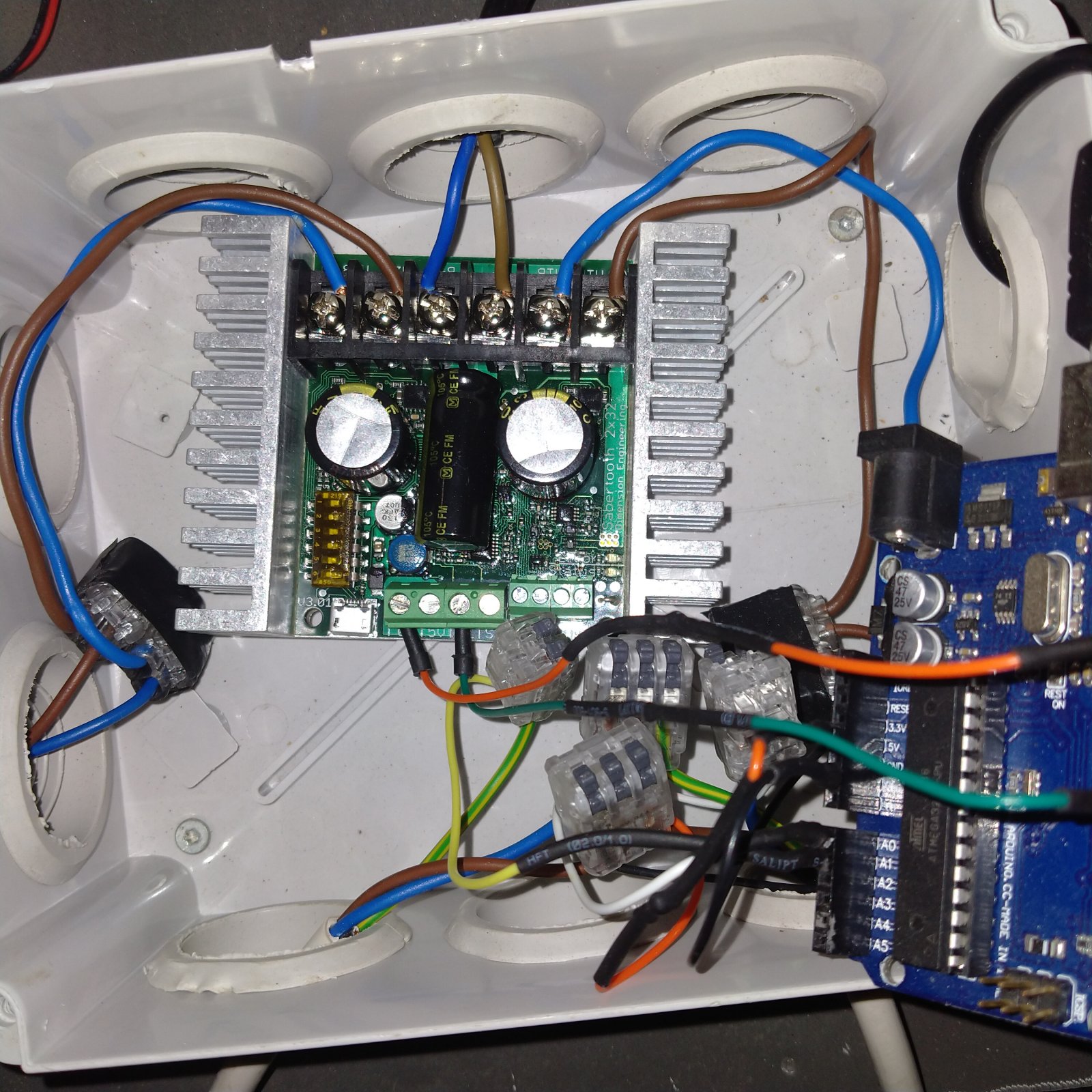

    hello all the friends after several days of reflection on the moments of galley I decided to change my card sabertooth 2x32 can you help me compared to this new card I know nothing and I am lost thank you IMG20200706154240.jpg

  14. Fernando Godinho
    Fernando Godinho Member
    Feb 23, 2019
    35
    Entusiasta de simulação
    Brasil - São Paulo - Guarulhos
    70Coins
    2DOF, 3DOF, Arduino, Motion platform
    hello titofe I had the same problem at the beginning and solved the arduino connections with the H bridge and changed the wires to the correct position
    needing to let me know that I help you
