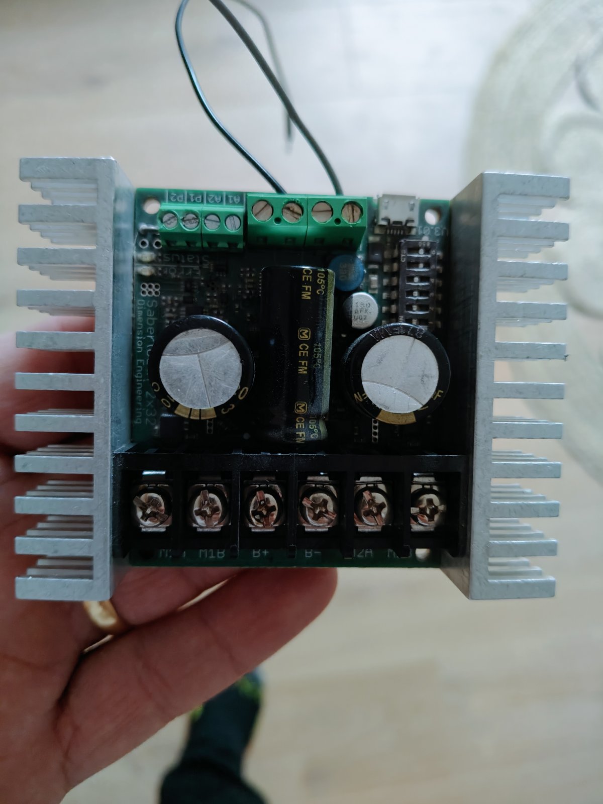

    hello friends after changing the card with motor 1 I started motor 2 and it does this to me it gets too hot and the card gets too hot what could it be thank you

    hello friends after changing the two iBT 2 cards for a 2×32 sebartooth card, I followed the connections the settings I found a problem, can you help me please I will post a video thank you guys.

    What happens when you increase Fpid, and set Step to 100, as per the instructions?
    Can you also please confirm the required DEscribe settings have been done.

    It doesn't matter fpid so when I turn on the engine it starts to run straight away it's not normal. describe it it was correctly the card was detected correctly. thank you

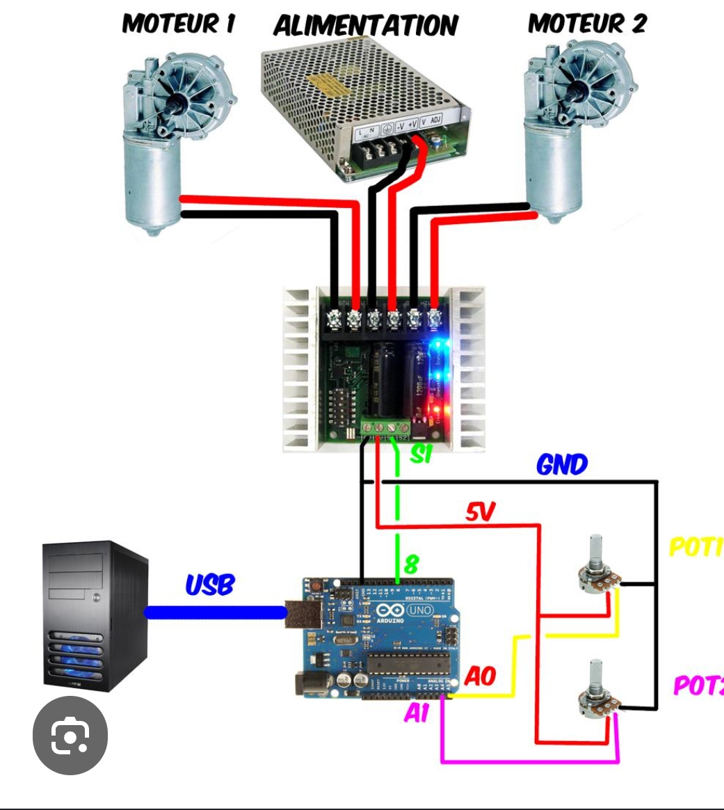

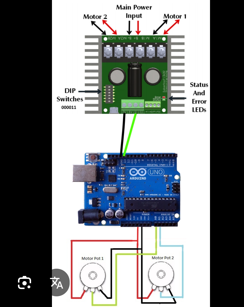

    Sounds like you have hardware and/or wiring issues.

    Hello. I used the first wiring. for you I should use which of the two thank you
