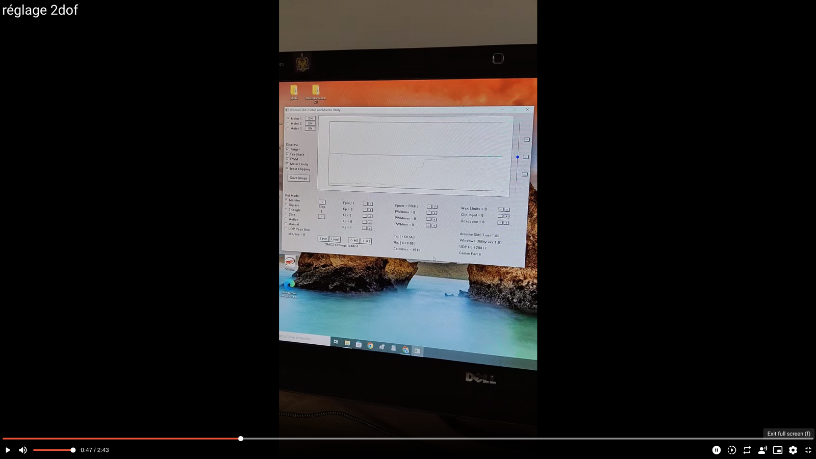

    hello when I say I have lost everything it is because even the first motor adjustment it no longer works it turns without stopping the green line on the potentiometer goes up it goes down it does not stop the engine between the red lines. I changed the two ibt 2 cards they are brand new the settings they do not take as soon as the engine turns the green potonciometer line it goes up quickly outside the red lines. Smc3 I reset everything to zero I started everything there is nothing that takes it's strange. I'm going to change my Arduino card. Thank you

    For now I would suggest following the SMC3 instructions and tell us at what step anything goes wrong:
    8. Set Kp to about 400
    10. Do the above for each motor
    When SMC3 starts the pot should already be centered.
    What is happening in this part of the video, I can hear a clicking noise but have no idea what you are doing:

    hello tomorrow I attack your proposal I follow them. at 47 seconds it's me who moves the potentiometer the green line to align it with the blue.

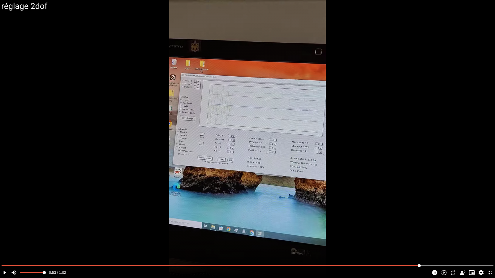

    Here Max Limits is set to 0 and it does not look like the pot is centered, hence my suggestion to follow the SMC3 setup instructions to the letter, as a baseline:

    hello I just put some videos online to report that you asked me for the 10 steps to do thank you
