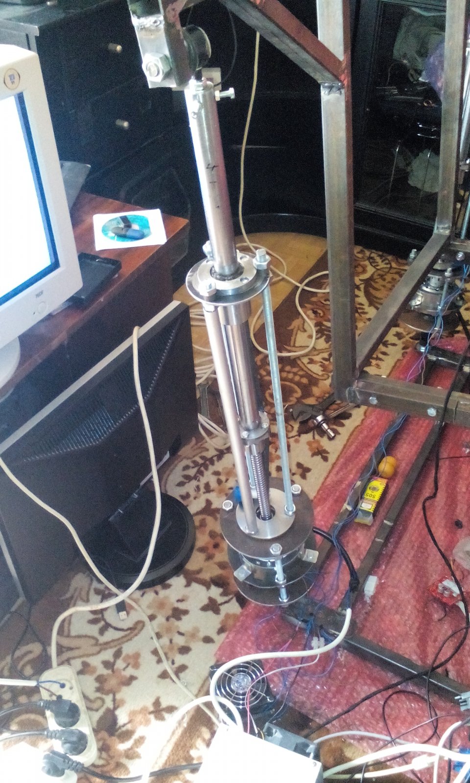

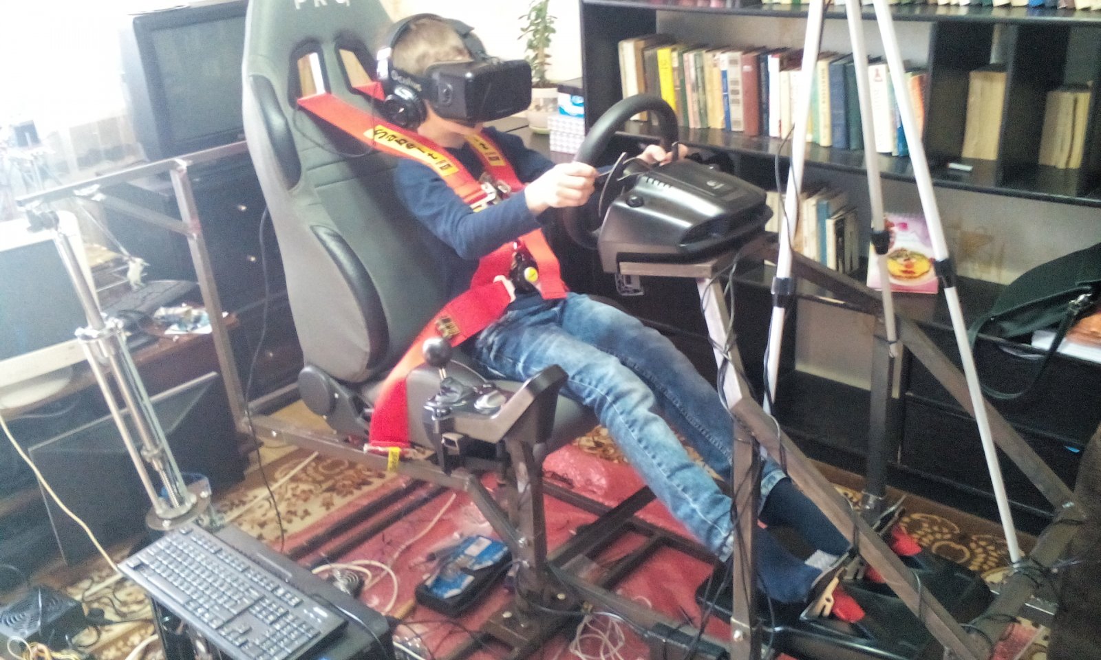

    Here and I have made the simulator, it consists of two actuators on them motors 12V 320W , Arduino UNO, Monster Moto Shield this is the plan.
    Thank you all, waiting for answers and questions

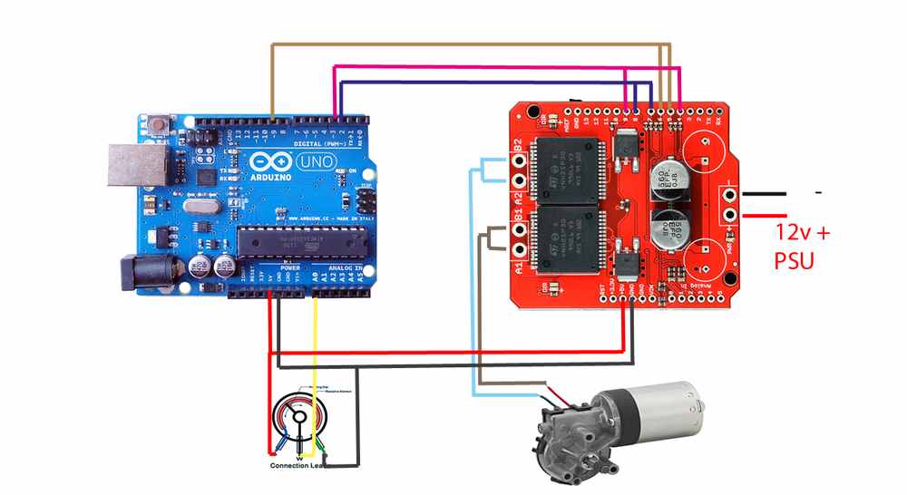

    Monster Moto Shield is connected according to the scheme, as on one Monster Moto Shield driver is disconnected on an overload.

  6. mariano68
    mariano68 Active Member
    Nov 15, 2014
    577
    builder contractor
    Argentina
    3,338Coins
    +395 / 2 / -0
    2DOF, Arduino, 4DOF
    Nice project!

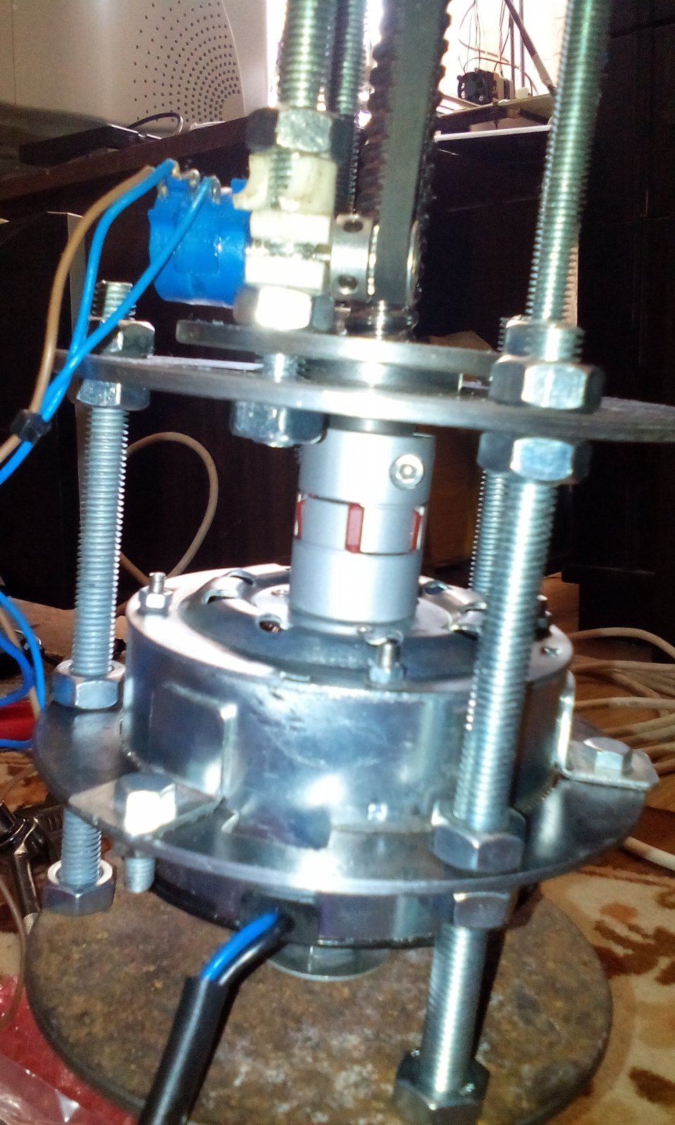

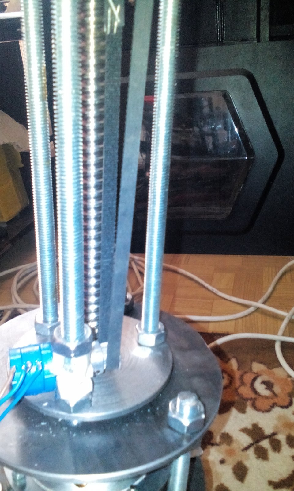

    Could you mind to post more detailed pictures of your actuators? Specially I would like to see the part that fix the ballscrew with the rod. Thanks!

  8. lioxacydak1
    lioxacydak1 Member
    Feb 28, 2015
    52
    rescuer
    - 249Coins
    +16 / 0 / -0

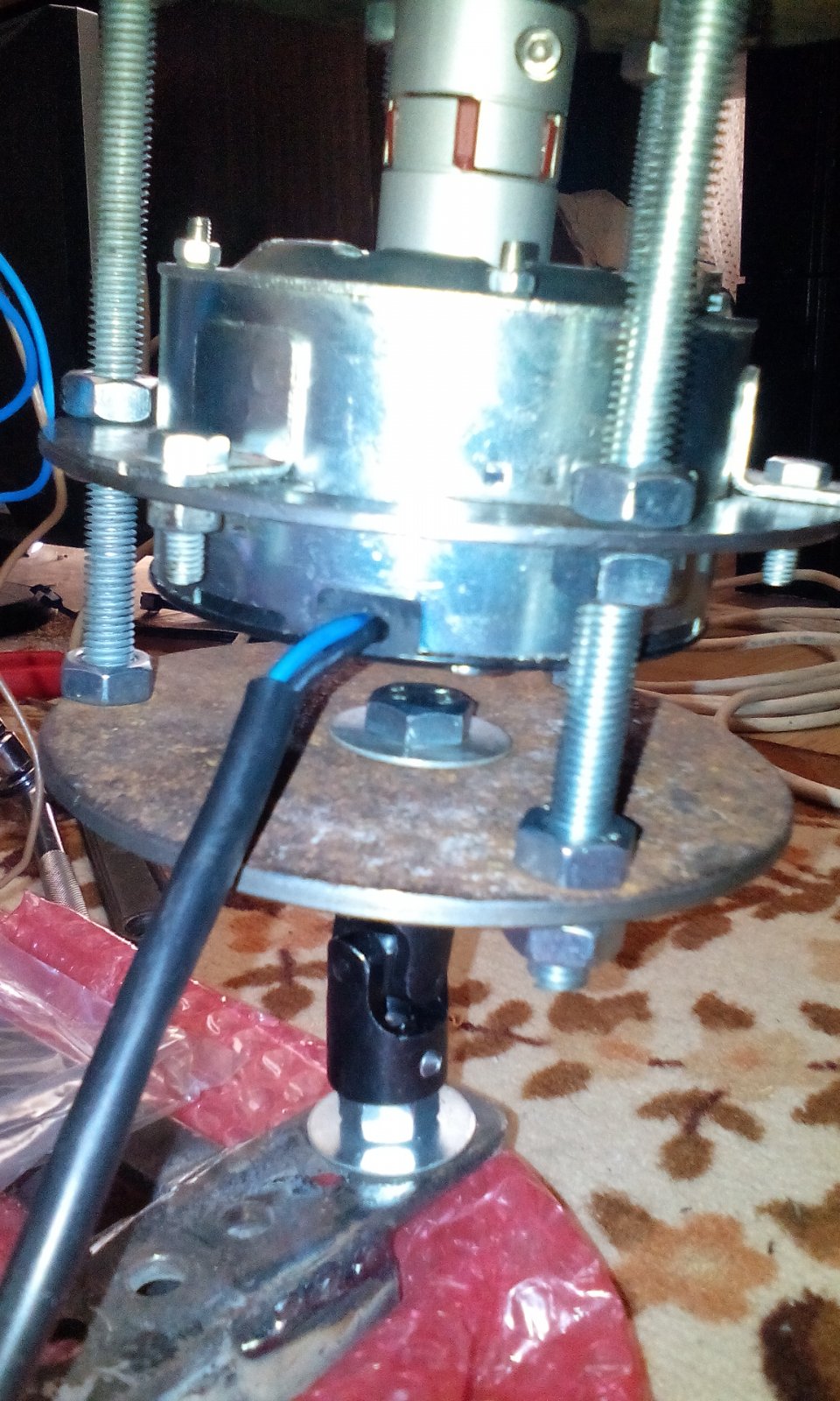

    it's the actuator
  9. lioxacydak1
    lioxacydak1 Member
    Feb 28, 2015
    52
    rescuer
    - 249Coins
    +16 / 0 / -0
    this connection of the motor and screw
  10. lioxacydak1

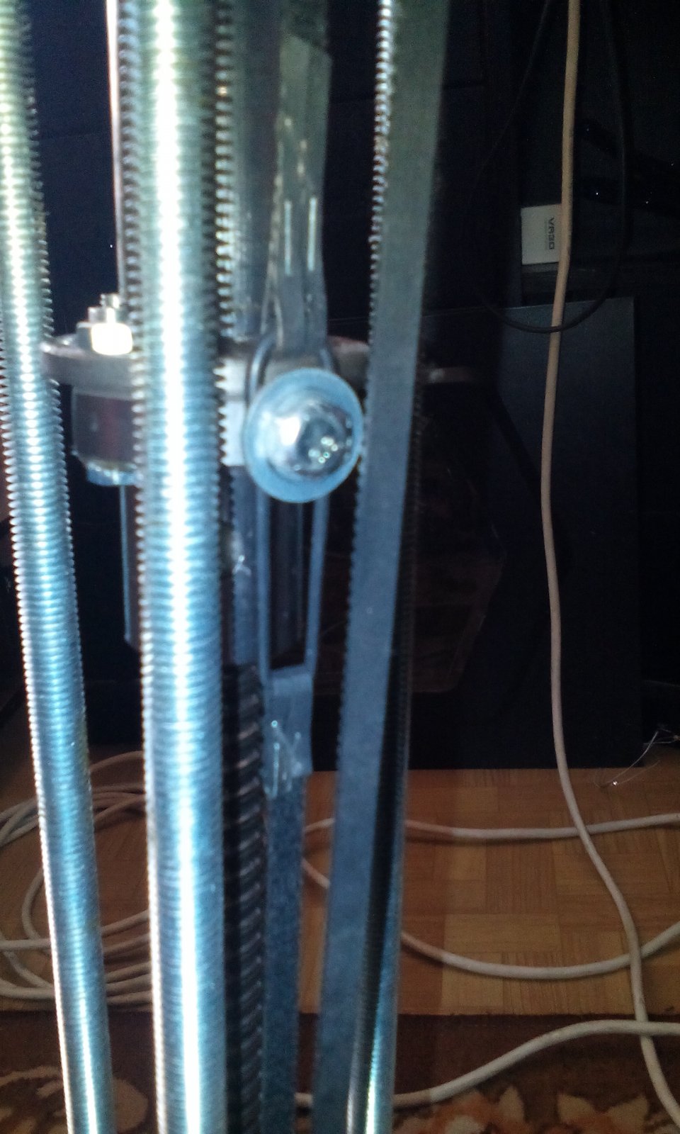

    this is the lower cross-piece
  11. lioxacydak1
    lioxacydak1 Member
    Feb 28, 2015
    52
    rescuer
    - 249Coins
    +16 / 0 / -0
    this strap mount feedback and shaft through the rubber rings

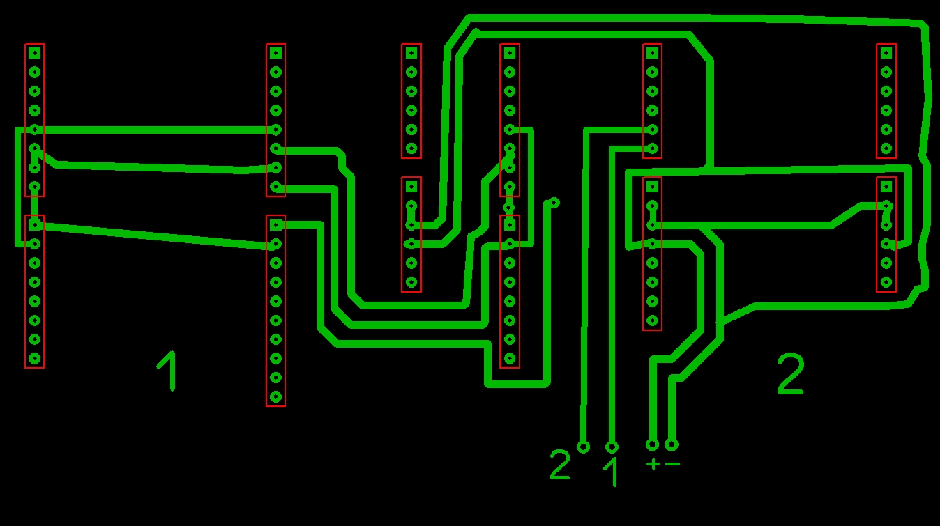

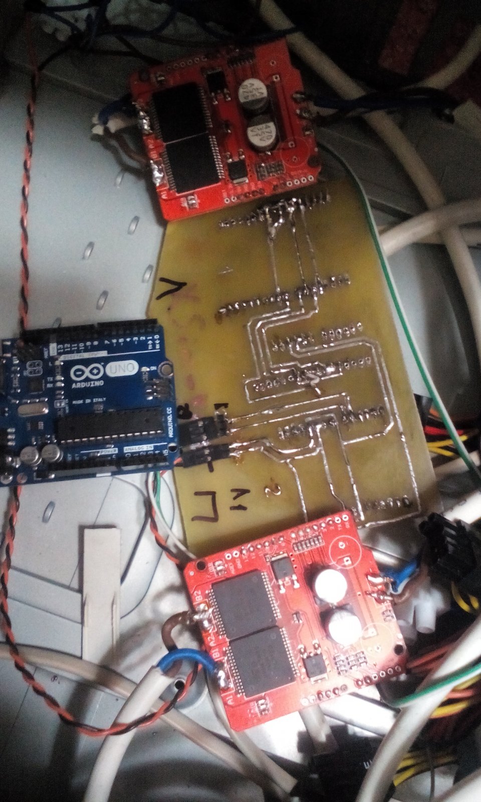

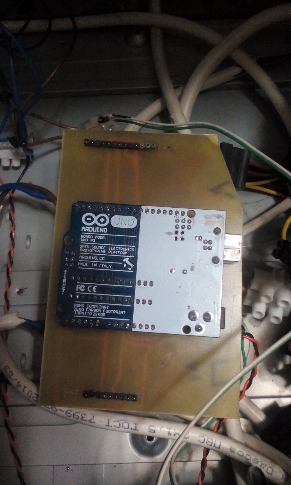

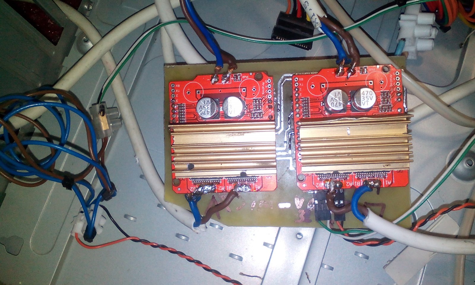

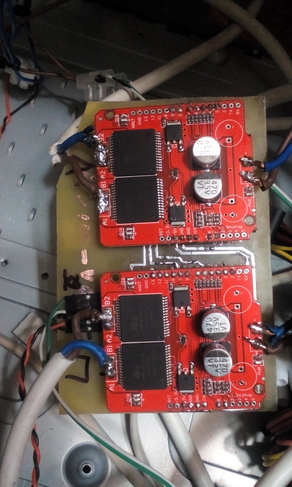

    After lengthy tests I decided to make a payment for the best replacement of electronics.
  17. lioxacydak1
    lioxacydak1 Member
    Feb 28, 2015
    52
    rescuer
    - 249Coins
    +16 / 0 / -0
    Here is a photo

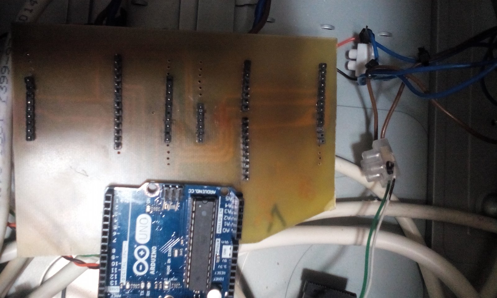

  18. lioxacydak1
    lioxacydak1 Member
    Feb 28, 2015
    52
    rescuer
    - 249Coins
    +16 / 0 / -0
    Here's another photo
  19. lioxacydak1
    lioxacydak1 Member
    Feb 28, 2015
    52
    rescuer
    - 249Coins
    +16 / 0 / -0
    And here's the scheme. You need to take it. The program Sprint-Layout 6
