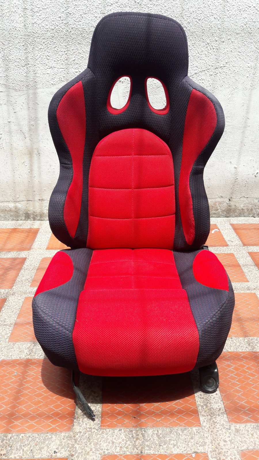

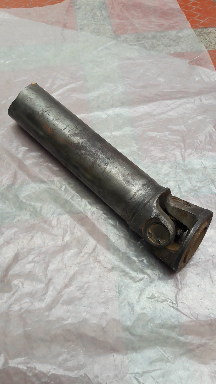

    my last acquisition a U joint robust enough and a sports chair
