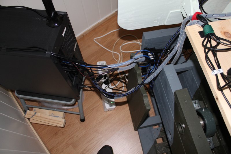

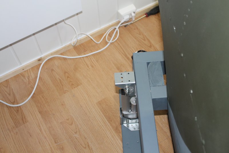

    This is my replica Spitfire VR cockpit with my son flying it. ( DCS ) 550 hours put in so far. Only one problem left....it does not fly!
    Thanks to this page I`m sure I can make it move in pitch and roll. Things are hooked up for it using fotbearings.
    I have read a lot about this so far and I realize it is a rather long learning curve involved. First step from me was to order some electronics ( Arduino, Monster shield ) and just learn and take it from there.
    The stuff are balanced and it takes around 5kg to 15kg of trust to move a person in it. The case here is not to move things like roller coaster, but to get response when you push the stick in some direction. Slow moving will do the trick as far as I can see it.

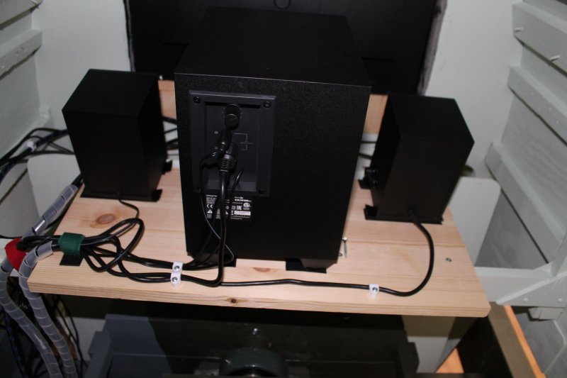

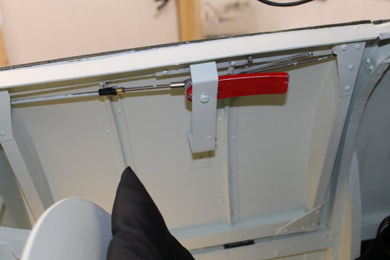

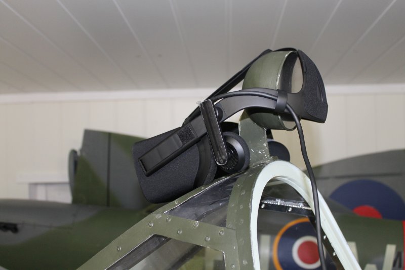

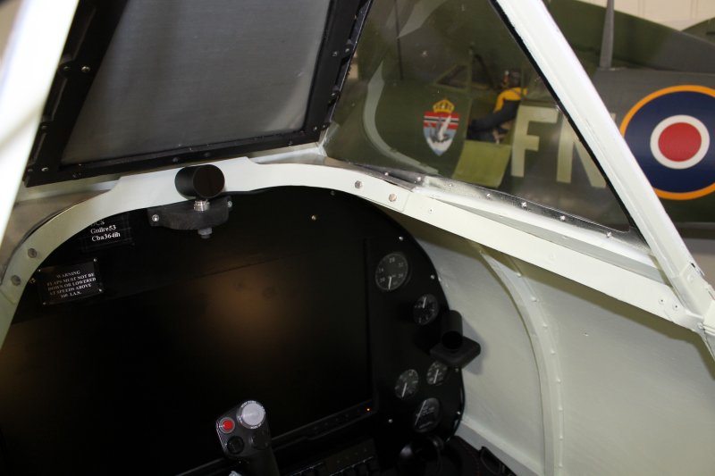

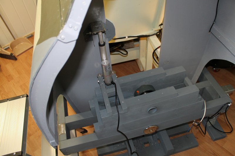

    Some information here and pics regarding this sim. Maybe these can make a new builder get some ideas and make it even better.
    Those two actuators mounted are just two low cost bought on Ebay. ( With feedback )
    The fun thing is that they seem to work just fine when i tested them manually. They are said to withstand 450 NM
    of trust and after testing this seems to be the case. ( the sim is balanced so not much force is needed actaully.)
    Under $ 100 for one :) For a car sim these actuators are too slow of course, but for a flight sim this is different story.
    Stroke is only 10 cm and maybe I will change to 15/20 cm i the future. The idea is to trick the brain and so far this looks good.
    Waiting now for arduino cards and 12v dc so I can go further into this.
    Cockpit is a Spitfire Mark IX replica/mock up for VR ) built after drawings made by Paul Monforton. ( order online )
    Scale with DCS`s Spitfire in VR is outstanding. Closer to flying a Spifire without actally flying one is not
    possible to day. With moving this is really going to take off. :)

    Got my Spitfire cockpit working yesterday. At least 40% increased fun factor. :) Ended up with two Polulu jrk 12 / 16 volt. Tried to understand the arduino set up but I could not make the codes. Those created by other users might work. but I failed with those too. JRK`s are much easier for a beginner and simtools takes it over when started up. What a good software! The new version is even better. Managed to get the "flip over" effect decreased and I`m sure there is much more to adjust.
    There are some negativ information on some threads regarding the DCS plugin. Nothing is wrong with it, but I spent many hours before things worked ok, but not because of the plug in. Also the new Yak 52 works beatiful together with the Spitfire. Not tested with the F15 but I`m willing to bet that that airplane works as well.
