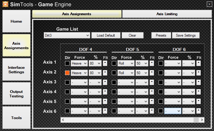

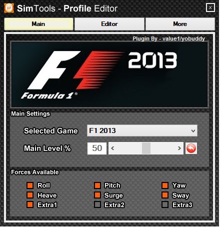

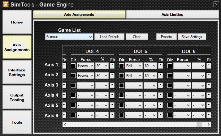

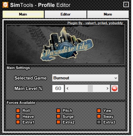

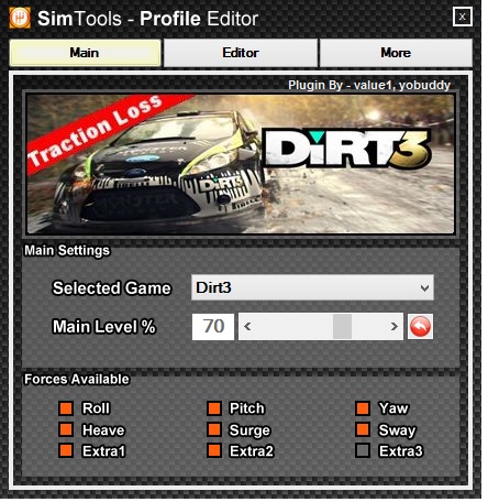

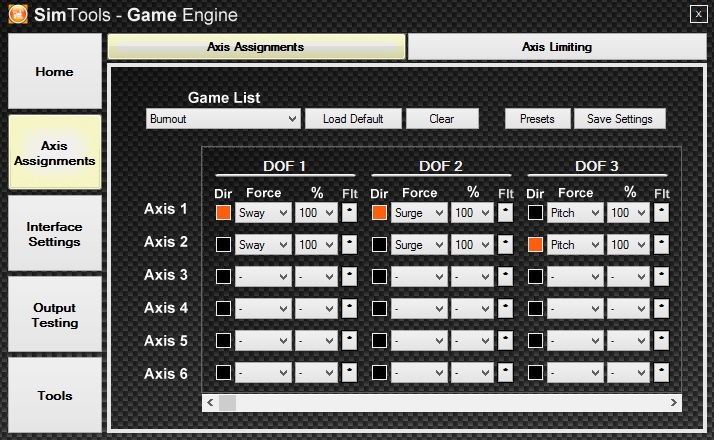

    So here are some profiles for Dirt 3, F1 2013, and Burnout.
    The Main Profiles of the Game Manager are between 50%-70%. NOne are at 100% yet. I need to build up slowly seeing the weak points and where I need to strengthen.
    I would like to feel more heave and surge if I'm honest.
    I will test out the new 150degree Arduino change when I have some feedback on my Settings.
    SimTools_GameEngine_Burnout_1.jpg SimTools_GameEngine_Burnout_2.jpg SimTools_GameEngine_Burnout_Profile.jpg SimTools_GameEngine_Dirt3_1.jpg SimTools_GameEngine_Dirt3_2.jpg SimTools_GameEngine_Dirt3_Profile.jpg
    20,551
    145,124Coins
    +10,778 / 52 / -2
    Your % allocations are way to high @Leo Burton, you should aim for a total of 100% or just a bit over, have a read of the information here: http://www.xsimulator.net/community/faq/axis-assignment-percentage-totals.120/
    Start at 20% per setting, do sway, surge and heave in that order, when you have them nailed try adding some pitch and roll, keeping in mind that they will somewhat lessen sway and surge.
    You can find other SimTools setting tips in the FAQs: http://www.xsimulator.net/community/faq/simtools-settings-tips-and-tricks.18/category
  15. Leo Burton
    Leo Burton Active Member
    Jul 23, 2014
    163
    London, UK
    2,625Coins
    +129 / 1 / -2
    Thanks @noorbeast
    I didn't know that. Didn't see it in the Quickstart guide or documentation. Must have missed it.
    So for example, Surge 20, Sway 20, Roll 20, Pitch 20, Heavy 10, Yaw 10
    So when it comes to responsiveness and power, is that the Main Profile percentage?

  17. noorbeast
    20,551
    145,124Coins
    +10,778 / 52 / -2
    What percentage you end up setting for each DOF depends somewhat on the rig design. Start with one force like sway at 20%, try it in game including tweaking the Tuning Center settings, increase the percentage if needed but keep in mind that something like 120% total should be a limit for all the DOF you intend using. Do each force setting in isolation until you know what is best for each, then try them together.
    Sway and Roll are actually different forces, as are surge and pitch, but yes there is a degree of cancellation between them. Get sway and surge right first before you even bother with roll and pitch. You can run them all, but it takes a fair bit of fine tuning to get the most out of doing so.
  18. Leo Burton
    Jul 23, 2014
    163
    London, UK
    2,625Coins
    +129 / 1 / -2
    I have made the 150degree change on the Arduino Code, so it seems more responsive now.
    I have tried the settings so that all the % add up to between 100-120%, and I can see a difference in reaction time, and sharpness. But wether or not I prefer it to how it was before, I'm not sure. I need more testing.
    But I took the Dirt 3 Main Profile to 90% and damn near got thrown out of my seat (good thing I had belts on)! Its epic! Its almost too much for me, I think it was more palatable around 60-75%, and gentler on the rig!
    I haven't tried Assetto Corsa or F1 at more than 70% yet.

  20. Nick Moxley
    17,054Coins
    +2,504 / 30 / -2
    running anything but 100% is Severely limiting motion and the TRUE min/Max's the games are offering, I HIGHLY suggest you run the profiles @ 100% and tune from there.
