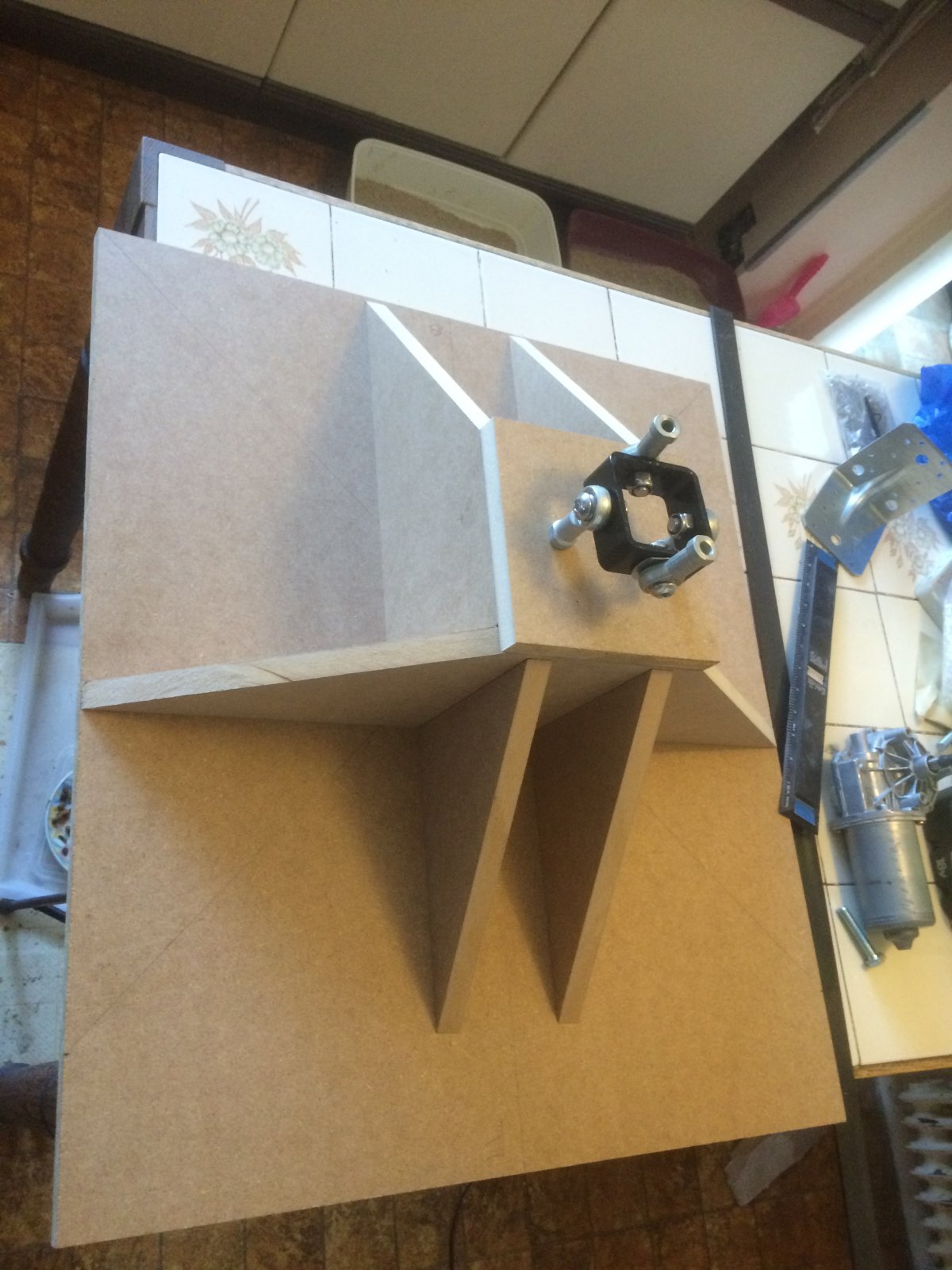

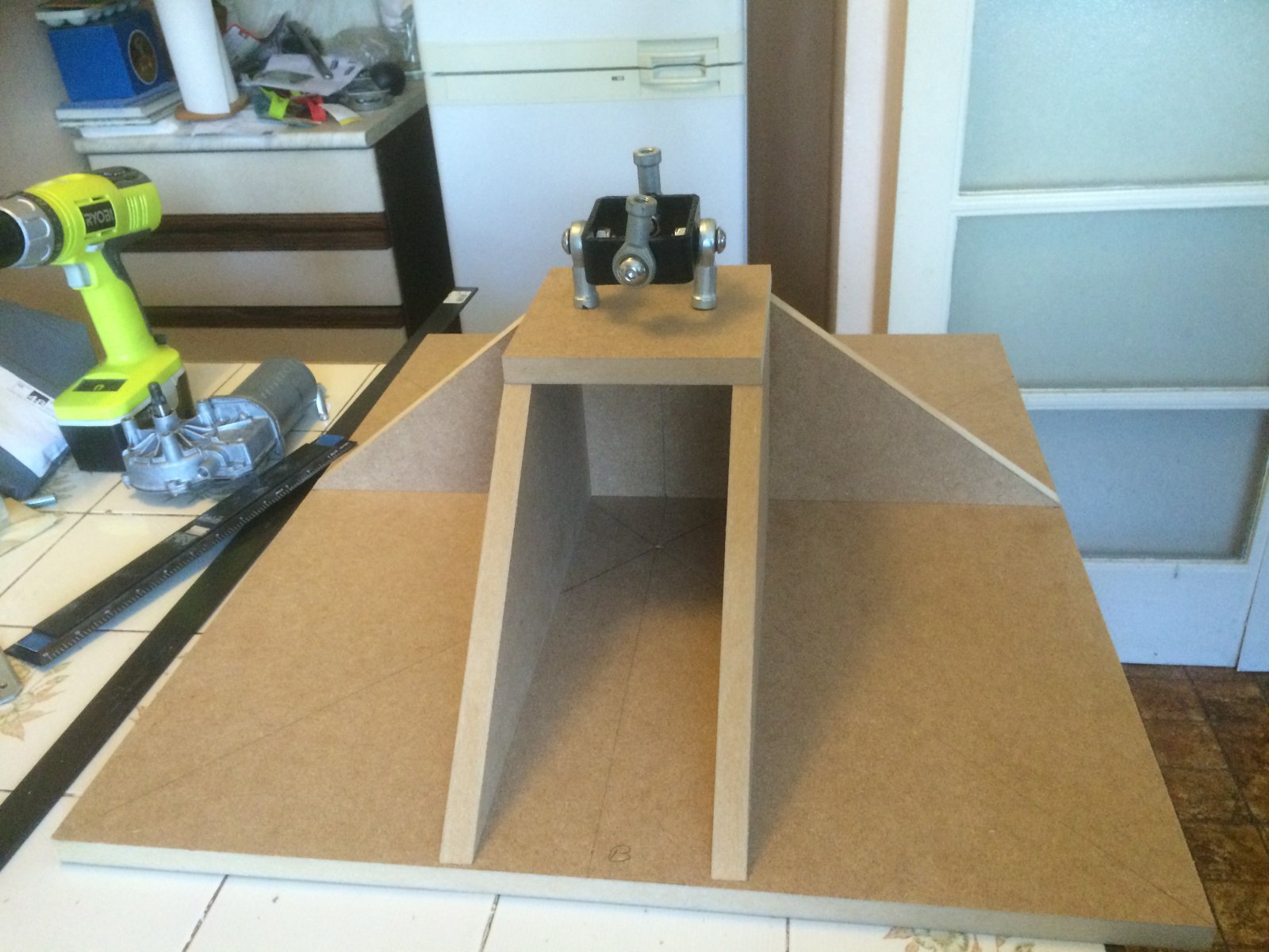

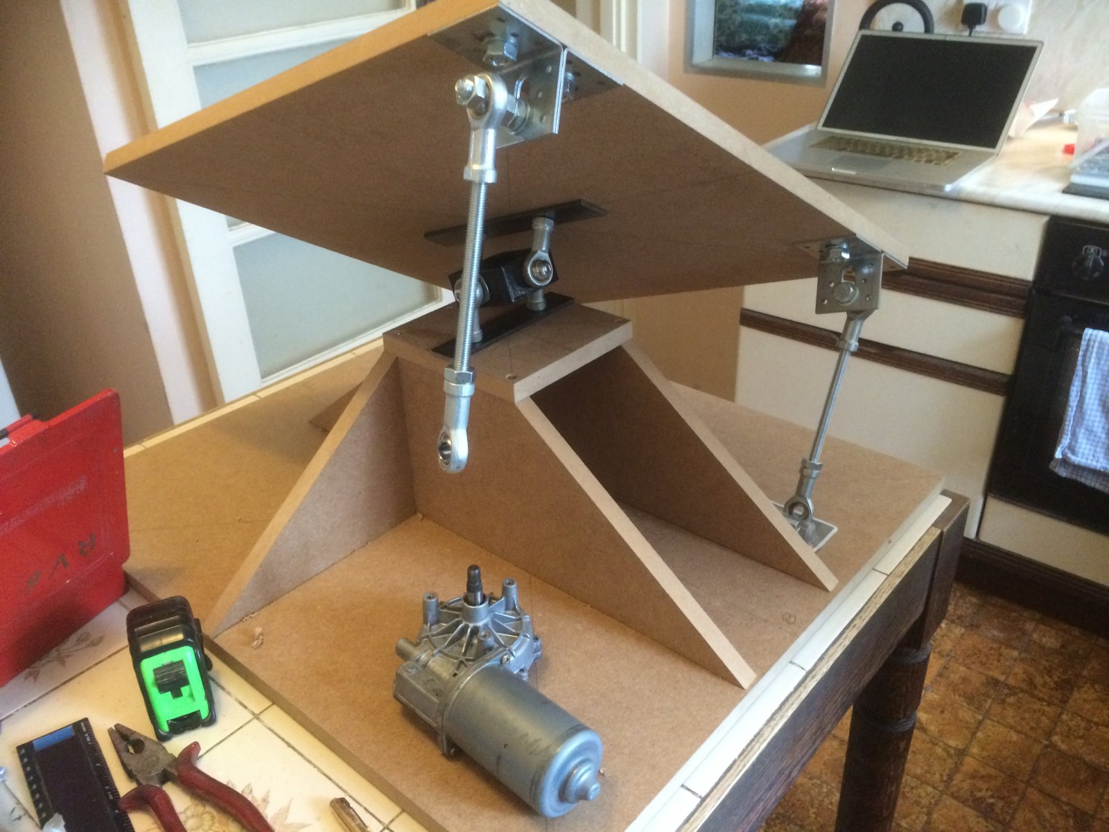

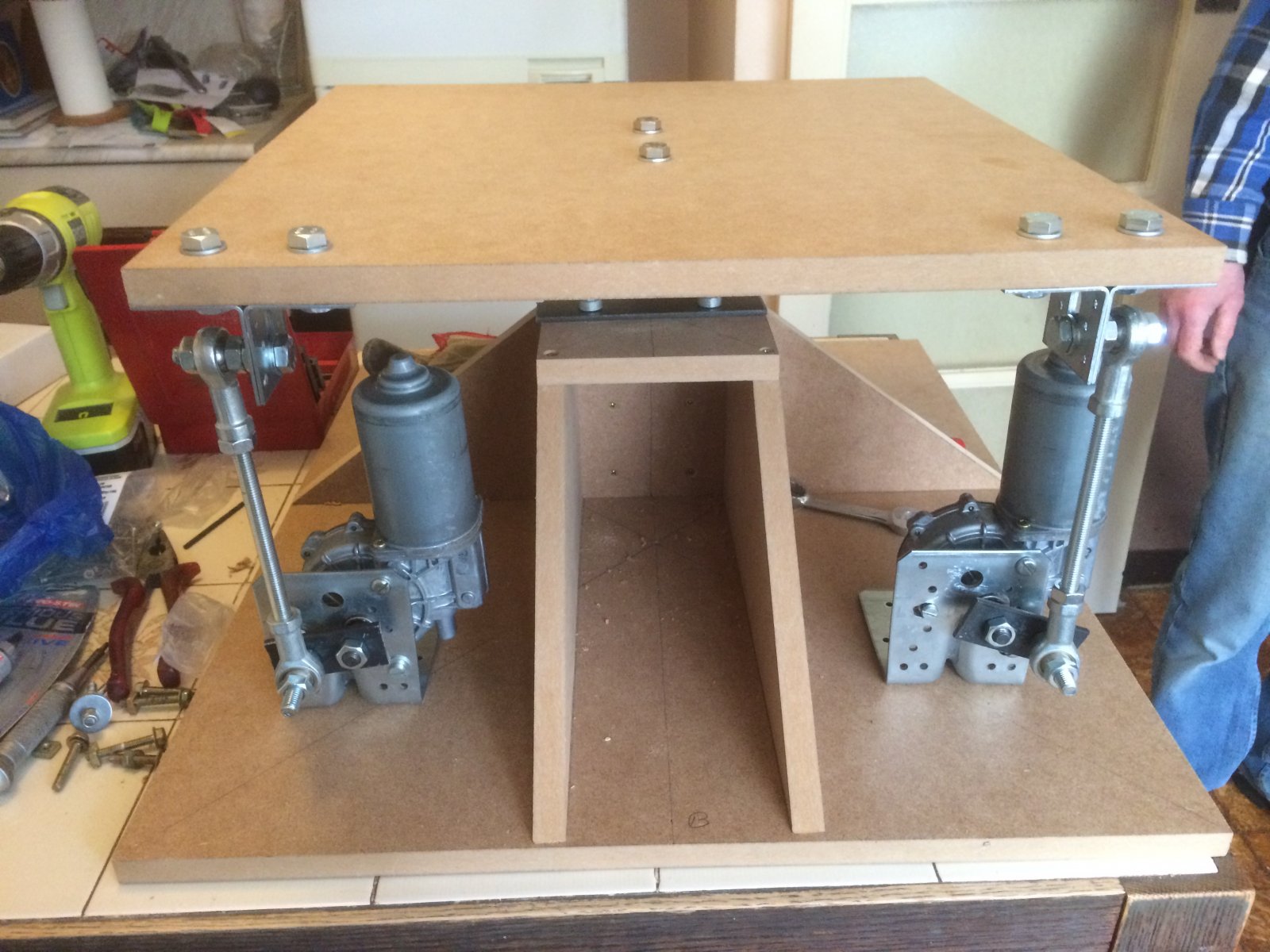

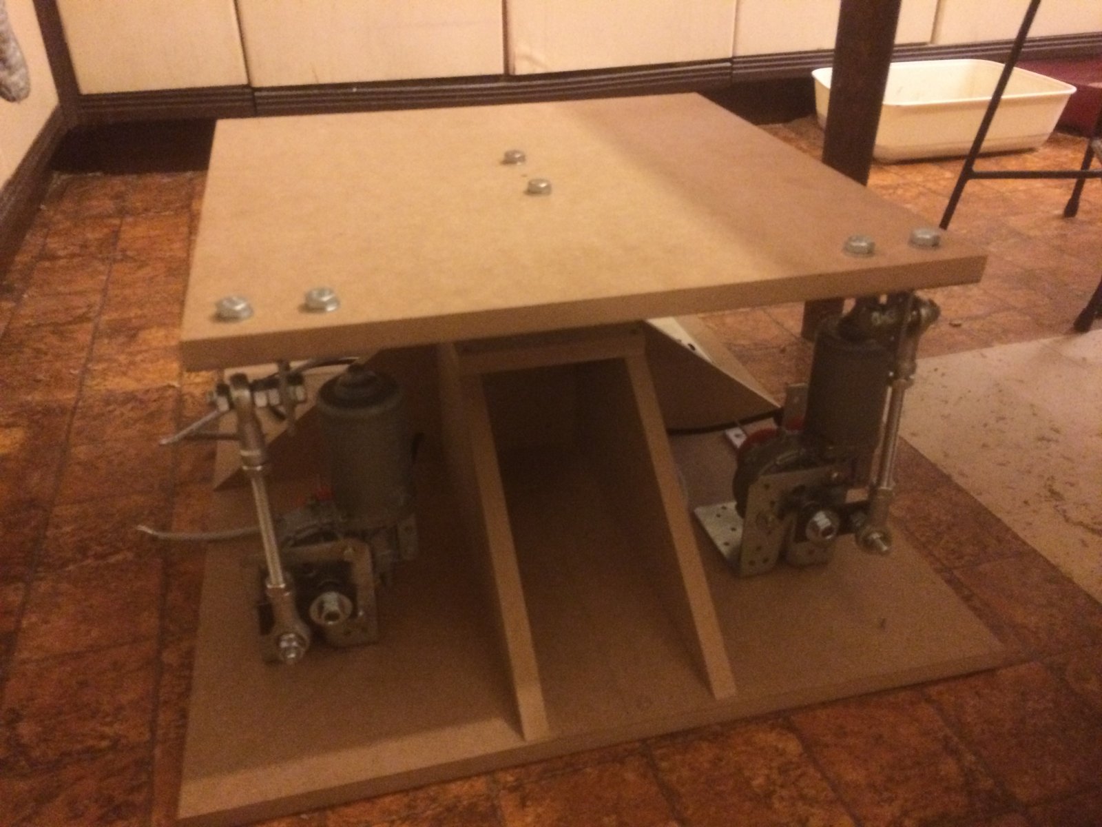

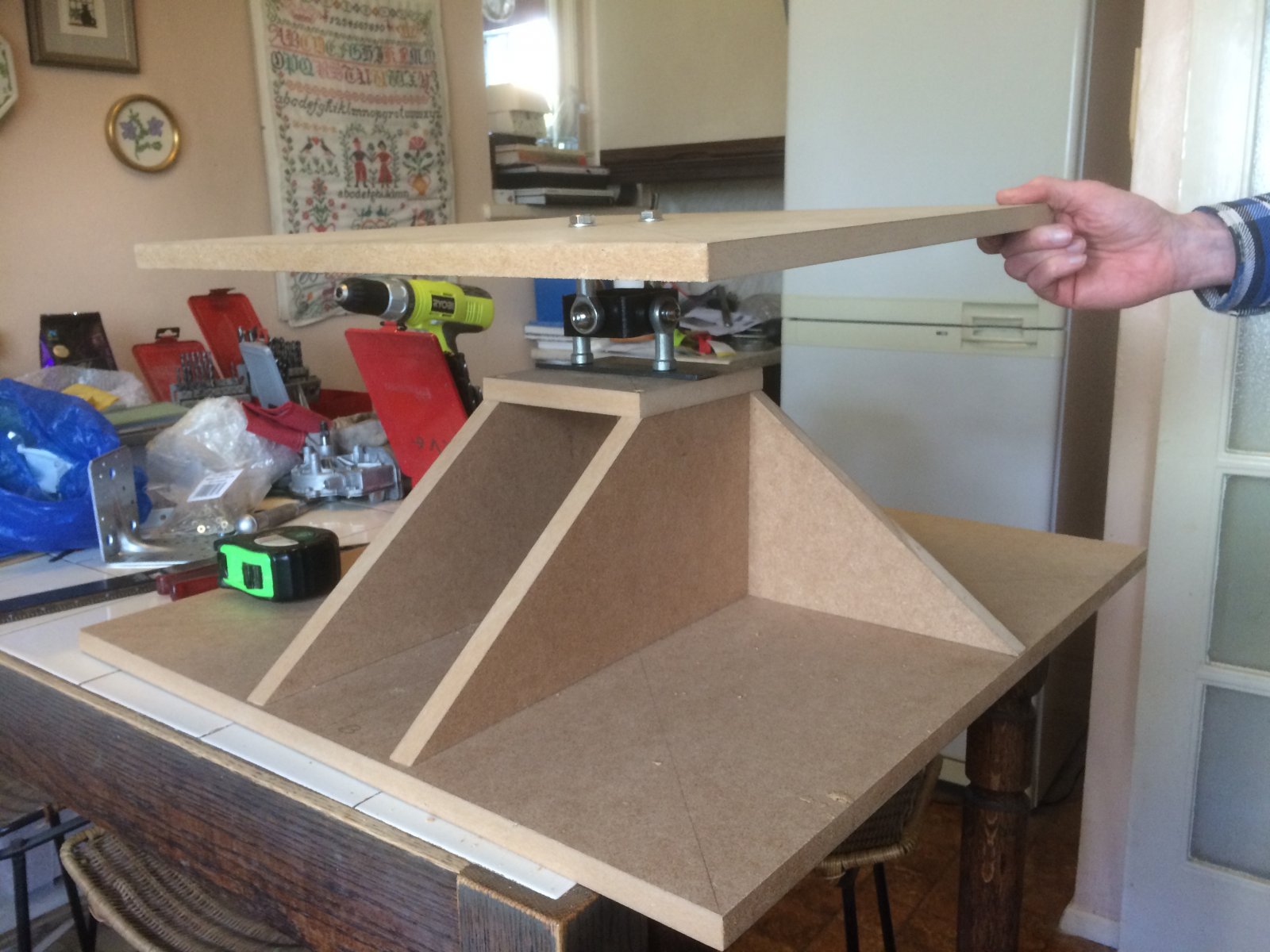

    So, day one went quite well.
    I went over to a friends house who has a cut-off saw and proper tools, and we started building the MDF SimuKit or 'Simulateur LowCost', which I purchased from @Wanegain. (who has been fantastic by the way, from shipping to support)
    I decided to try his 'solution alternative', as I rather liked the clean lines, and no use of a central wooden strut. We got as far a mounting the Pots, power supply, and getting all the wires ready for soldering and hooking up to arduino board before we called it a day. I'd say we're about 80% done on the build stage. Just soldering and a few tweaks here and there. Maybe a coat of paint.
    I'll be back on it next week when I have a clear day. I need to order a more wood for battening the underside.
    Been a lot of fun though.
    But I'm anticipating the software side will take a lot longer to get right!

    I am curious, what is the thickness of those right angle engine mount brackets?

    I decided to go with your suggestion of lowering the vertical panes from 25cm, to 17cm. Its a good clearance, and keeps the motion base low. I was trying to calculate its 'finished' height once I take into account the extra battening and the 7cm wheels I'm putting under it. Plus the height of the Gameracer chair. I'm aiming for a finished seat height of 47cm approx. So when the front wheel&pedal section are removed I can push it up to my desk for the correct height.
  13. noorbeast
    21,584
    151,118Coins
    I guess you will find out one way or the other but a sim can generate a lot of force on motor mounts and that does not seem adequate in terms of bracing.

    Yes I know what you mean. If they don't work out, I'll upgrade them. But they do seem to be fairly heavy duty. It's all a learning curve for me. I can already think of mods I want to do if this one works out.
  15. Nick Moxley
    17,056Coins
    +2,506 / 30 / -2
    those motor mounts WILL flex for sure, You need to be on the Overkill side to GUARANTEE no movement.
    for reference, this small angle was able to be twisted under load, the Big angle....Not Lol
    • Agree Agree x 3

    I am using the same brackets and it's not flexing (I guess I have to shoot a video to be totally sure). But I agree that something stronger would be better. You can for example put 2 brackets side by side.
  17. bsft
    even just welding some triangle bits of steel on the sides will help. Ive had 3mm thick brackets before and hat solved the problem.
  18. noorbeast
    21,584
    151,118Coins
    A video would be good @Wanegain.
    Flexing is normally is a question of both the material thickness and how it is braced. Initially I had mine mounted 8mm aluminum but it still had a little inward flex, which is what led be to design the brace bar between motors on my sim.

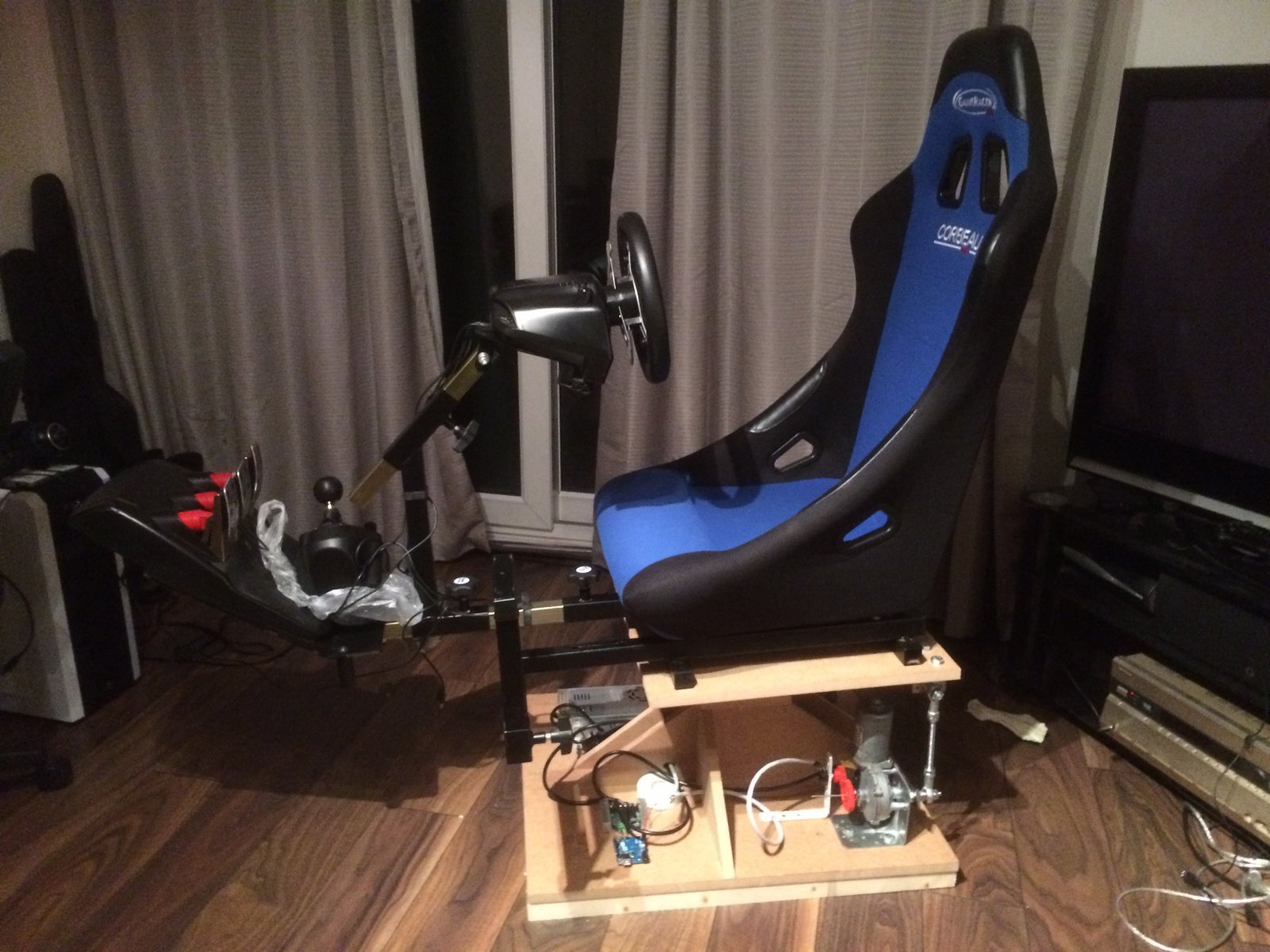

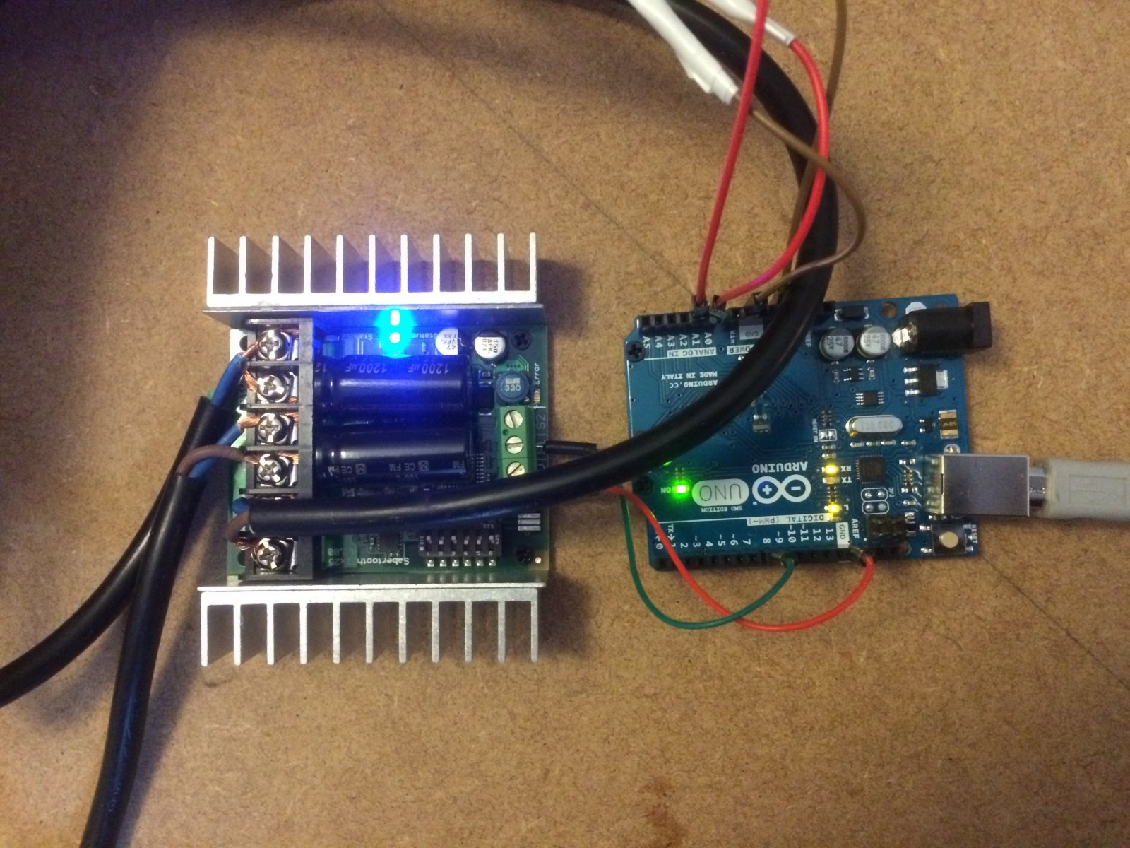

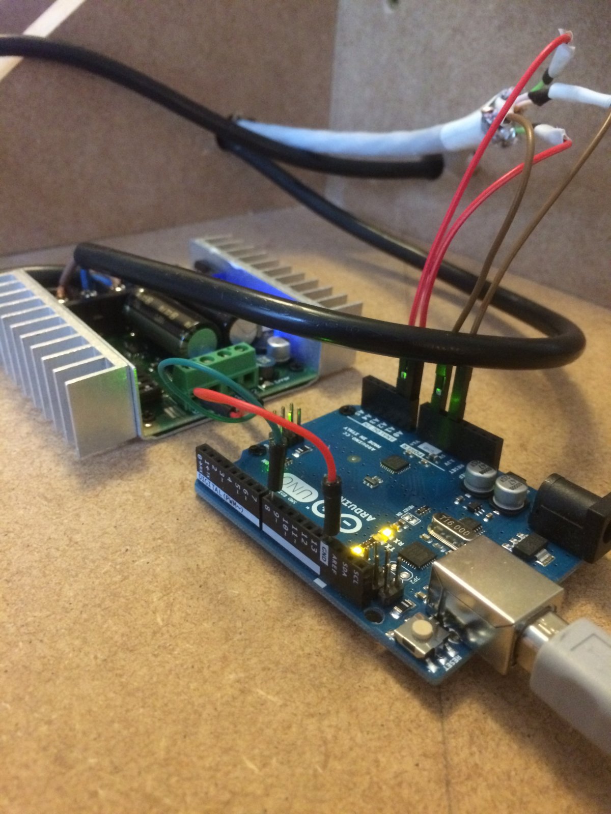

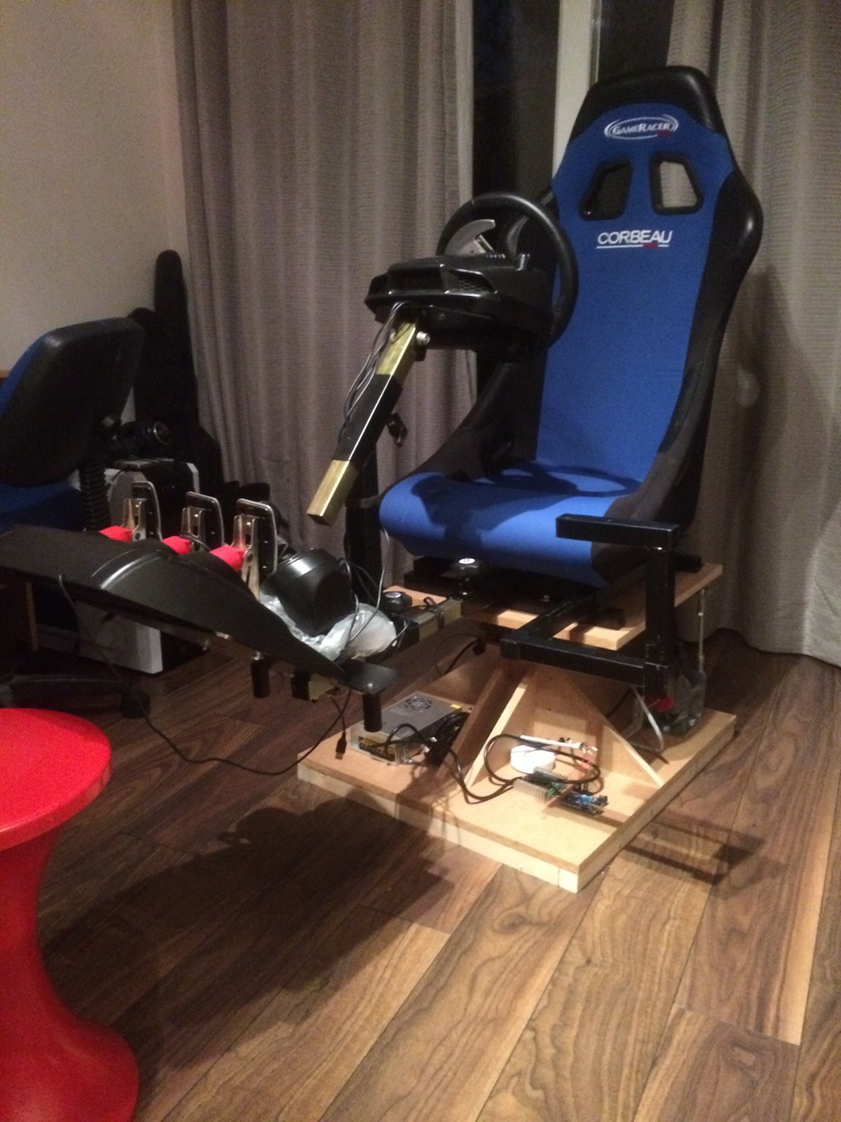

    Today I finished the build part of the rig. Was a lot easier than I was expecting. The soldering all seemed very straight forward, and well laid out in the tutorial by @Wanegain.
    I had to make some dimension adjustments to allow for the Centre of Gravity of the full-frame cockpit.
    I can already see areas I would like to improve on the next version. I'd like to re-bracket the motors at an angle to lower the height of the rig. Maybe reduce the size of the base itself.
    I'm sure there will be lots of teething problems, I'm not under any illusions, I know all kinds of issues will crop up.
    Tomorrow I will take my first step with Arduino, and then Simtools. Fingers crossed!
