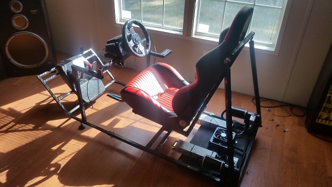

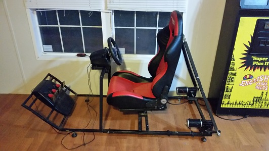

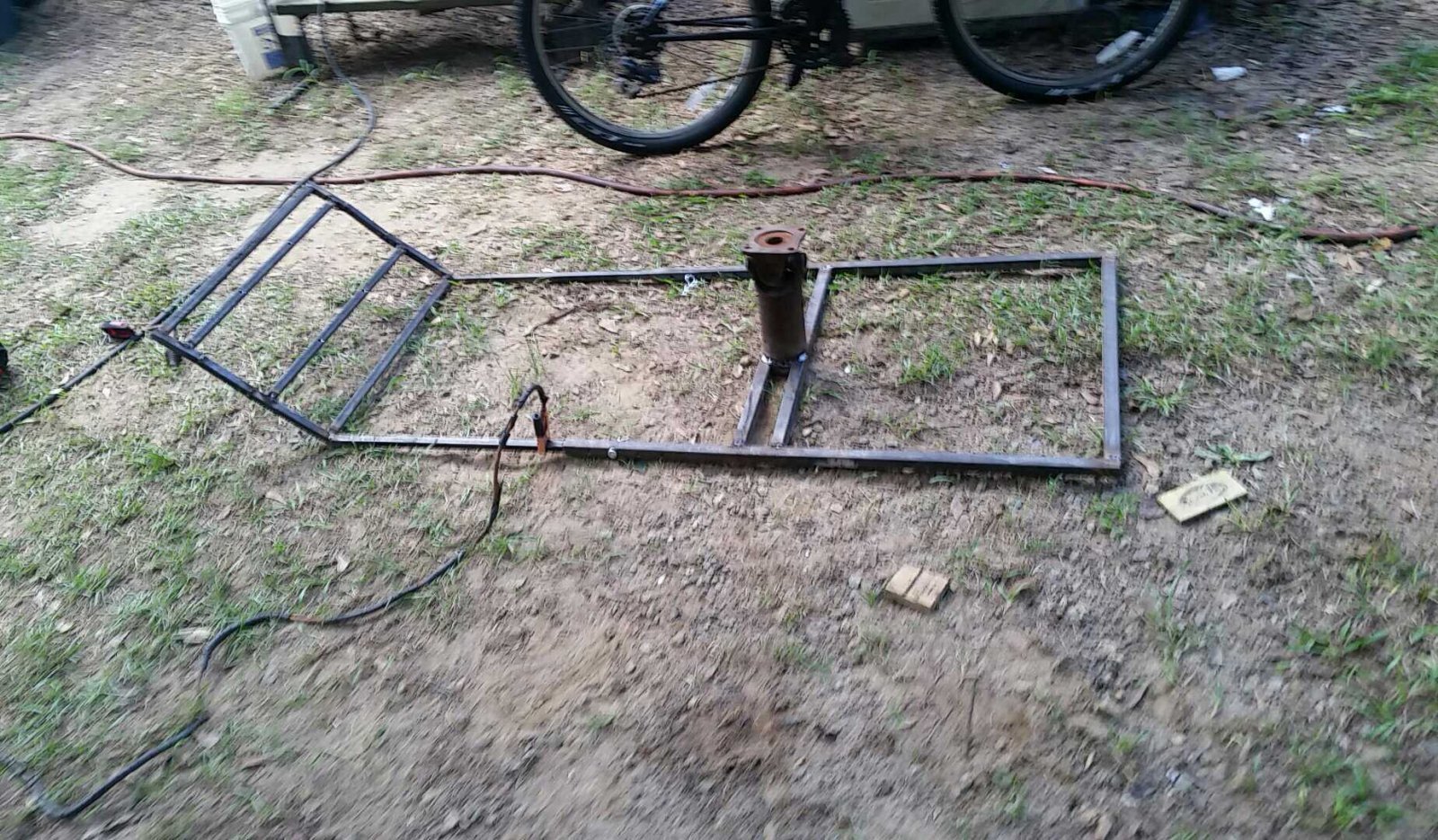

    Started on the frame, mig crapped out on me, had to bring out the arc weilder. Hadn't done any real weilding since high school. I'm 41 now,lol. So this may get ugly. 1474480716904.jpg

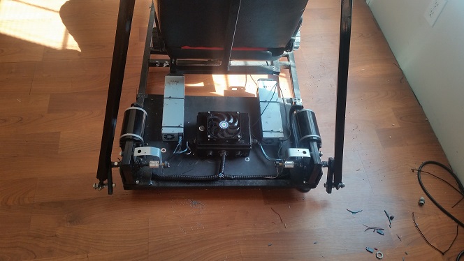

    20161010_192851.jpg 20161010_192900.jpg 20161010_192919.jpg When I installed the seat . I was way too high. I cut the u-joint shaft down to about 8". I took measurements off my pvc rig as I liked the way it sits. Installed motor brackets and arms. I'm thinking I going to redo the arms had to cut in half and reweild due to my seat being so high. They are not bent, just not perfectly straight from the heat from the wielder and being on the ground didn't help either. The arms bottom out about the 4:30 position on a clock is this ok? What I mean by bottom out is that the square tubing hits the lever and stops. Also I going to have to redo the steering wheel square tubing, its to hard to get in and out of it.

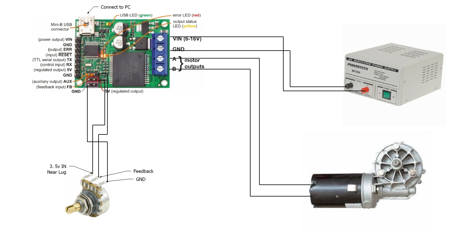

    Got my jrk controllers in . have a question. Do I need to connect both pins on the jrk to the 5v ,and the ground and just one side that says feedback? jrk wiring.jpg
  5. Raymann
    Raymann New Member
    Jun 20, 2016
    24
    278Coins
    +23 / 0 / -0
    Just 1 Pin
    I think 1 pin of 5v and ground and Feedback are for Potentiometer 1, and the others for Potentiometer 2
    21,494
    150,584Coins
    +11,017 / 55 / -2
    No, personally I just use the 3 pins closest to the main chip.

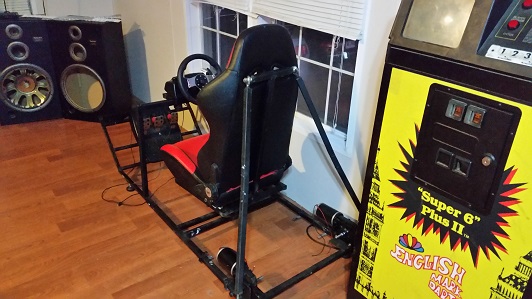

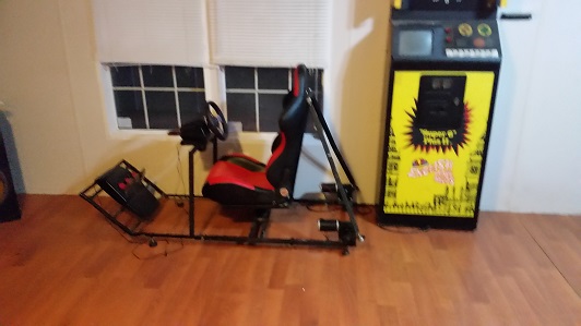

    Redid steering column so I could get in and out. Redid tie rods so they were straight. Added bracket for shifter . Hooked up jrks and pots. Cleaned up some of the wires .

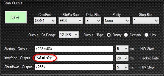

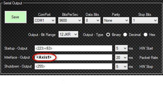

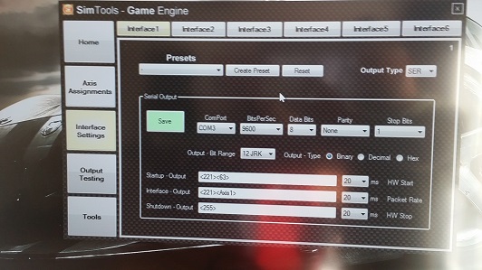

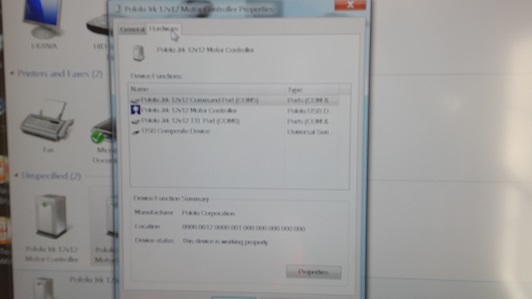

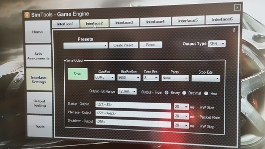

    Got my PC in. Centered the pots. Read the quick start and the full simtools manual. Getting no movement when I go to the output teasting. Jrk"s are lit up green and yellow. Change coms from 3 to 4 and 5 to 6 , still a no go. Anybody see anything wrong? Pics of screens below. Sorry if grainy took with my phone. Manual said Microsoft Dot Net 4.0 is mandatory, I have Microsoft Dot Net 4.6.1 will that cause a problem?
    20161122_103808.jpg 20161122_103840.jpg 20161122_103858.jpg 20161122_104012.jpg 20161122_104050.jpg
  13. Blame73
    Blame73 Well-Known Member
    Nov 6, 2014
    1,215
    8,300Coins
    +1,127 / 2 / -0
    I see com ports 3 and 4, but you used 3 and 5
  14. Blame73
    Nov 6, 2014
    1,215
    8,300Coins
    +1,127 / 2 / -0
    did you set JRK utility?
    Once you've done that you can then set Simtools, but first use the jrk utility to set max and min axis usage and PID.
    EDIT: if you've already done that, post jrk utility pics

    ok , i got it. Did't see that anywhere . Actually did a search for anything like that and didn't see anything. I just set the pots at center,didn't actually set them up. Thanks again Blame73 and noorbeast (the king or queen, which ever the case may be, of links:thumbs)

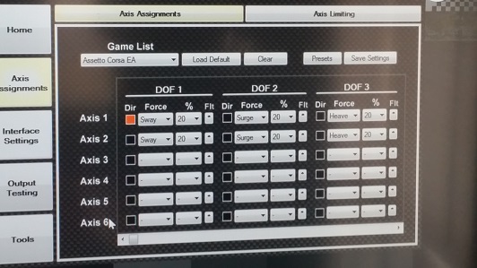

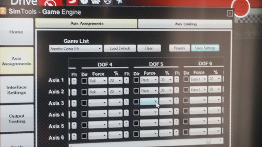

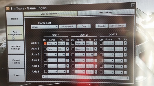

    Got back from a mini-vacation, started to tune simtools. Only reading sway and surge from output testing on tuning center. Thinking i need to invert some of the settings? Or it maybe something completely different. Read the FAQs many times, may be getting thing confused with oneanother ,set all forces to 20% , nothing except sway and surge. 20161207_125454.jpg 20161207_125556.jpg
