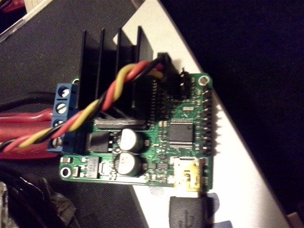

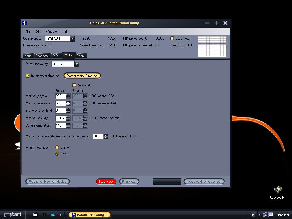

    Thanks mate, I have read through that manual and found that part.
    You are correct, I am using the 600PBS power supplies. I have changed the psu over to see if that makes a difference. No luck. I can't see any evidence of any short anywhere on the controller. No stray strands either.
    I have also cleared all the settings from that jrk multiple times. Unfortunately that did not fix it.
    I have set up the first jrk without any problems and then went on to do the second one.

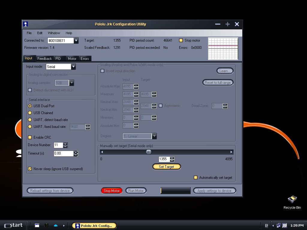

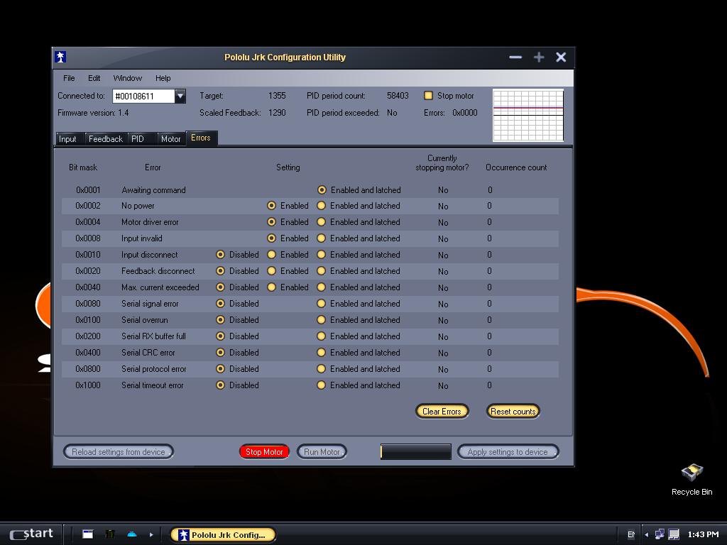

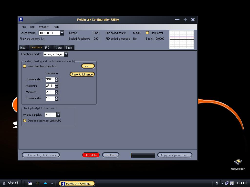

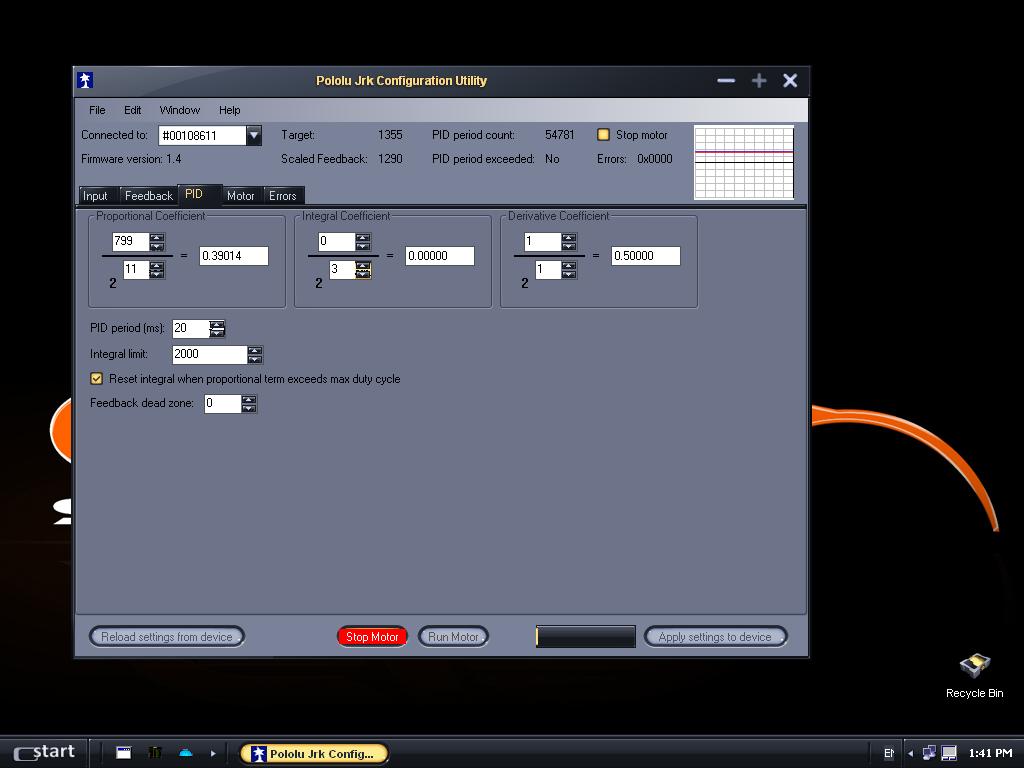

    I'm not sure if it will help you but here are the settings I put into the controller:
    Maybe I need to get this one jrk replaced...
    21,669
    151,668Coins
    +11,045 / 56 / -2
    I have had one JRK DOA, so it can happen. Pololu will want you to trouble shoot first anyhow.
    I am hoping that there is no chance you crossed the power and earth wire for the pots.
    Can you post a picture of the problem JRK and how it is wired up. Are the wires to the pots on the pins closest to the large chip?
    A bit of a stretch but have you tried a different USB cable for the problem JRK?
    Just some setting stuff to try. You can increase the integral limit to 10000, Max Current to 0 (unlimited), Current Calibration 130.

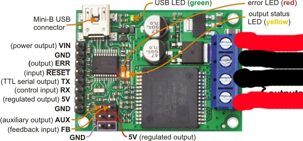

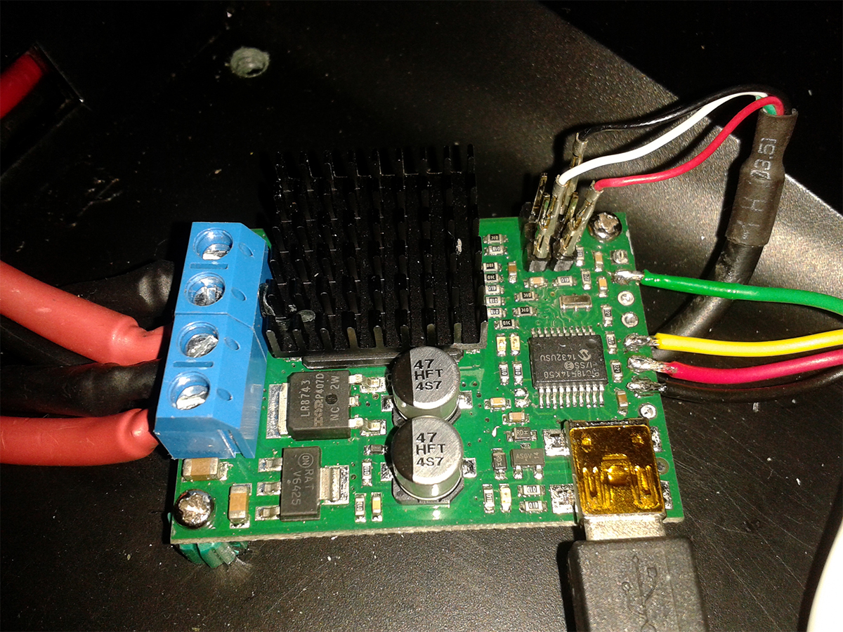

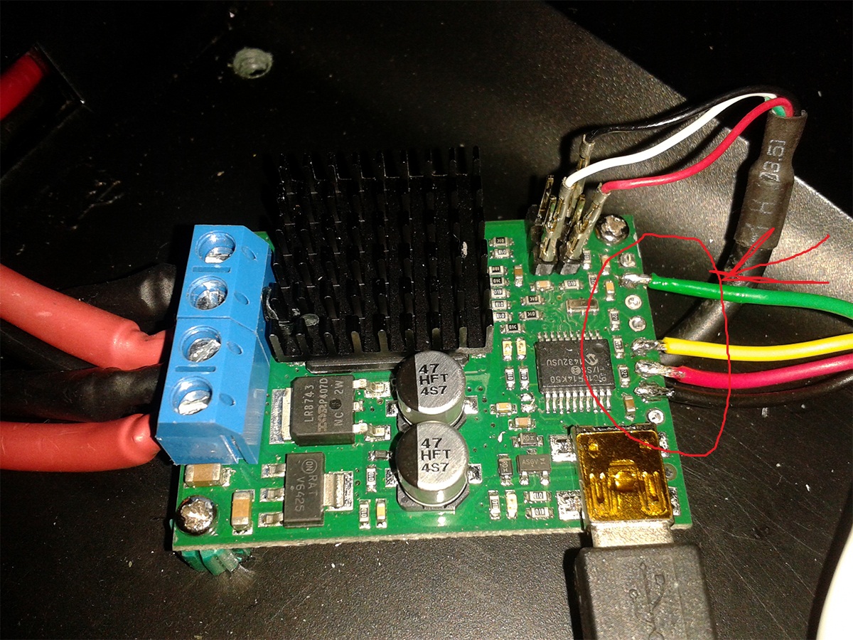

    @noorbeast - This is how it is wired. The wires for the Pots are: AUX (Red) on 1, FB (White) on 2 and GND (black) on 3. This is the pot http://au.rs-online.com/web/p/potentiometers/1642661/
    Again, even without pot and motor connected, the issue remains. I have also tried a different usb cable.
    @Archie - worth a shot too. I will look at doing that.

    Just FYI:
    The AUX line is an output that is generally high whenever the jrk has power. The line will only go low for two reasons:
    1. If the jrk’s microcontroller goes to sleep (because there is no VIN supply and the device has entered USB suspend mode), the pin is tri-stated and pulled low through a resistor.
    2. If the Detect disconnect with AUX option is enabled for either the feedback or the input, then the jrk will drive AUX low for about 150 μs each PID period to check if the feedback and/or analog inputs are disconnected
    So with the AUX you can check, if a pot is connected or not.
    Selecting the Detect disconnect with AUX option activates an extra feature that allows the jrk to detect if the FB pin becomes disconnected from the analog voltage input device or shorted to 5 V. This option is intended for use in analog voltage feedback mode with a potentiometer connected between AUX and ground. When the option is selected, the jrk will periodically drive the AUX pin low, verifying that this results in a 0 V signal at FB. If the line does not respond as expected the Feedback disconnect error will occur.
  9. bsft
    Just a question and I may have missed it?
    Why do you have extra wires soldered on? like I have circled?
    The green, black, yellow, and red?
    I can see the alligator clip wires would be for the pot

    I used the AUX pin because that's what was recommended in the Jrk manual I believe. I have also tried it connecting to the +5V instead.
    The soldered on wires are for a status LED's and a reset switch on the dash board. Just like @Archie has done here - http://www.xsimulator.net/community/threads/jrk-reset-switch.6642/
    I have contacted pololu about the problem and am now waiting to hear back.
    21,669
    151,668Coins
    +11,045 / 56 / -2
    Fingers crossed Pololu will come up with a resolution.
    My biggest concern is unshielded terminals for the pot, as there is a real risk of some movement and a short. A 3 pin terminal block from radio controlled gear is a much better and neater option.

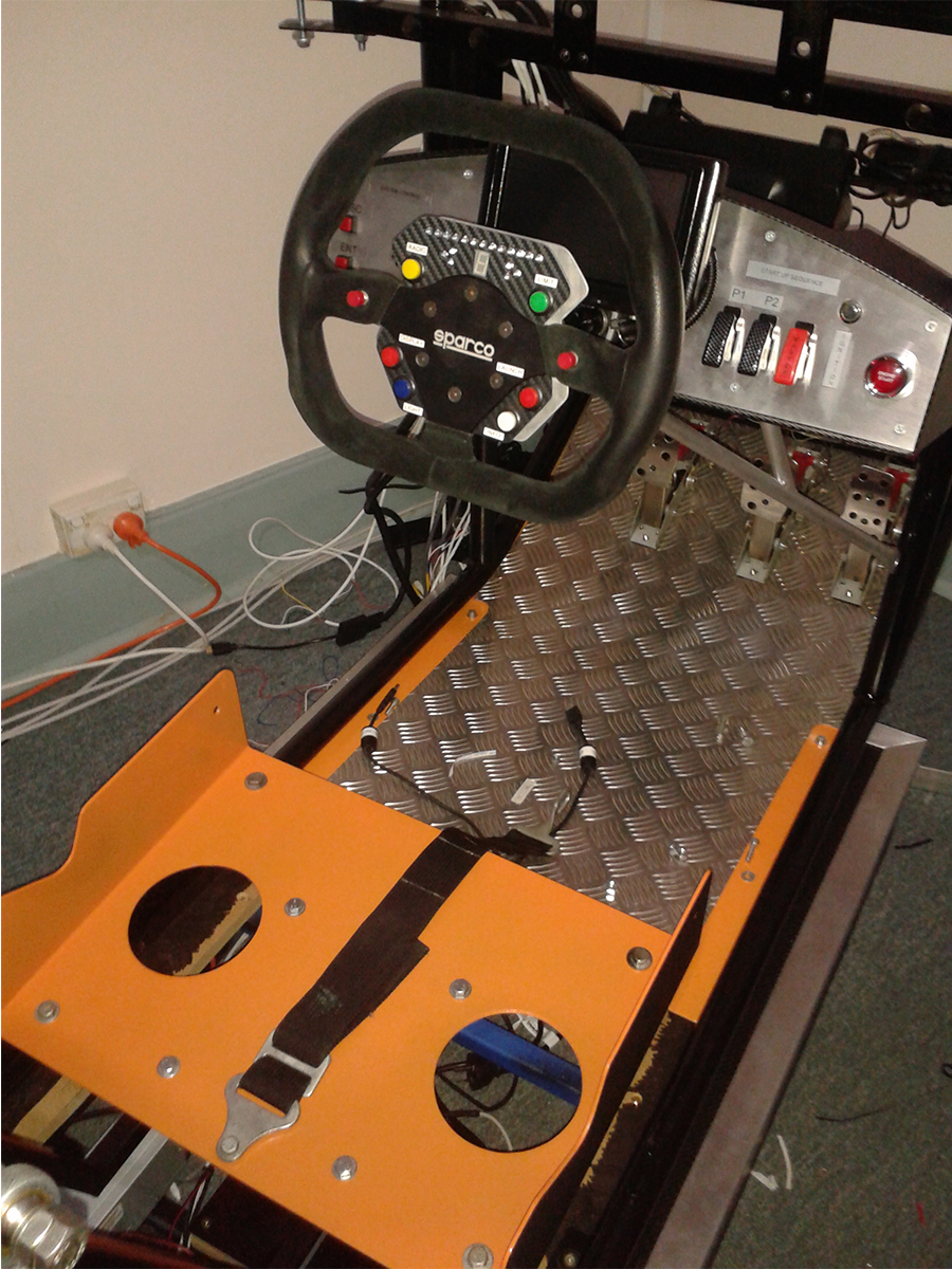

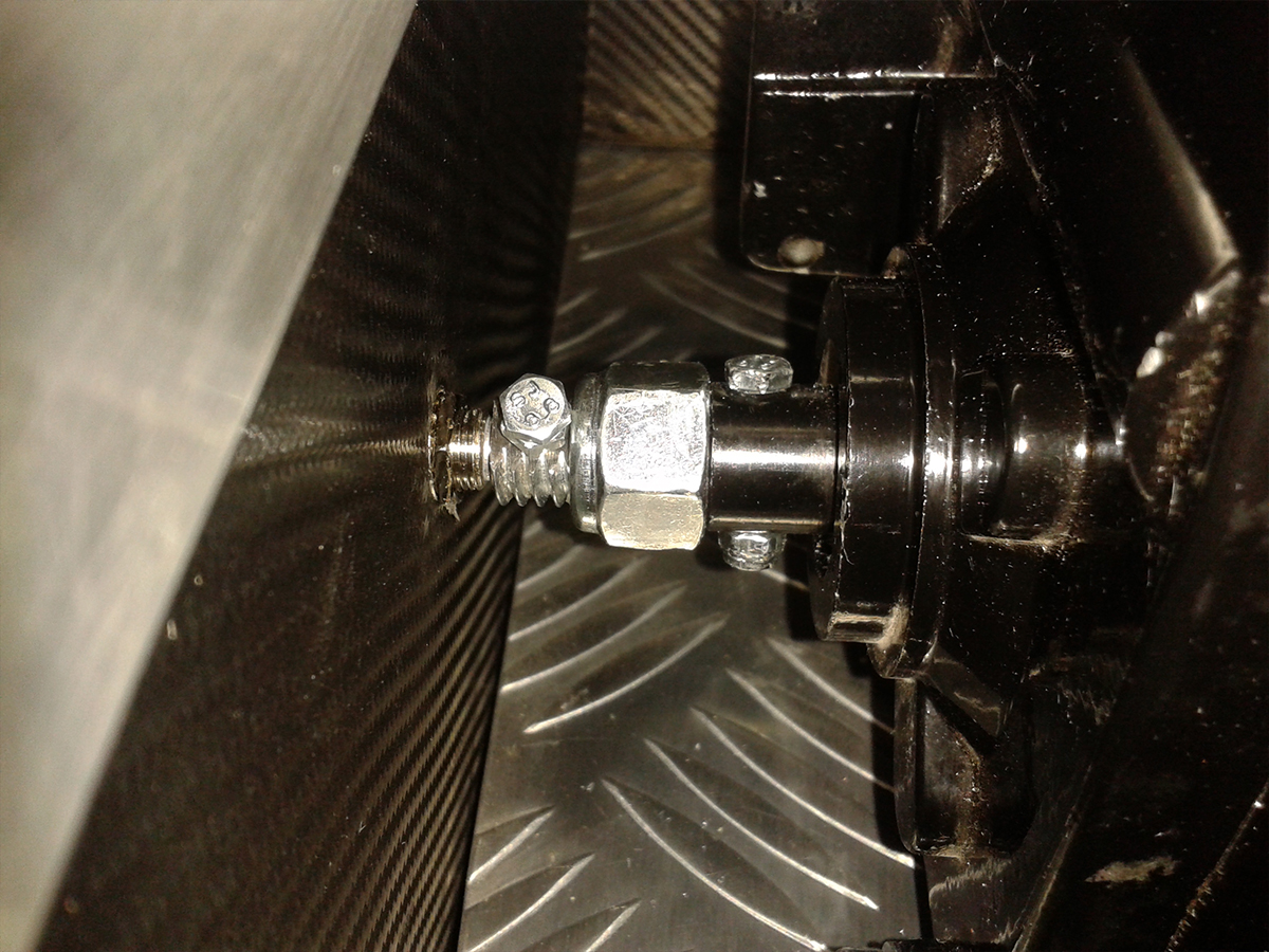

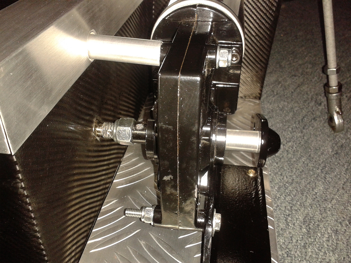

    I started putting things back together.
    This is how the motors ended up getting mounted. I welded the lever directly to the axle. Safes having to rely on nuts holding things together. I know it's more work if I have to replace parts as I have to make them again, but I think it's worth it.
    The potentiometer is mounted directly to the end of the axle. Where the shaft of the pot goes into the axle it is held in place with a grub screw.

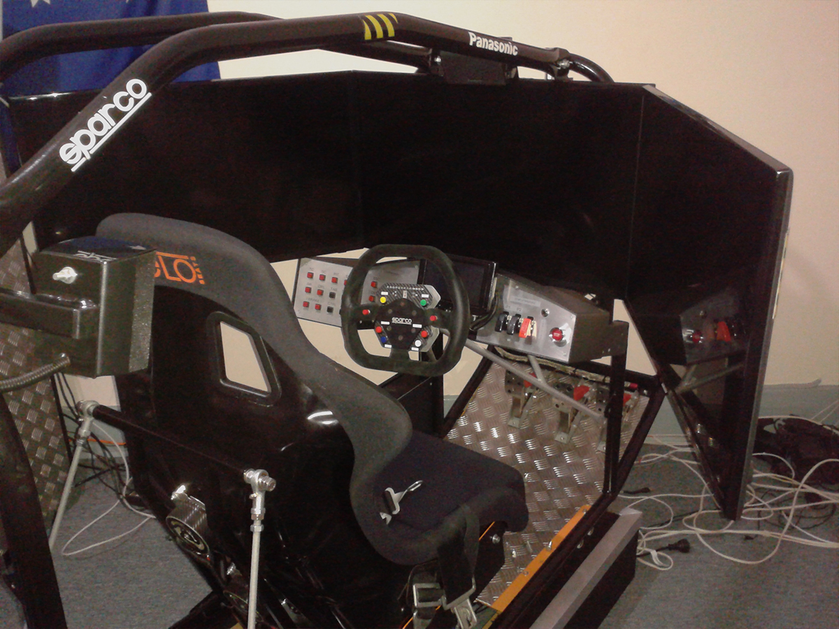

    While I had everything apart, I changed the Screen positions slightly. So I thought I better go for a monitor test fit...
    It ended up exactly as planned!:D
