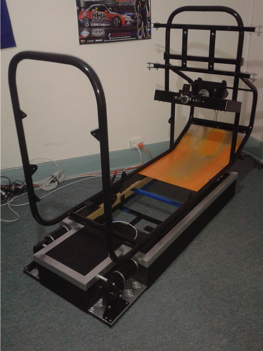

    I finally got around to uploading some pics. Progress is slow because I spent a LOT of time nutting things out...
    But I manage to actually build a bit here and there.
    So,.......:

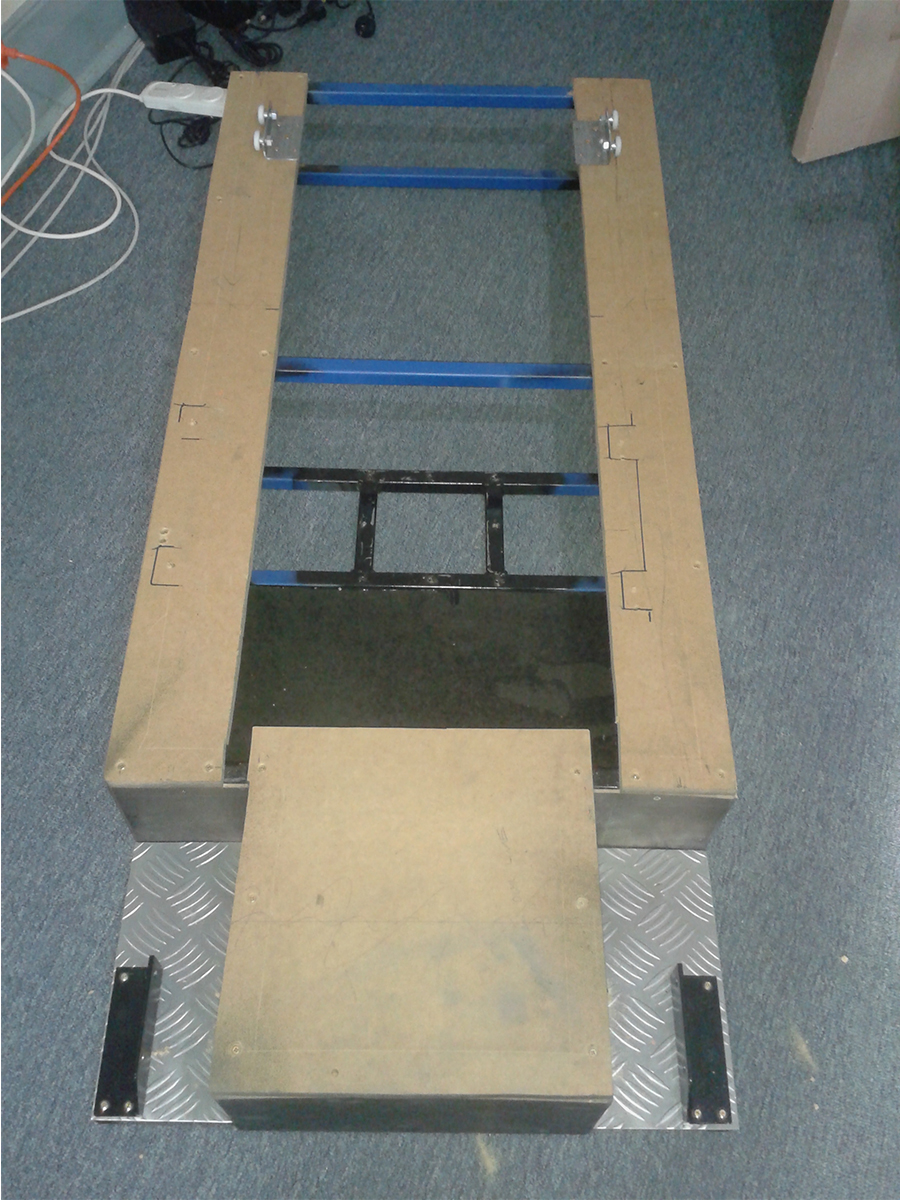

    Base Frame 1.jpg Base Frame with MDF fixed to it. The rollers at the front are for the main frame to sit on so I can adjust it.

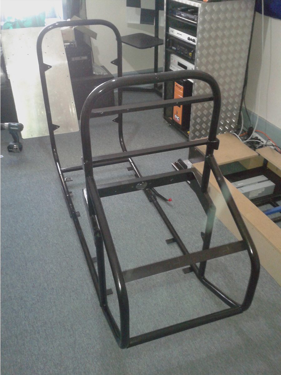

    Main Frame.jpg This is the main frame I was already using. I had to modify this slightly.
    Some time later......
    Base and Main.jpg Main Frame and Base Frame meet.Plus a few other bits attached. The whole top frame can slide forwards and backwards a little bit so one can adjust the "seat".

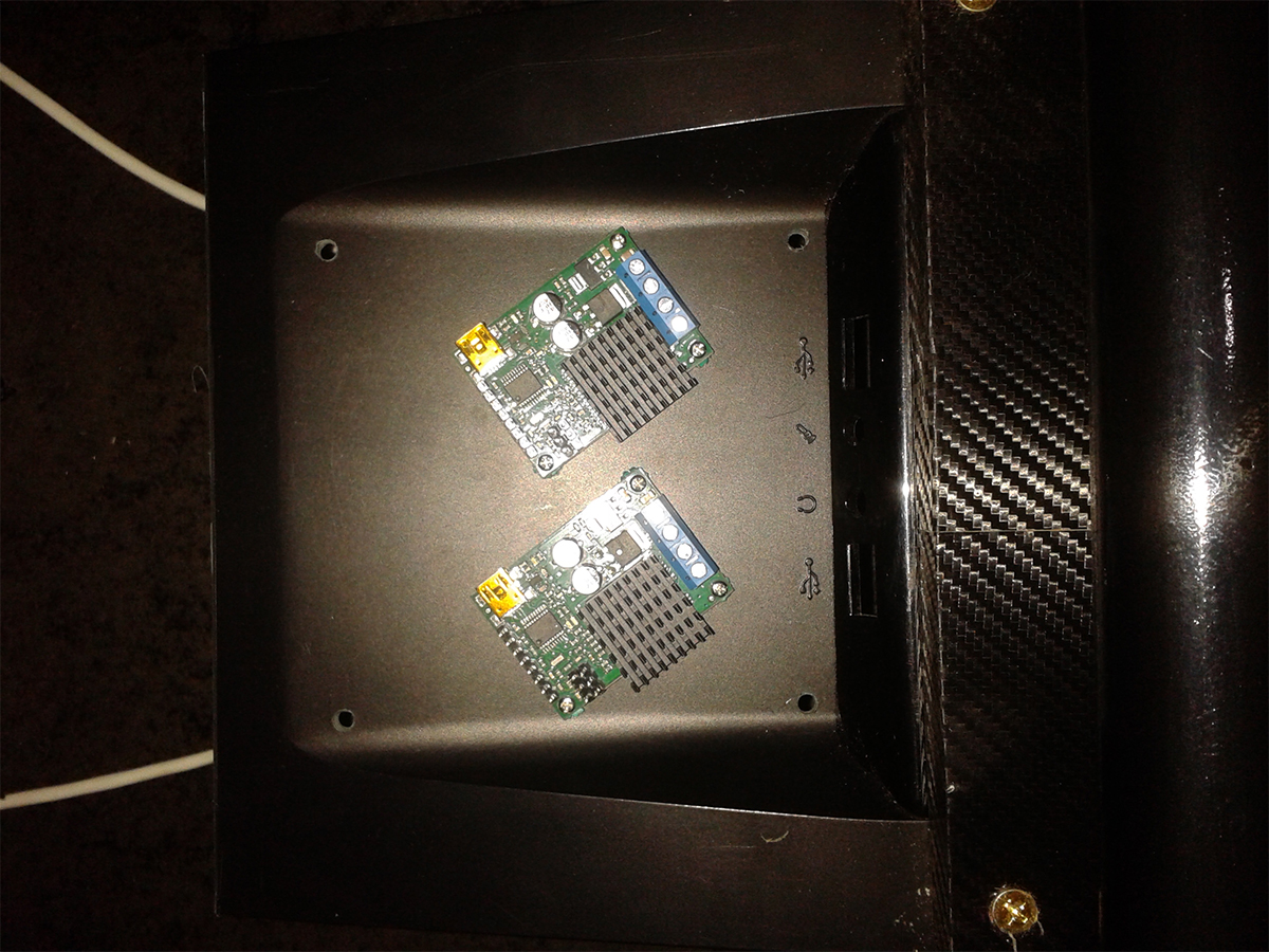

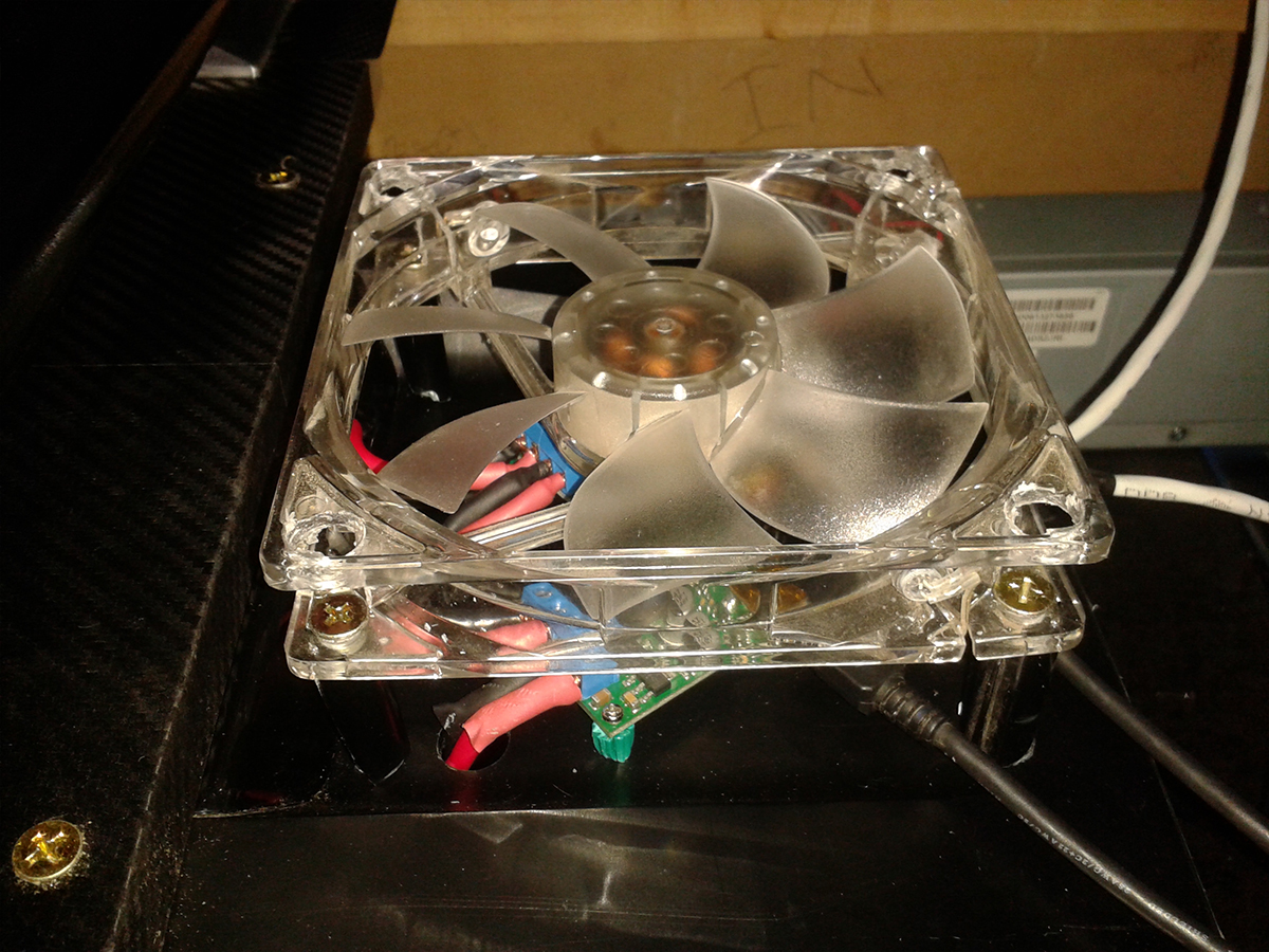

    The JRK's are mounted. Courtesy of an old PC case. I hacked up the plastic housing and fixed it to the base frame.
    The plastics are the perfect size to even stick a 100mm fan on top to keep things running cool.
