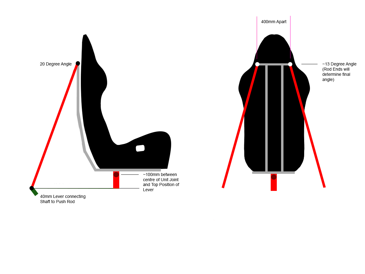

    Ok, I took the seat off my sim and started by finding the balance point. Once I had that, I put the seat temporarily on top of the uni joint. And by temporary I mean just sit it there :D I wanted to find out what sort of motion range I am to expect so I can build the frame accordingly.
    What I found is that the motion range at the uni joint is less than I thought it would be. So that's cool.
    Am I correct in thinking that the motion for accelerating/braking especially is actually quite little? Otherwise the legs will get too short to reach the pedals very quickly.:confused:

    Depends on your build @GIB SimRacing - It all depends on the levers you choose for your particular setup.
    I might be wrong, but I doubt you would achieve a throw back (surge) with such a degree of motion to make you unable to reach the pedals.
    Maybe post some pics of your thinking? :)
    I am sure you know this, but make sure you are in the seat when finding COG, and load up everything that will move with the sim, otherwise you will over work your motors.

    Different people have different preference in the amount to movement they run, you can get a bit better idea by watching videos of different builds. But because a seat shaker gives more torso motion ques than a full frame it really does not take much pitch to feel the breaking and acceleration at your wrists and ankles.

    @GIB SimRacing , can we see pictures on your intended design?
    and from another thread, 25:1 you may be able to move slightly under 12v load, but its not an issue. Once the motors are going its no problem. If not confident, use 60:1 boxes then.
    As for surge back enough to pull your feet off, not likely, unless you have 6" long levers, of which I DO NOT suggest.
    Best was I found was I sat the seat where I was comfortable , with my legs not too stretched. If yo have ever sat in a real race car, its slightly cramped because it needs to be to keep you on the pedals and wheel. Think that way with your build.
    Dave.

    Here is what I intend to do.
    The priority is to get the motion working correctly. Everything else I will build to suit.
    So for the motion part of it, I was thinking of making it like this:
    @bsft - Are you after any other info?
    If that will work, I will then build the rest of my sim around that.
    I am still unsure of the final design as such. Because I want to re-use as much as possible of my current setup, I keep looking at it and trying to come up with various different things.
    I get a bit picky when it come to the way this thing will look.
    I hope that gives you guys some idea as to what I'm up to.
    PS: Sorry for the simple picture. I tried using Sketchup but that program is driving me crazy!

    Yep thats fine, even pecil and paper scanned would have done the job.
    Now go forth and build my friend

    @bsft - Sweet, cheers. I am glad that this idea will work. Building will only start on the weekend. Unfortunately I won't have the time before.:(
