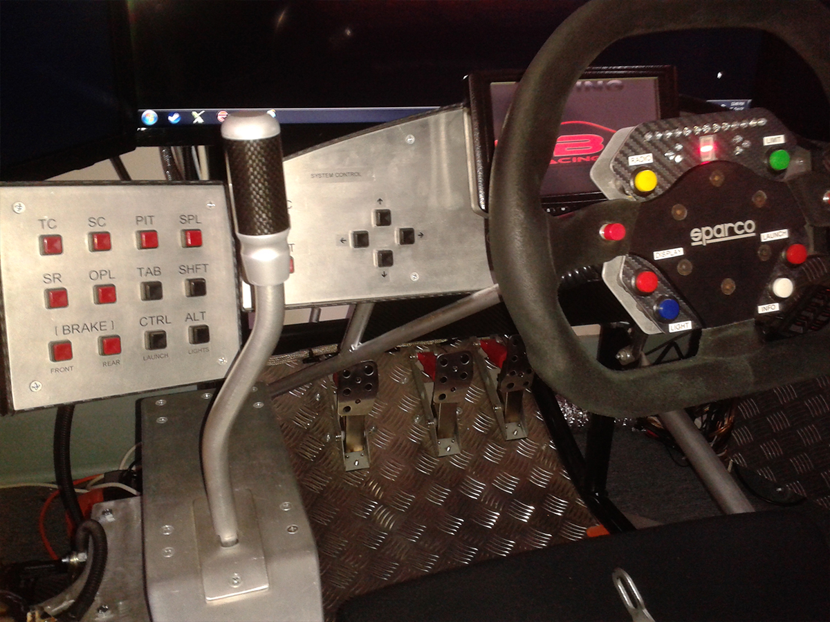

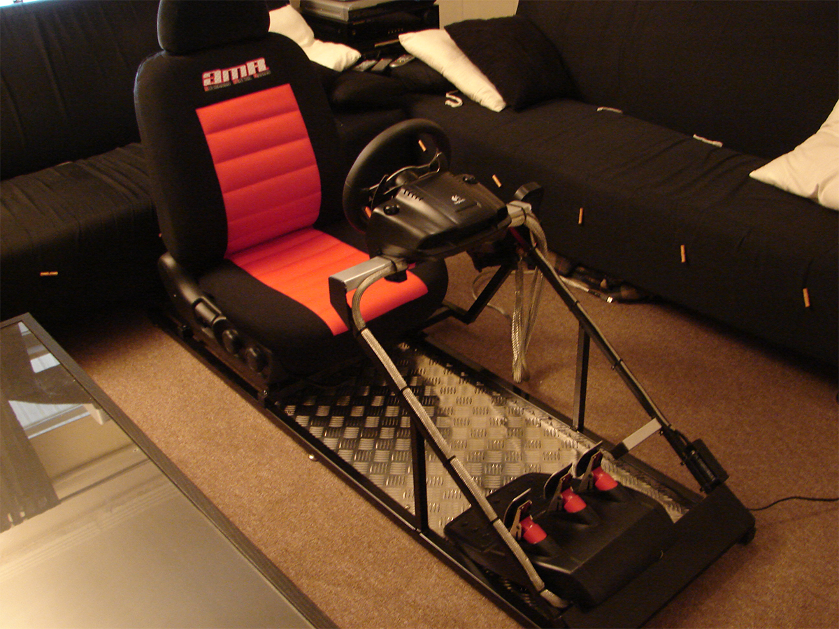

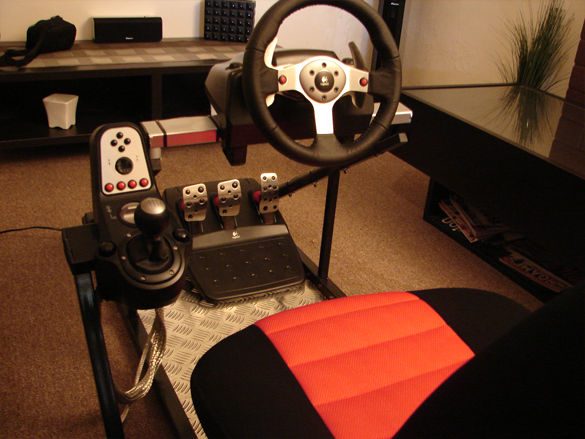

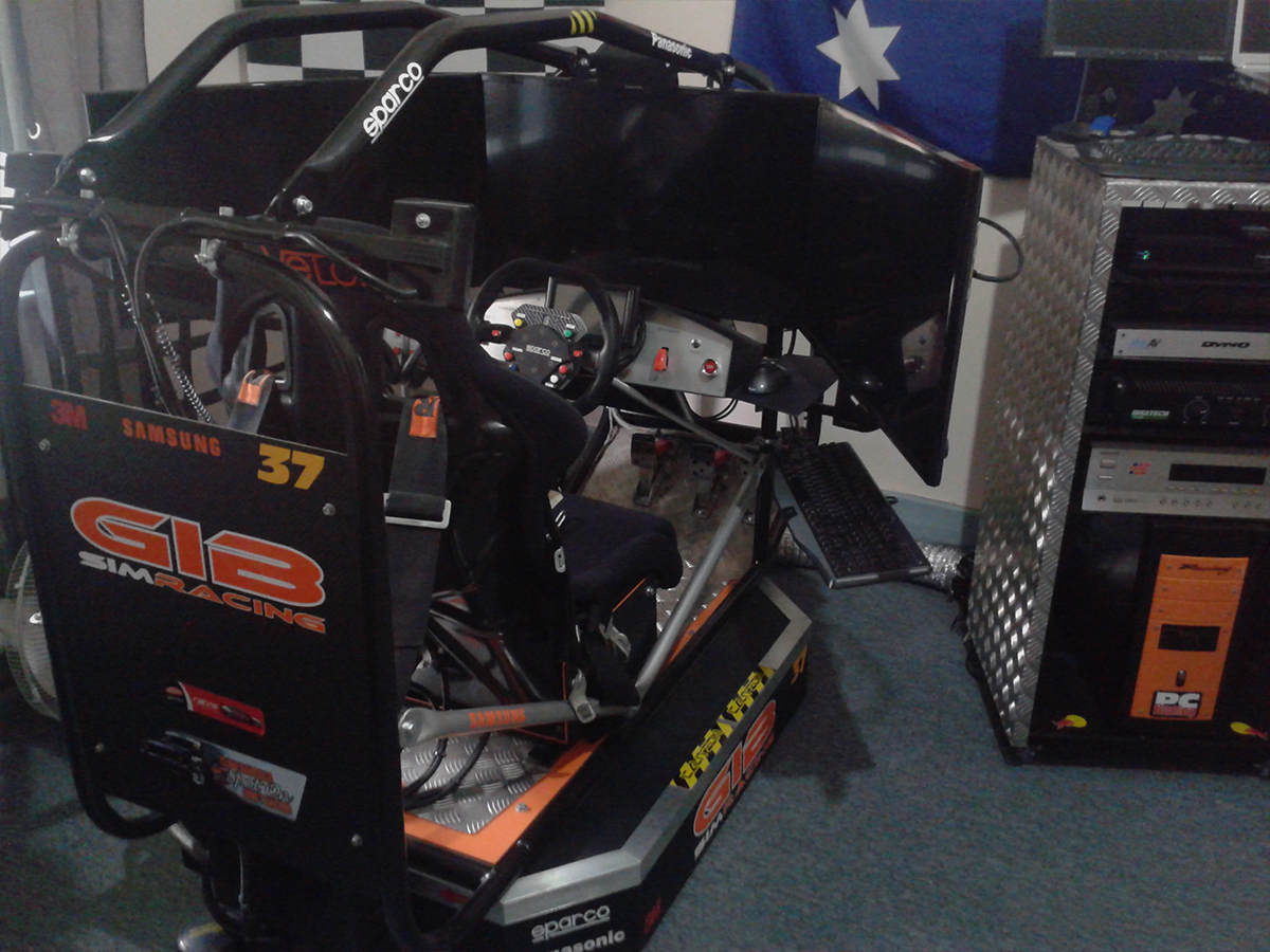

    Here is my first attempt:
    And this is what I'm currently using. But this one has had a few upgrades along the way.

    great job, better than my builds
    22,039
    153,830Coins
    +11,151 / 57 / -2
    There is lots to like on your current sim but the roll cage screen braces are just awesome!

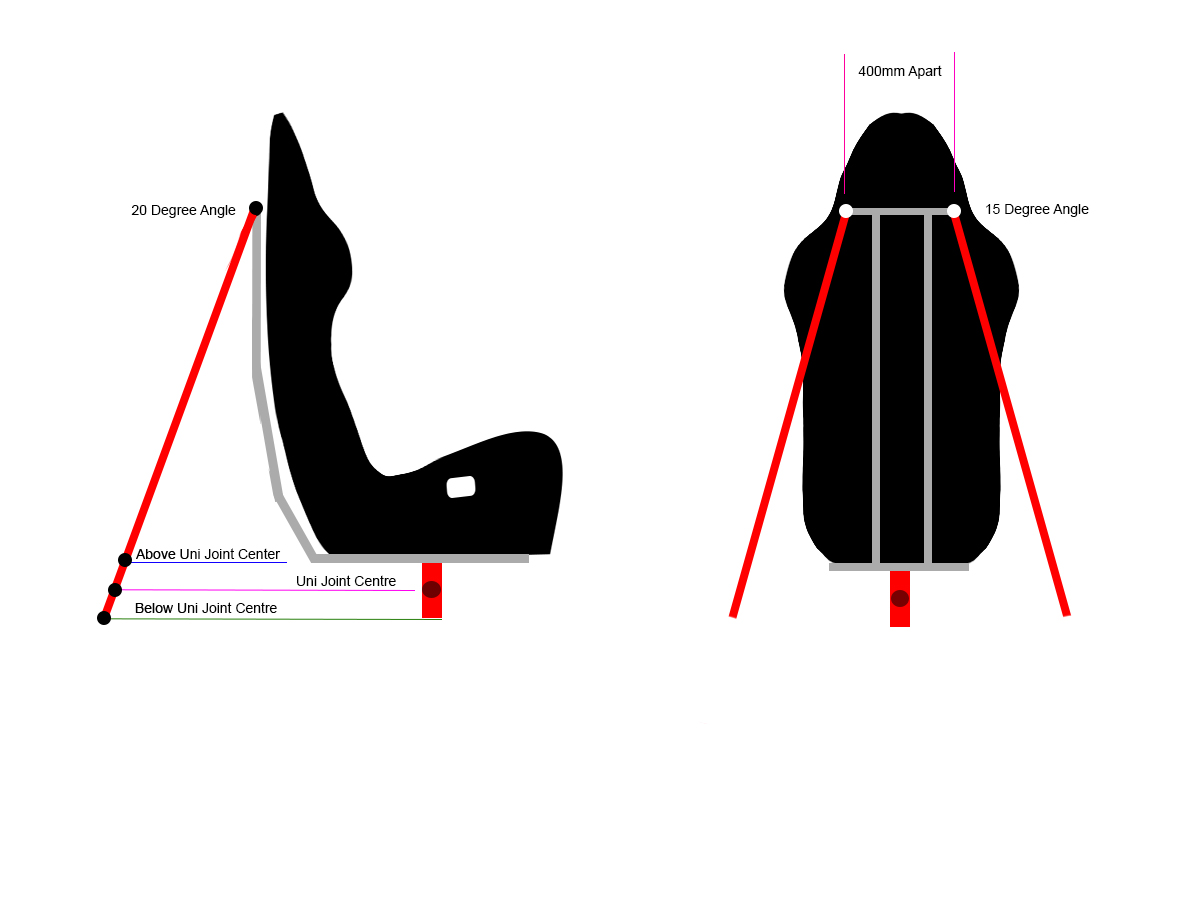

    Ok, I will have to go with the 25:1 gearboxes for the motors. This means a shoulder mount setup for me.
    I have quickly made this sketch to show you guys what I have planned.
    I do have a question though. I am unsure of what height to connect the motors to the rods. I hope my sketch makes sense.
    Should I attach the motors above, centre or below the uni joint pivot?
    Thanks in advance for any help.
    Also I hope the angles are good as they would fit relatively nicely to my current frame.
  13. noorbeast
    22,039
    153,830Coins
    +11,151 / 57 / -2
    Below and the uni joint should be as close to the seat as possible.

    Thanks @noorbeast . Do you think it would be enough if I was to attach 100mm below the uni joint pivot?
  15. noorbeast
    22,039
    153,830Coins
    +11,151 / 57 / -2
    Yes, as long as that adequately allows for the planned range of movement.
