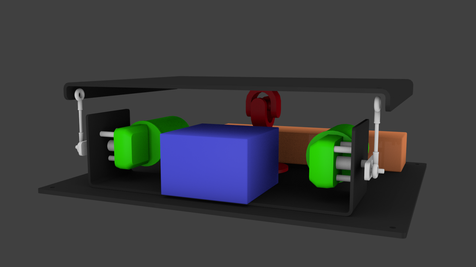

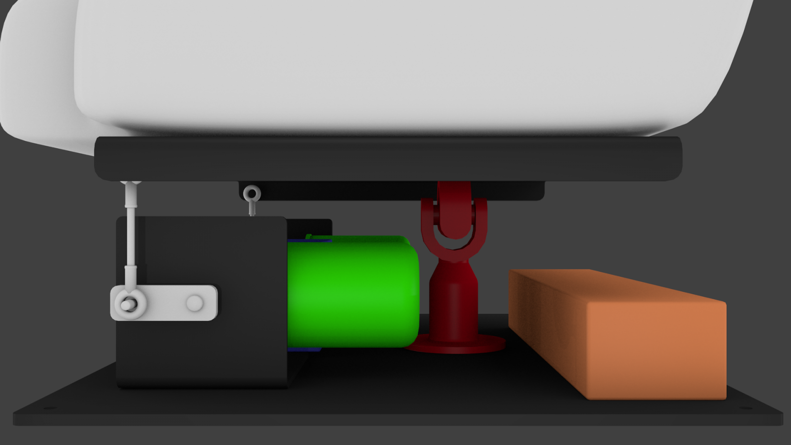

    So, were these 200w motors strong enough for this type of seatmover?
  4. FoxHound.92
    FoxHound.92 2DOF seat mover
    Jan 11, 2018
    73
    52Coins
    +30 / 0 / -0
    Yes, easily.
    I'm 73kg and the power is around 40% max power on peaks. :thumbs
