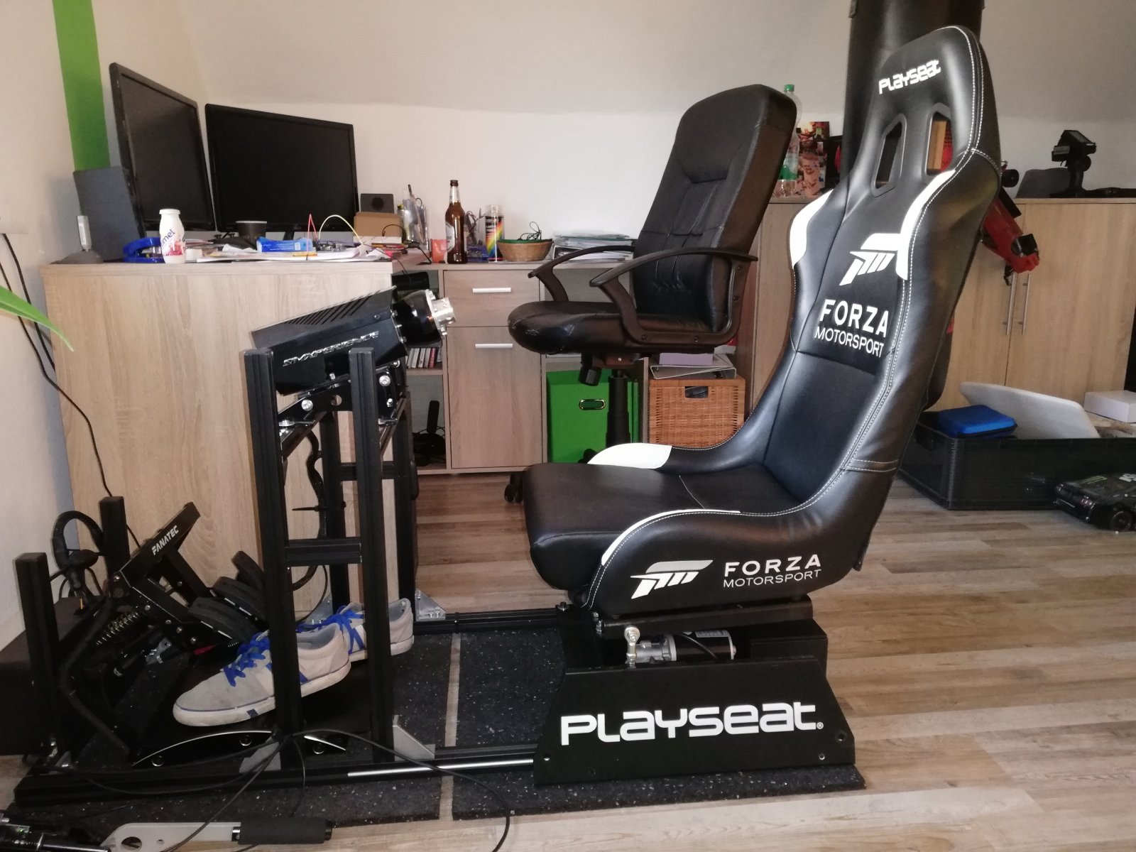

    This is my current setup:
    An originally Playseat-based custom rig with modified G27 shifter, modified G27 pedals, DIY handbrake and my greatest pride and joy: my accuforce v2 with the ADAM LZ Steering Wheel.
    (Don't ask how I got it past her.)

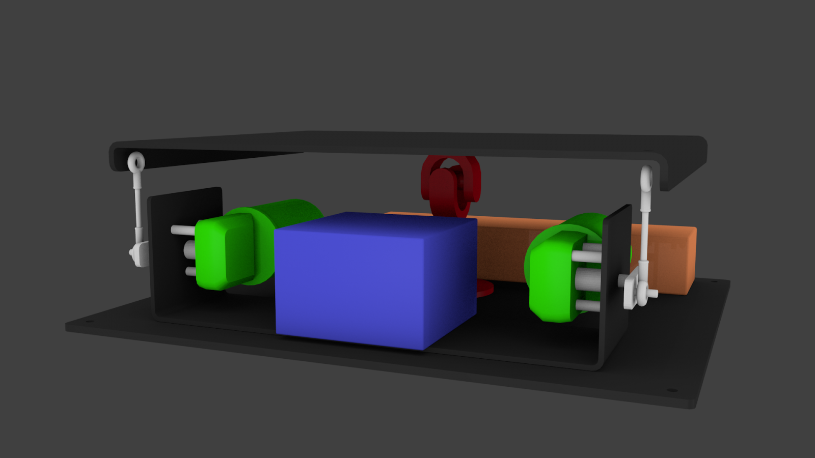

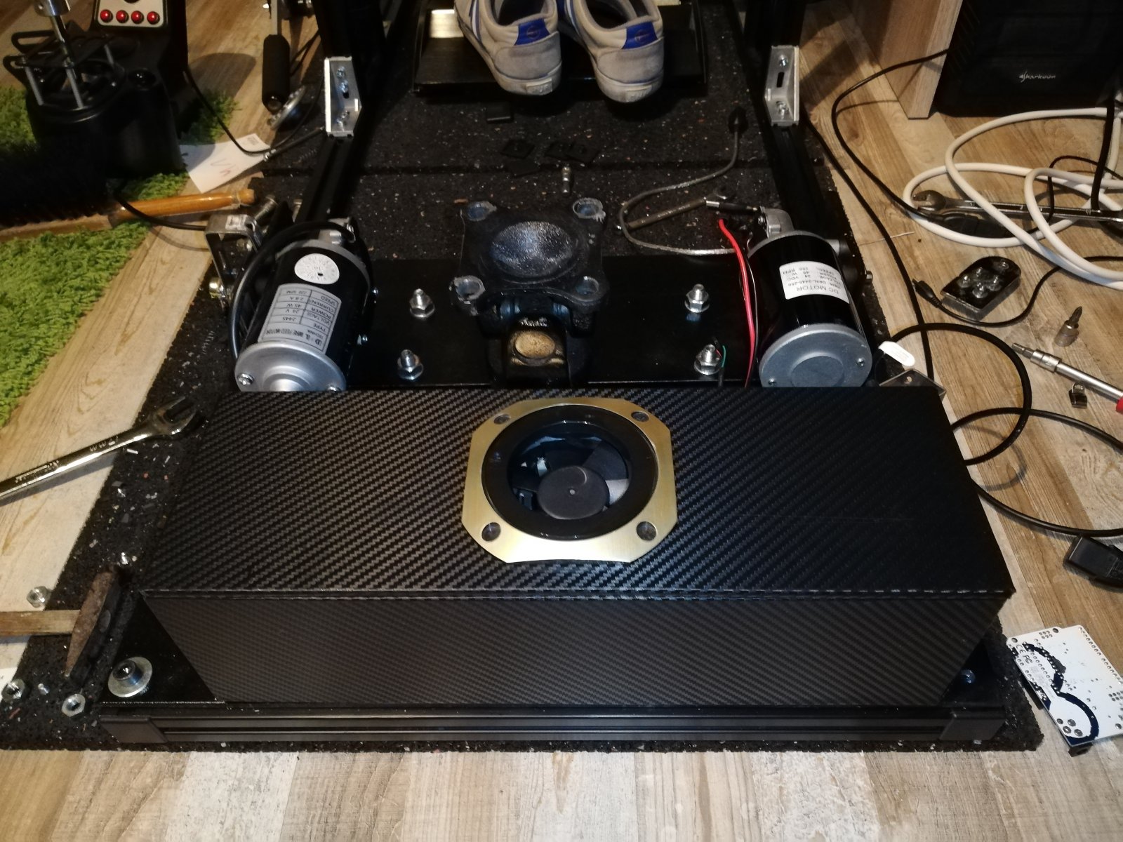

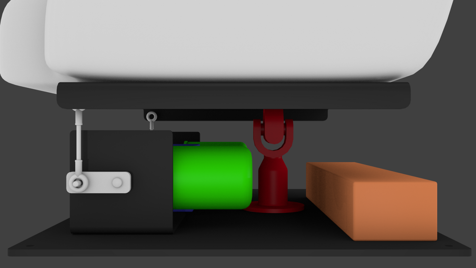

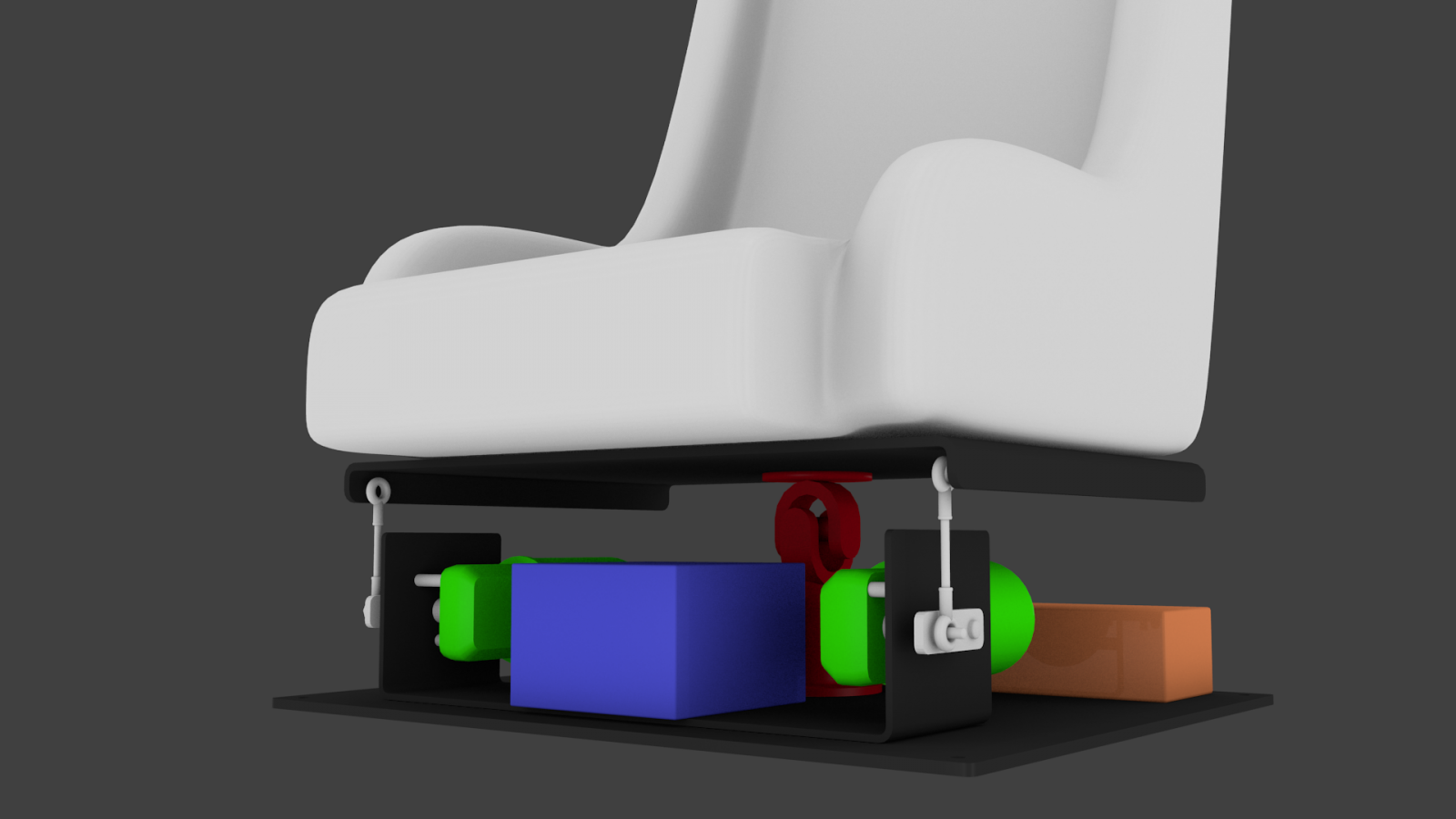

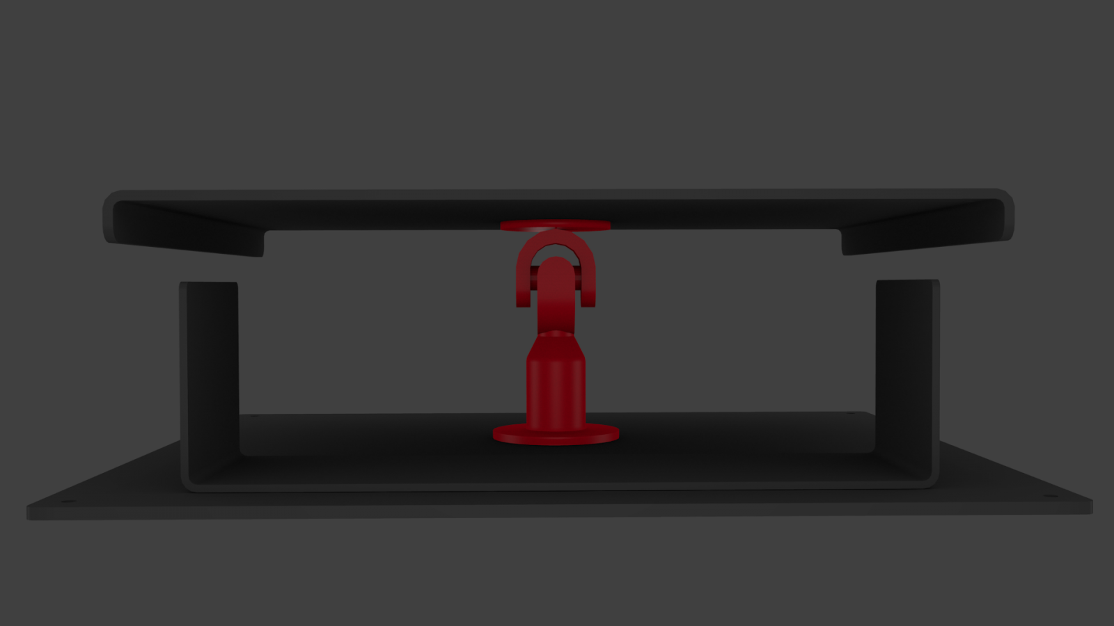

    The basic design is inspired by @pipis2015 's 2DOF compact seat mover
    The base measures 400 x 490 x 50 mm.
    My plan is to put the two motors and the connecting rods in the FRONT of the seat.
    Most seatmovers i have seen have mounted them in the back but the NLR v3 also does mount them in the front. I figure, this will give me a better and more direct feedback - considering in a real car you sit closer to the front suspension then the rear one and any motions "start" from the front.
    Also it would allow me to position the u-joint (red) further back and therefore closer to the actual center of mass.
    Have a look at these two pictures:
    I also blocked out the position of the other components:
    green = motors
    blue = electronic's box (arduino and motomonster with fan)
    orange = power supply
    The connecting rods are sized the same as @pipis2015 's (60mm x 20mm x 5mm).
    I also checked if they could potentially turn 360 degrees and adjusted the placement of the motors.

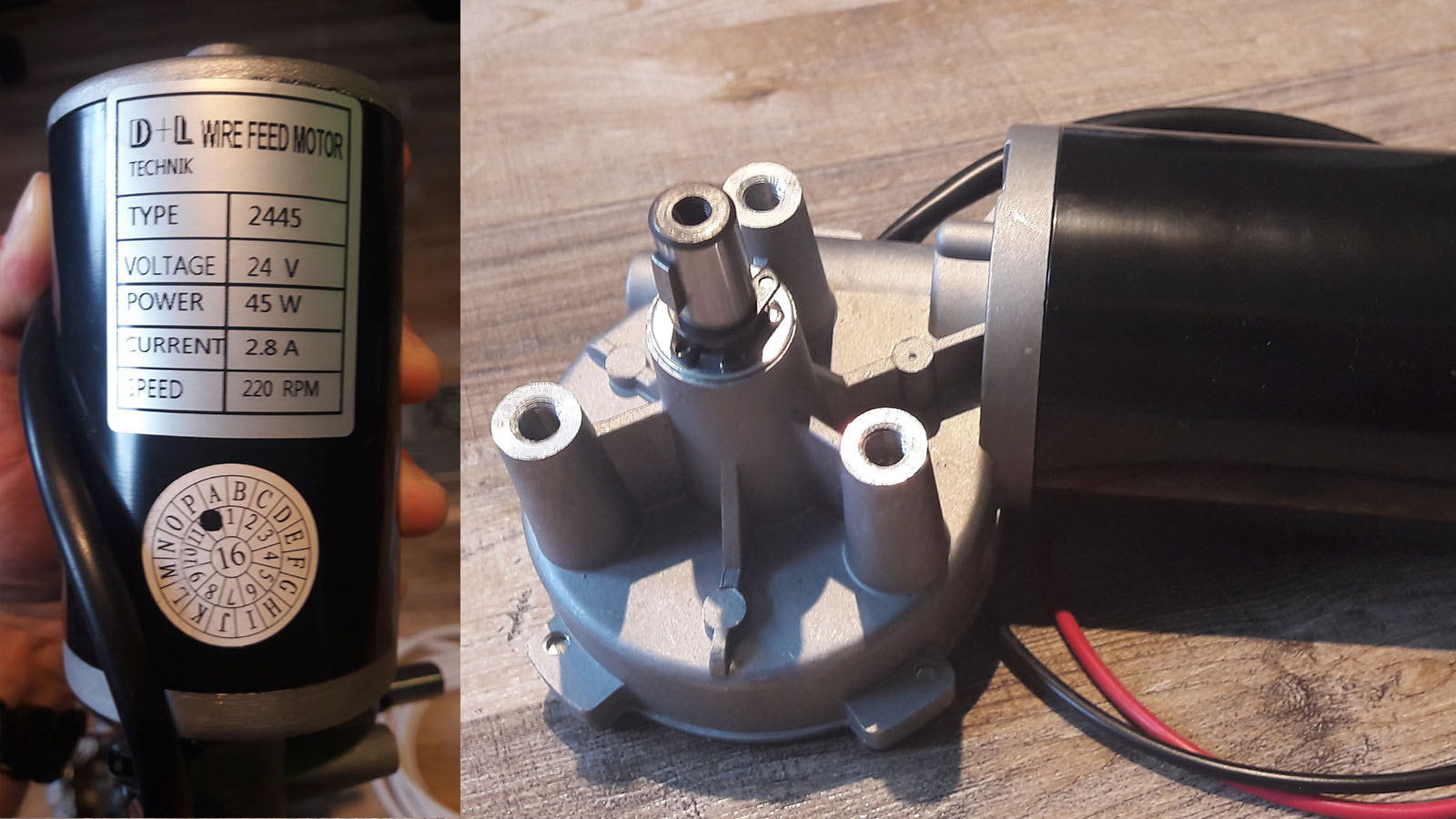

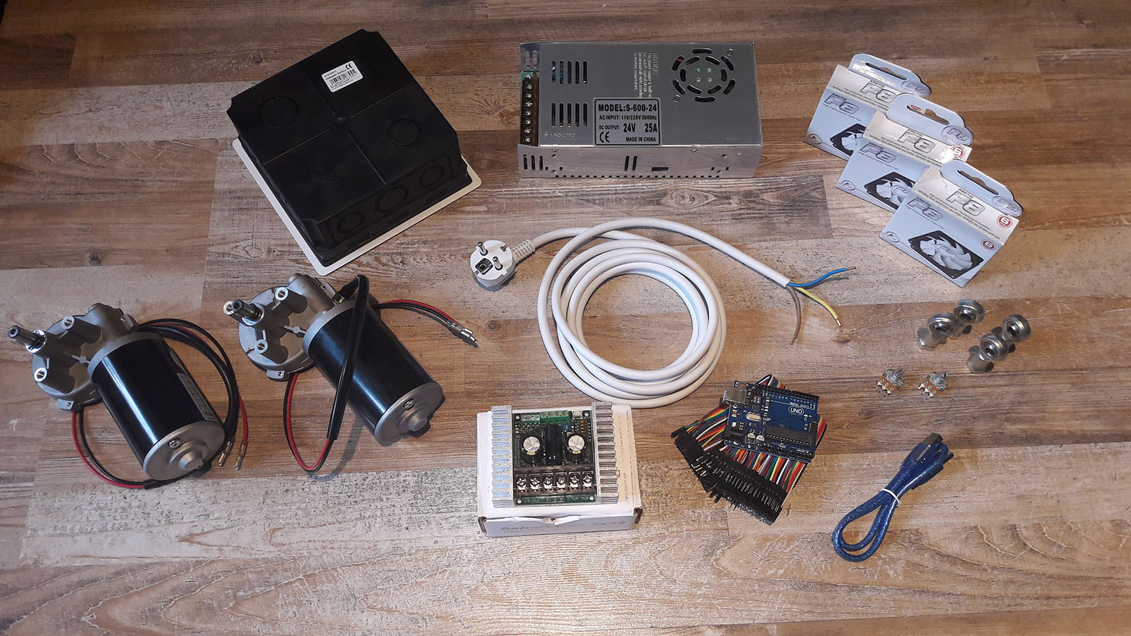

    After a few months without any progress on my build due to life - I'm back to continuing my 2DOF! :cheers
    RECAP:
    While having the steel plates machined by a friends friend took its time, so I did the same with ordering all the components and slowly gathered everything required for the build.
    I took a few photos of everything I have right now:
    There are still a few things I need to tackle before I can assemble everything:
    1)
    Come up with a solution for attaching the lever to the motor transmission axle + combining it to the potentiometers.
    My idea for this is to make a steel cube with a cutout to fit the transmission axle and welding the lever onto it. The axle has a 5mm thread which I will use to somehow connect the axle to the potentiometer.
    But maybe you have a better solution for me?
    2) Wire and test the electronic components.
    I already have a wiring plan and basically know how to wire everything but I will need help with the software setup & how to run a test routine. :eek:
    3) Clean the steel plates and paint them to make them look neat.
    Self explanatory. One thing I need to do before painting is drilling the holes for the motor mount bracket and bolting everything together.
    I hope to continue the project a bit faster now and hope I will figure everything out with your help + searching the existing forums.
    That's it for now.
    Stay tuned! :)

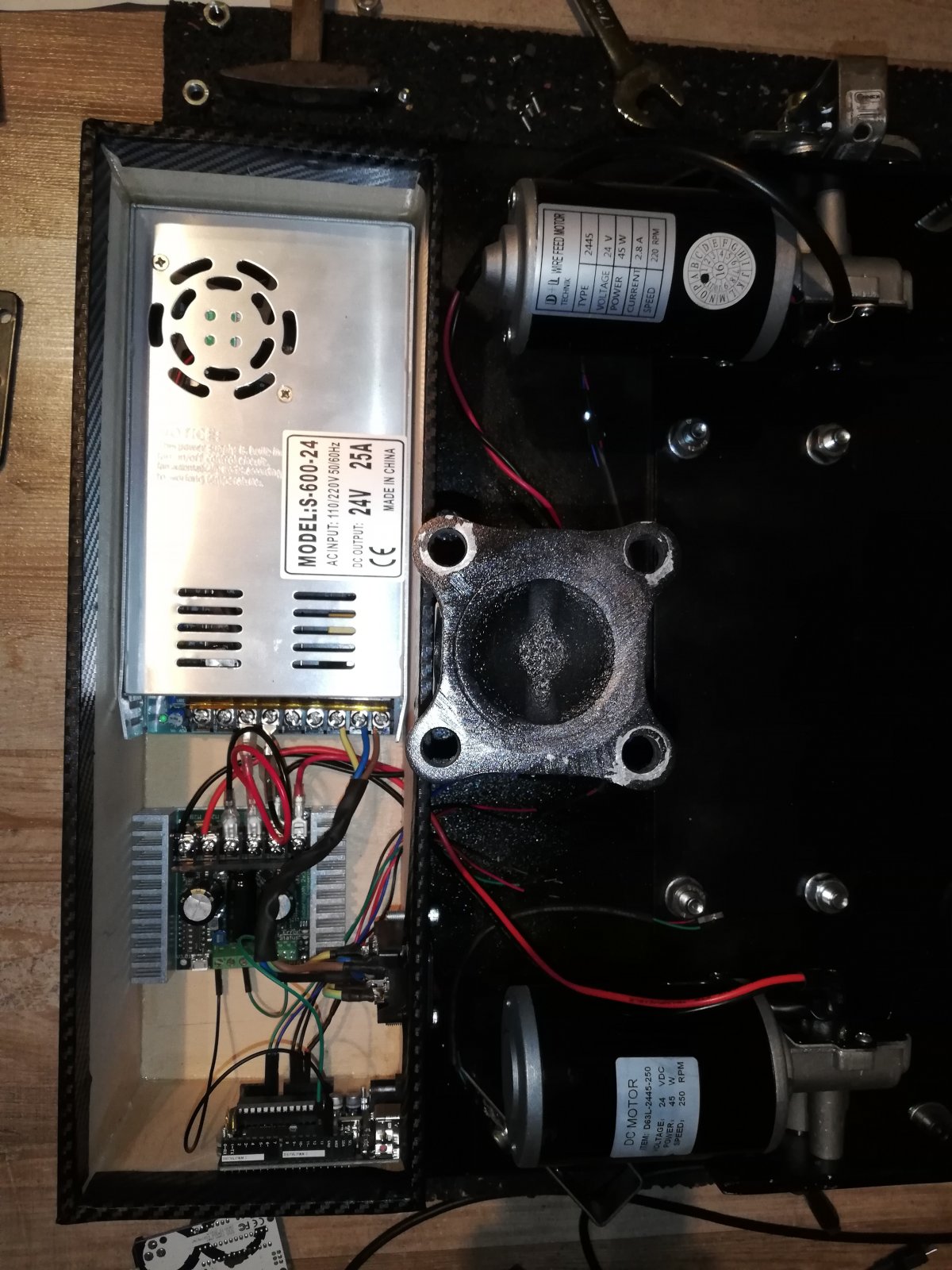

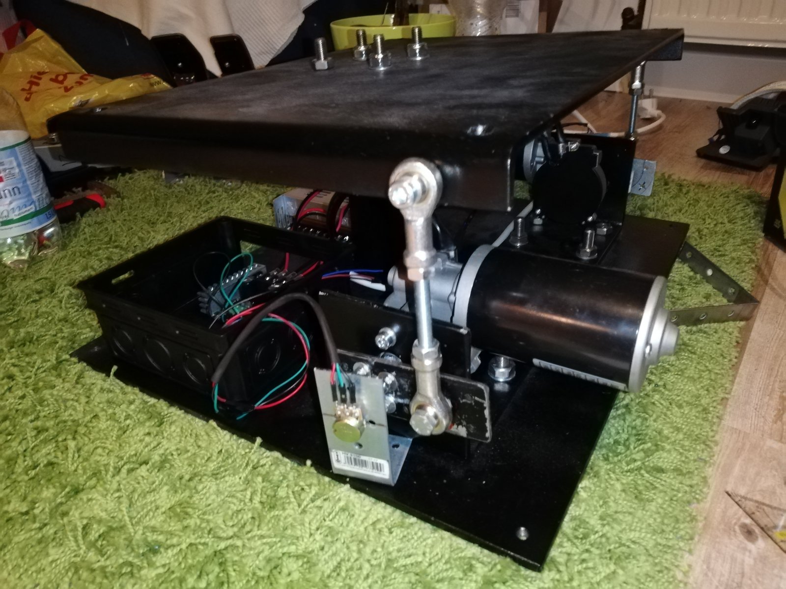

    I'm slowly making progress as the winter season is coming around :D
    So this is what I have so far:
    I painted the steel plates, bolted everything together, came up with a solution for the CTC lever attachment and wired everything up.
    For the electronics housing I simply used one of these standard issue electronic boxes made of plastic. On the housings roof there is a fan for cooling the boards.
    Right now I'm waiting for a long USB-cable to arrive to connect the arduino board to the PC as I have the plattform beneath my current rig until I could test it out.

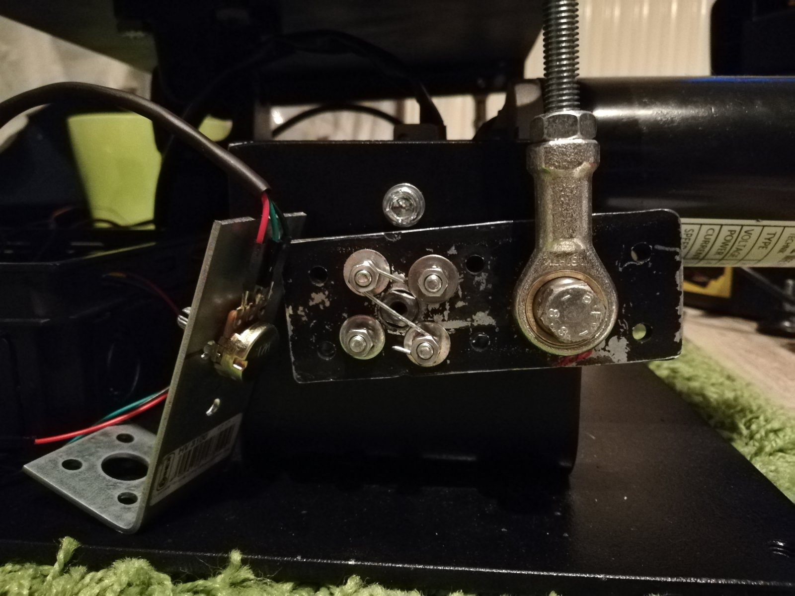

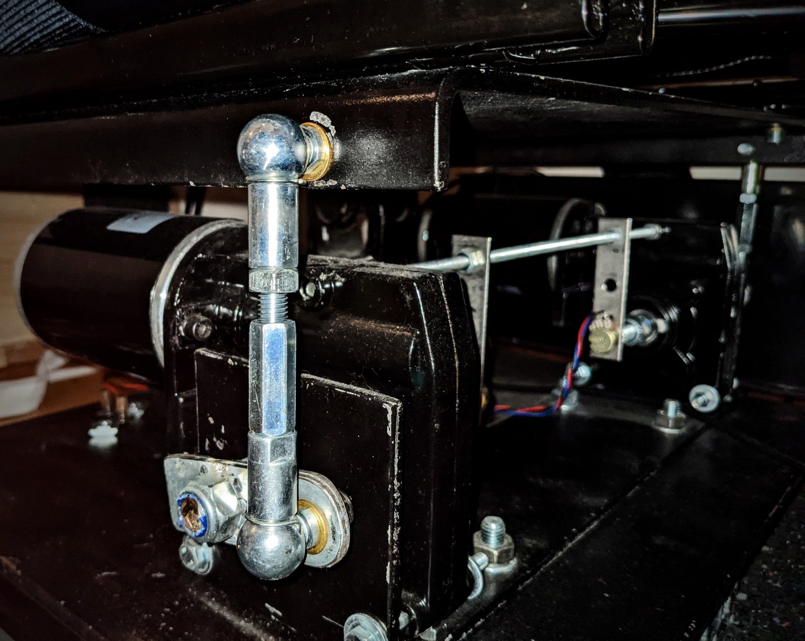

    My biggest concern are the motor axle attachments for the CTC lever:
    I was not able to find the correct fittings for the motor axle's shaft so I ended up with ebay couplings without a tooth or anything. They need to be secured with 2 screws only but at least I didn't need to weld anything (because I can't.).
    They are secured by flattening the axle on two opposite sides and only 2 4mm screws. They seem to fit really tight and I had to use a hammer to slide them fully onto the axle.
    Fingers crossed that it will hold up... o_O
    For the potentiometer attachment I simply used a strong metal wire bent between two opposite screws which fits the u-shaped axle of the potentiometer perfectly.
    I hope to be able to connect everything to the PC within the next week.
    I'm excited if my build will work!
    @noorbeast
    To be honest I haven't checked if these motors need ground isolation. I opend one up and was heavily confused as it looked way different from the example in the forums tutorial so I didn't mess with it. :think Can somebody enlight me why I actually need ground isolation for and if I can damage the other electronic components by trying to operate it anyway? :sos

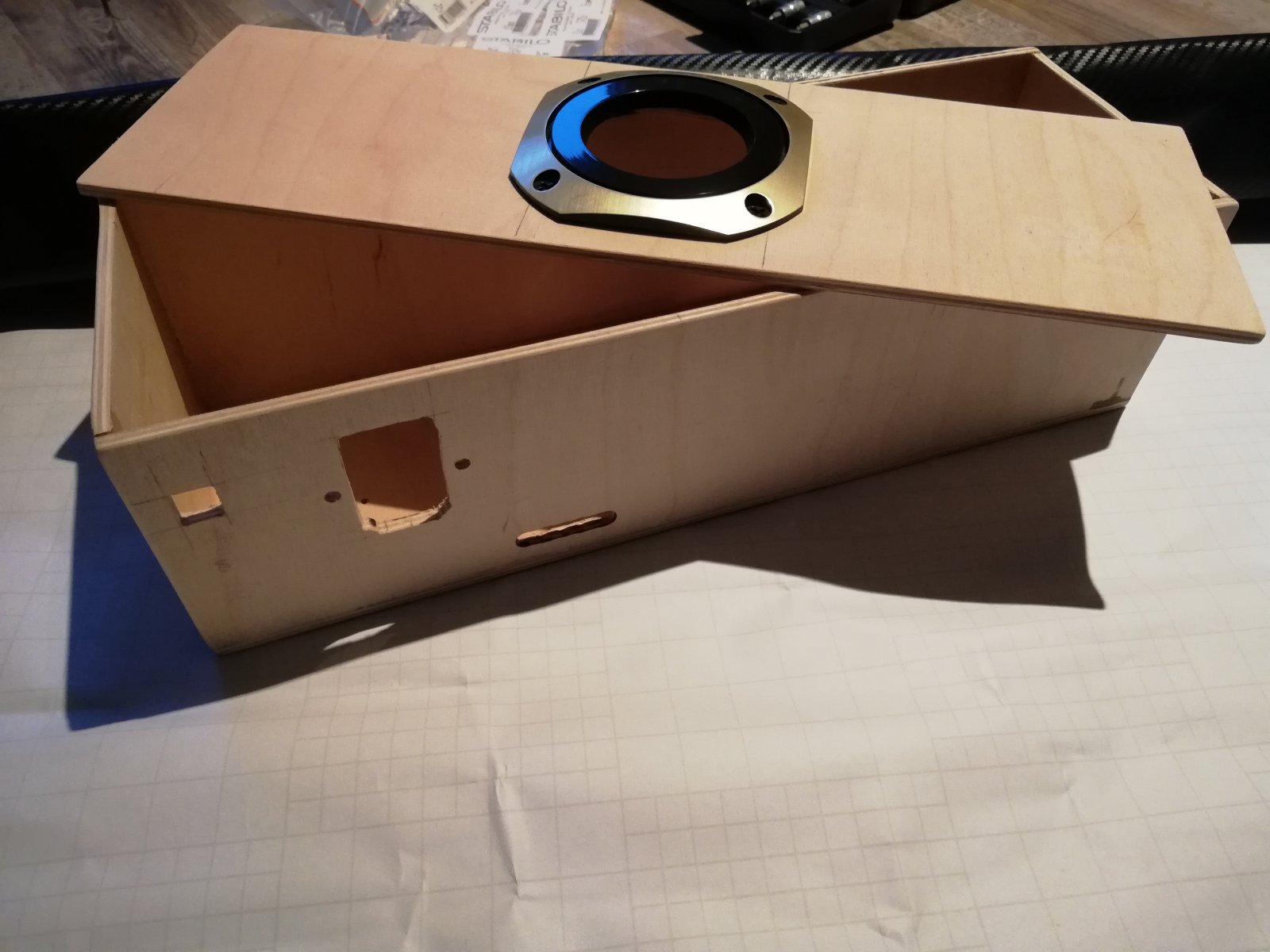

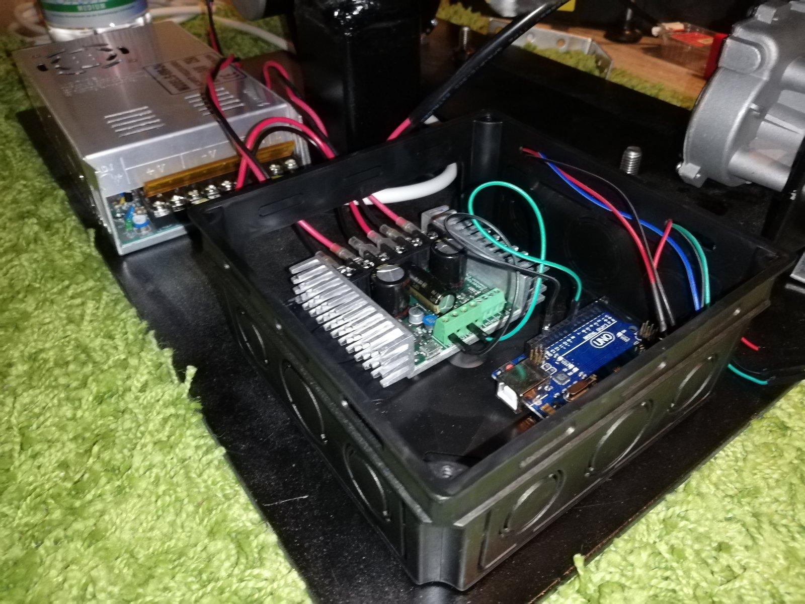

    While waiting for the new motor to arrive I build an electronics housing:
    IMG_20181031_163237.jpg IMG_20181031_163303.jpg IMG_20181031_210824.jpg IMG_20181031_211711.jpg
    I also added the new motor but was not able to really continue testing in SMC3 except for a short 5 min test and everything worked but the new motor is twitching the more I power it up end ultimately ends up out of range.
    Seems a bit strange. I'll have to sort this out on Sunday when I can continue actual testing.
    I wonder if maybe the pot is bad?

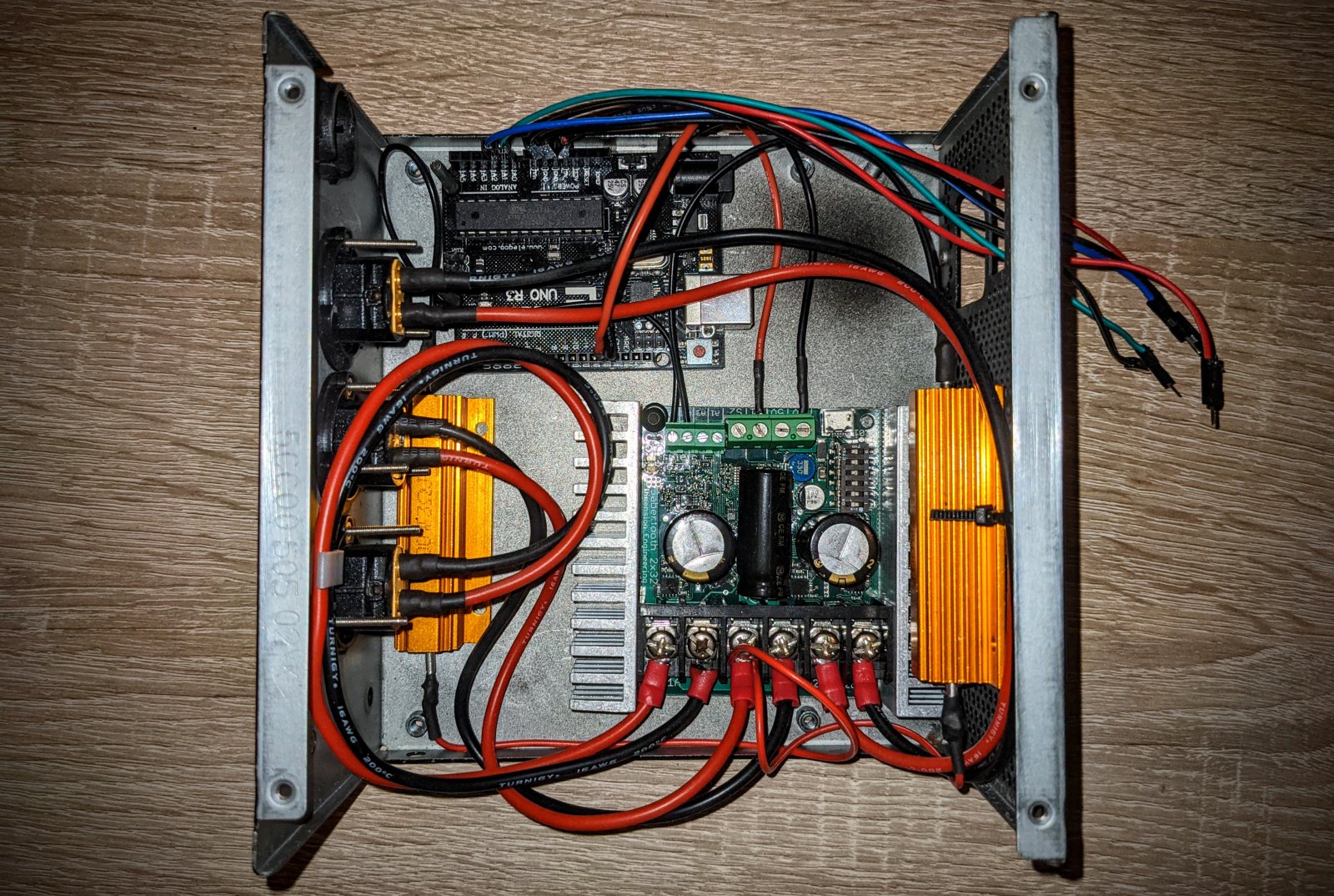

    UPDATE FOR V2
    Motors: MOTIONDYNAMICS Worm Drive Motors 24V 200W, 180RPM, 20Nm
    PSU: SKYRC Extreme PSU 1200W 24V 50A (model seems not available anymore)
    Control Unit: updated design using an old psu casing
    Sabertooth 2x32: added 2x 1Ohm resistors
    updated Axle shaft levers: switched to M8 ball joints
    Might be worth noticing that I added an additional support rod end connector (the large nut thing) as I felt the M8 rods were a bit too weak. Choose M10 if you wanna fell better :)

    Nice work on the control unit.
    How did you attach the XT60/90 to the 3D printed holder? Can you post some more pictures of it?
