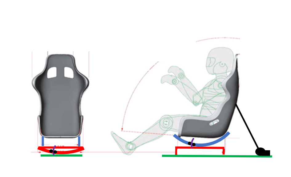

    Thankyou Noorbeast. I will likely use shoulder mount, and i am not looking for big angels/large movement. But if i can make it even more balanced, maybe the vipermotor can move a rig with pedals and wheel. It is also posible I make a rollercoaster sim for some kids, and in that case I want the ability to adjust ratio. :)

    Rocking chair consept. My idea is to keep center of gravity low, and more balance to make it easyer on the vipermotors :)

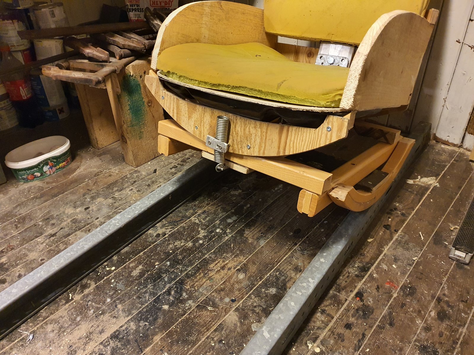

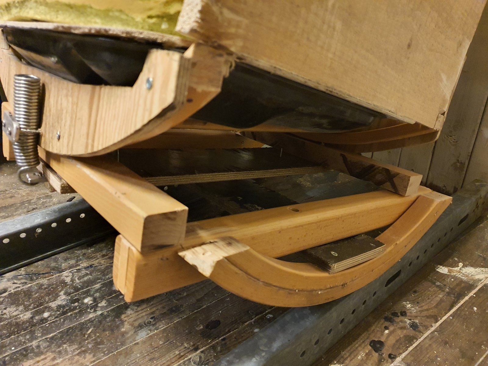

    A little update: In building my rig I recycle somee materials from an office chair and other furnutures. its not looking pretty, but I will make a fake leather skin and some paint on it. Its kind of a rocking chair on a rocking chair :) I can balance sitting on it, but to far pich or roll I will loose balance. But I think the vipermotors will have an easy job, if i keep the angels moderate. I have got the motors but waiting for the controllers. I am also working on a H-shifter, and started to plan wheel and pedals.

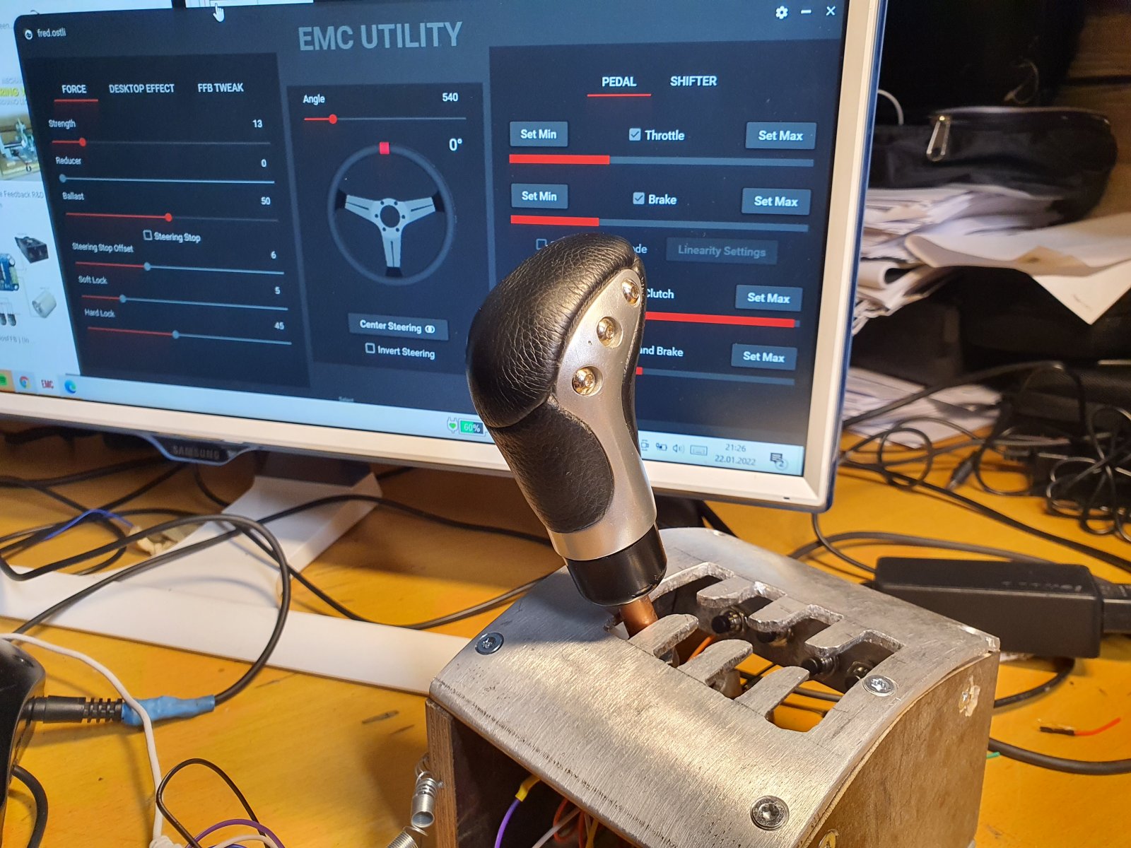

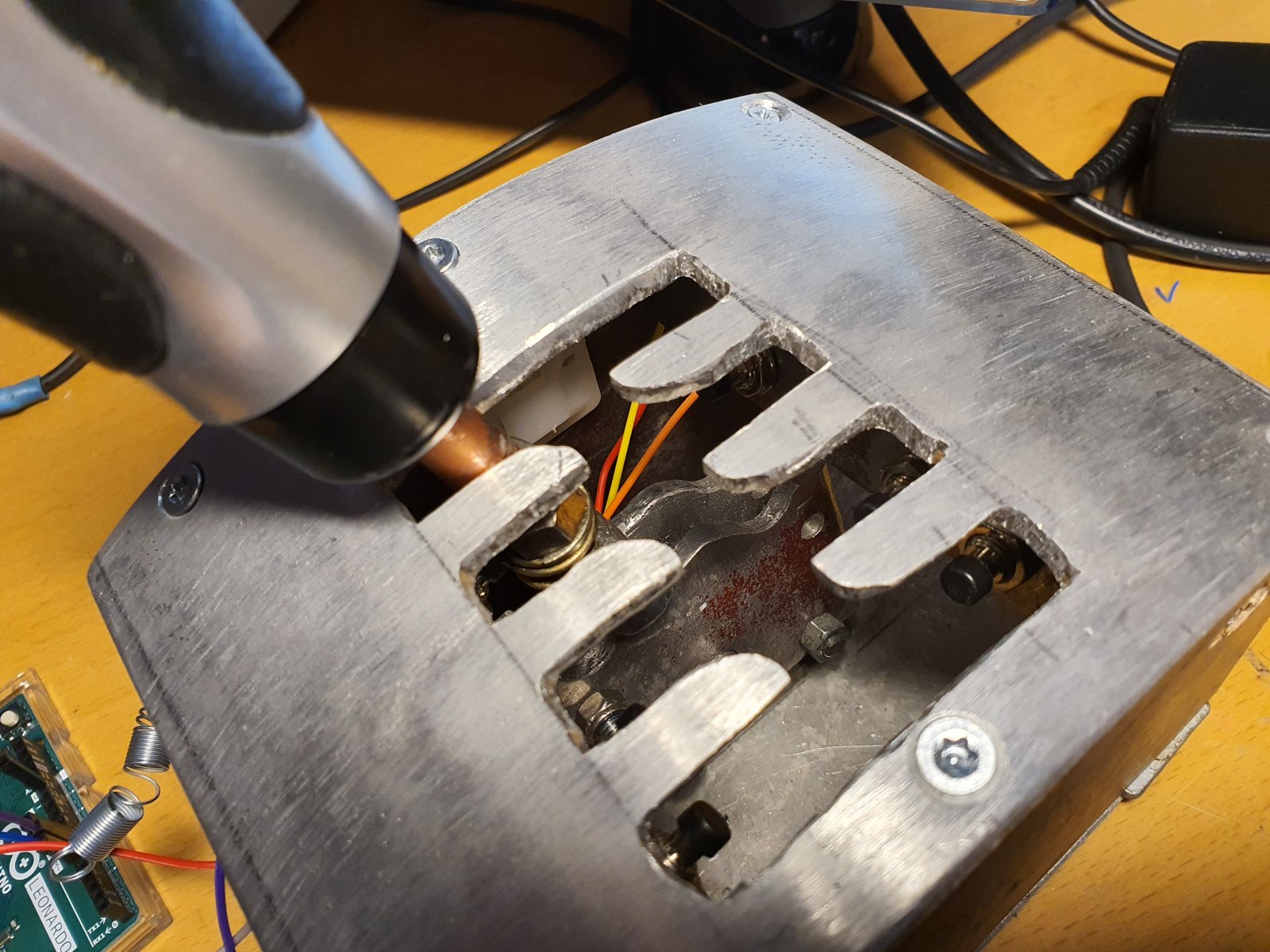

    A little uppate: i have made a H-shifter, not completed the finish, but tested with Arduino Leonardo and the EMC firmware and software. Looking good so far, I realy like the work mr EbolzMagy do https://www.youtube.com/channel/UCe6N3hxeEd2DB_undoxaIMQ . Also connected some pots for pedals,

    I am now working on a FFB wheel with Arduino bts7960b EMC, and a windshield motor. I did a test today with a small motor and an encoder from a printer. A little drive in GTR2 with encoder as stearing wheel, worked well :) i have read that the bts7960 might have some heat-sink issues. Tomorrow I will do a test with the windshield motor, but want advice on improve cooling, and safety. Nothing burned yet, but I know its a risk. I have a cpu-fan i will use.

    OK, I did the first test with my ffb wheel. I use the gears from the old logitech wingman and the wheel, but I skipped one gear, as the windshield motor is stronger. Seems to work ok, but I did blow a fuse with the ffb strengt on maks in GTR". The fuse was 10A so a lot less than the motorcontroller rating. Nothing got hot in my test, and all well with 86% strenght in the game, and full strenght in EMC-settings :)
    Next is making a box over it,get the wires properly fastened, and connect gearbox and pedals. When the controllers are done, I will continue with the seat-mover :)
