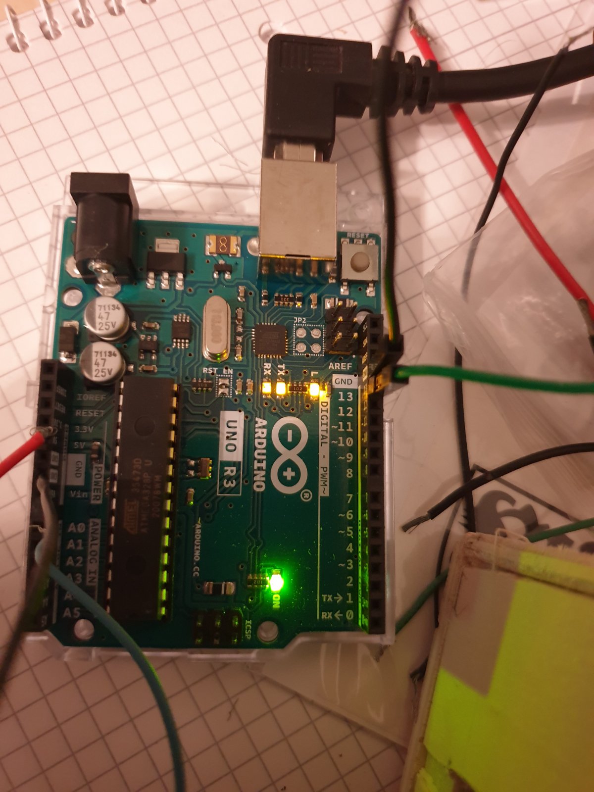

    Hello guys,
    I'm building a motion seat.
    Unfortunately, I really have problems controlling the motors.
    I use a 24V 30A power supply for 2 motors, an Arduino Uno R3 and a Sabertooth 2x32.
    I can't get the motors moving with a potentiometer.
    But when I play around with the Sabertooth jumper, the motors start and run continuously.
    There's something wrong with the Sabertooth jumpers.
    I've been reading the forum for days
    Unfortunately I still haven't made it.
    Maybe someone could help me.
    That would be great.
    thanks, people

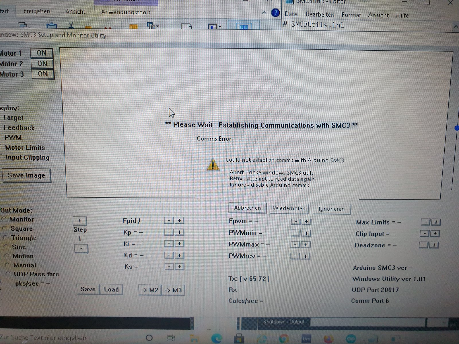

    I read and understood the SPS tutorial and tried to follow it.
    The baud is correctly. On Arduinonand Sabertooth. Both are on 115200
    When i try to open the smc util 1.0 or 1.01 i cannot open it.
    When i use another smc3 file i can open smc v 1.0

    SPS is mostly the same code as SMC3 but with drivers for Sabertooth controllers. However utilities and the Arduino must communicate at 500000 baud so if you have a jumper on pin 8 to gnd it can't connect. That option should only be used if you have communication issues between Simtools and the Arduino or clone.

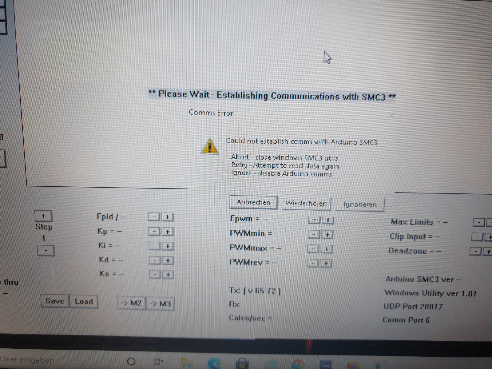

    SPS i can upload in Arduino. But after tjis i cannot open any smc.util.
    Take a look at the picture....
    What do you mean with pin 8 ? This i dont understand

    I mean the only reason I know of at this point why it won't connect would be if arduino pin 8 to gnd option is used to change baud from 500000 to 115200.

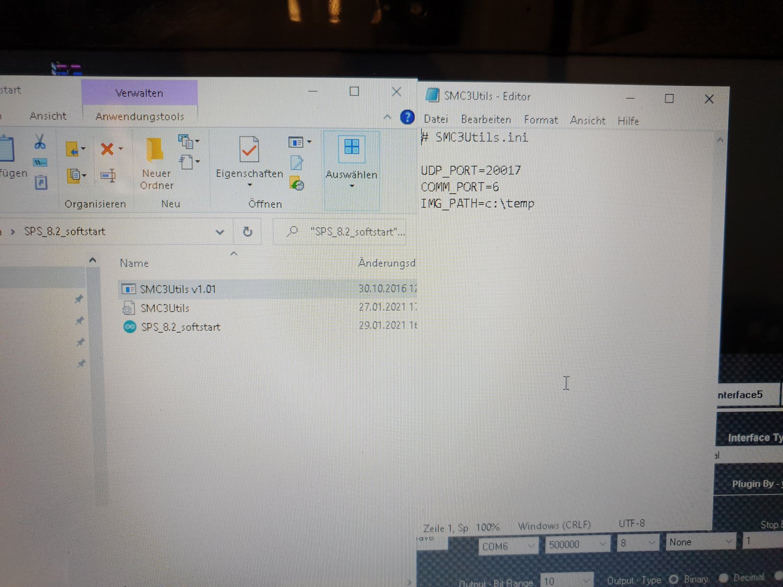

    The Arduino baud is 115200....only in the settings of simtools it is writtennthat you should use 500000. By the way with simtools i have no connection to SMC3.
    And the main problem was that the motors are like dead. Theres no Impuls. Nothing. In germany we say ' i am finished with my Latinum ' haha....it is frustrating. I think i am not so far away from moving motors. But wheres the mistake ?

    When you power up or reset SPS sketch it will automatically set its baud to 500000 unless pin 8 is grounded first. Utilities can only use 500000 baud because it doesn't have a way for the user to change it.

    You need to get connected to utilities before this matters.

    I uploaded SPS 8.2 with softstart successfully on Arduino

    With utils v 1.01 also with von 1.00
    Shit
