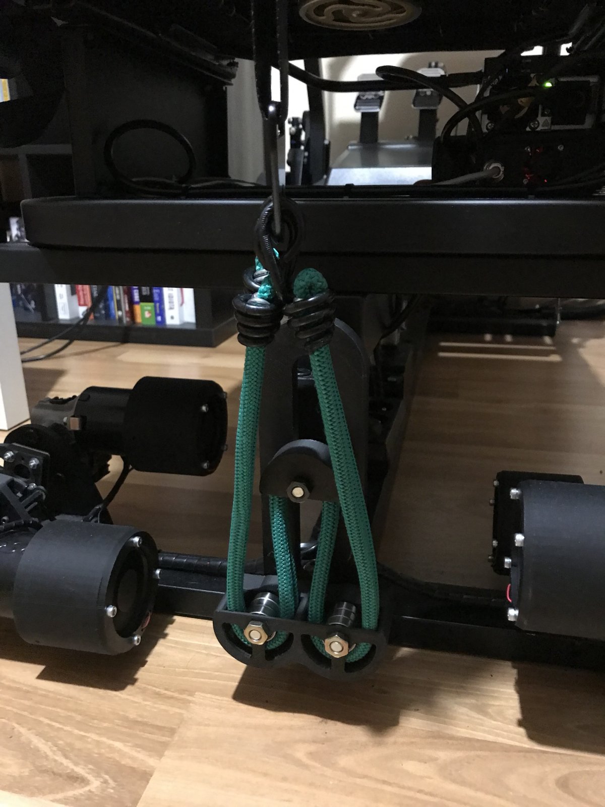

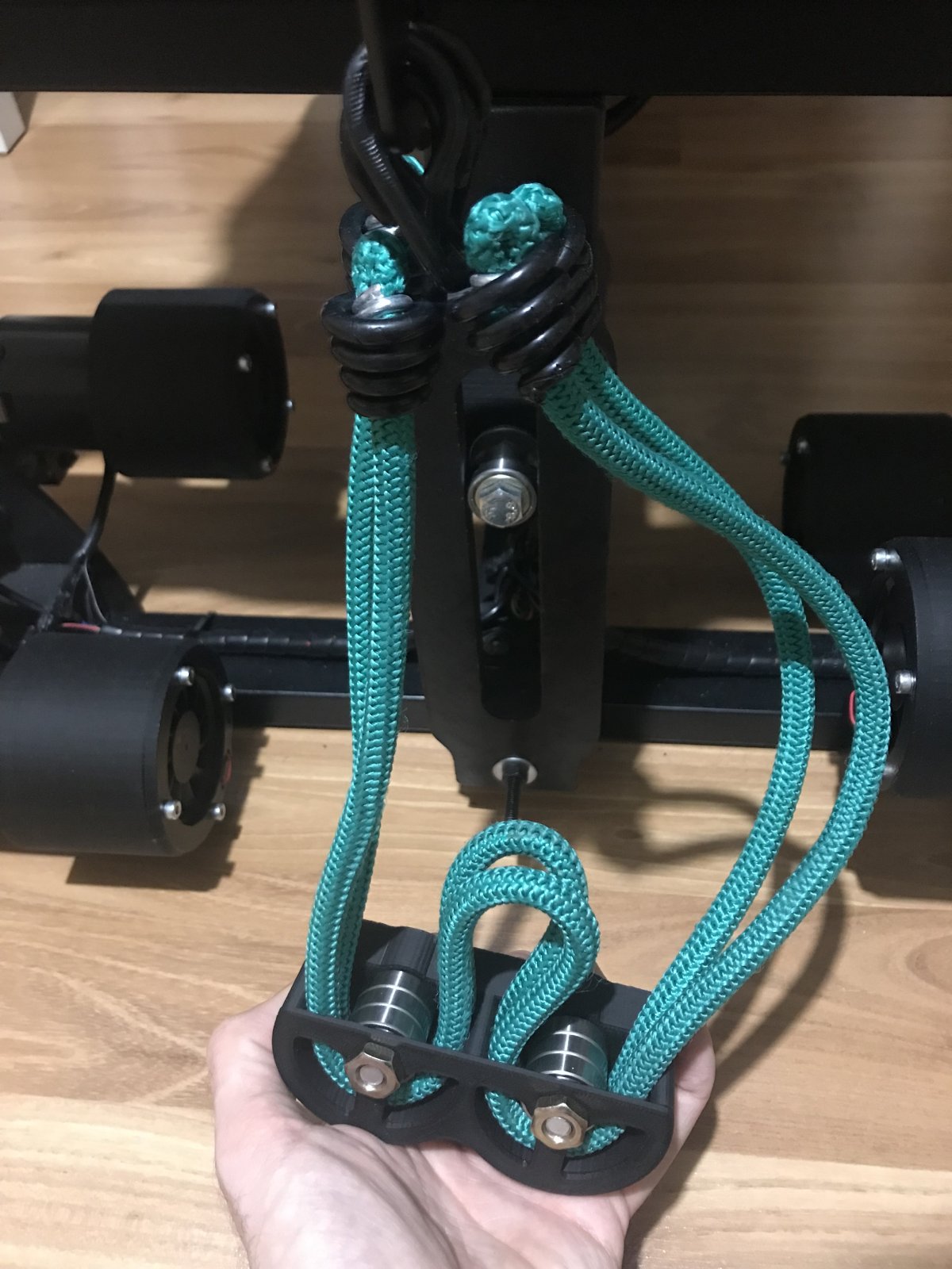

    It's finally finished! I've just done a couple laps on the Nurburgring :D
    Here's the solution for the belt tensioner:
    This system of pulleys doubles the motion of the belt - both the belt and the attachment point get pulled at the same time. They obviously move in the same direction so the pulleys at the bottom reverse the motion, resulting in 2x motion.
    The belt system went from "not worth the effort" to "quite good". I'd still like it to tighten more, but this probably the best you can get without an electric tensioner. I'm happy.

    Nice build and nice 3d prints! It's amazing what you can do with PLA, very underrated. I might have to try out your seat belt tensioner idea.

    the belt mechanism is really a great idea!
    can't wait to replicate what you did, when I have time.
