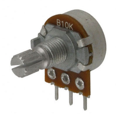

    Just getting started on a 2 DOF motion base. I want to order all the parts needed to build a mock-up/proof of concept to learn Simtools and perfect motion before building a real life base.
    I based this list from Mode 1 of this forum:
    The end result will be a simulator to play back 3D ride films.
    Along with Simtools and Video Ride Creator, Recorder and Player. Here is a list of items on my shopping list so far.
    R1206 UNO + Development Board + Breadboard + Bread Wires Set - Blue
    $36.00
    Alloet Dual VNH2SP30 Stepper Motor Driver Module Monster Moto Shield Replace L298N
    $9.40

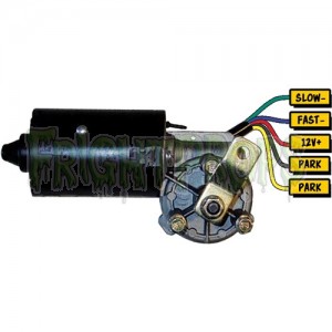

    2 Dual Speed High Torque Prop Motors
    $24.99
    https://www.frightprops.com/electric-motors/motors/dual-speed-high-torque-prop-motor-mot1.html
    (These motors are just to make the small platform move, not for final base)
    10K LINEAR POTENTIOMETERS
    (from local electronics store)
    5v-5amp (Regulated) Power Supply

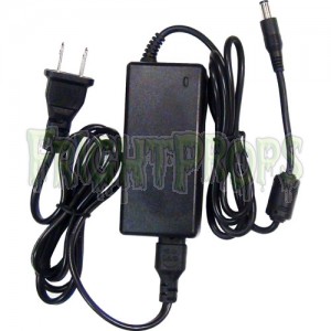

    $15.99
    https://www.frightprops.com/electric-motors/power/5v-5amp-motor-power-supply-0955-0005-5000.html
    I am asking for your input to make sure I am ordering the correct items to make it work. Please let me know if this list is complete and if the prices and suppliers are good.

    You need a 12v power supply for these motors...

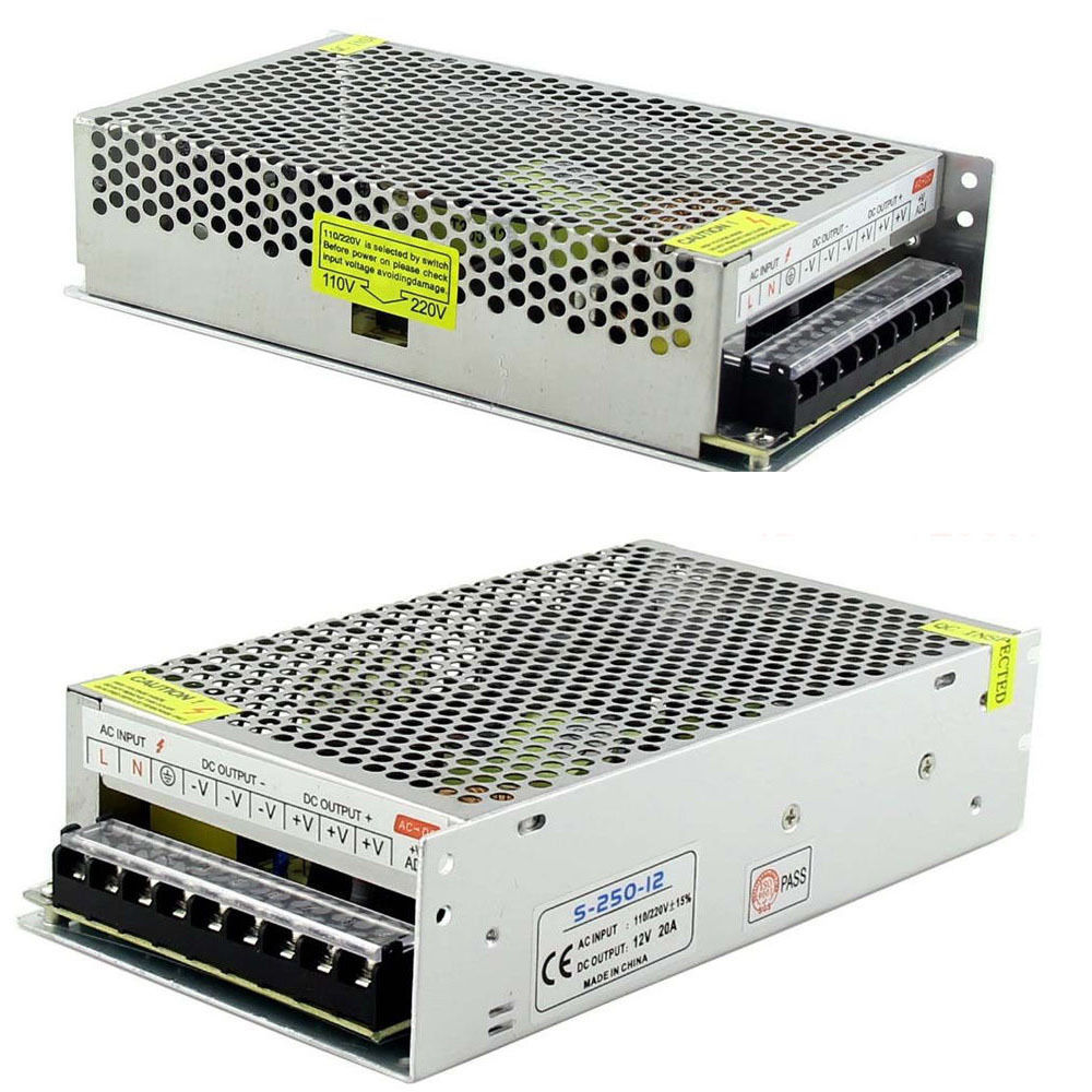

    To start a base project the list you write could be ok (the dc motor has 6Nm that according to me are low, but i see also that the price is low).

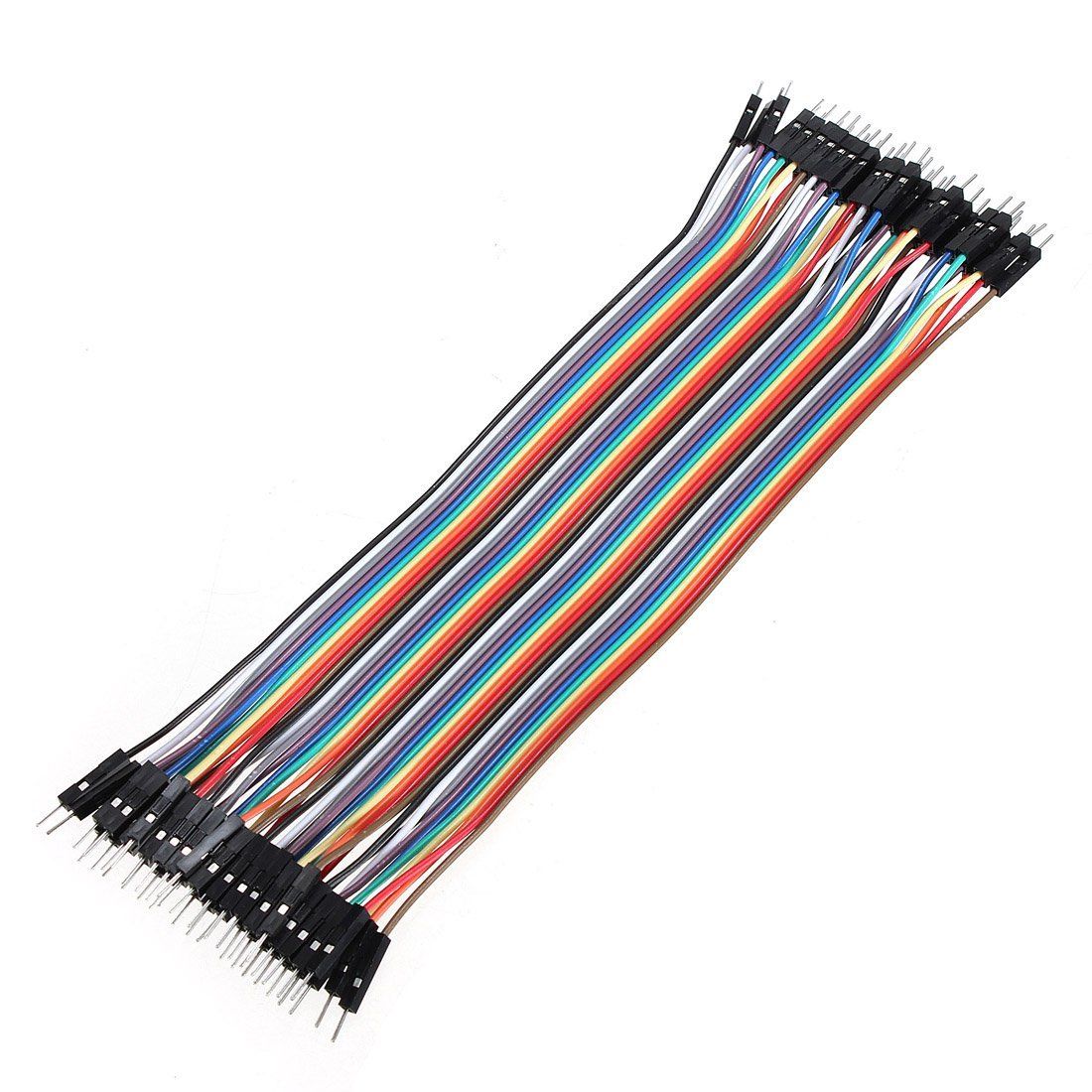

    At the start of my project, i bought only an arduino uno r3 (about 5$ on ebay) and 40 jumper wires (about 1,5$ on ebay. Without breadboard and development board or other)
    You don't need the 5v power supply (the pc usb will give the 5v to the arduino board)
    You need a 12V 30-40A power supply (aboout 20-30$ on ebay, similar to the picture attached) to drive the motors
    Has more Ampere of what you need but will be ok for future update without other purchase
    I hope this helps
