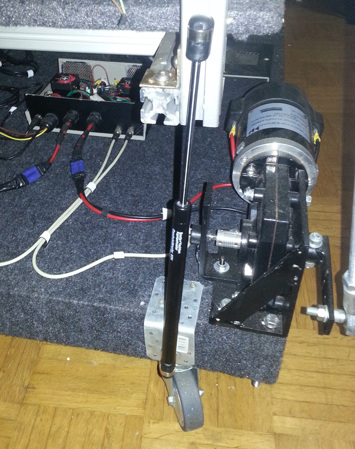

    I recieved all of my Hardware for Edtracker and maked the first Tests. At the moment it runs quite well.
    I also mounted my Hall Effect pots. Now the motion gets better again.
    I only have to sort out a Problem with the Gear boxes.
    The problem is descriped here by @Ville Pesonen 2DOF motion simulator build
    It is really annoying. I thought about some Dampers or springs to support the motors holding the upper platform.
    I thought about something like this
    http://www.ebay.de/itm/2x-GASFEDER-...OP-QUALITAT-/370960800974?hash=item565efc9cce
    Did you think this will ne usefull?
    21,676
    151,700Coins
    +11,045 / 56 / -2
    If they are brass gear 60:1s and did not have slack when new then it is likely the teeth of the main brass gears have deformed as a result of the load on reversals, as the design limit is only 90nm.
    Design wise these motors use the same diameter gear as a 25:1, but because they have far more teeth, to achieve the lower ratio, the dimensions of each tooth are far less. If the reversal spike load is over 90nm, which is not a lot, then the brass teeth can be deformed, resulting in slack.
    I have redesigned my sim to significantly reduce the load. I was lucky in that I picked it up early and only one gear was affected. I have since changed the gears in that gearbox to fix it.
    Depending on how you made the levers you could try turning the main gear 180 degrees and check if that takes up the slack. If so then the teeth in the original contact area are deformed. The only real fix then is to redesign to lessen the load on reversals. If not then check things like the keyway for slack.

    My gearboxes had the slack in them when they were new also, and agree that it's pretty annoying. In some cases it makes the movement jerky. I have no idea how to fix it though, other than getting new gearboxes.

    Mine had this slack also when where new. Are there any alternative Gearboxes avalible which will fit the motors without much work?
    21,676
    151,700Coins
    +11,045 / 56 / -2
    If they have slack the 3 most likely areas are the gears, the coupling to the motor or the keyway. It would be worth examining each to find where the slack is.

    But I think a redesign isn't possible at the moment. I really thought very long about the design, and I really wan't nothing other than such a structure.
    Since I work in a car garage and there these demperes I post previous are very common, I've got some at home with different Newton ratings to try.
    It looks very good, but the motors are stopping quite fast in case of the blown fuse. The dampers are still to strenght.
    I need to find some good dampers. I will try this before dissasembling the gearboxes.
    But first I must find the right N value for the Dampers, since I can't calculate them with math formula, i need to try so i will order some different ratings and try them.
    For the gearboxes, I don't think they are brass Geared. I bought them from motion control products in uk and in the Datasheed they send me stand something about plastic. I need to search it on the computer.

    so today after some trouble with the seller the dampers I ordered finally arrived. This are 50N each at the moment. They could be a little bit stronger something about 80N and a little bit longer. But this helps my sim very much. I need to find some in the right lenth and strenght.

    I chose 60N each, 25€ inkl. postage. They are testwise attached to my rig. I need to build some new holders.
    The annyoing gearslack is mostly gone and it is a huge Improvment for motion. Now the moion of my sim is finally as i had in my mind and now it's no frustration to play its fun :)

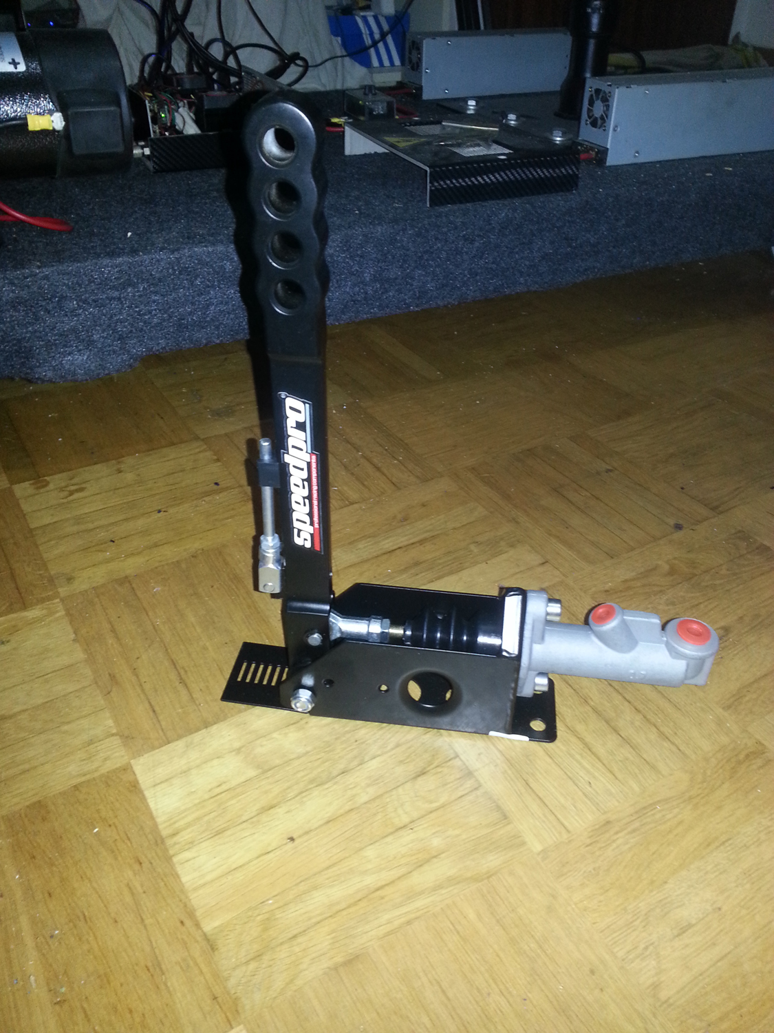

    Also my new handbrake arrives. For 40€ it's not worth build all the holders and lever myself.
    I try to convert it to loadcell like shown by RacingMat.

    I was able to take a video of the motion of the sim. You can see the damper work in the front. I'm still trying to record my gameplay, but it seems my pc isn't capable of that.
