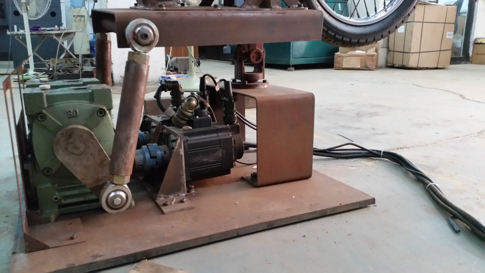

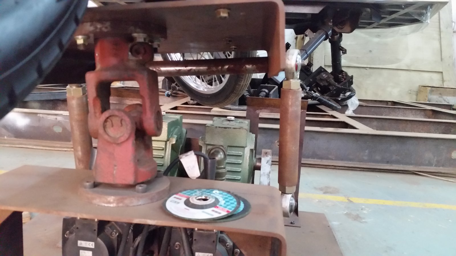

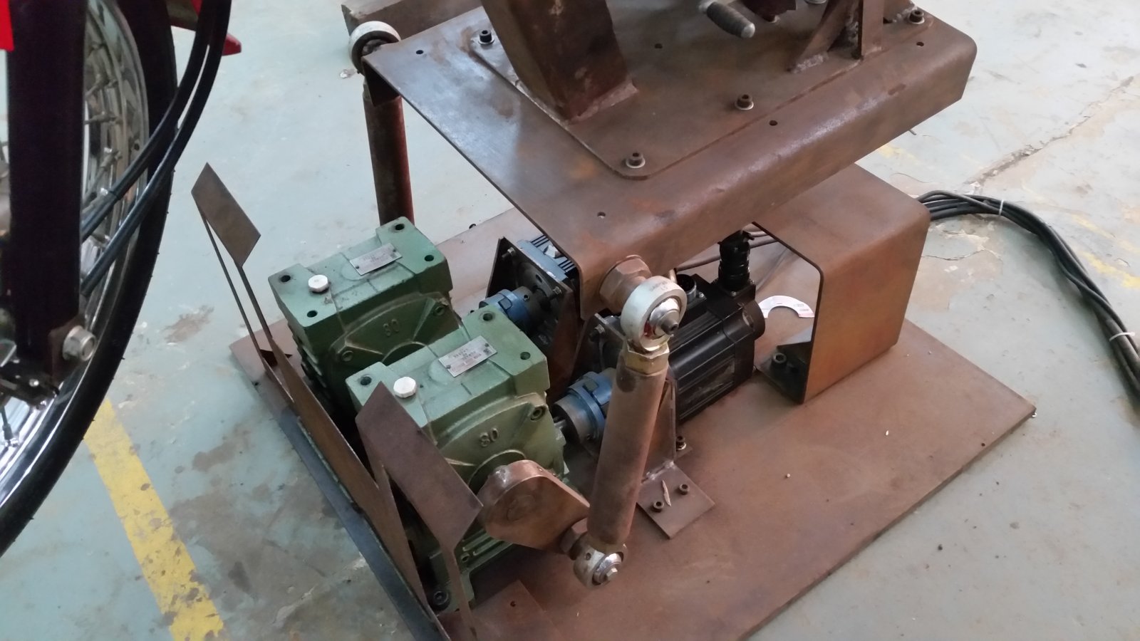

    I am building a 2 DOF Bike Games Simulator, which is in progress on software as well as on its structure side.
    So far i have installed the motors with gear box:
    Universal joint as pivot:
    and a connecting rod with ball joints on both ends to connect gear box with the platform:
    and made an enclosure for drive and circuits placement.
