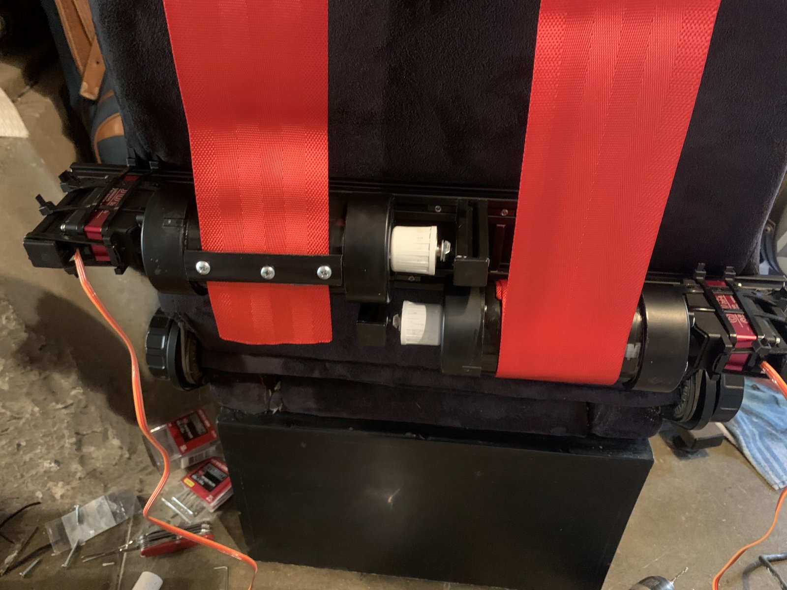

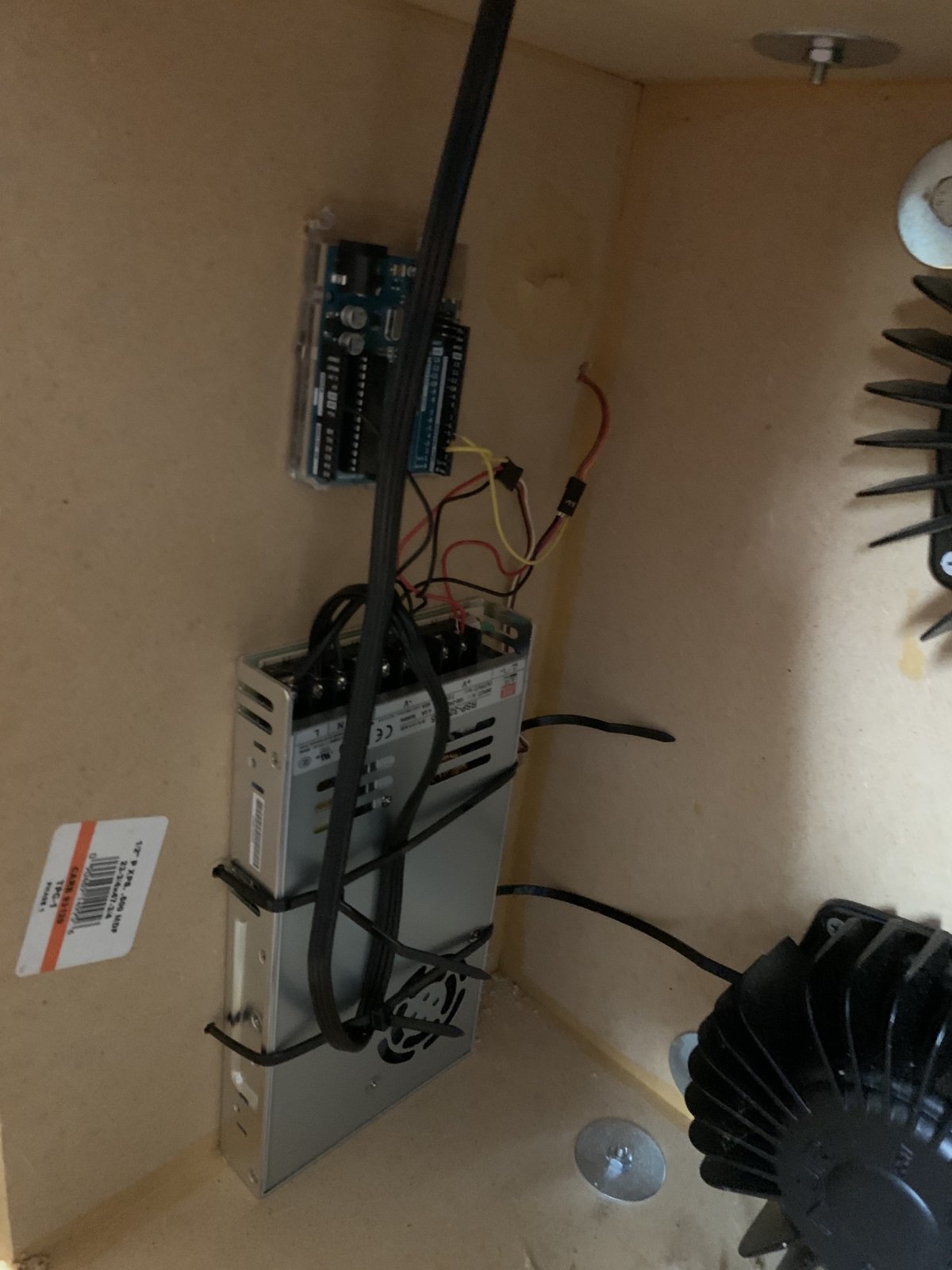

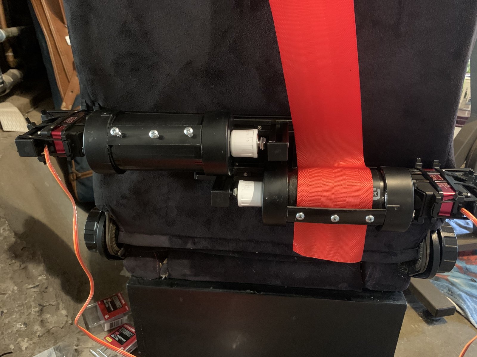

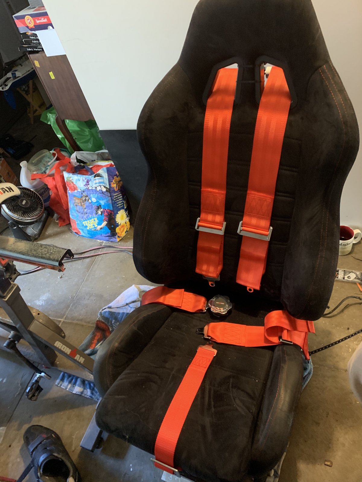

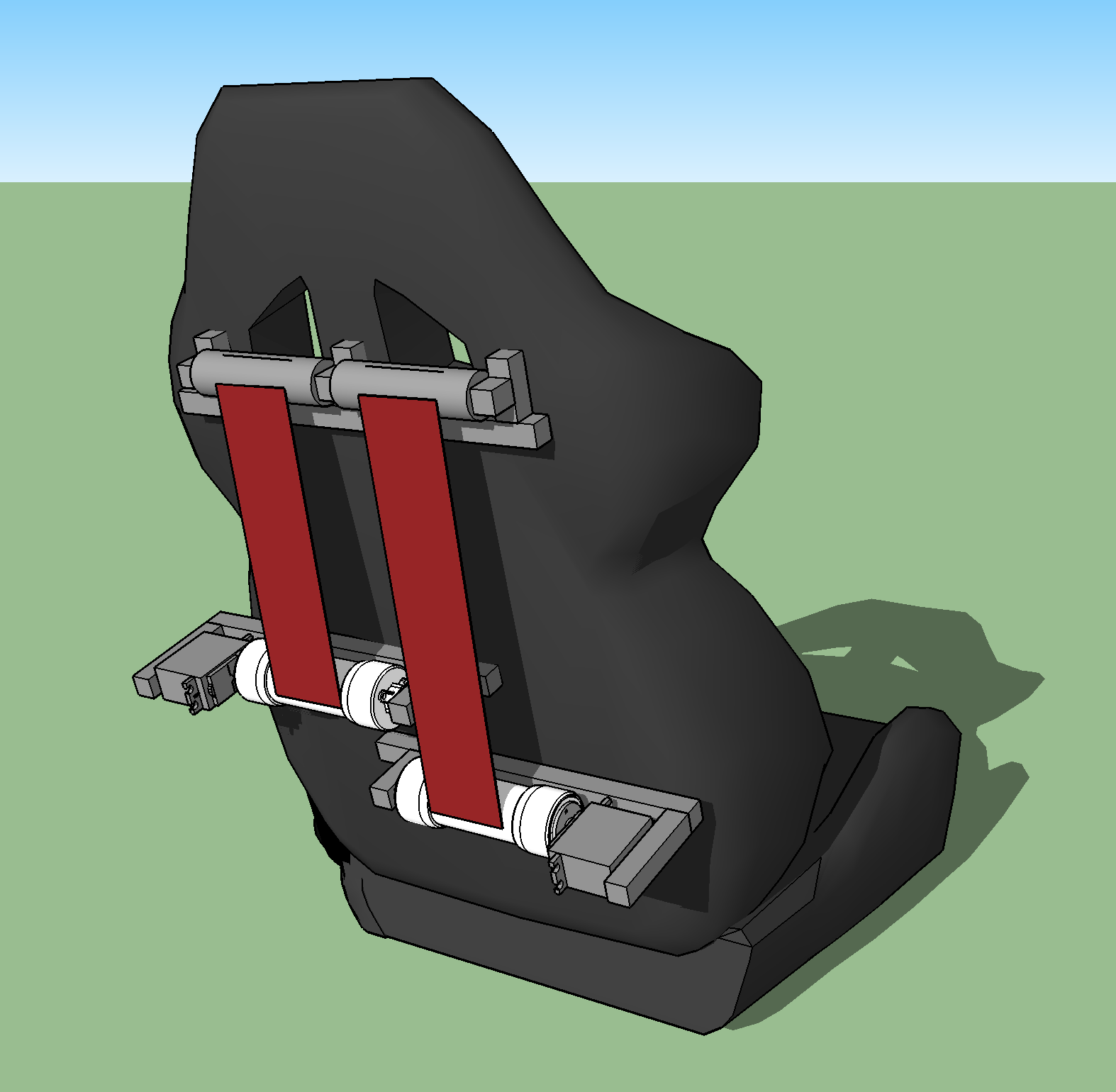

    More progress - I have mounted the lower rollers to my seat and installed the belts. I have also installed my power supply and Arduino under my chair. See photos below.
    I should have time to test the system over the next few days.
    Mars

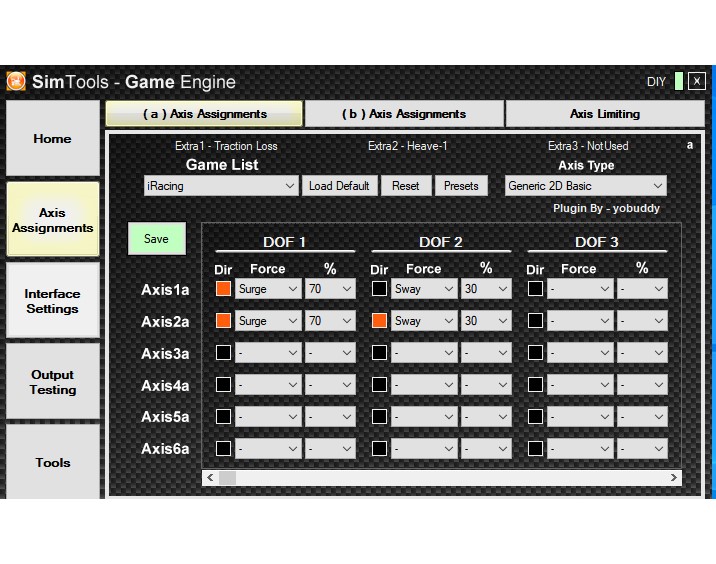

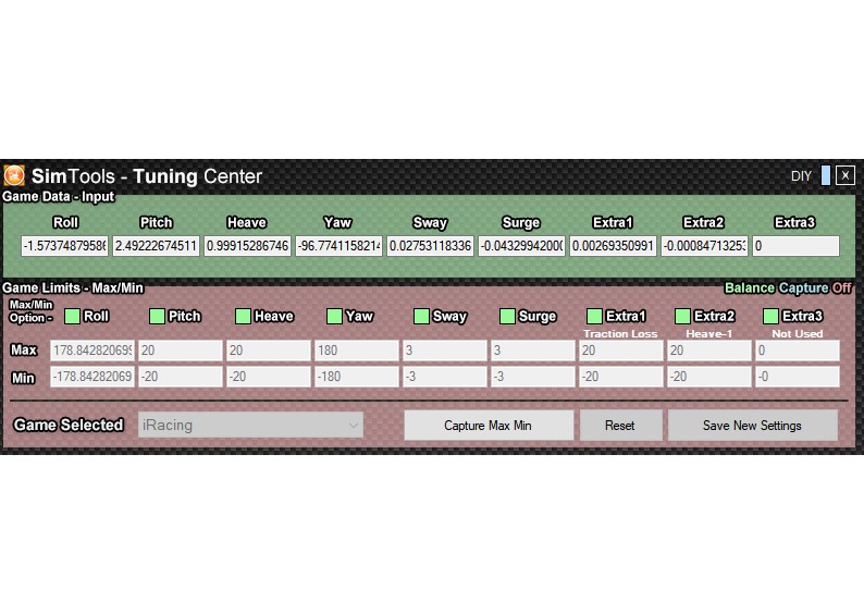

    OK - had some time this weekend and attached are the Simtools setting for my belts. These favor surge by just a small amount over sway but feel pretty good to me. I may turn the surge down slightly but for now this is what I am using.
    Let me know if you have any questions.

    And here are two videos showing the range of motion for surge and sway. The belts tighten a good 2"-3" (5cm-7.5cm) which is more than enough to pin me to the chair under hard breaking.

    I have had more seat time with the belts and they are so cool! So easy to add and really worth the immersion. I am not sure they make me faster in iRacing but they definitely add to the experience! I have not tried DCS yet but will at some point soon.
    I have a couple questions:
    Racing:
    1) When I get in the car I snug the belts and then accelerate away. As I do the belts loosen but they loosen a bit too much. If I adjust my "Surge" Min in the Tuning Center from -3 to -2 this will reduce the amount of movement in acceleration without changing the amount of movement in braking, correct?
    Flying:
    1) Surge and Sway will be helpful while flying but is there a way to have the belts react to the position of the aircraft? Meaning, if I am flying knife-edge for example, can I have one belt tight and one belt loose? Also, while flying inverted can I make both belts tight?
    Thanks!
    Mars
  11. xxpelle
    xxpelle Discord "TPMax#9574" Gold Contributor
    Dec 24, 2017
    120
    619Coins
    +150 / 0 / -0
    Hello Mars
    For question 1:
    No - the other way was correct, change -3 to -4, that makes less when accelerating.
    Question 2:
    Yes - with pitch and roll you can of course simulate the side position or climb and fall.
    Overhead is simulated with Heave.
    The value - should also be smaller than the +
    At flight sim, Heave is the most important parameter to simulate negative g-forces
  12. mars
    mars New Member
    Jan 13, 2011
    27
    Architect
    Northern California
    245Coins
    +30 / 0 / -0
    Thanks again xxpelle - I will have to dig into the flight sim range of motion options to see if I can come up with something I like. Knowing heave is very important will help me do this.
    Knowing that -4 will decrease motion for acceleration is very helpful too.
    Thanks,
    Mars

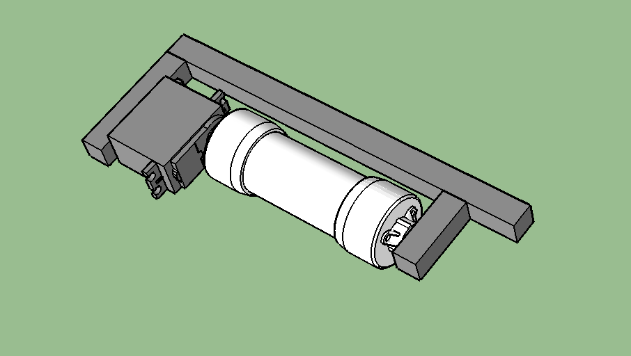

  13. RacingMat
    2,237
    21,050Coins
    very good job! thanks for sharing :thumbs
    I wonder how you linked the servo to the roller?
    In your opinion, are the shoulder rollers mandatory?
  14. mars
    mars New Member
    Jan 13, 2011
    27
    Architect
    Northern California
    245Coins
    +30 / 0 / -0
    Hi RacingMat,
    Sorry for the long delay. I used the large circular servo arm that came with the servo and screwed it into the end of the roller with (4) screws. This made a very strong connection.
    I did not try the system without the top rollers based on the research I did. They remove friction and they keep the length of the belt consistent between servo roller and buckle so all of the change in length of the belts is translated into what is felt. I think they are required to make the system work well.
