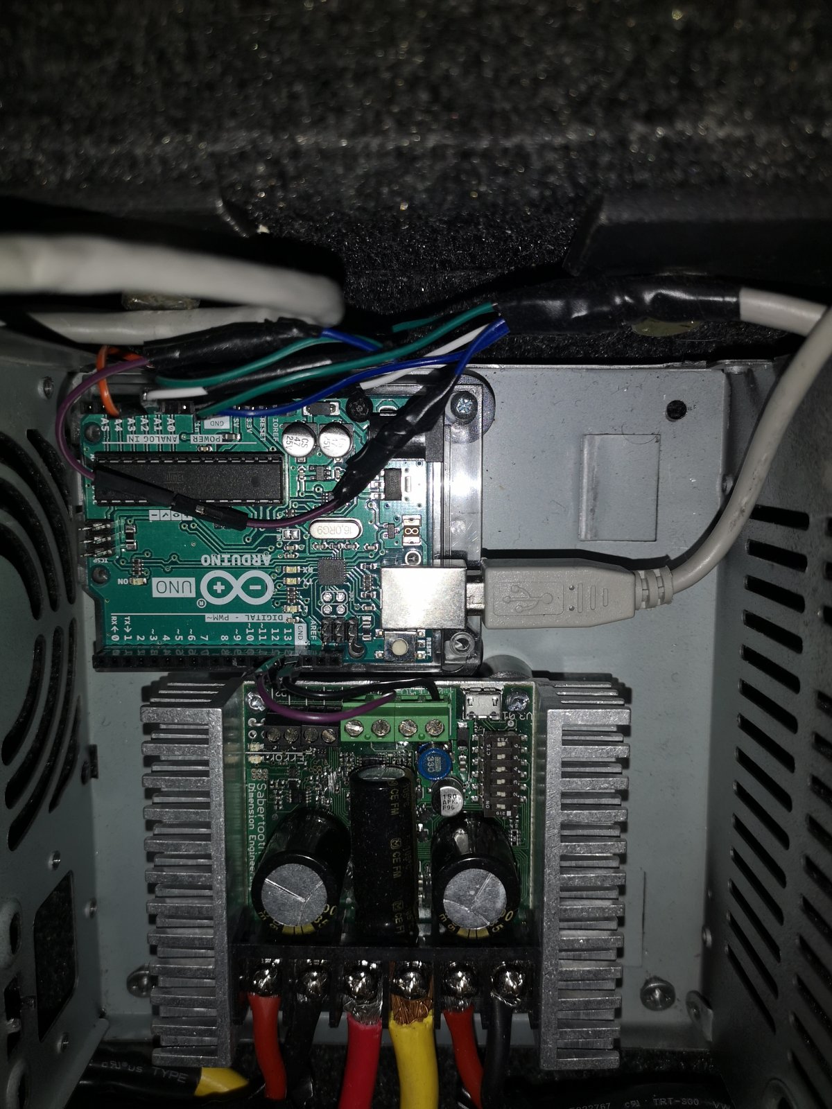

    Not sure if this will help but this is how mine is wired. Works without a hitch. I run 24v. No resistors on the sabertooth. No heat issues at all. Use one single 80mm fan blowing down on all both cards.

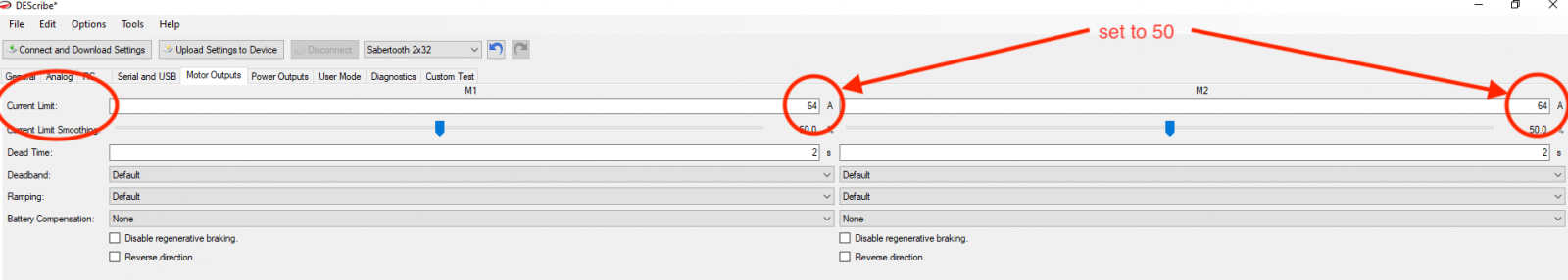

    So I cracked it, turns out my sabertooth was limited to only 10A in the DEscribe software so cranked the current limit up to 50A, uploaded to the sabertooth board and now the rig has amply power to move it.
