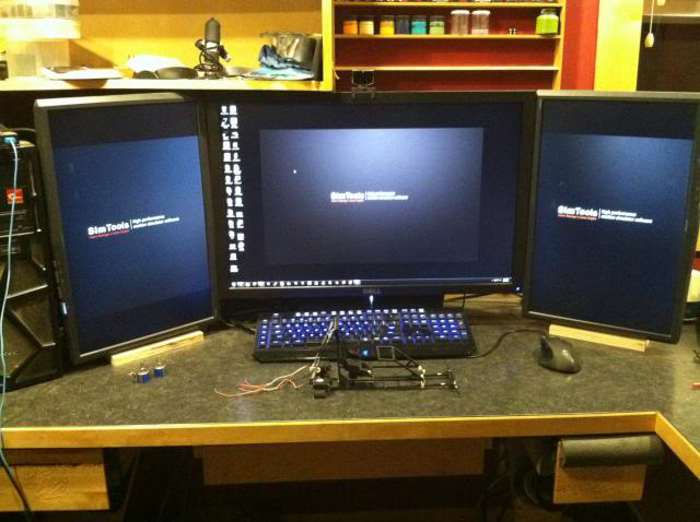

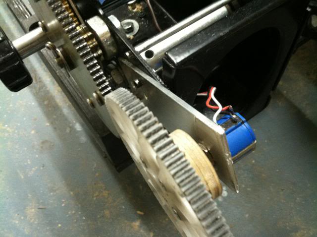

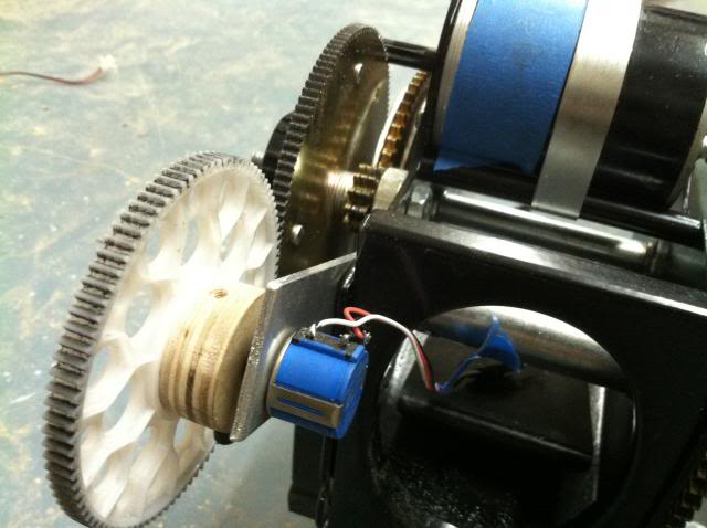

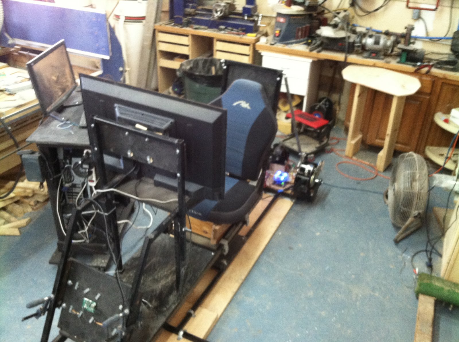

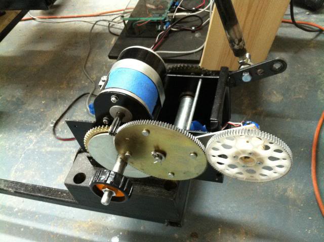

    RacingMat, you asked for these pictures a while back. Sorry it took so long:

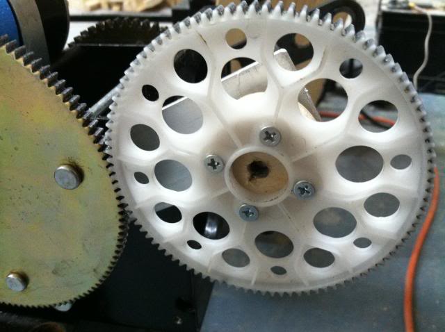

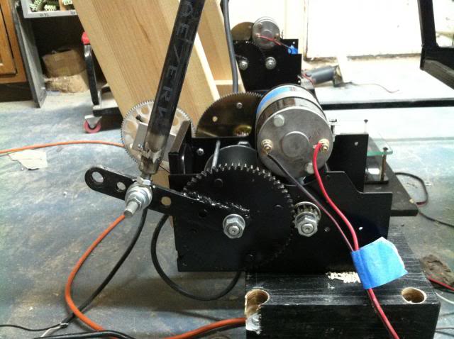

    Thanks for the pics even if you found the solution before !
    How did you finally get rid off shear force onto your pot ? a little more gap between gears ?
    Many teeth !!! :D:D:D
    So, between simulator highest position and lowest position, how many pot turns do you get ?
  5. bsft
    nice idea of side screens on the side, that would be a more compact 3 screen setup
  6. Historiker
    2,162
    9,205Coins
    +2,173 / 19 / -1
    Mat, I will have to take a look and find out. I doubt there is one full turn though. Kind of overkill for 10 turn pots I know but they are what I had available ;)
    EDIT: Forgot to answer your other question. I used a Dremel and elongated the mounting hole for the pot so I could adjust the position.
    Dave, thanks! I do a lot of writing so having documents open in portrait mode makes it much easier to get work done. The center screen is a Dell 30" 2560x1600 so no scarcity of gaming space either :D
    I am loving the Simtools wallpaper!

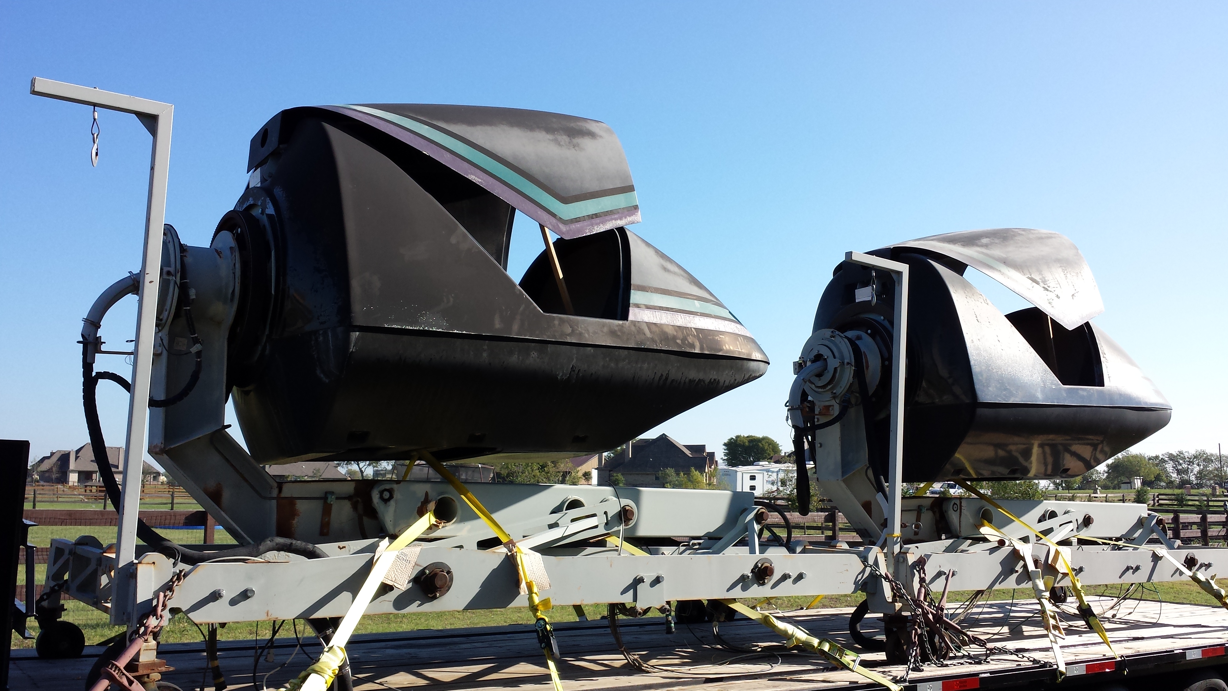

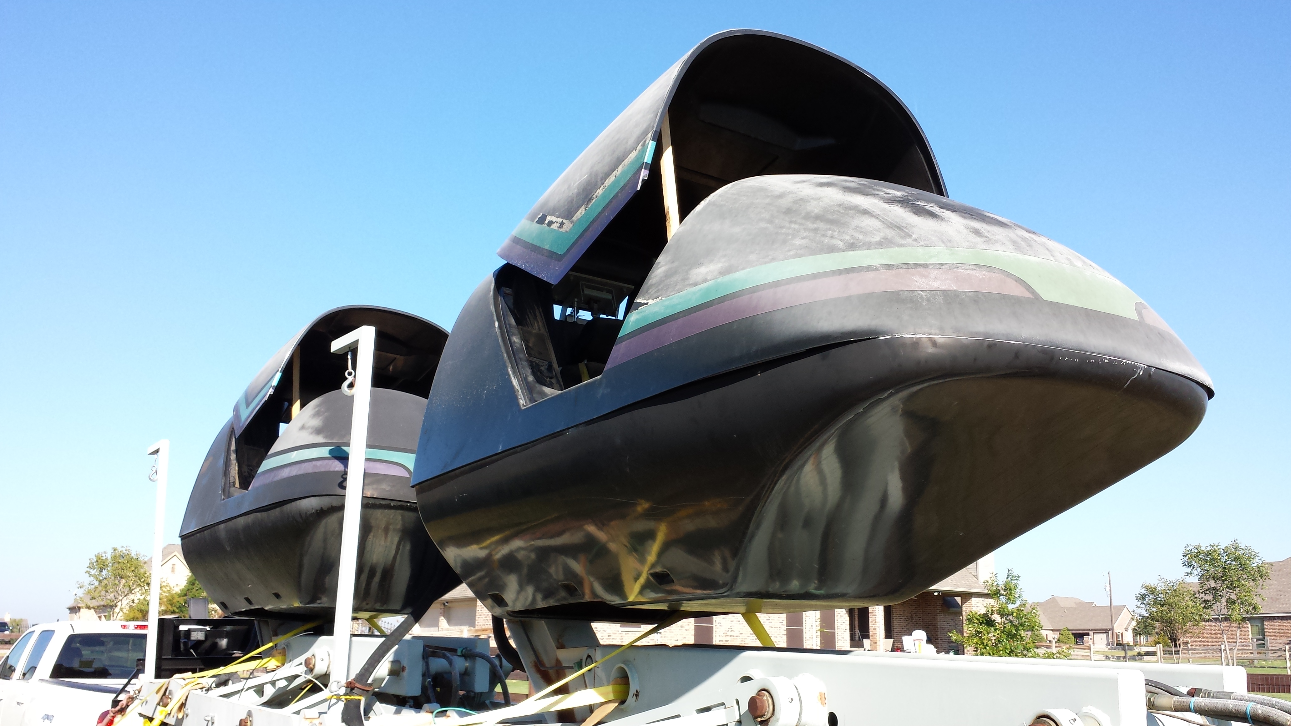

    Rene', Here are pics of my projects. They are Namco Magic Edge Simulators. Inside will be the DCS A-10C cockpit builds. A lot of operating system has be done. Hydraulics are in work. My travels in aviation keep me away from what is really my heart desires. Recently the third simulator was purchased and next week to jumpseat to pickup the remaining control hardware and later to drive and get the simulator. Lots for groovy game gear boards, EPIC boards and Comtrol PCI card to make the most realistic motion simulator posible. Soon will be need of SimTools with DCS plugin to get the simulators in motion for testing. Simulator pic.jpg Simulator pic 1.jpg

    OH DROOOOOL................!
  17. RaceRay
    Nov 8, 2006
    4,658
    Hamburg, Germany
    23,884Coins
    +2,095 / 13 / -0
    What a beast:) @MagicEdge When it comes to start of your project you should open a separate thread than with your A10 Thunderbolt Warthog:thumbs

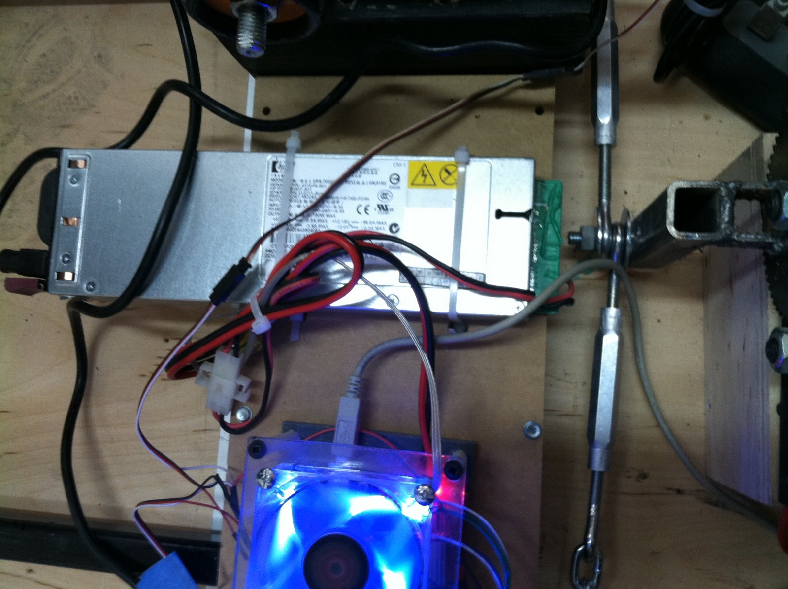

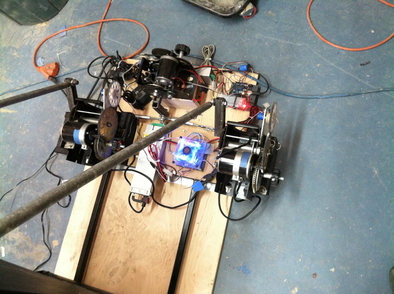

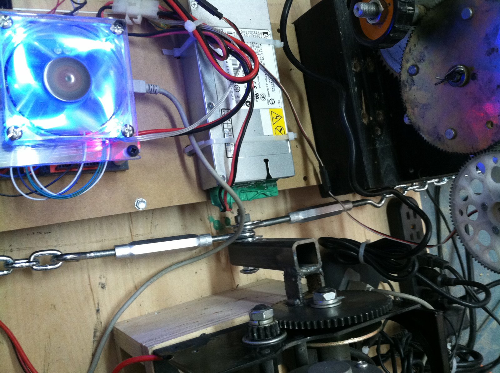

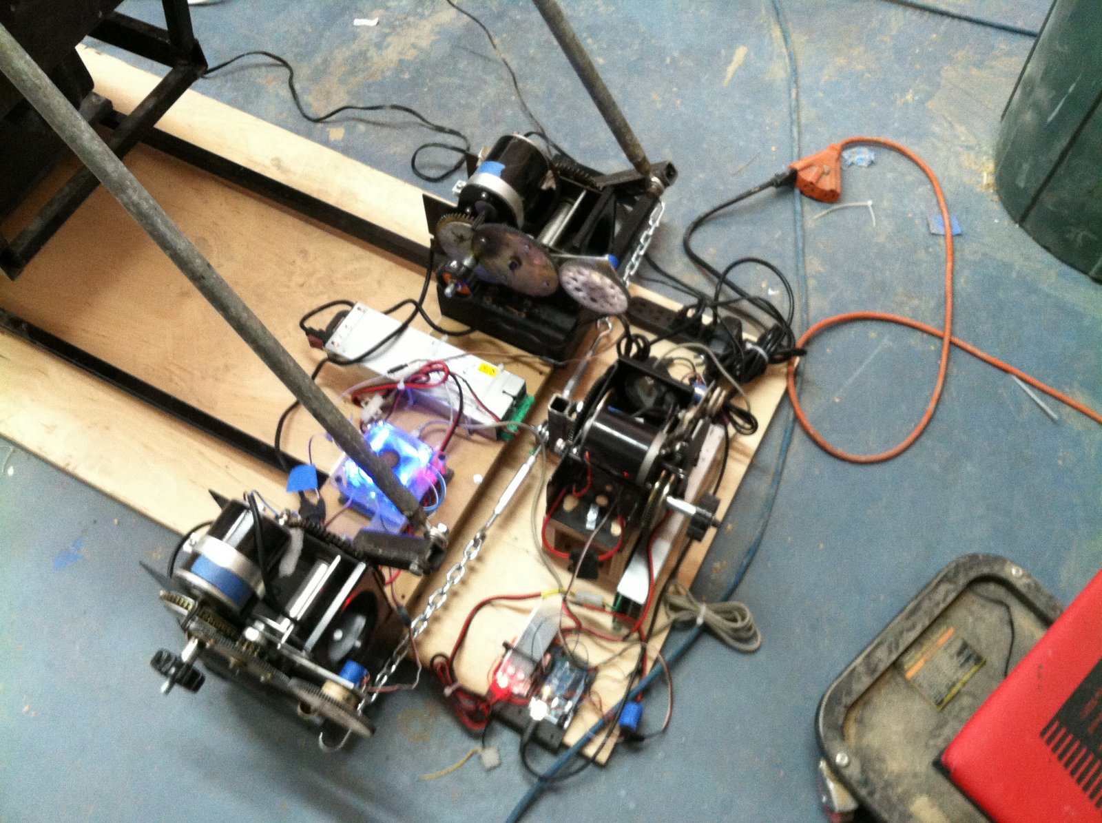

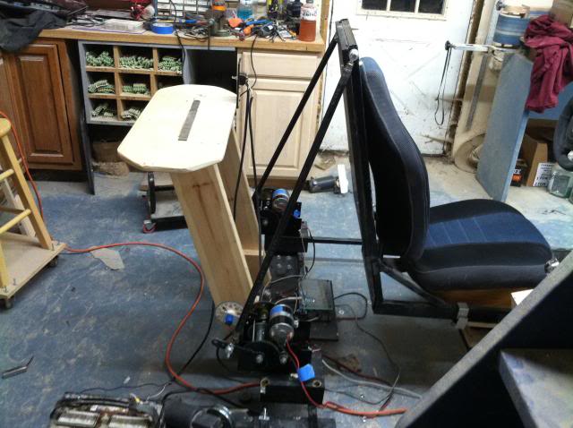

    I had disassembled the 2DoF platform to use the parts on my 6DoF project. But I found that the winches were a different size which put my movements off on the 6DoF platform. So I purchased the matching type of winches for that project and decided to rebuild my 2DoF platform. I also did not want to share controllers on one platform, it was easier to make two platforms than make modifications to the 6DoF to swap out controllers. The 6DoF will be for flight and this one is for driving.
    Excuse the plywood, it is for prototyping purposes. I am going to make the base layer out of steel as soon as I have the bugs worked out.

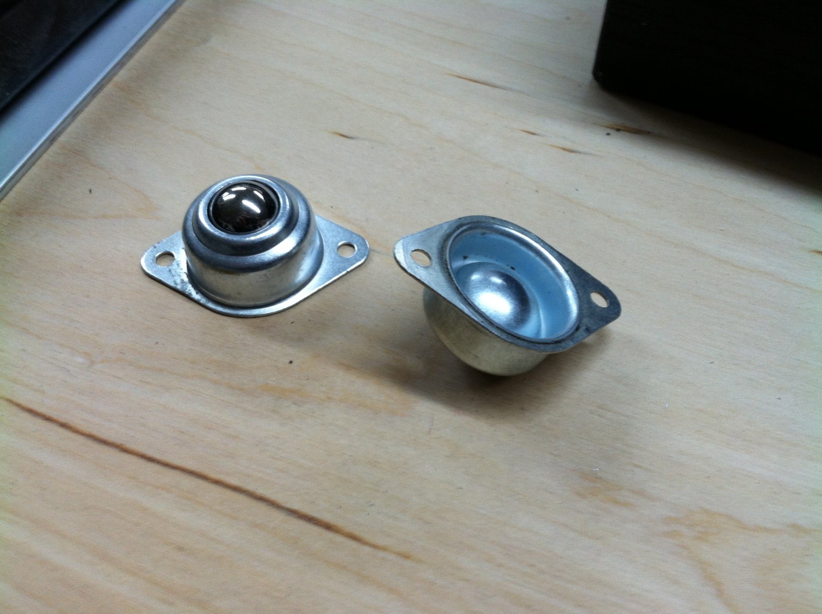

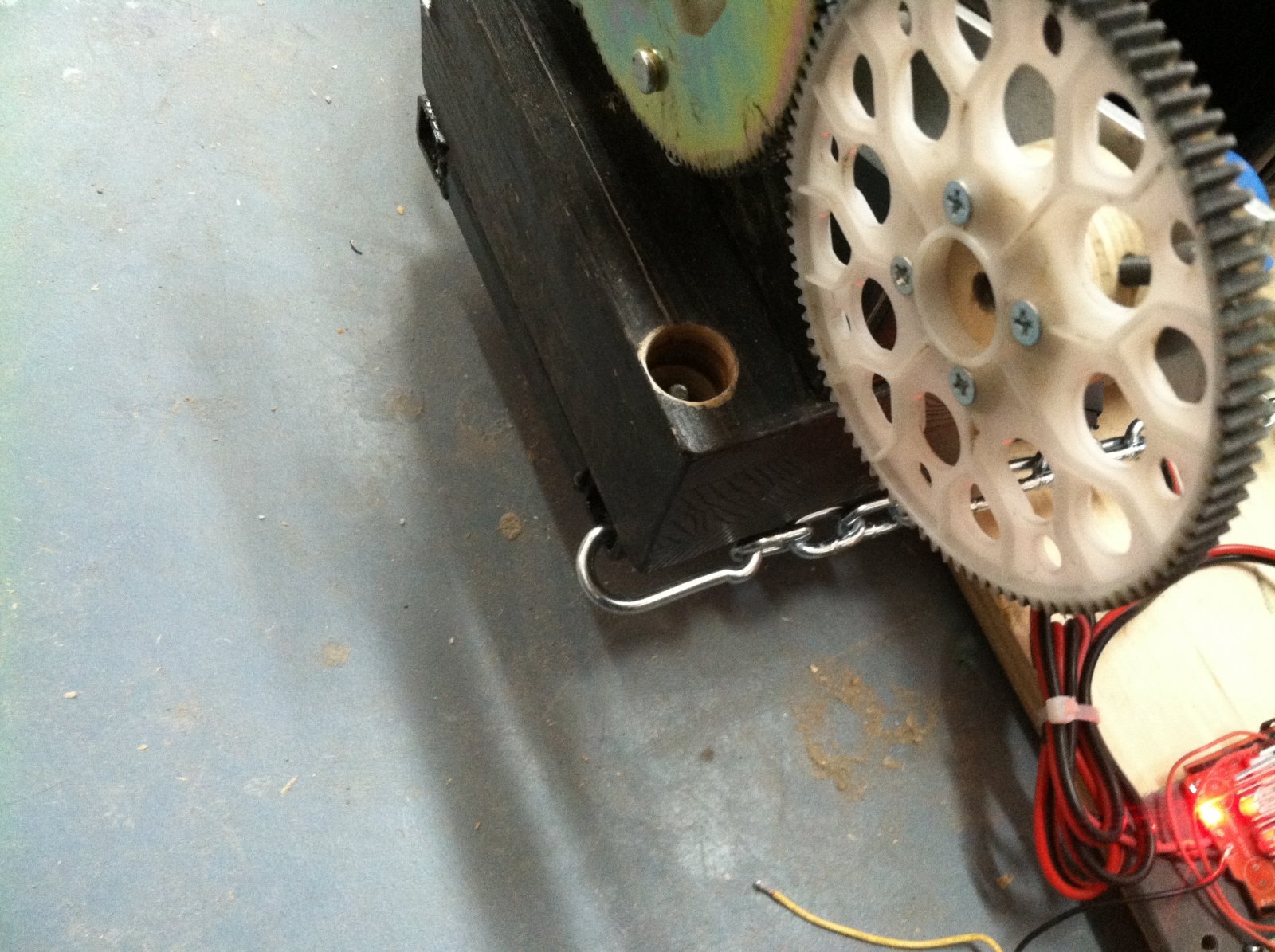

    I added a third layer (base layer) so I could add traction loss. The third winch motor works good for traction loss but this axis really would benifit from a faster motor. I might replace the winch with one of my old 24v wheel chair geared motors running in order to increase the reaction time. @SeatTime has a great idea using chain drive for traction loss and these motors would be perfect for that. I also have experience with chain drive on my DIY CNC router table. Here are the pictures of the prototype base platform for traction loss. It is pretty crude but quick to put together.
    The universal direction castors mounted under the second layer platform, they ride on a steel plate attached to the base platform (plywood):
    The entire rig:
    The connection method for the third winch is, again, crude but quick to set up and does work pretty well.
    Note the green goop to cover the exposed contacts on my HP 700GB server power supplies. I know myself, I would have dropped something metal across those contacts if I had not protected them ;)
    The goop is liquid electrical tape, just brush it on (or dribble a lot like I did, lol) and in an hour complete protection.
    Everything for layer two of the platform is mounted on that layer, the winches, Arduino, Chinese Moto Monster, and power supply.

    +1 well done Historiker and thanks for these detailed pictures!
